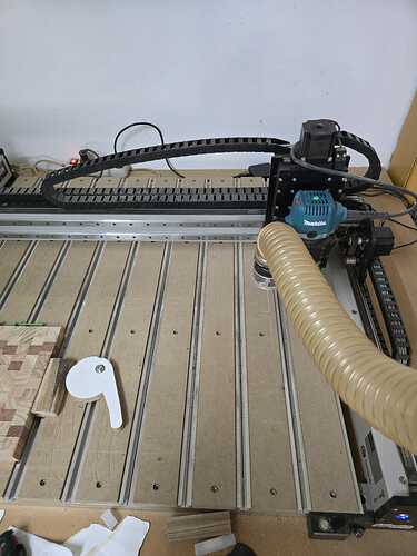

My machine when is initializing stops in the midle and doest come to the front if i try to do it manualy it doesnt move more then y400 and x100.
Yesterday was completely fine… If i try to setup the machine again in the part of the bit setter happens the same the machine stops there like the photo and goes down assuming the bit setter is on that position.

Please try re-running the Machine Setup Wizard:
if that doesn’t help, check in w/ the folks at support.
I’ve had this happen randomly on my S5 Pro 4x4. It all of the sudden thinks it’s a 4x2. As Will said, rerunning the machine setup and selecting 4x4 should fix the issue.
Hello Will, i already did that, but in the part where i have to set the bit zero it happens the same… the machine doesn’t come closer than that so i can set the bit zero…

I found the problem, on set up a new machine i was forgetting so save the selection :person_facepalming:t2:
I did new setup and everything came to normal.
