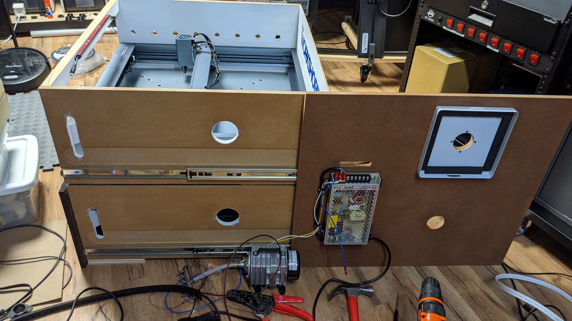

Laser Cutter Drawers
By far the most complex, this involved designing a cabinet with two full extension drawers to fit inside an existing metal rack. It has cable drag chains that nest in the same thickness as the drawer slides carrying compressed air, power for each machine, and control signals. When closed the drawers also trigger a fume extraction system that pulls smoke through HEPA + activated carbon filter before exhausting it back into the room. As these 10W optical power diode lasers are primarily engravers and I only use “safe” materials, the generated fumes are not very severe. The extractors run around 70% full power.
The drawer fronts were the first and sexiest part to make. I use a 36% VLT acrylic for scratch resistance bonded to an MDF drawer front. I routed the chamfer to avoid multiple setups, but the Shapeoko did the rest.
I built the cabinets WITH the machines installed and separated on spacers. It was a bit awkward but worked out well in the end.
Inside each drawer there is one laser cutter, light strip, and wifi camera. The decals were cut on a Silhouette Cameo though Carbide Create helped generate the SVG.
