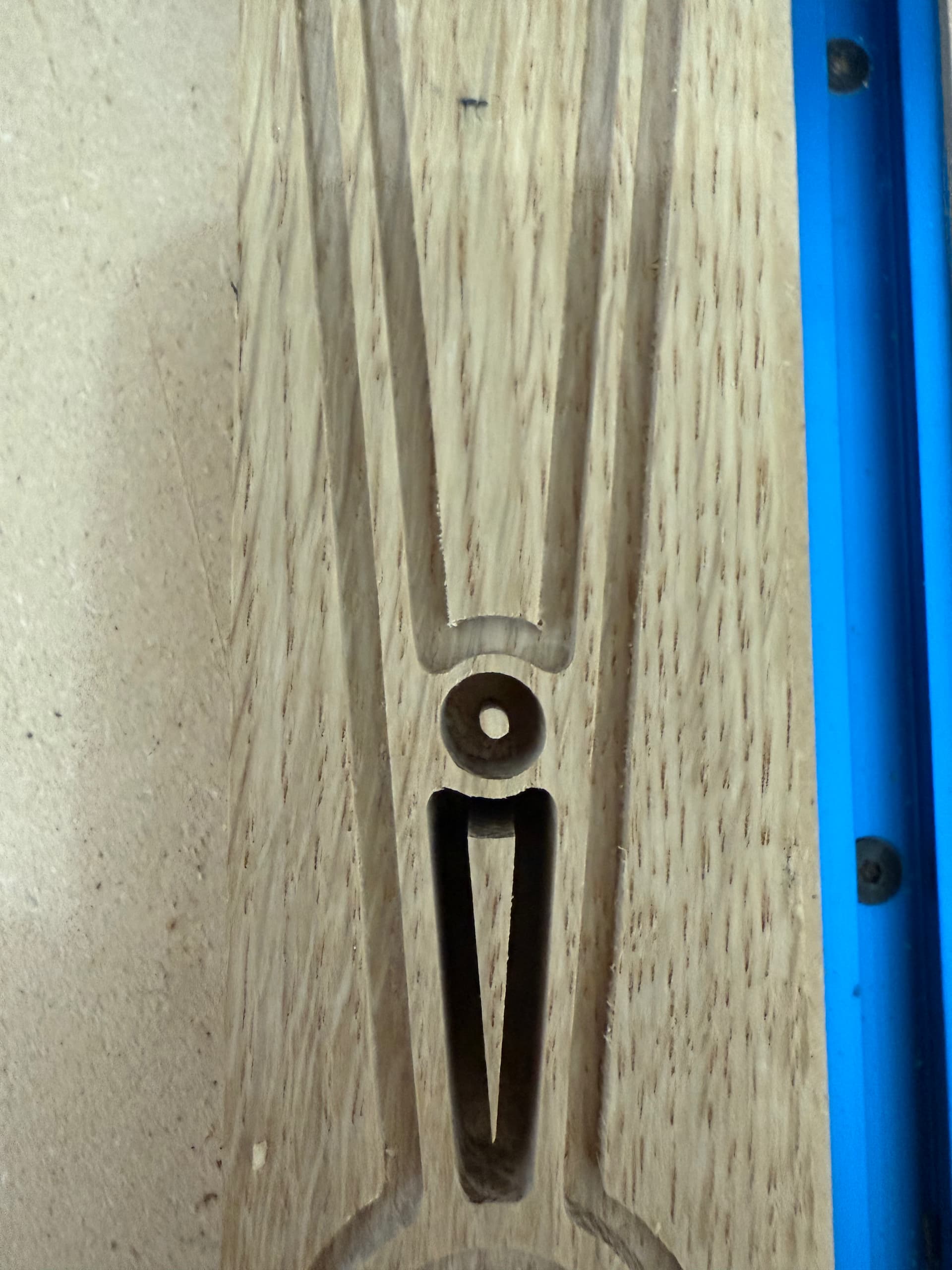

So I just moved and after setting up my shapeoko 3 XXL I am unable to get it to cut properly anymore. at first I thought it was the file but after remaking the file several times I’m getting the same exact result. The part I’m trying to cut out has 2 legs one left and one right the right side leg cuts out thiner then the left if I flip the part upside down and cut it I get the same result but in reverse the left side is now thiner then the right. Im also noticing that circles are not coming out round. I have checked everything I also had extra belts and wheels so I replaced all the belts and wheels and made sure the machine is square. When I moved the machine is was on a table so nothing really changed with it other then the location since the table is on wheels. I have attached a photo for reference. Thanks for any help with this.

When I see circles that aren’t circles like this, it makes me wonder if you have a loose grub screw on the X stepper or one of the two Y steppers, causing the shaft to slip inside the pulley. They should both be tight, and one of them should be on the flat. Many people replace the stock grub screws with M4x8mm socket head cap screws like this:
I checked them they are all tight. I thought maybe it had something to do with the software since I’m using carbide motion on a raspberry pi but I get the same result when using a PC. its weird because its not random its always in the same spot so everything im cutting ends up identical but .58mm off from left to right

I see you checked squareness and belt tension, etc, but did you check the level of the table? Since you moved it to a new area, the floor could be sloped differently and cause your table/bed/machine to be racked / potato chipped, which could result in a consistent error in roundness and angle. It may be worth checking level in several directions and shimming the table legs as needed if you haven’t tried that yet. If you do end up shimming it up in some locations, you will likely throw the gantry out of square and need to re-square the machine again.
its not hitting anything. Is there a way to check if its losing steps?
Thats one thing I didn’t check! I figured the table I built for it is so rigid that twisting would not be an issue. After reading your post last night I leveled the table and the machine and squared it again it was barely out of level but its perfectly level now and still getting the same exact result.

In my inexpert opinion, you have some play on your X sides. IF a circle isn’t a circle, then your gantry is shifting/torqing. Bet your issue is South > North vs North to South cutting (maybe E>W/W/E but more likely N>S). I would redo your belts, making sure you are square and flush in the rear, and that there is NO play in the gantry. power off/disconnect motors. hold left side to the back, can you wigle right side? now do opposite.Hold right and wigle left. If you lifted the unit by any of the rails, (even for a second) it could have shifted a rail.
I’m sorry you’re still struggling with this issue, it has to be frustrating. I had one other thought that could be impacting you, based on the last post about x movement. At one point I found that my spindle mounting plate was loose and the spindle could rock slightly because of it. I had to take off the spindle (router in my case) and mount, center the plate and tighten all the screws (if I recall correctly, to the linear bearing blocks), then reinstall and align the spindle. If yours is also loose like that, it could explain some movement along both the x and z axes as it rocks side to side. I’ll look to see if I posted anything when that happened. And copy a link if I did.

This support response didn’t address my concern directly, but after explaining again and feeling confident about torquing as I saw appropriate and adding some loctite, I went ahead and re-tightened everything and have been cutting happily since. I think I was able to feel the movement when I grabbed the spindle and twisted in the x-z plane.
