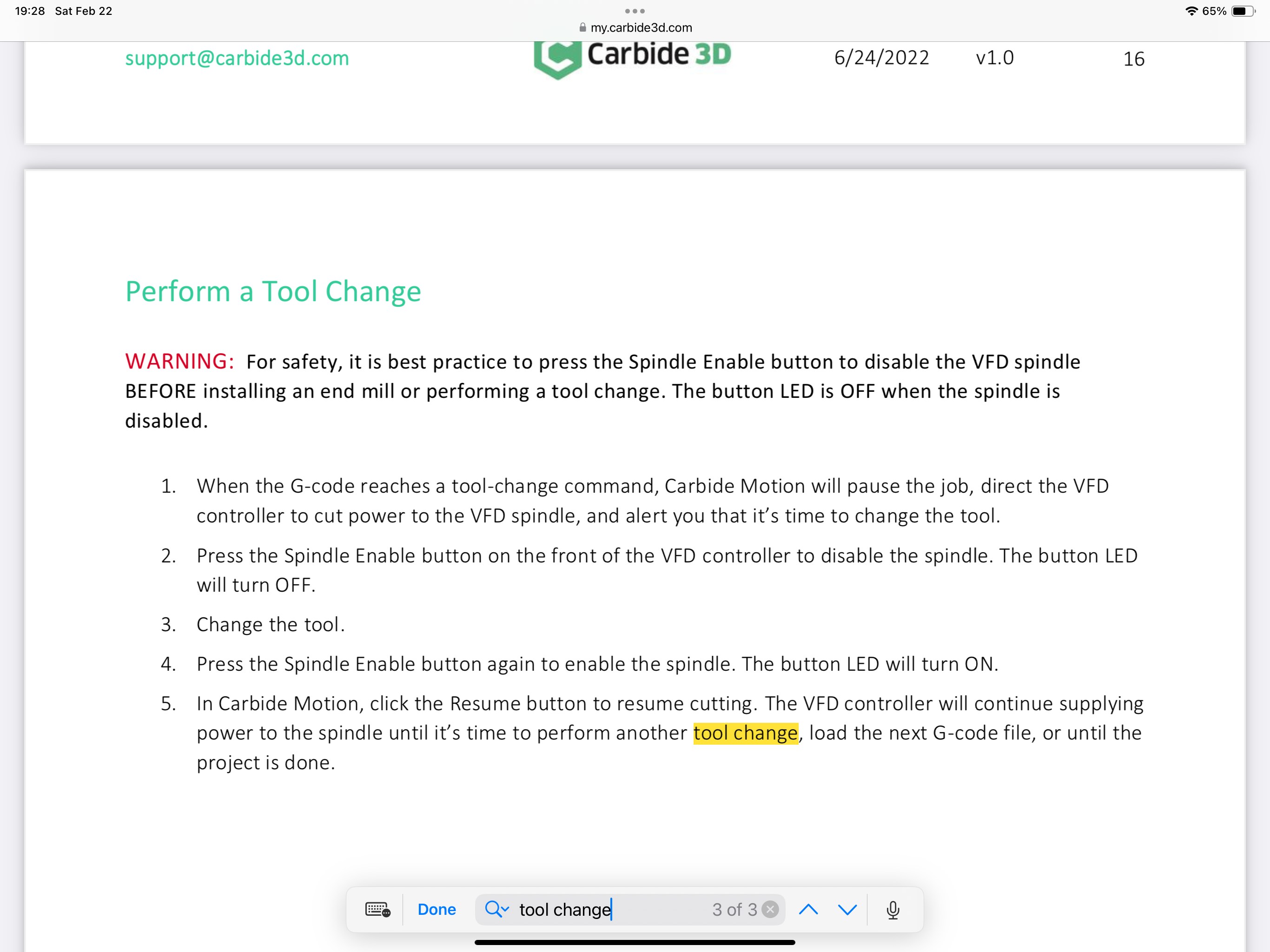

On two occasions lately I was showing my Shapeoko 5 Pro with VFD spindle to friends. Both of whom work in manufacturing industries. I was doing a tool change while demonstrating and both asked how I was “locking out” the spindle to prevent accidental running (and losing digits in the process). Well, that was something I had never heard of and in many searches on Carbide’s website and the groups I couldn’t find reference to this. I’ve learned that this is standard procedure in manufacturing and the horror stories are many of people losing limb and life because a machine started up accidentally. We all know how perfect computers are! I would think Carbide should be emphasizing machine use safety and have this one feature in bold RED letters somewhere obvious. I have since discovered the lower button on the VFD controller is indeed a lockout button, but the documentation is poor at best. I think the guys at Carbide are great but documentation is where they fall short. FYI.

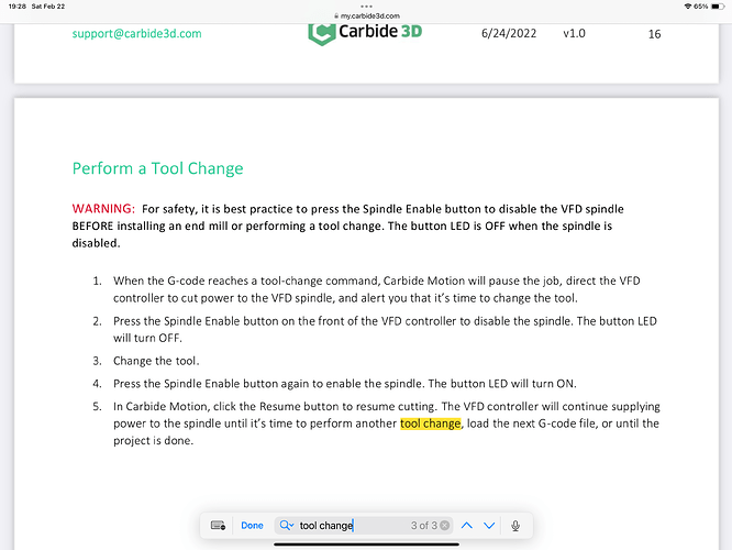

I just looked at the 65mm VFD install manual. The spindle enable button was called out at least three times as the proper procedure, including the following:
Perform a Tool Change
WARNING: For safety, it is best practice to press the Spindle Enable button to disable the VFD spindle BEFORE installing an end mill or performing a tool change. The button LED is OFF when the spindle is disabled
If people won’t read the manual, there’s not much more C3D can do.

On the C3D site, I went through Support / Manuals, (Product manuals) and then the link for the 65mm VFD took me here:
It’s on page 17, in bold red letters of the manual mhotchin listed above. I dowloaded this exact manual prior to installing my 65mm VFD.
