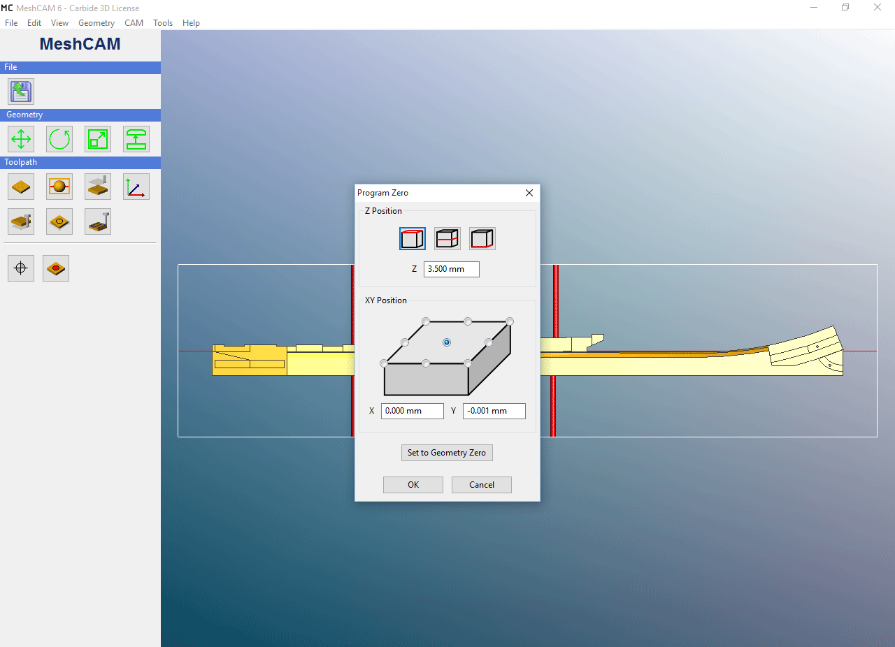

Hi Guys,
Using my new nomad pro
I tried my own file in meshcam as a first go, I zeroed the machine as per tutorials but it the measured the tool and started machining 2 mm above the stock. About half way through it did go into the stock a little.
What settings could I have got wrong in meshcam?
Thanks
Tim

I suspect that the machining parameters are not at issue. How the object is aligned to the machine is.
Could you have CADed your object such that part of it is above the XY plane and part below?
Where, exactly, did you zero Z? Top of stock?
Please post the STL file you’re working from and a screen shot of the MeshCAM parameters.

Its screenshot 3 the top Z I have left Z at 3.5mm and also done Z at 0mm but still similar results?
Wherever you set the Program Zero, is where you touch the cutter down in Carbide Motion and set Z=0. In your screenshot, you are just setting program coordinate Z=0 at the top surface of the stock. So when you touch the premeasured cutter there, zero the Z in Carbide Motion and all will be well.
MeshCAM generates is gcode relative to the Program Zero you define.
I like to say MeshCAM defines the stock relative to the geometry, and the gcode relative to the stock. You can verify the Program Zero onscreen by the red/blue/green vector triad.
Randy
To help reinforce what @Randy said, I added 3mm on top and placed X/Y/Z zero in the middle (so it is obvious).
With the Z0 in MeshCAM on the top of stock, “touch off” machining Z0 by barely touching the top of stock with your end mill and declare this Z0 in Carbide Motion. Then away you go.

thank you very much for the explanation guys I think I know what I’ve done wrong now and will try again! :smile:
