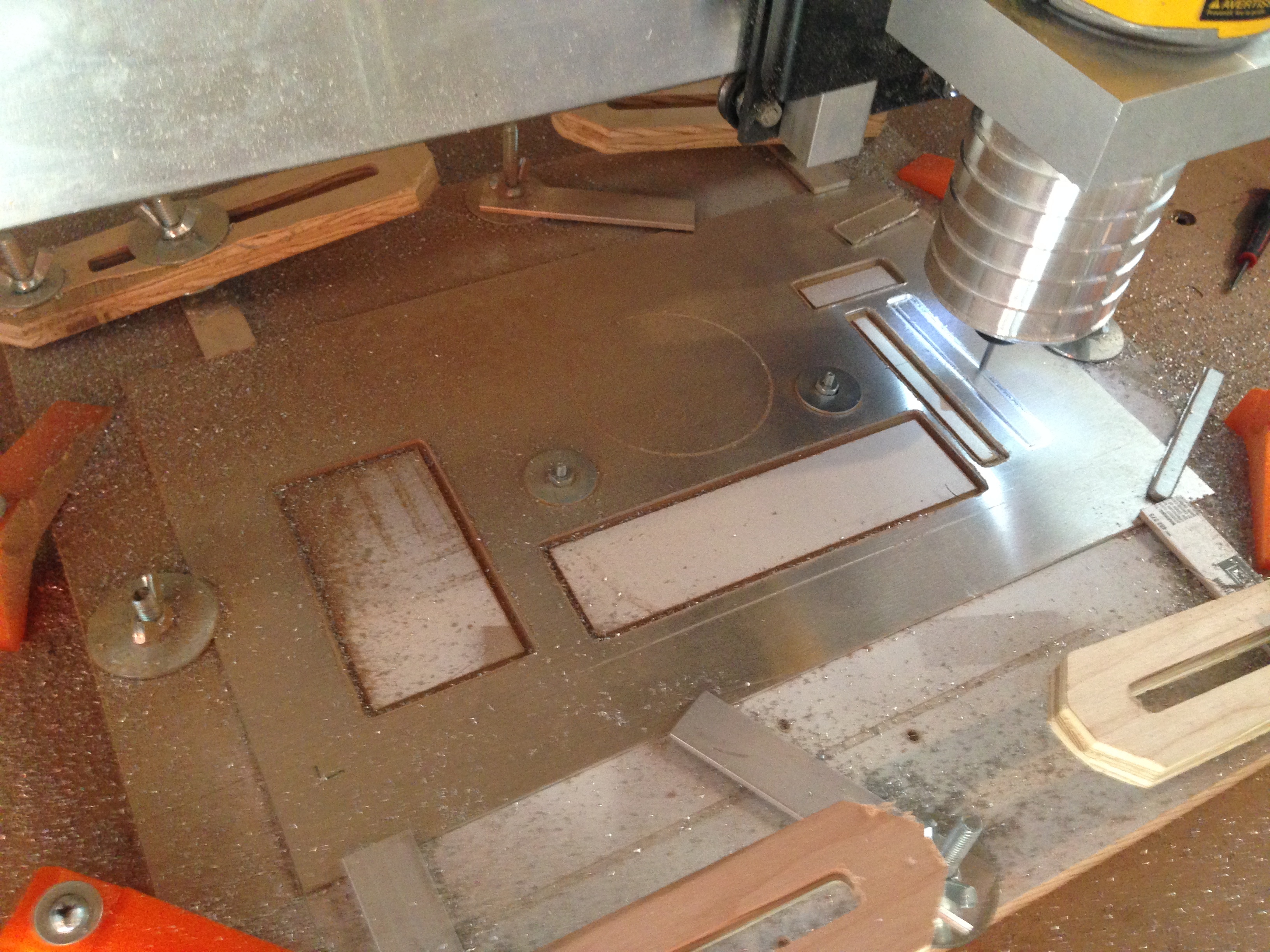

  1. Clamps, Clamps, Clamps. I can’t stress this enough. When I first started I would use 4 clamps and just make sure the stock is secure to the table. That simply isn’t good enough. You need to make sure that the entire stock is flush to the table and will not “lift” between spans. What happens is the endmill will go over a span, push down the stock (even just a fraction of a mm) and make the cut. The stock then comes back up to it’s original position. The next time the endmill comes around there is a good chance it will “catch” on the stock because it’s higher than it should be. Your fine as long as the endmill continues to push the stock down but often on the last cut, there may or may not be enough material to push the stock down; you’ll catch the bit on the part of the stock that isn’t flush to the table. Now you broke your bit and you were 95% done with the work. This is frustrating to say the least.

I’ve attached some pictures of my clamping jig and a completed part.

Clamps, yes you are spot on. Good clamps makes all the difference, but clamps should be level, with the back of the clamp level or a little higher then the work part, AND the hold down bolt should be (about) in the middle of the clamp, NOT at the back. You will get a lot more clamping force if you use them correctly. I made my own set, but you can buy some nice strong 6 or 8 mm clamps from:
