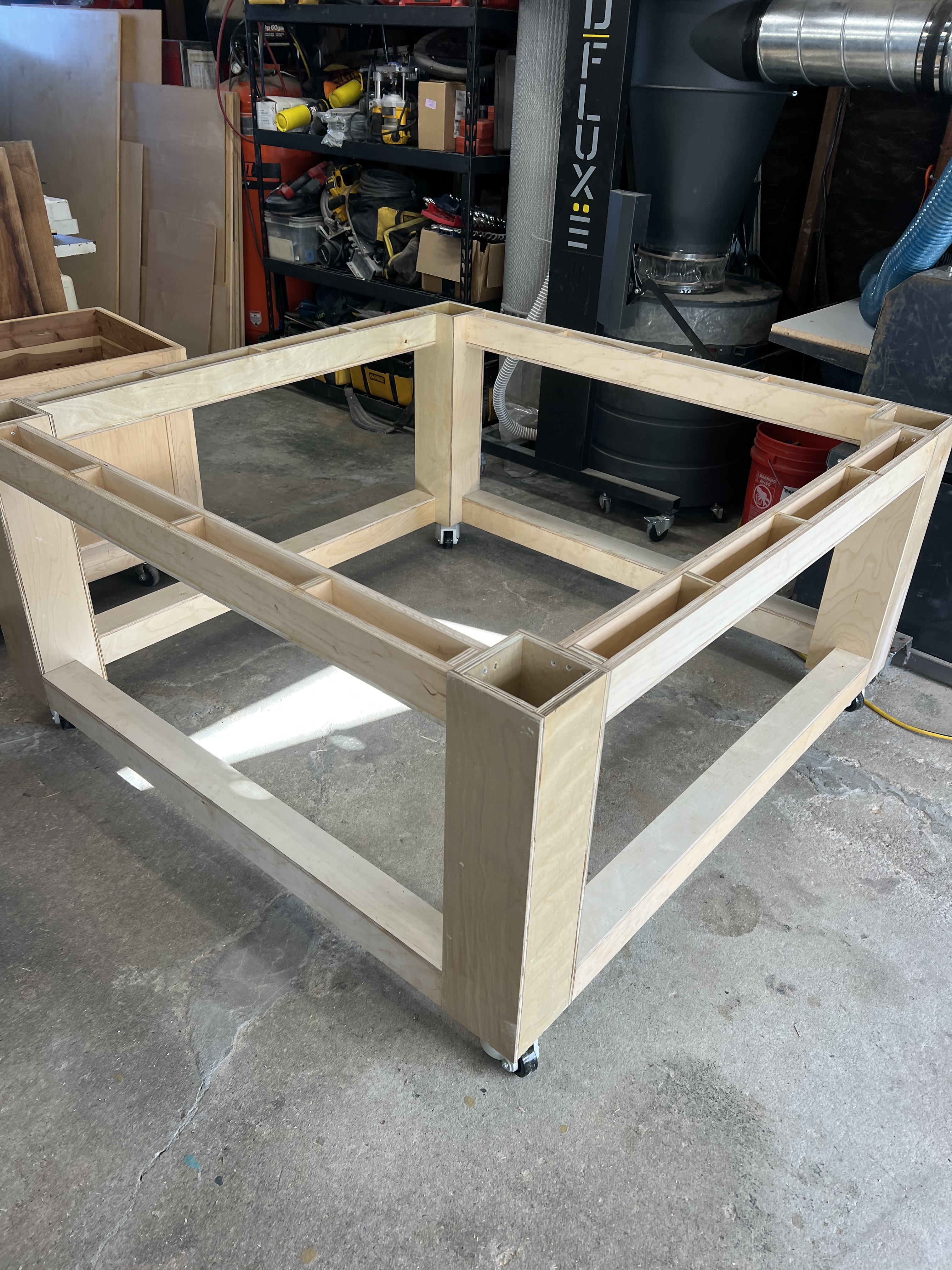

Made a table for shapeoko pro 5.1 4x4 not quite done yet

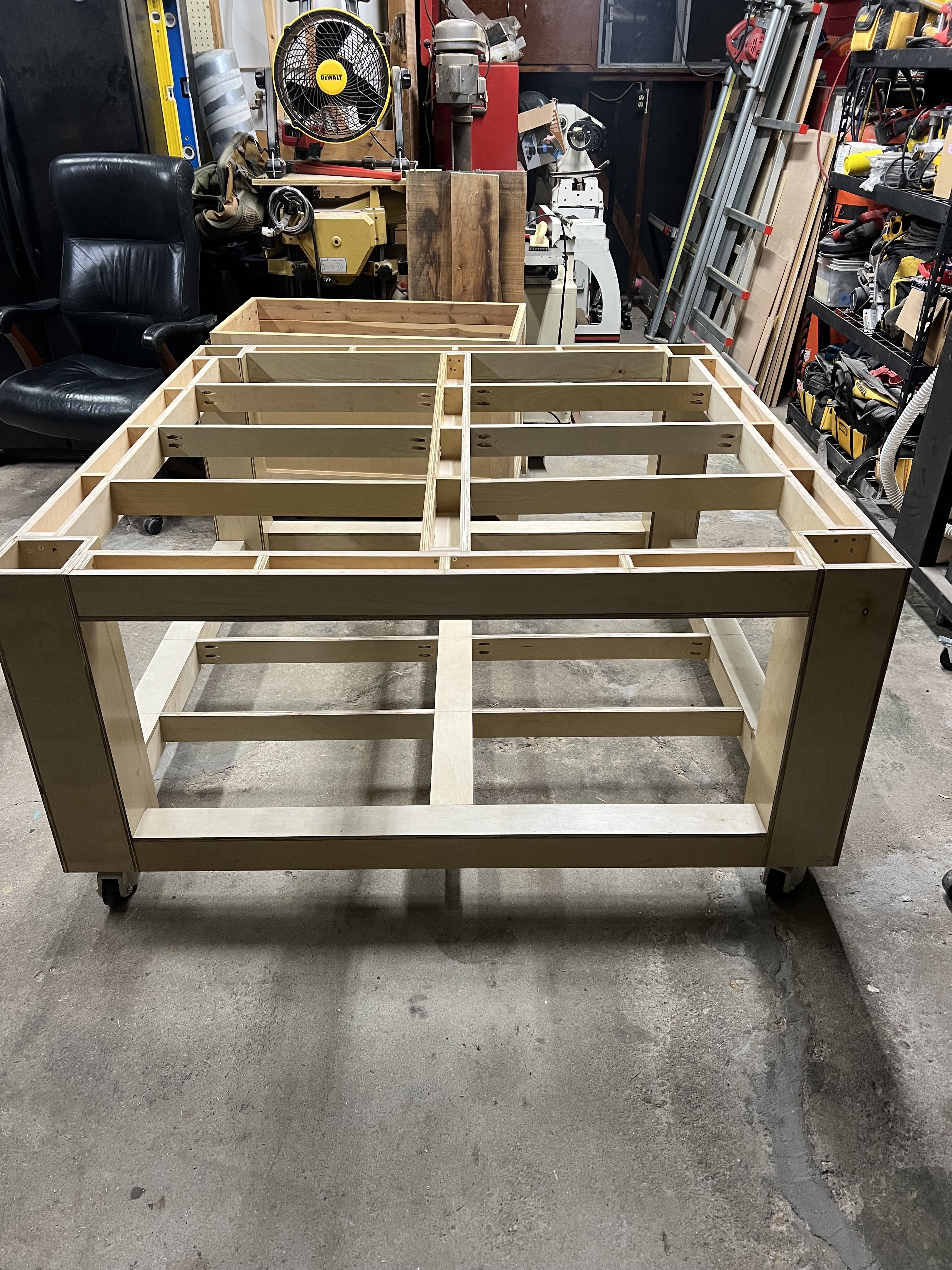

I like the box sections as beams- I don’t remember seeing that before.
@phillip.Harrell
Did you add any cross members under the table top?
Not finished with the build yet and yes I added another cross support on the top and bottom and will also put in supports across to have screwing points for the top

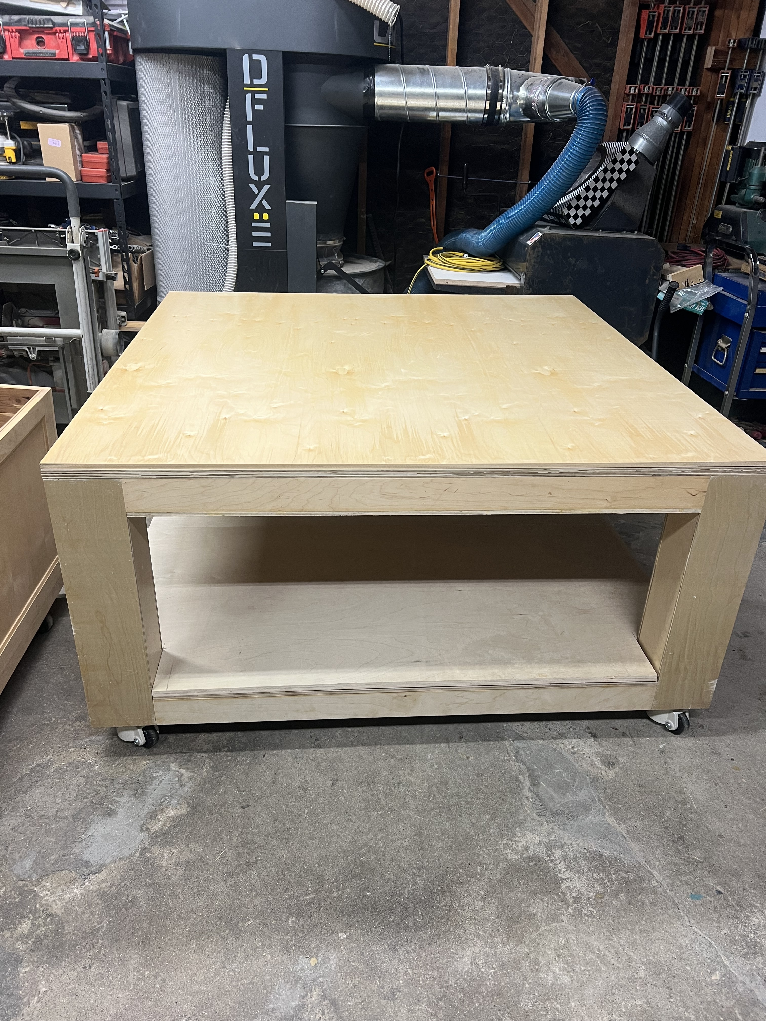

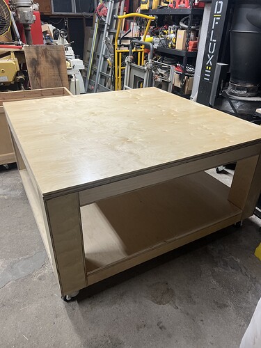

There will be 3/4 ply on the top with a piece of 1/2 bb birch on top of that more picture to come
Thats a beast of a table… Looks very solid. Are those retractable caster wheels?
Looks like the same wheels discussed in one of the other recent threads.
Agreed, beautiful table. But I must admit that, after reading way too many CNCZone threads, my first thought was “imagine the damping after it’s filled with epoxy-granite”… :sweat_smile:
Ah, the old CNCZone optimization traps. :wink: Been there, decided not to do that. They would have you chasing half a thou on a hobby/prosumer machine. :smiley:

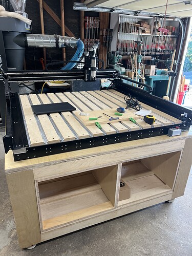

Yes the wheels are leveling caster 3300 pounds they do roll very nicely got them off Amazon need to put plywood on the bottom shelf and the top then put a couple of banks of drawers in supposed to get my 4x4 Pro this Friday

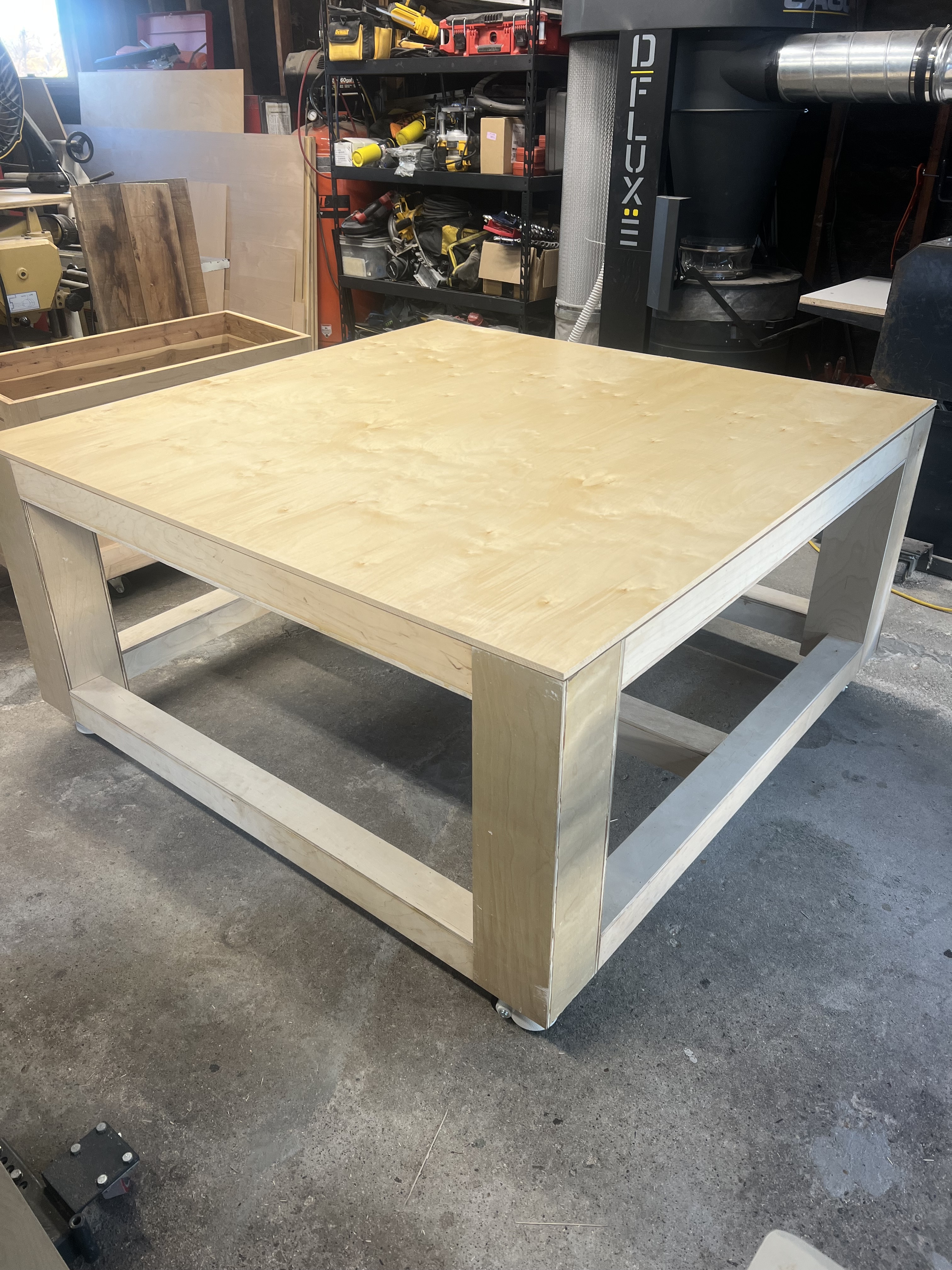

What size is your table, it looks humungus
Gary
Out side dimension are 60x60 I thinks it’s like 34 to the top of the spoil board let me know if you have any other questions
