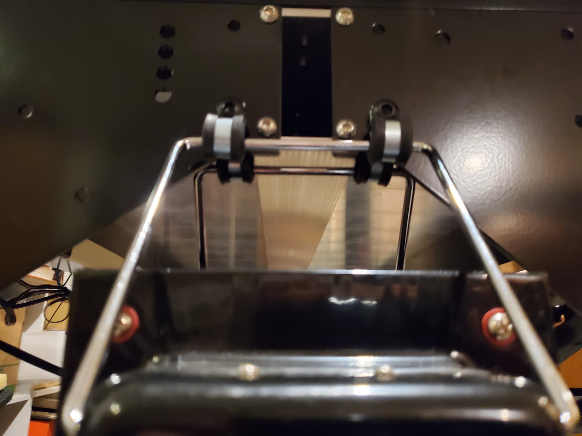

That said, I now have another problem/question: How to attach/hang the transformer from the machine structure?
My current thought is to use 4 (2 packs of 2):
https://www.lowes.com/pd/Gardner-Bender-1-2-in-Metal-Cable-Clips-Cable-Staple-2-Pack/5001840207
but the steel is only 0.75mm thick and the transformer weighs ~48 pounds…
@WillAdams
You will need to use some type of backer material, like “back plating/through bolting” process used for example in boat manufacturing.
Since the holes are through the steel legs, I believe that they will be fine:
and I mostly have the cables and so forth run in a reasonable fashion, and best of all, managed to puzzle out the BitRunner issue — bad Spindle Pendant cable — next up is tidying up the balance of the basement and working out how to reposition machines for actual use.
(also putting tape along the seams of the underside of the hybrid T-track)
@WillAdams
I didn’t realize it would be mounted to the frame. That would easily be hefty enough in that case.
