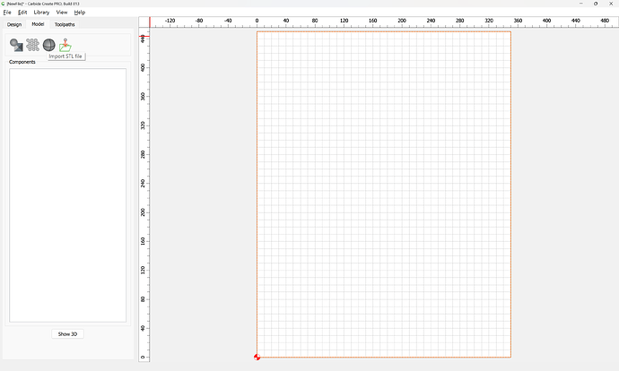

Downloaded newest software, but now it will not allow me to create tool paths for stl files. Always says empty path, no matter what i change in settings

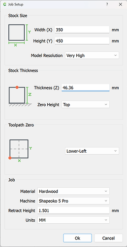

Eventually, the file is repaired and may then be inspected for dimension:
so we set up the Job to match:
and draw a rectangle which matches the Stock dimensions:
and import the STL (after switching to the Model tab)
The model comes in slightly scaled, so we reduce to 1 where necessary:
Interestingly, the appearance on import does not match that of the STL which was originally shown in the 3rd party tool.
