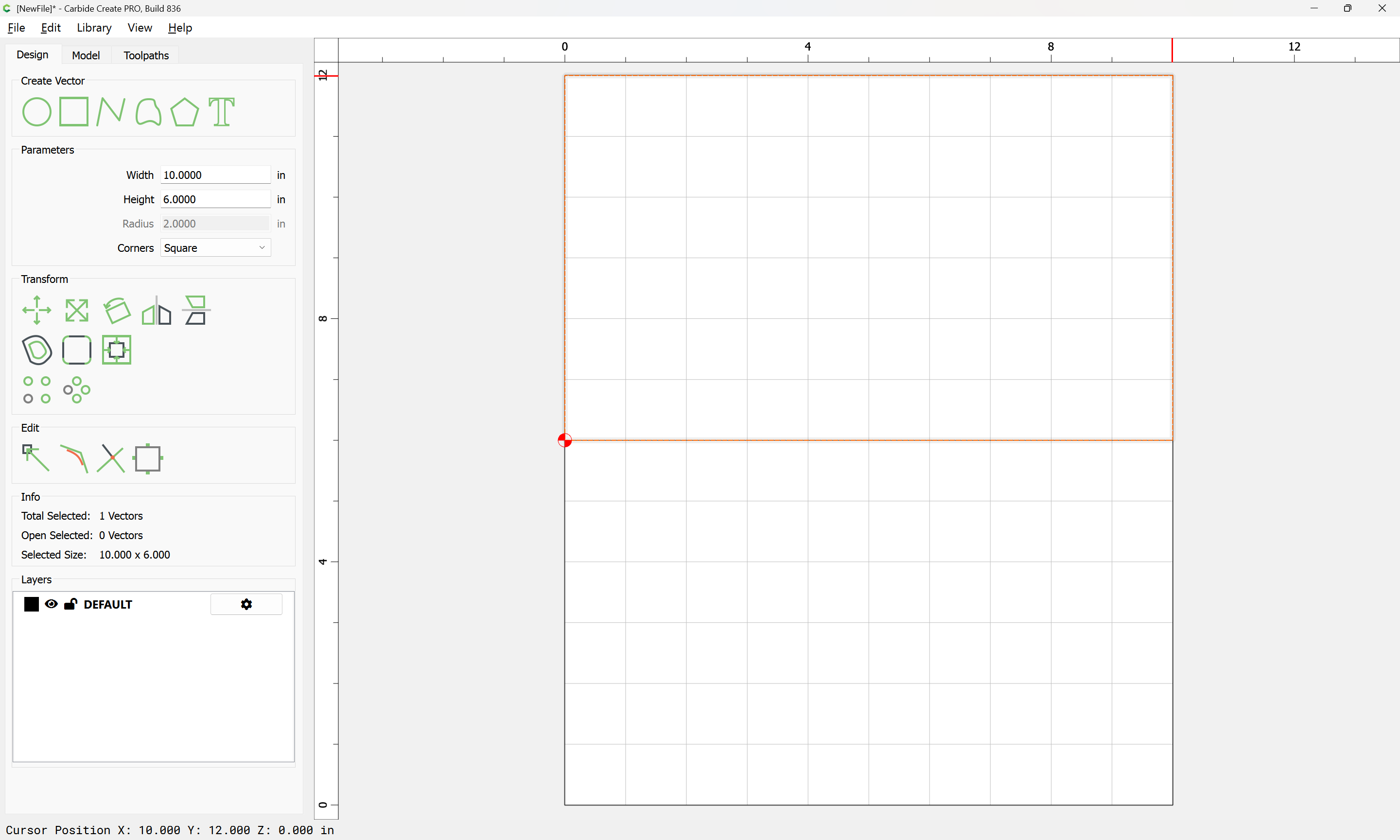

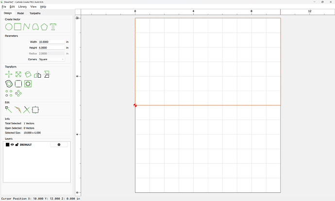

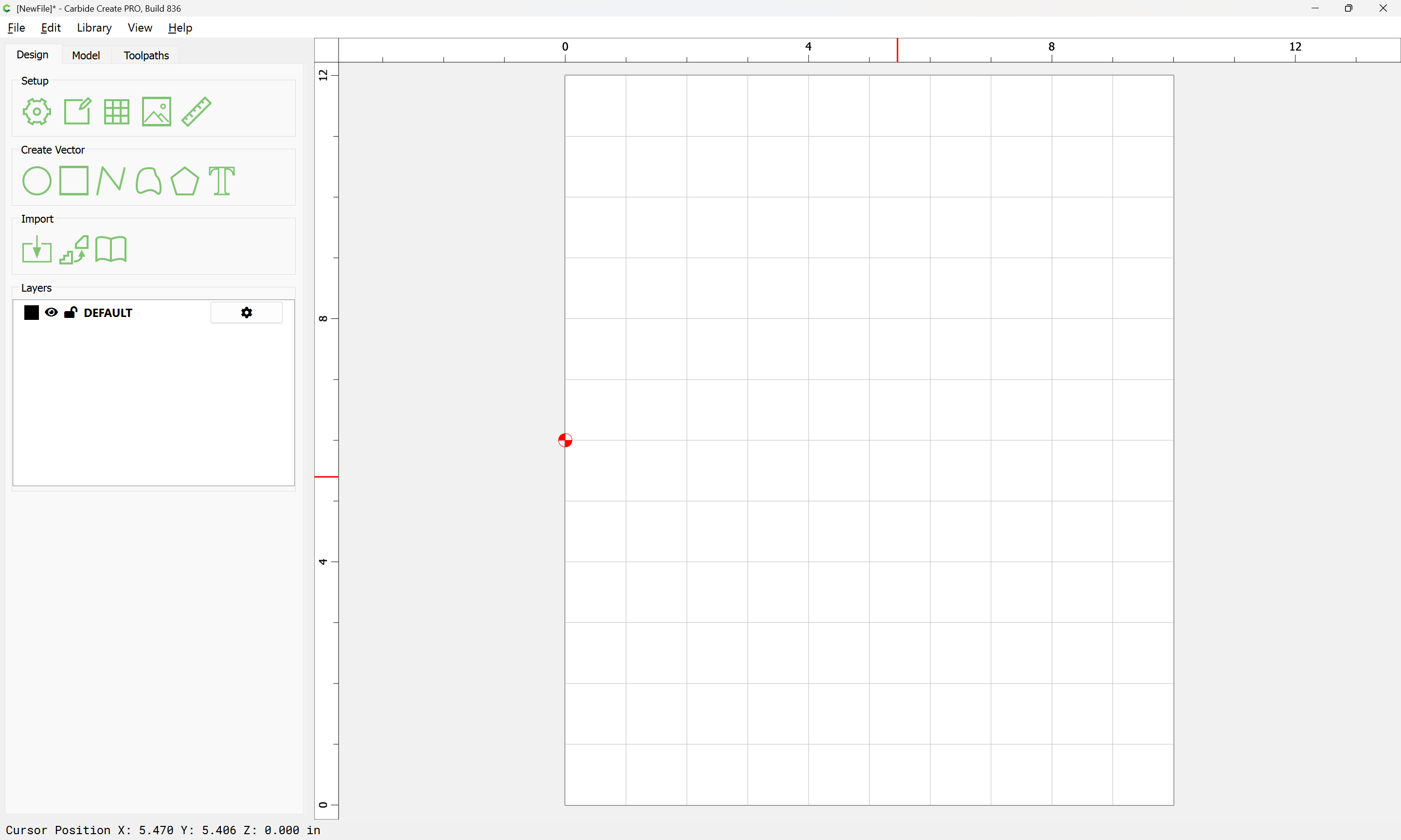

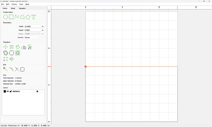

as requested on support…
…make:

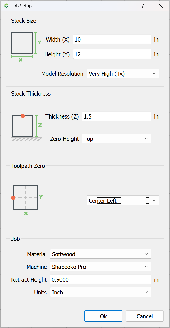

Board size = 10" x 6" x 1.5" (thick)
Product size = 8" x 4" x 1.5"
Cut bowl size = 7" x 3" (upper lip)
Bottom of bowl = 4" x 1.5" ; 0.25" thickness remain at bottom.

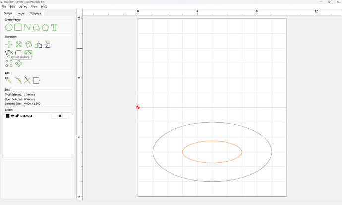

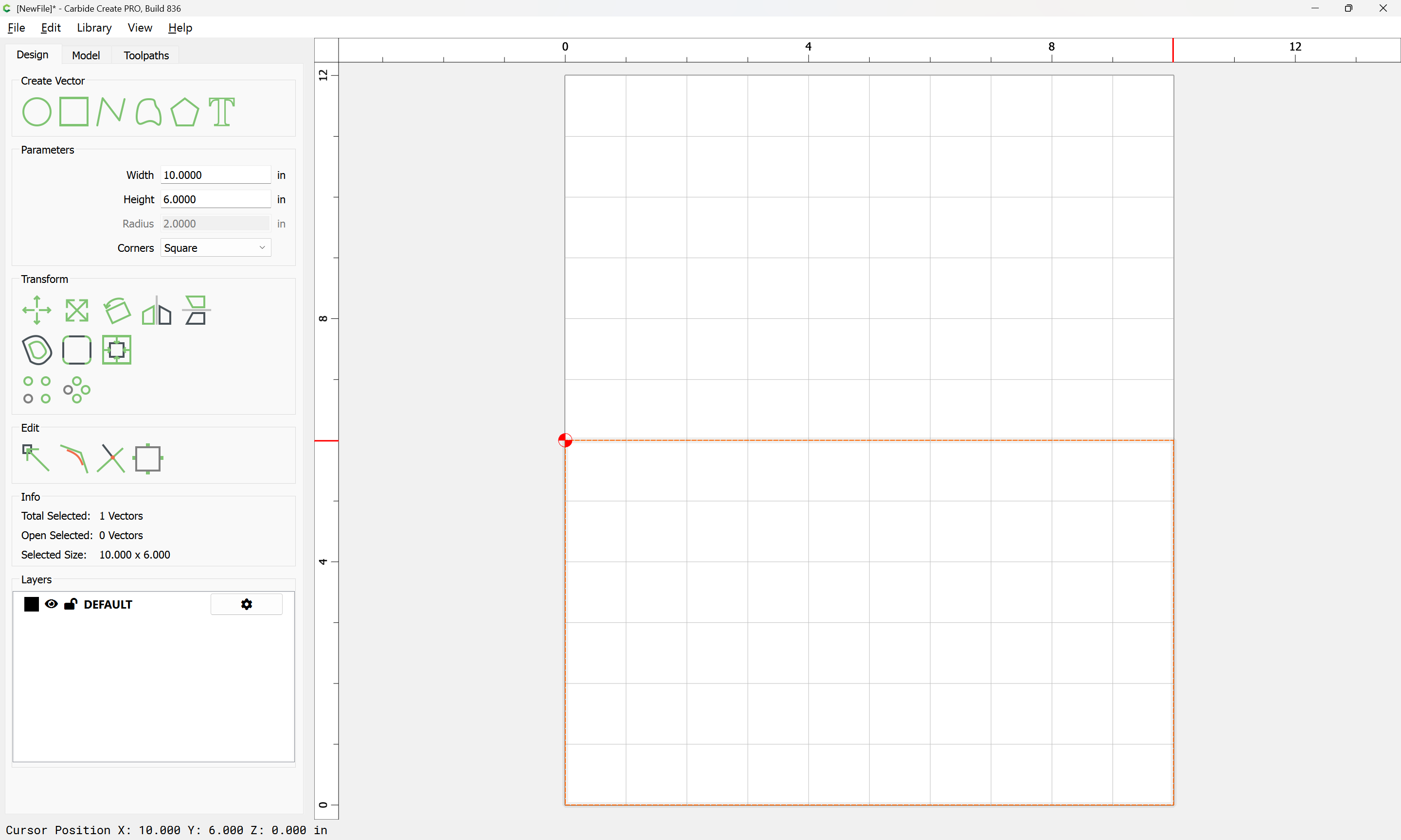

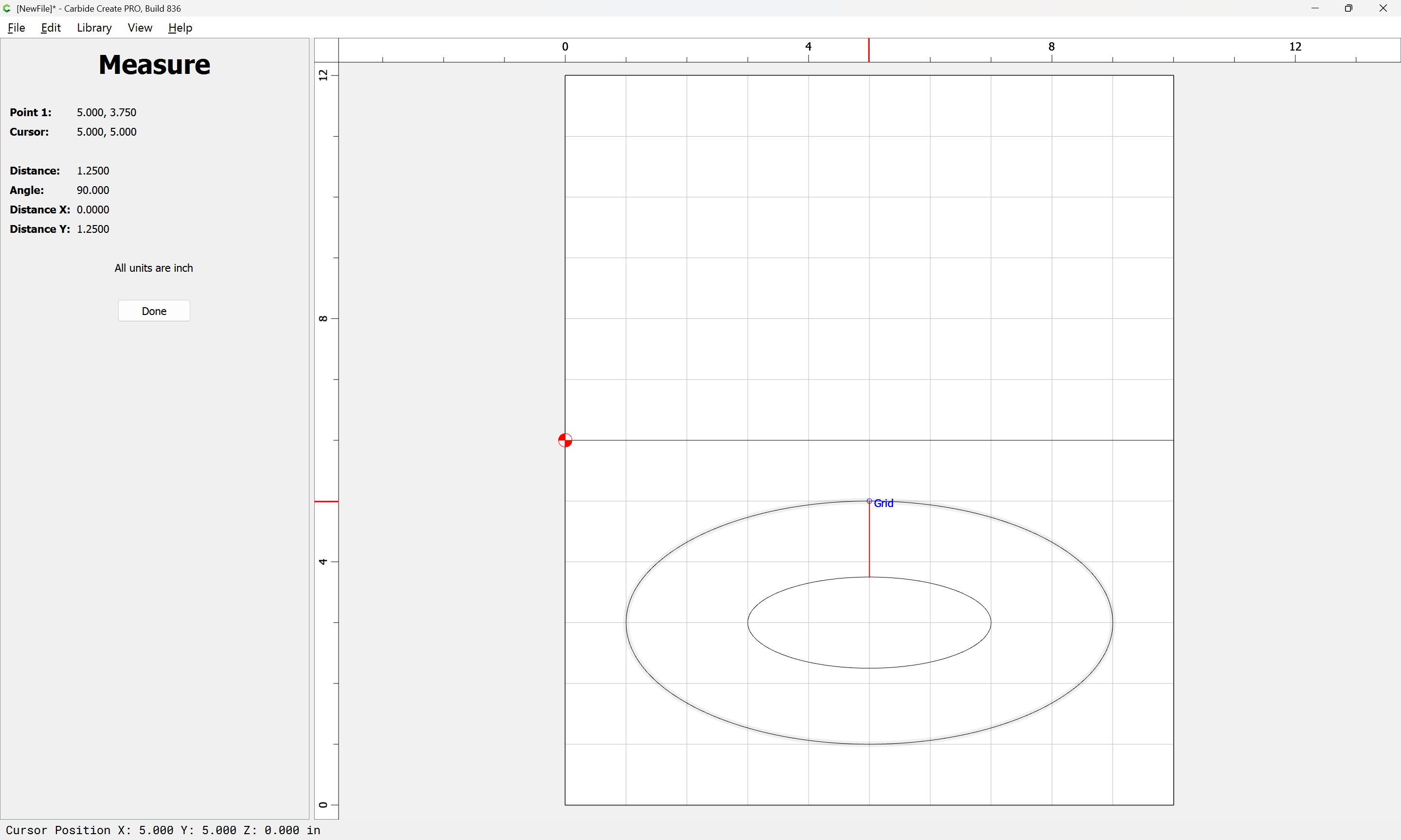

The file will be set up at twice the necessary size so that top and bottom may be cut in separate operations:

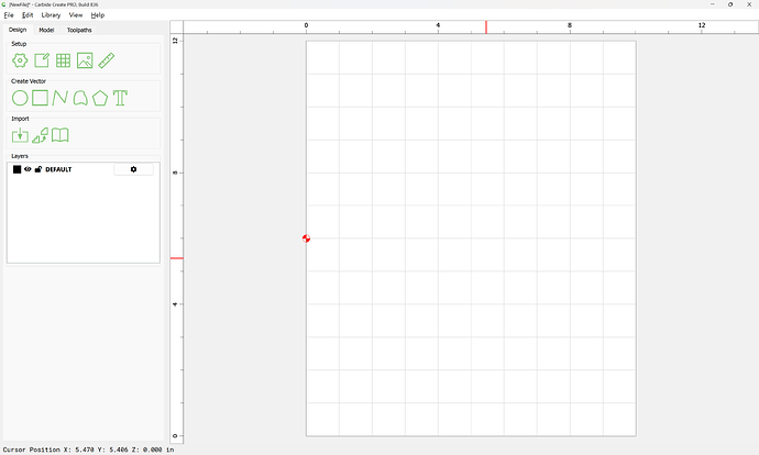

Draw in geometry for each half:

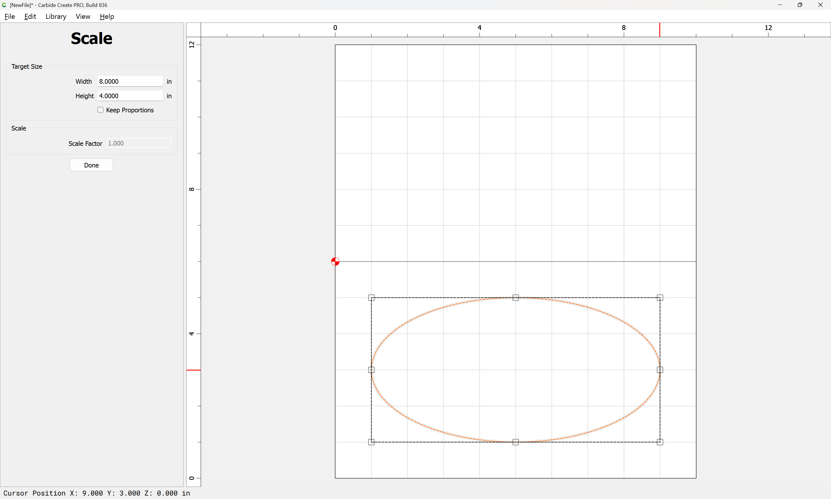

Then draw in a circle:

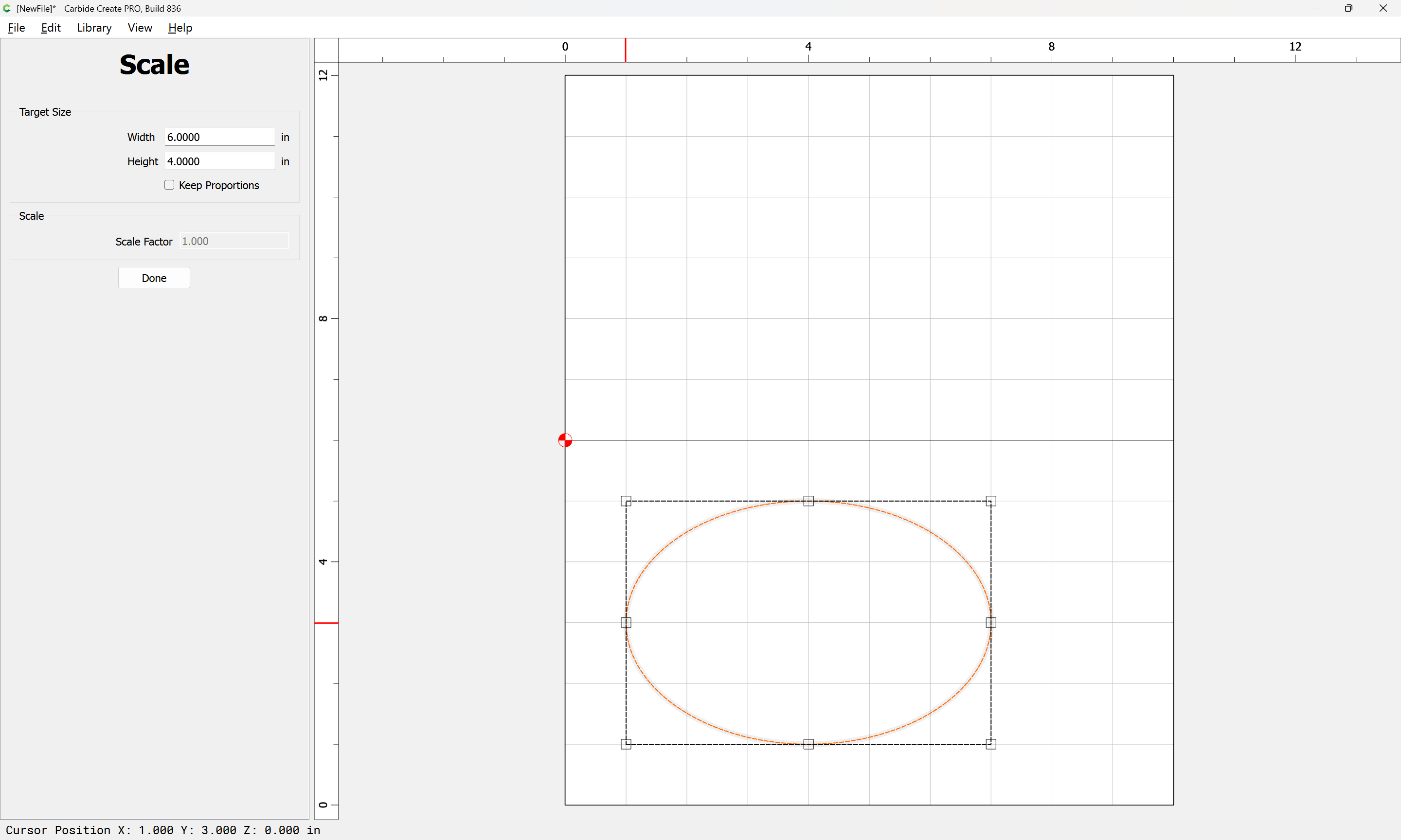

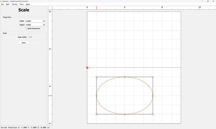

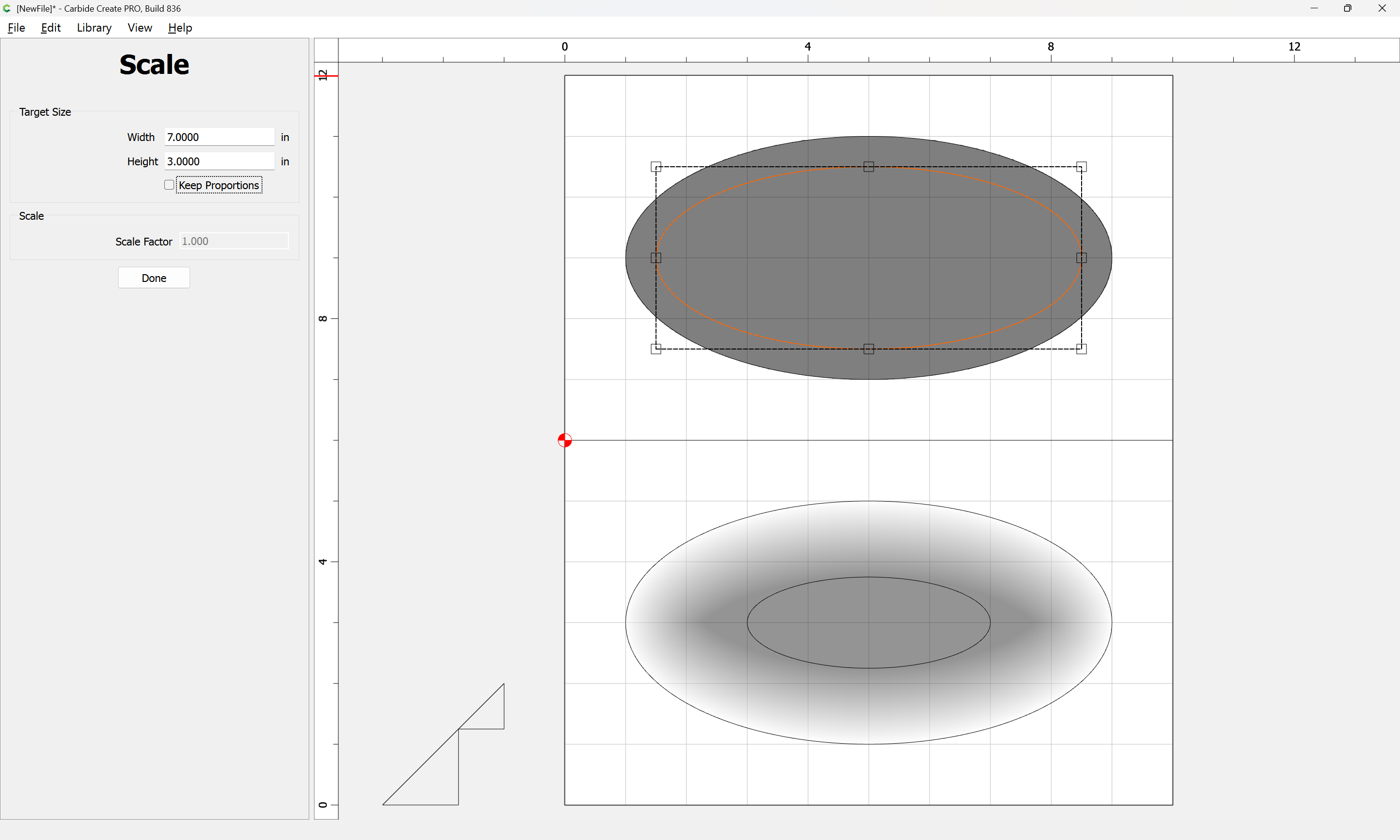

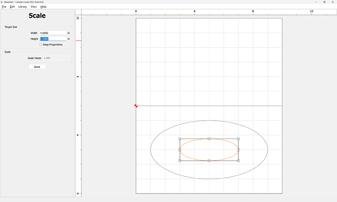

and scale:
clear the checkbox for Keep Proportions:
to draw the outer perimeter at the top.
WillAdams
(William Adams (Carbide 3D))
2

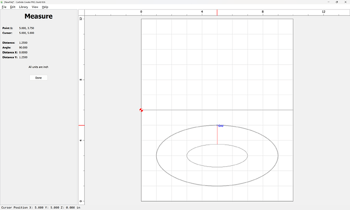

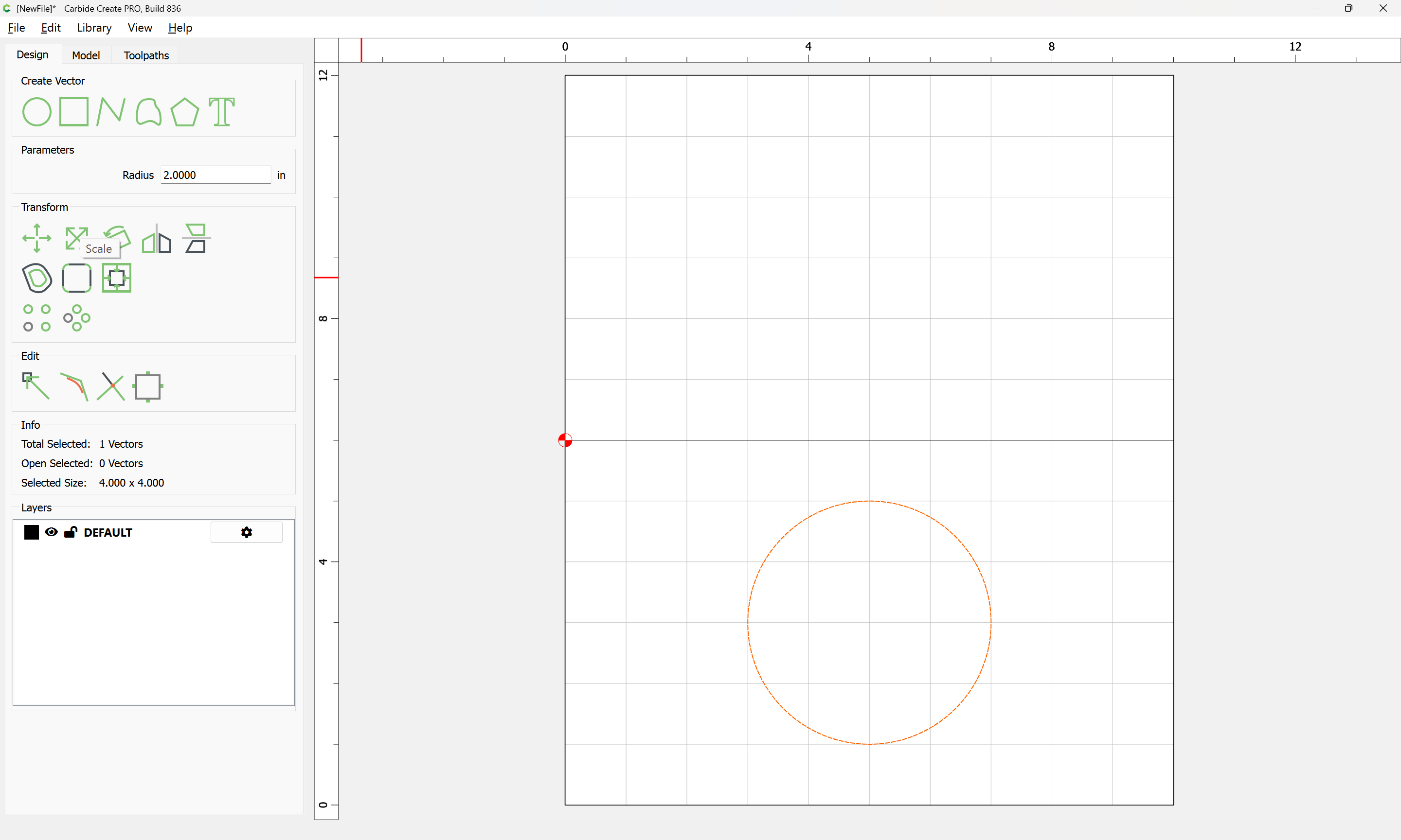

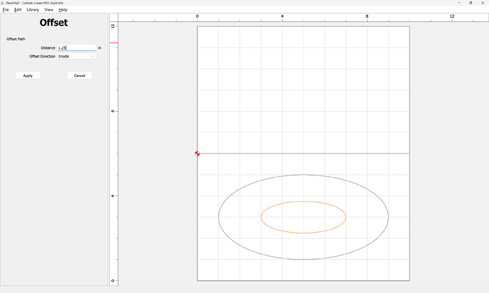

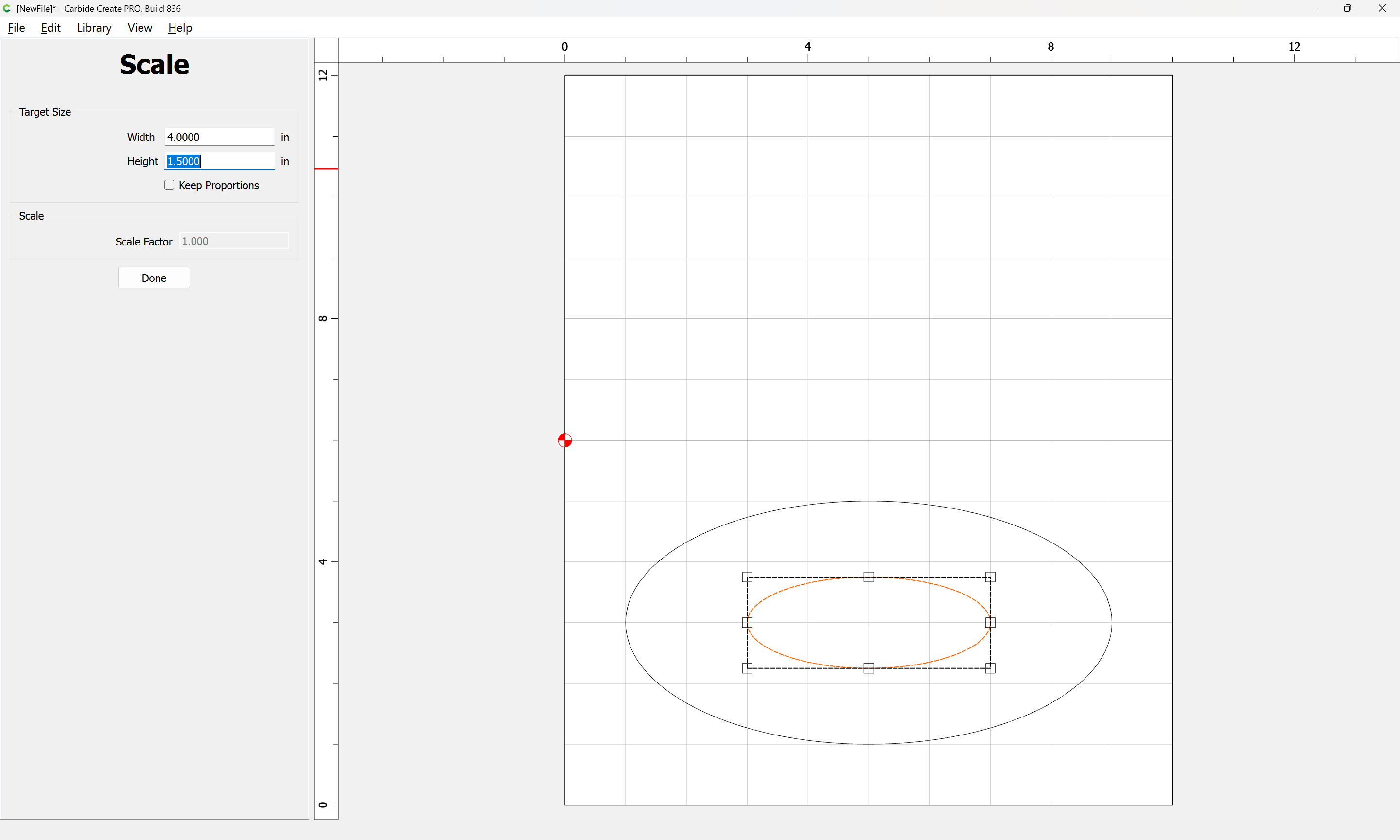

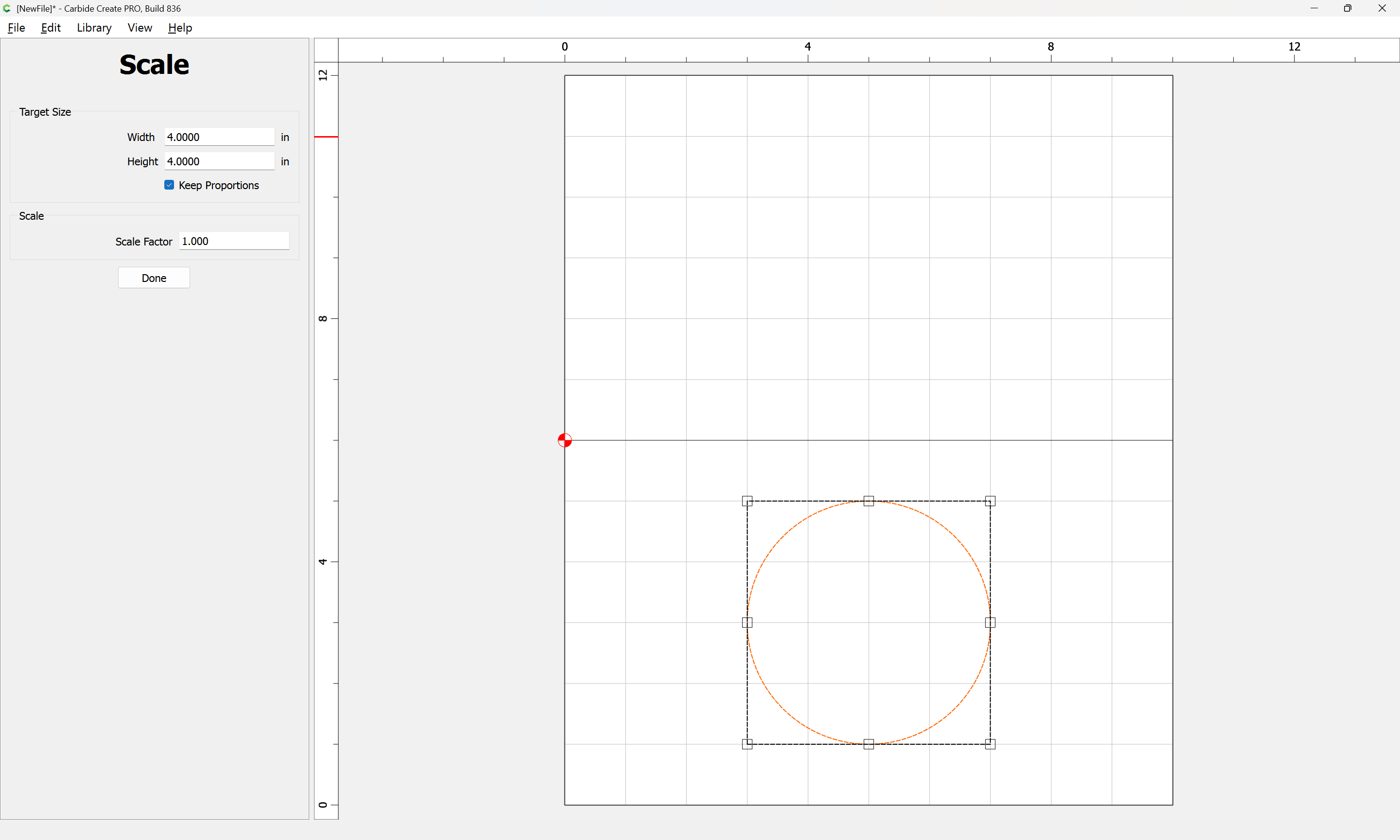

Draw in a circle for the bottom:
and scale as before:

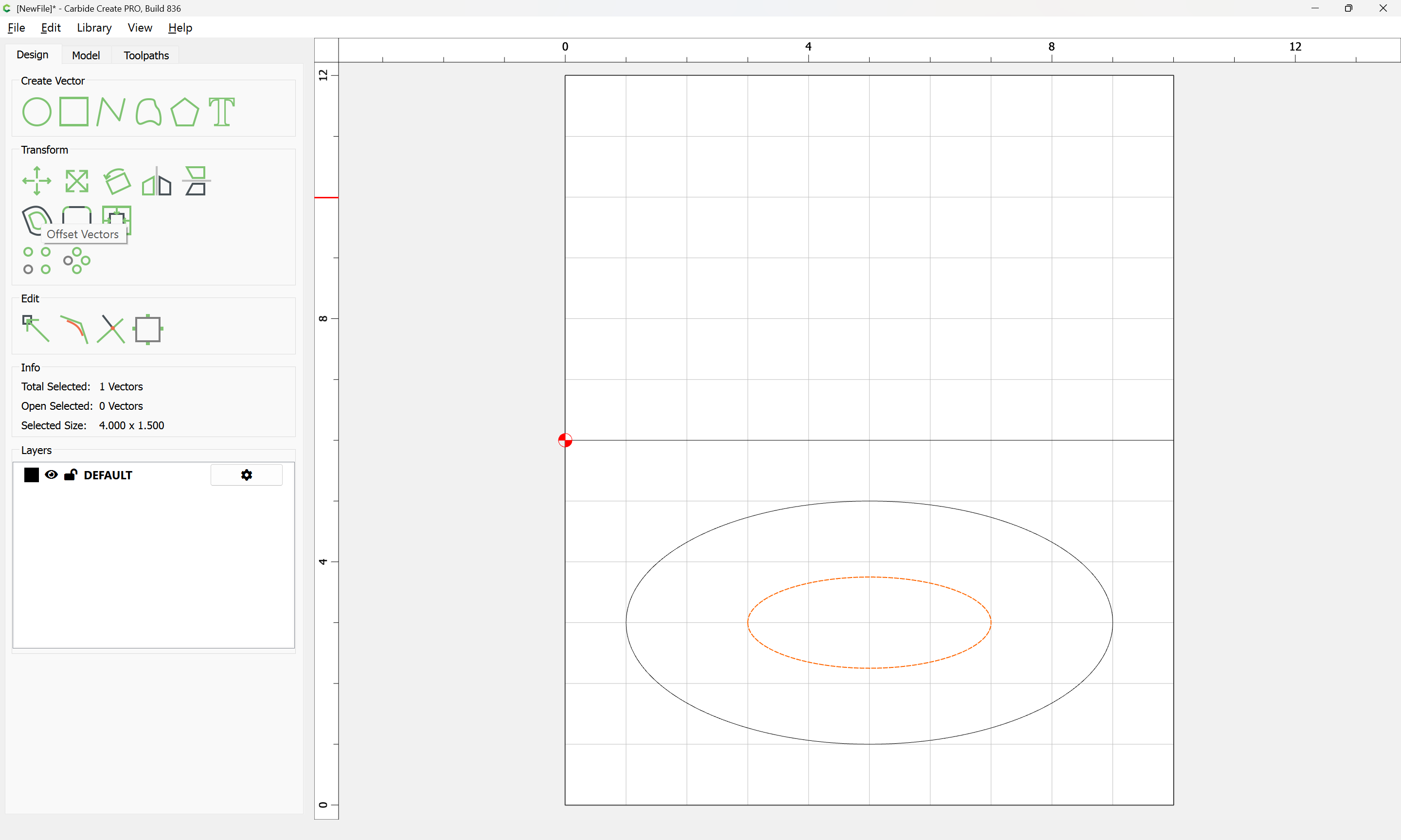

Measure the distance to the edge:
but it is not possible to inset by that dimension:

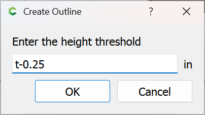

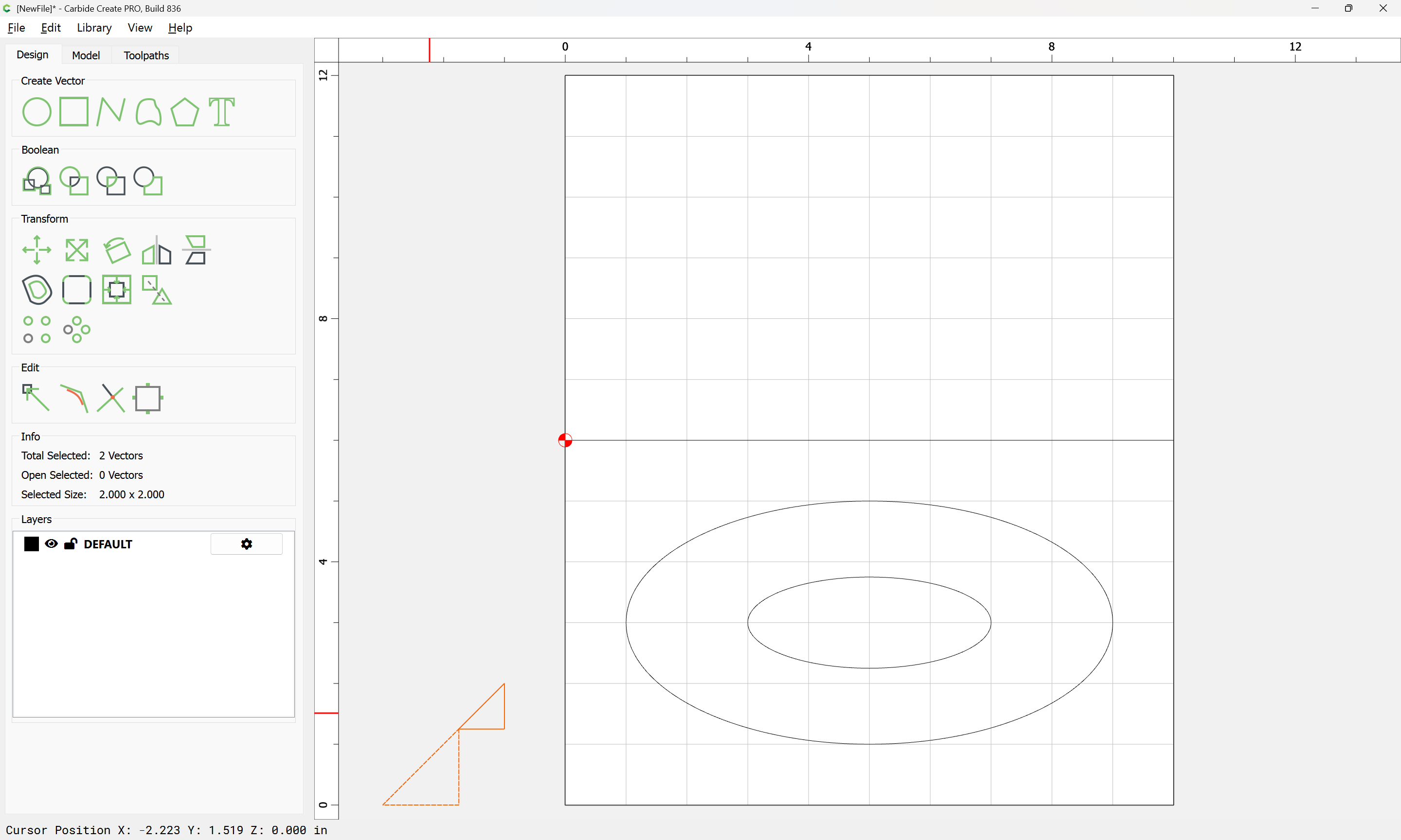

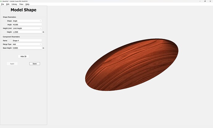

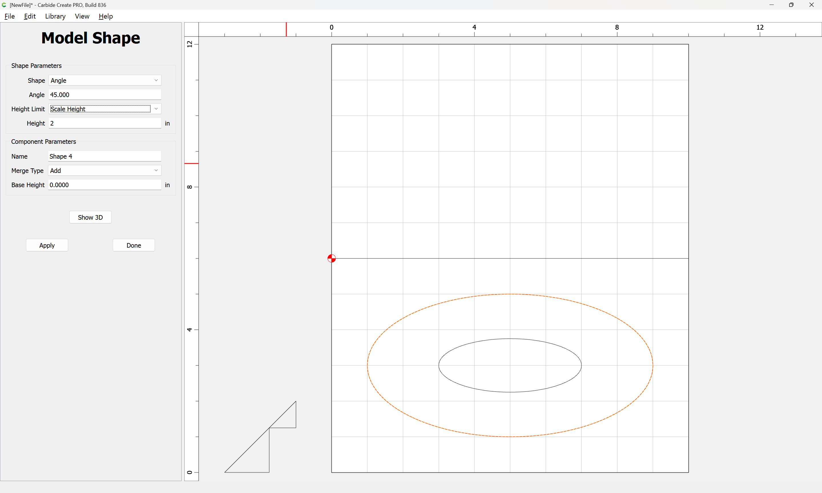

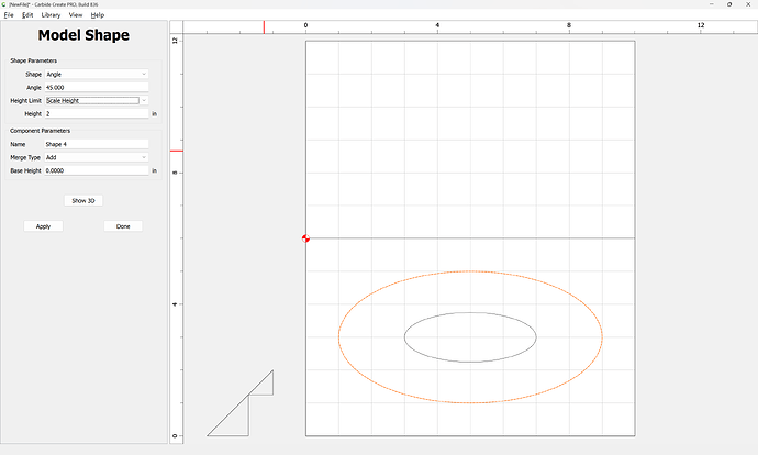

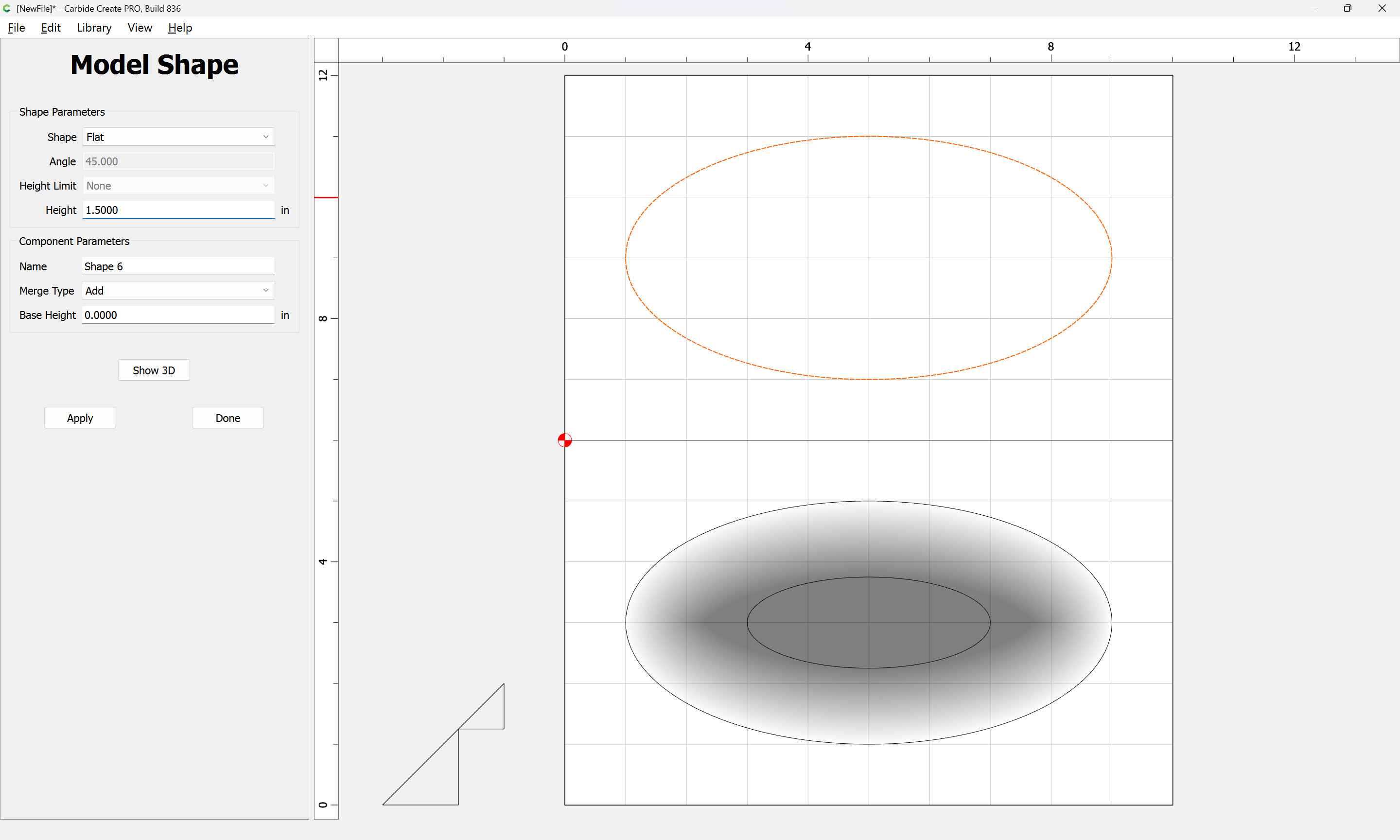

So instead, draw things up in profile:
and model to that height:
Edit the model to match:
(though note that the model no longer matches the specified dimension)
WillAdams
3

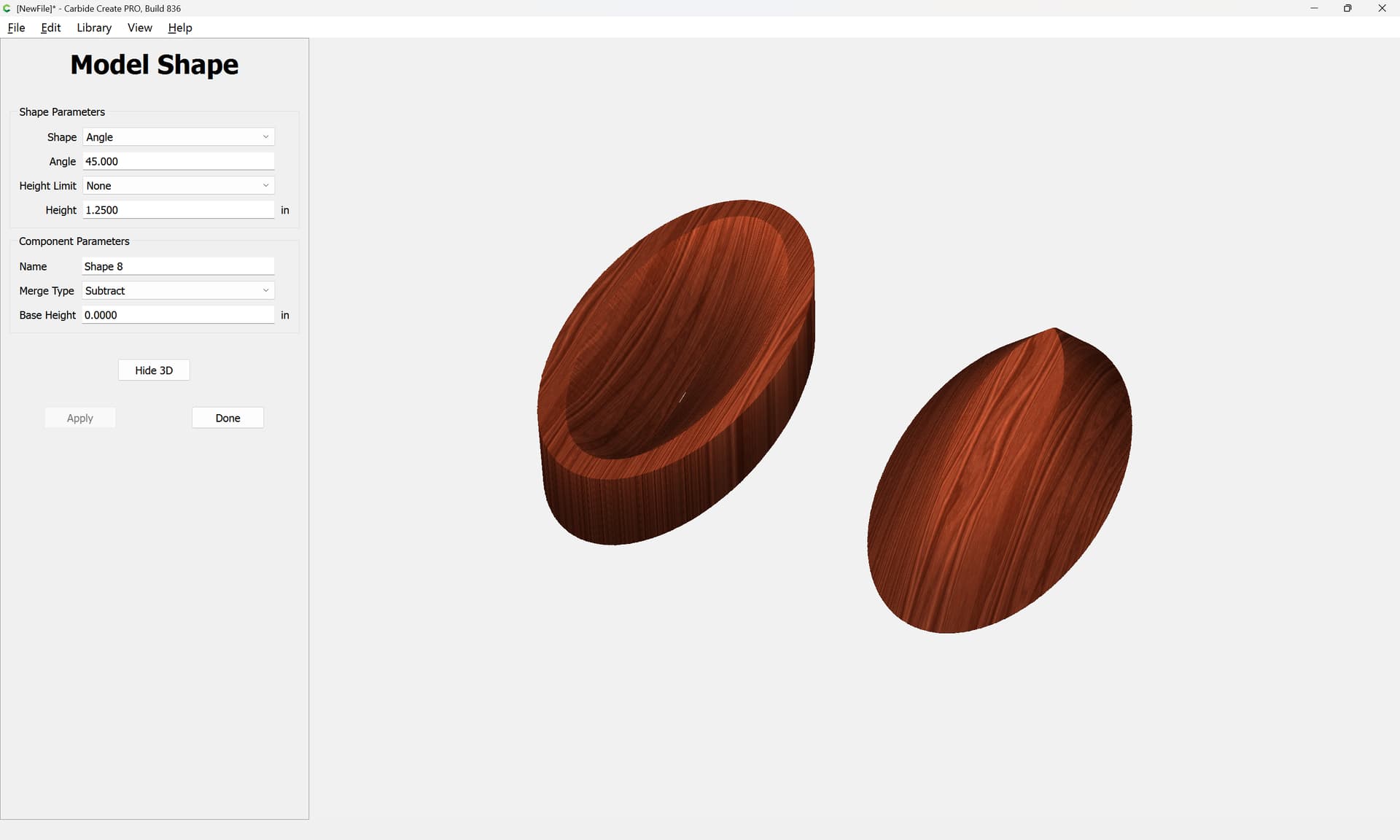

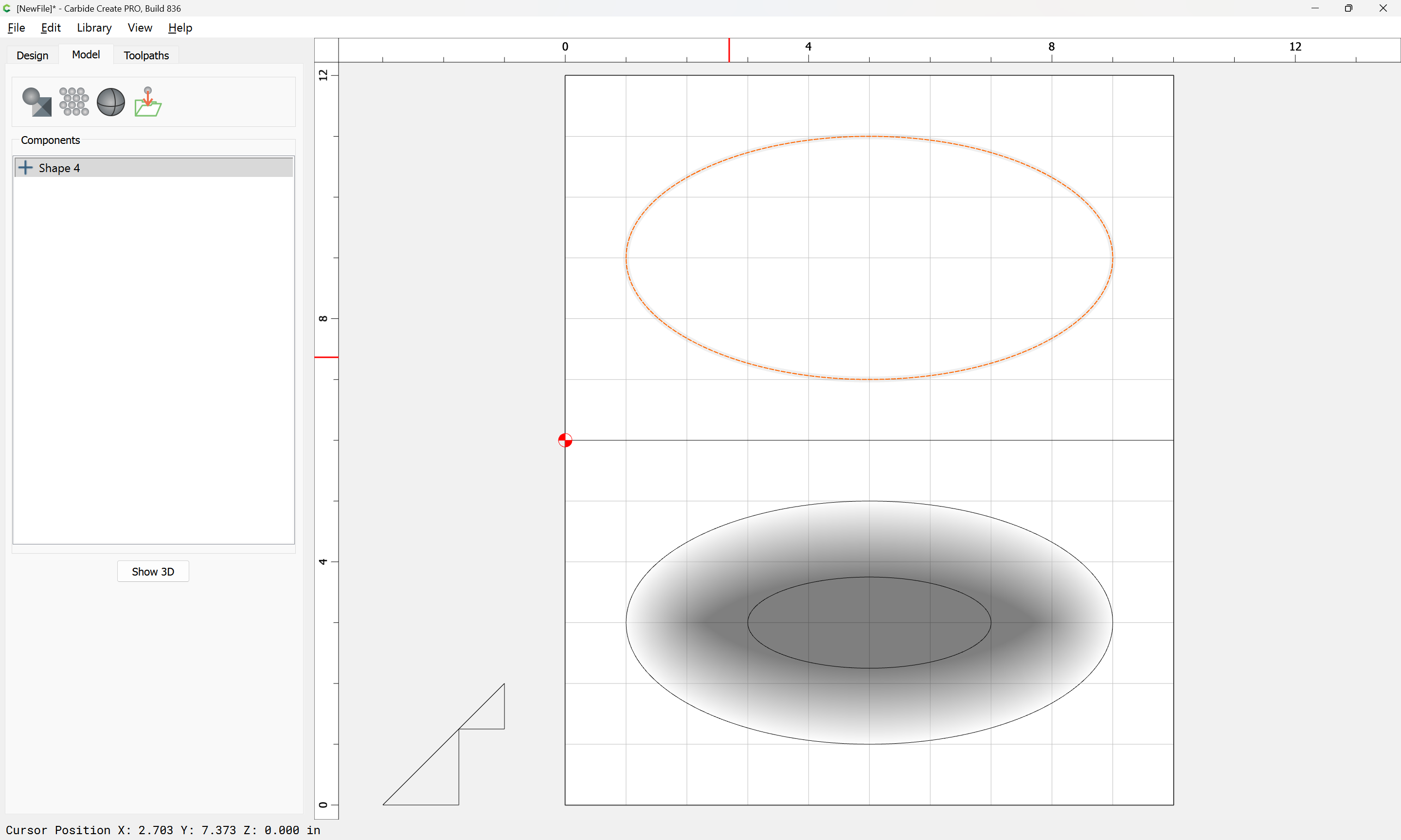

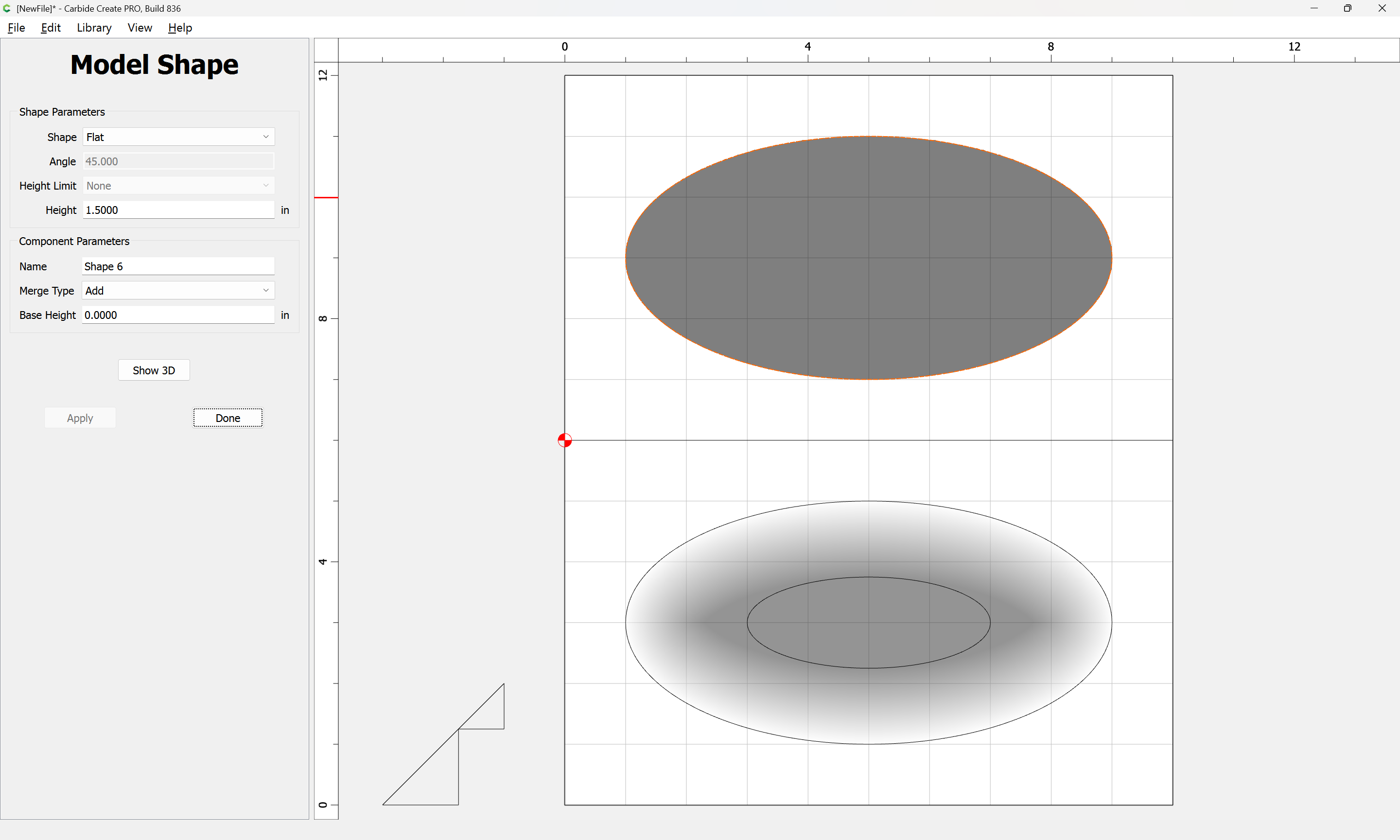

Copy the perimeter outline into the top half:
and model to the full height:
Apply

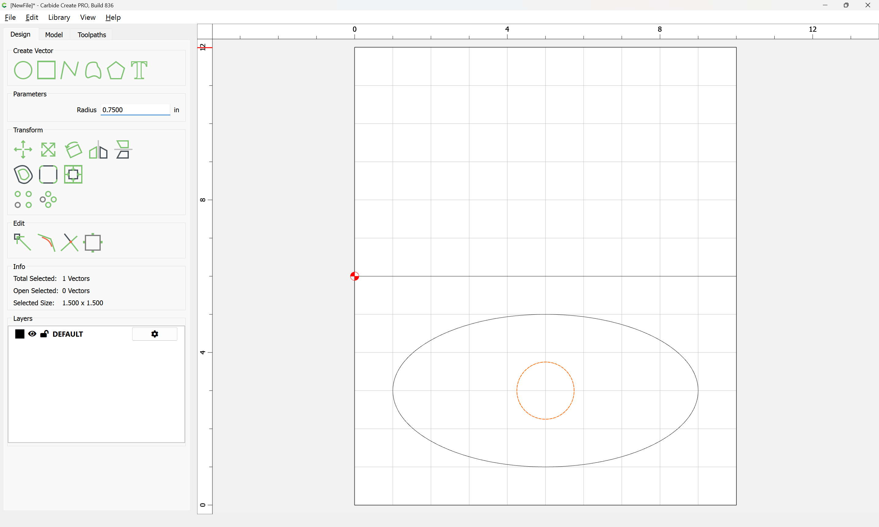

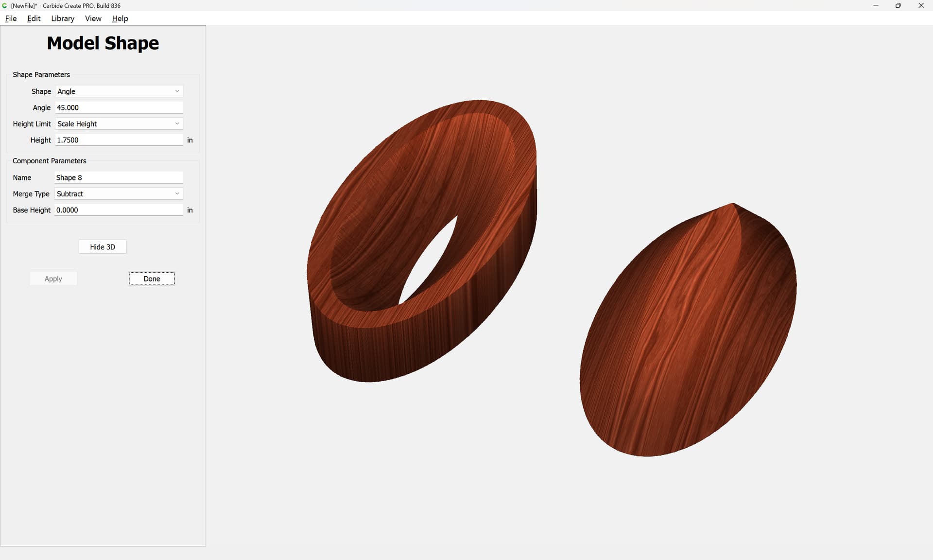

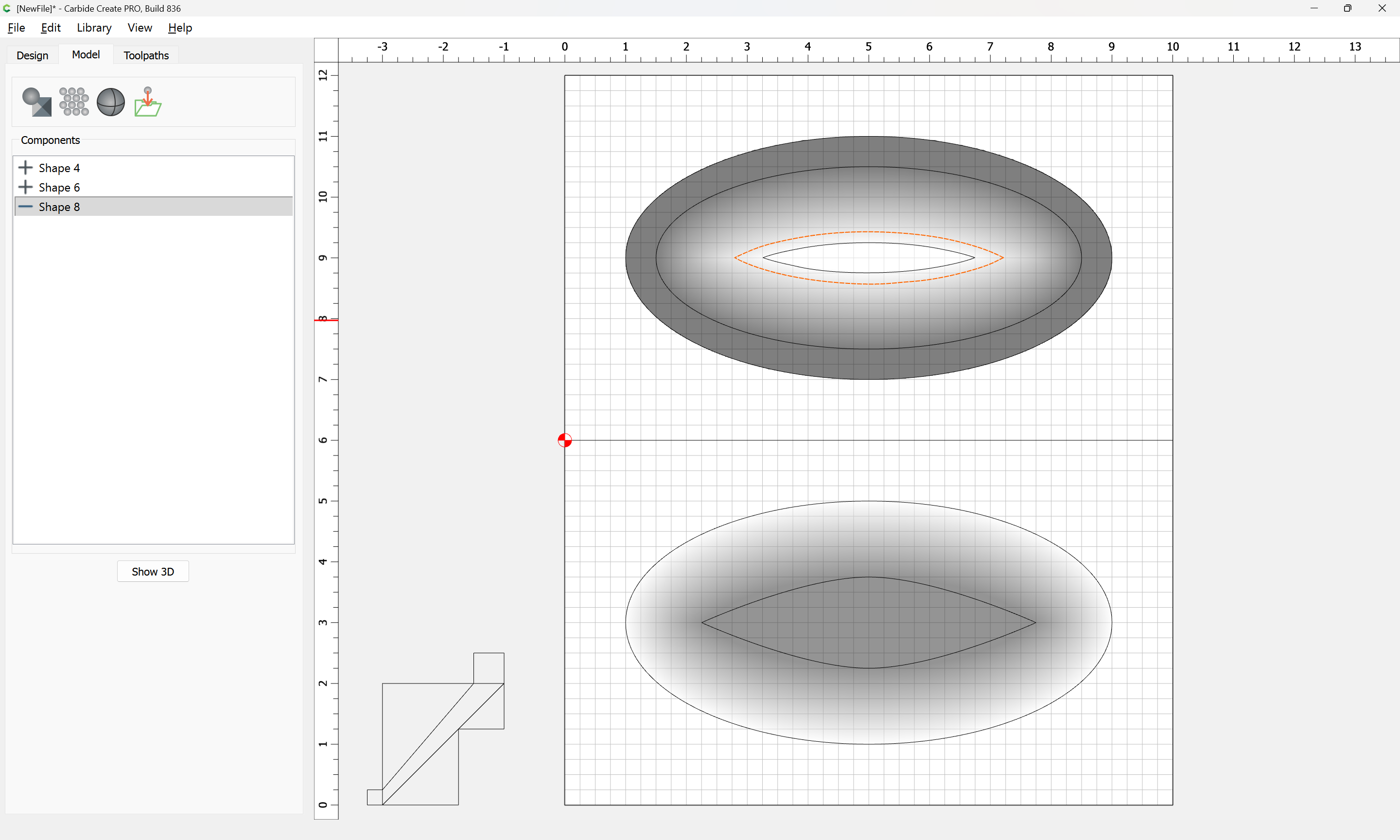

Then draw the inner perimeter:

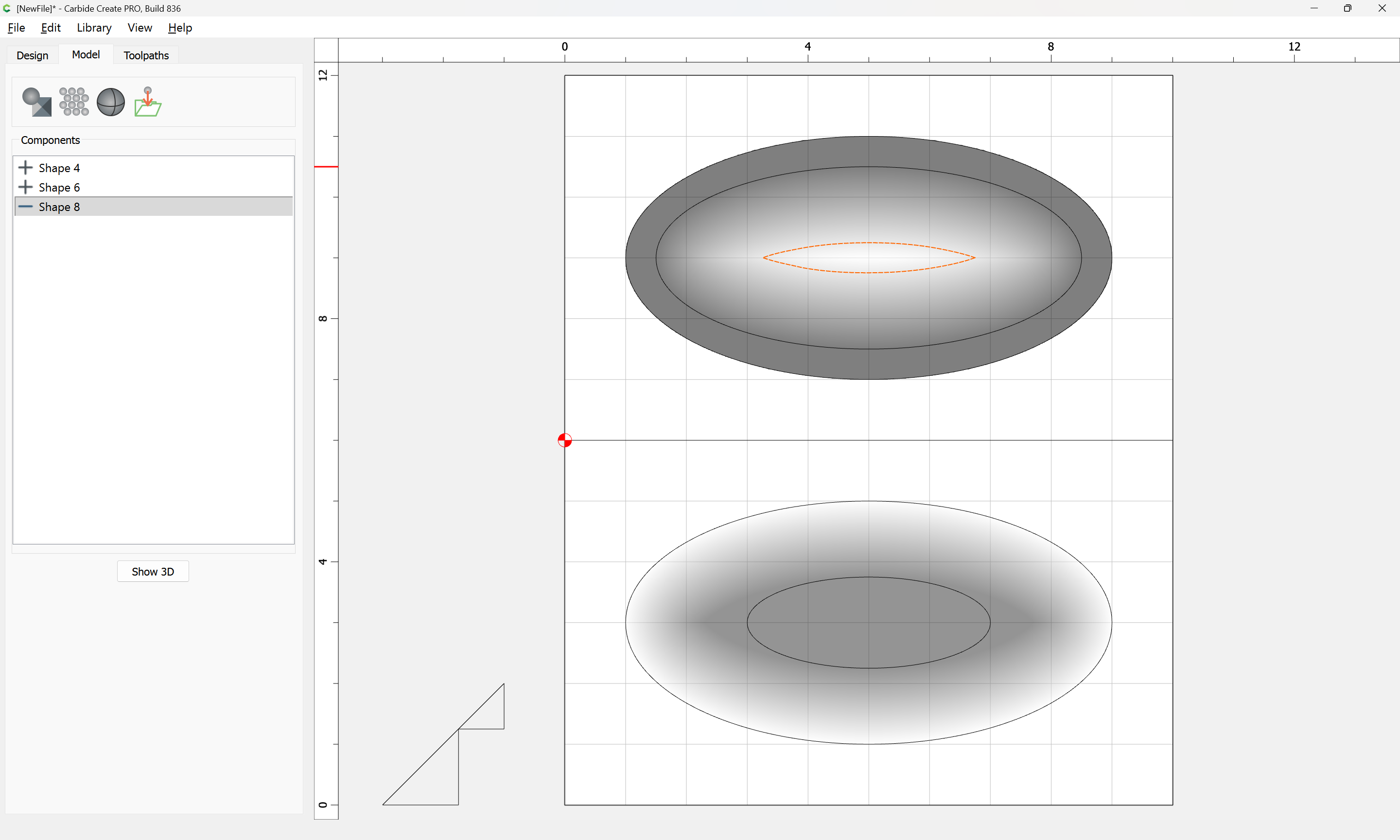

Then use this geometry to try to model the interior of the bowl:
and check where the model is:
and adjust based on that.
WillAdams
4

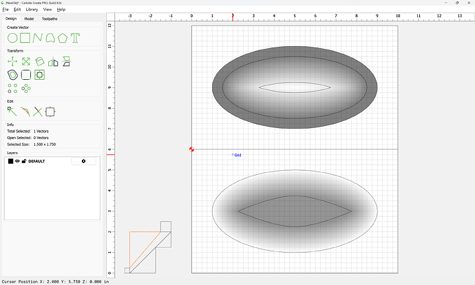

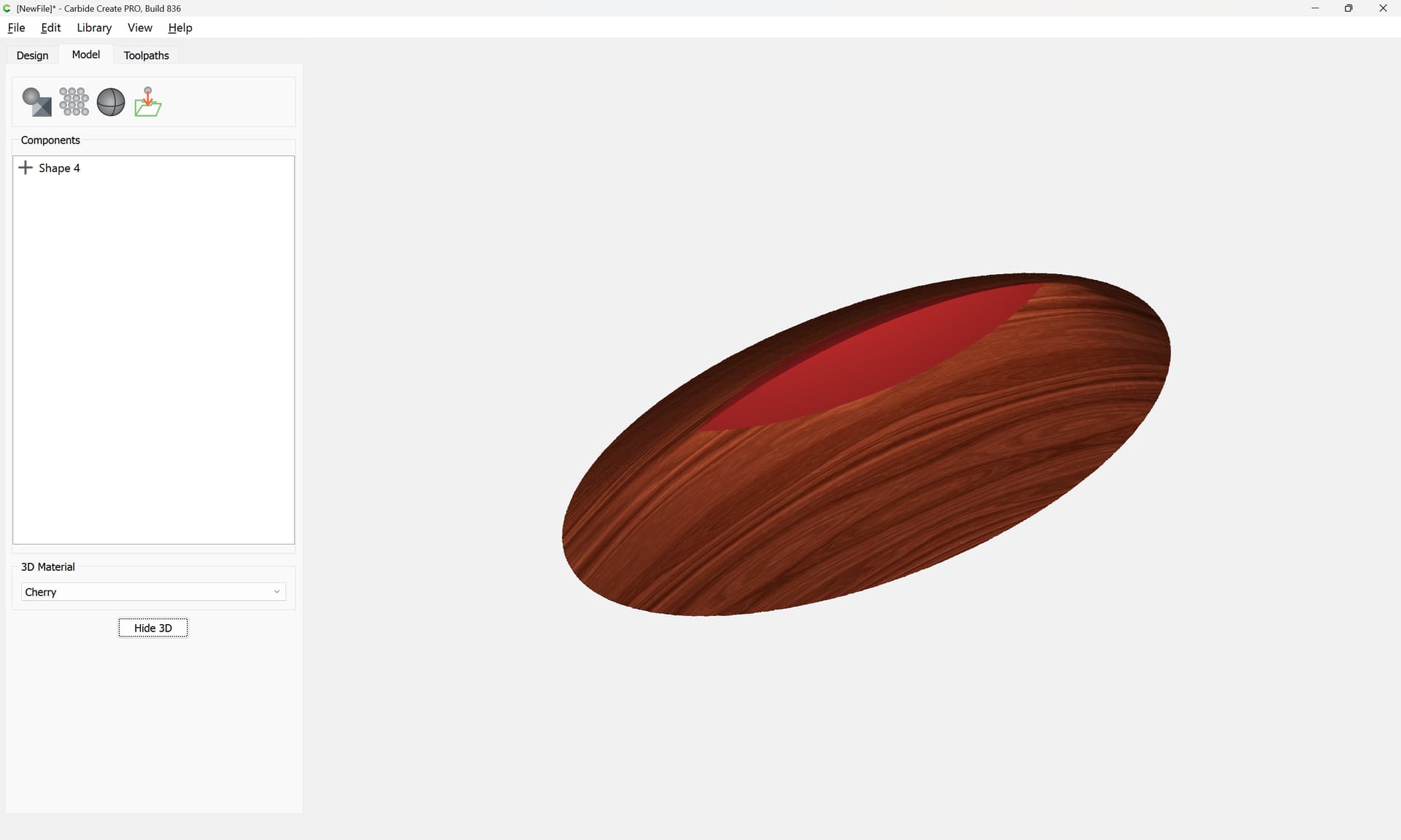

Drawing up in profile we get:
Adjusting a bit:
then tracing we get:
which looks to fit within the outline.
Then model this as an equal thickness:
Attached as a v8 file.
