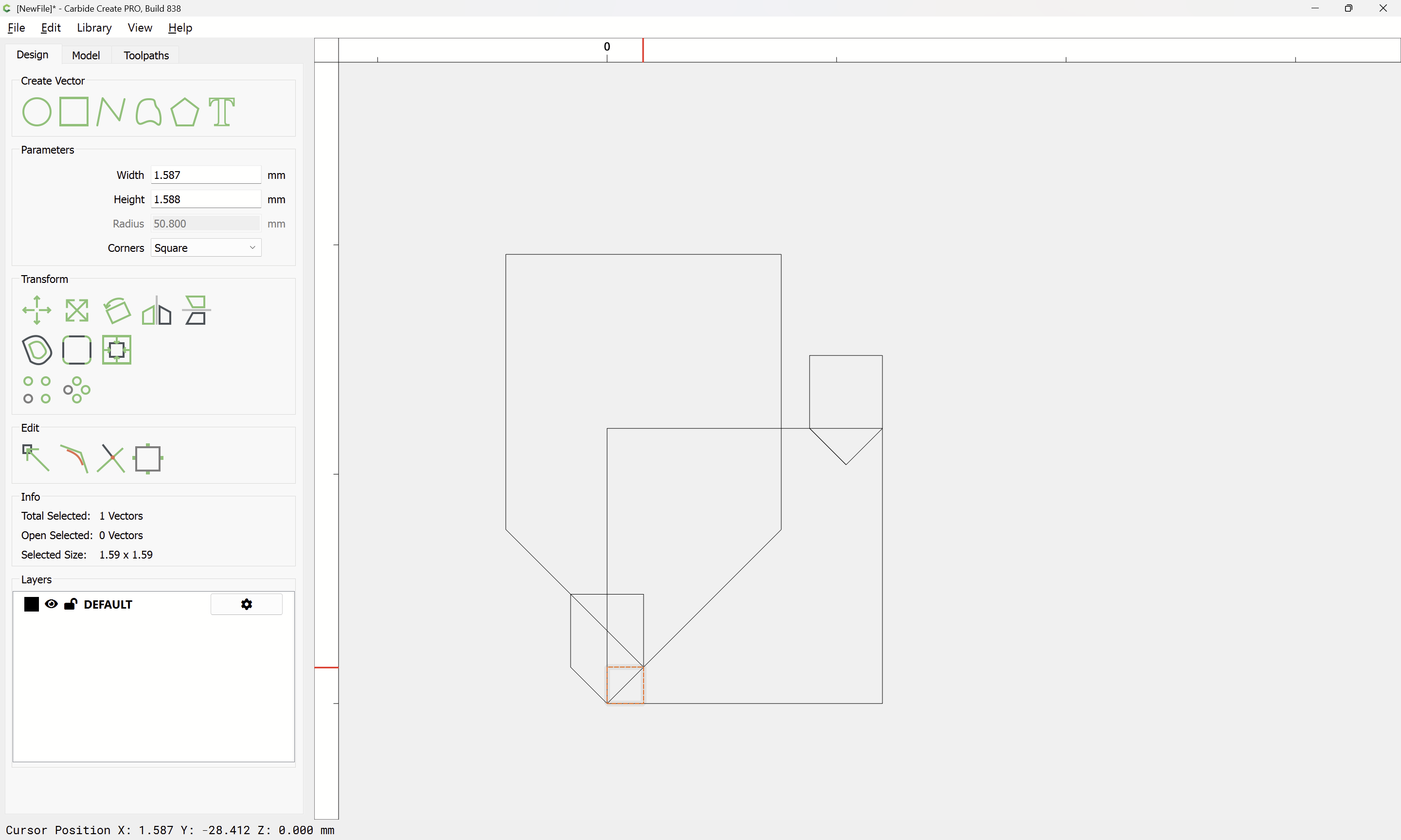

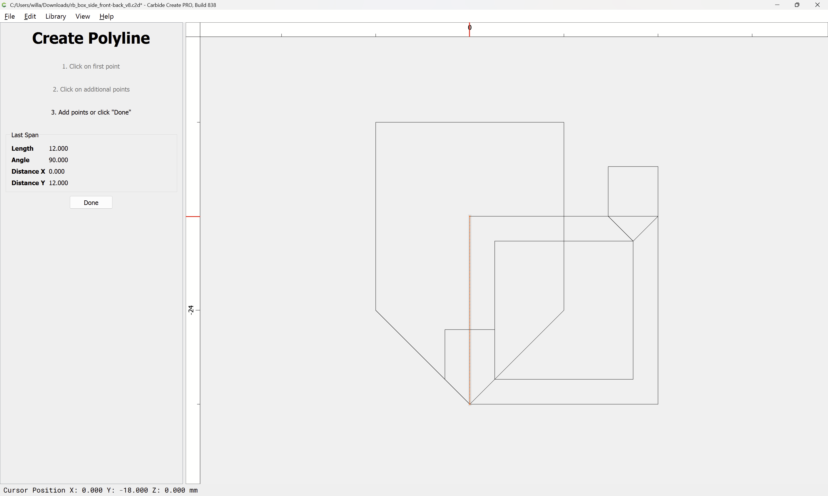

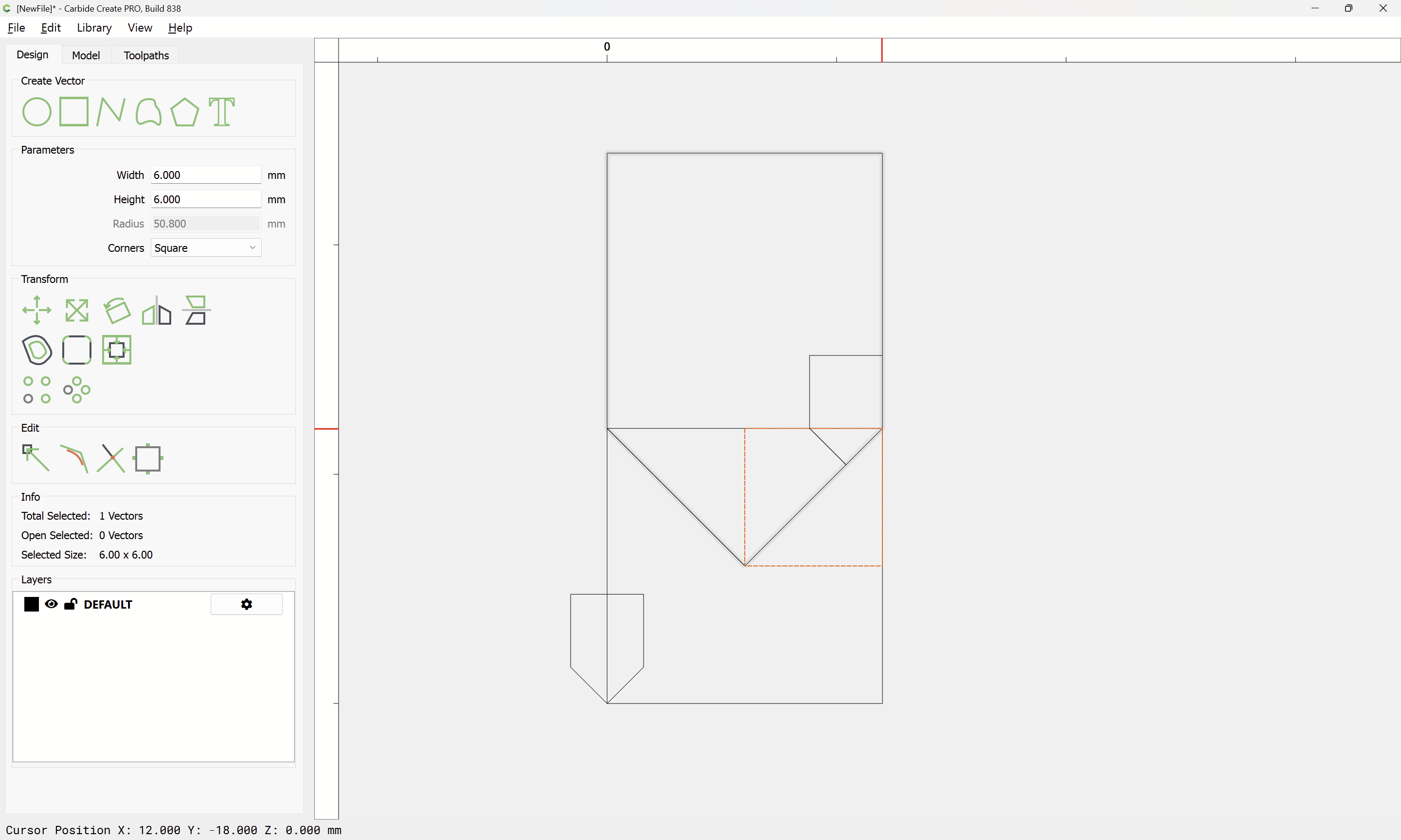

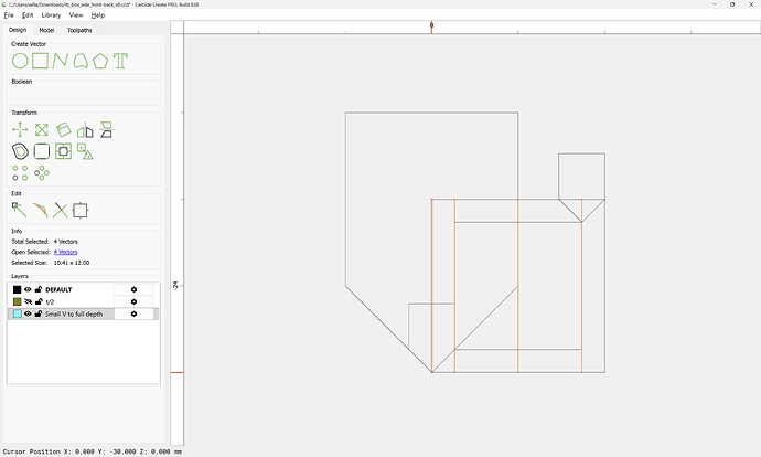

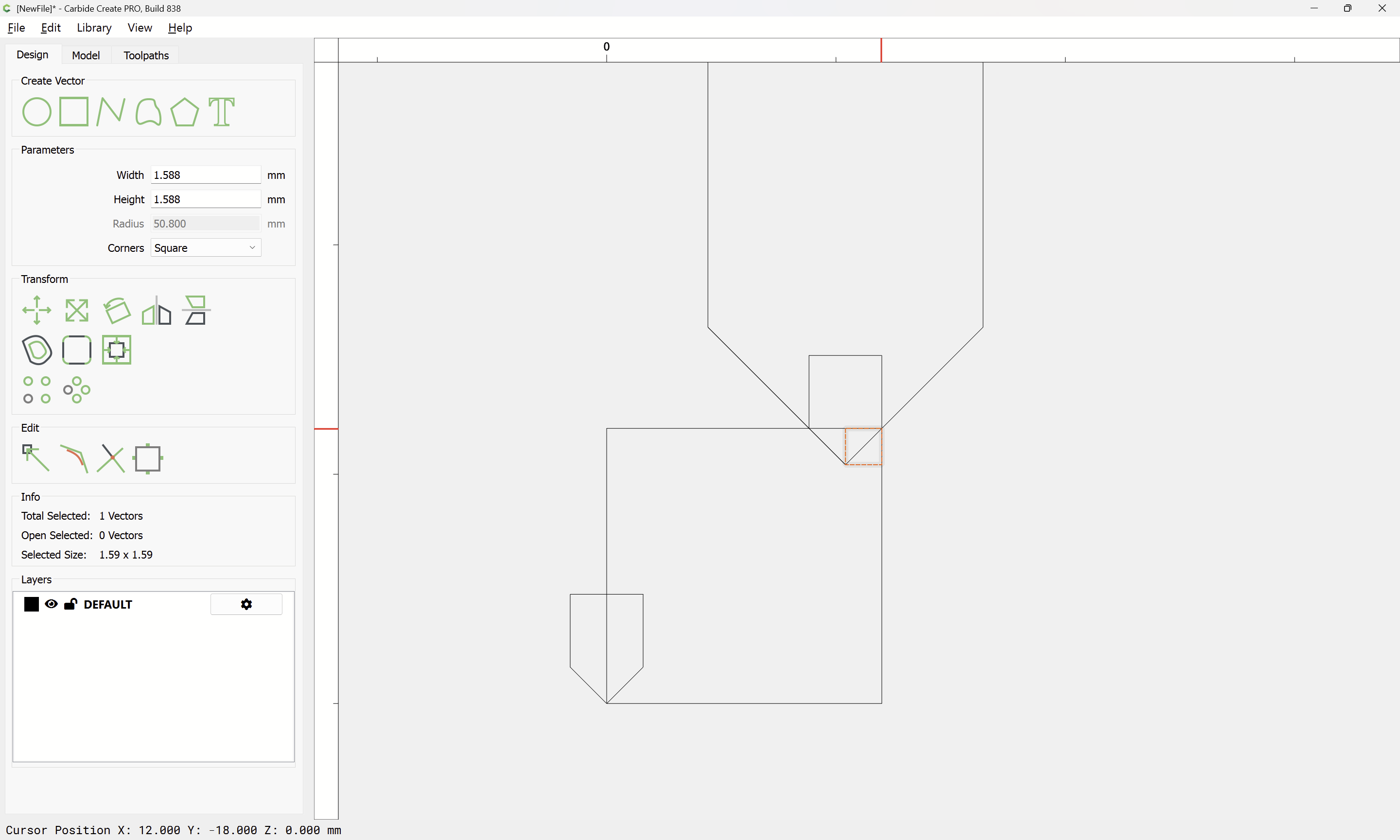

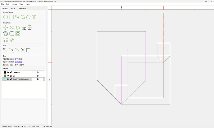

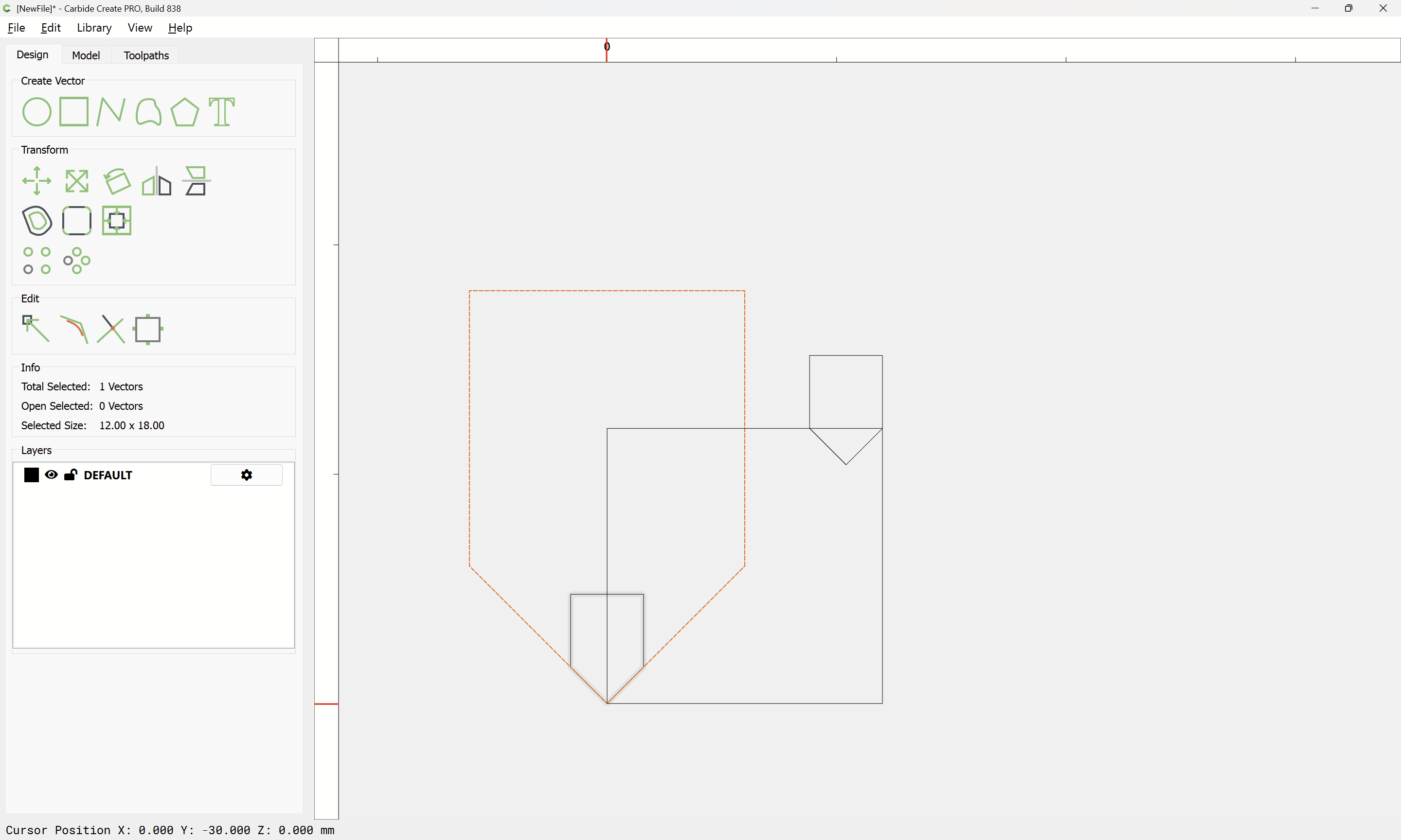

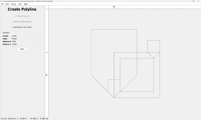

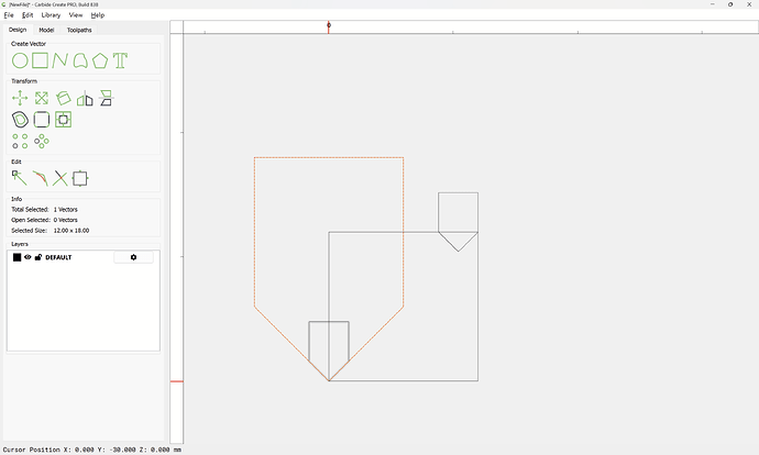

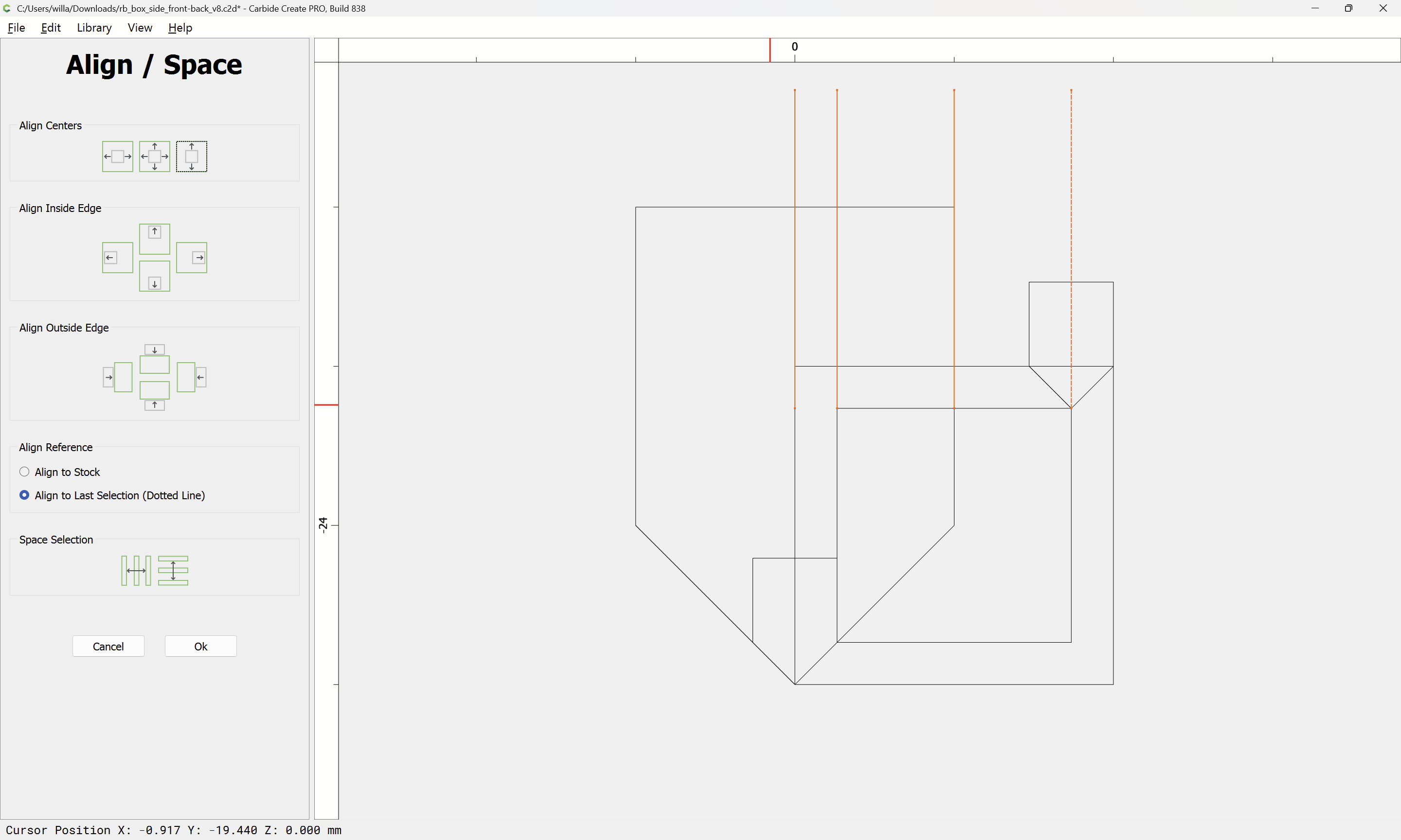

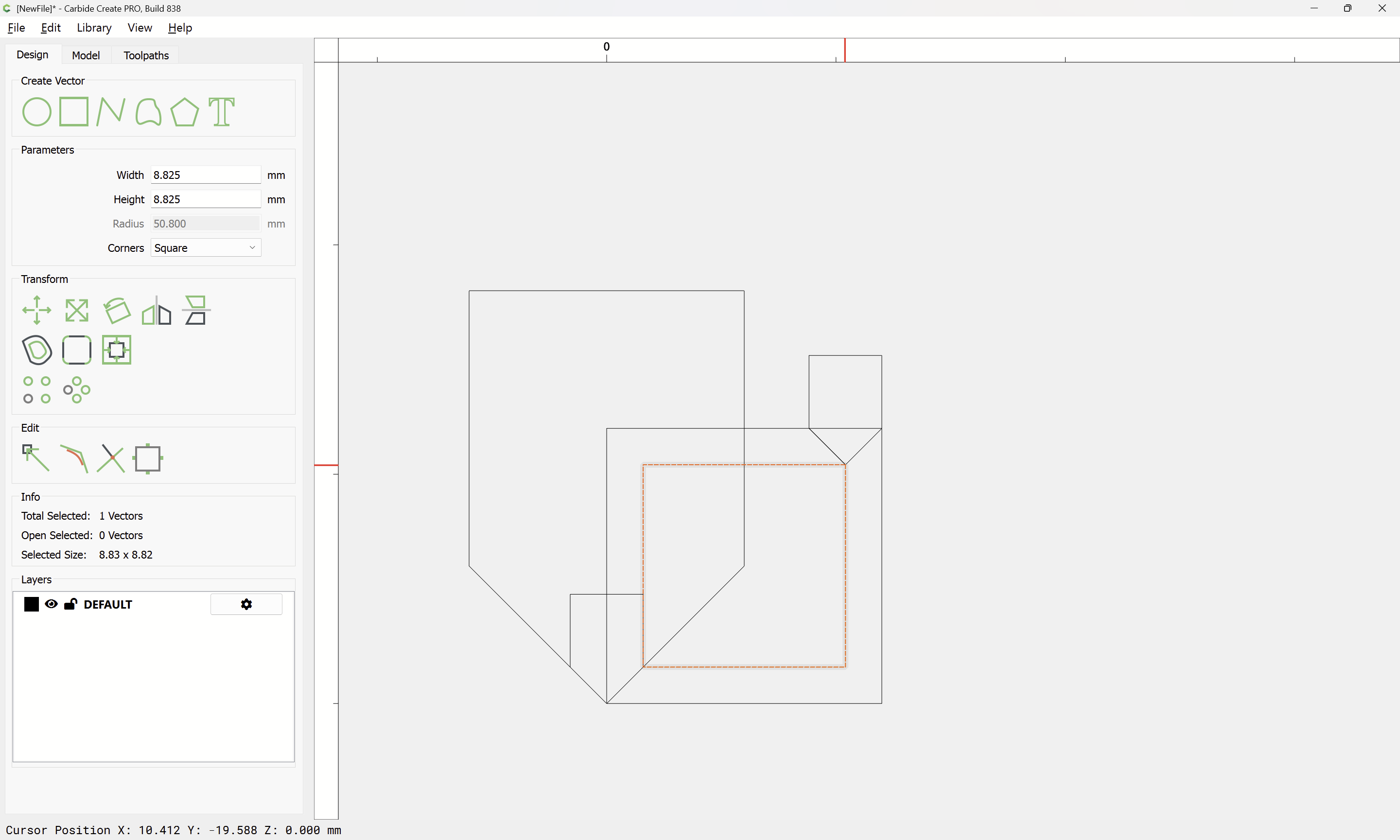

As per usual, we start by drawing the cut/tool in profile.
The joinery will be the full-blind box-joint style which folks have done various versions of for a while now.
The tool is rather small relative to the (un-cut-in-half) stock, and making multiple passes with the V tool helps with the geometry. Doubling the 6mm cutting depth of the tool seems a reasonable compromise, and it should be easy for the reader to increase the number of passes if desired.
To ensure a reasonable overlap, and to make calculations simpler, 4 passes will be made:
One at the top, inset in and down by half the diameter of the small 1/8" V endmill which will be used:
a second at the half-way mark both in and down:
a third at the top edge of where the V endmill will cut:
and a final pass at the bottom:

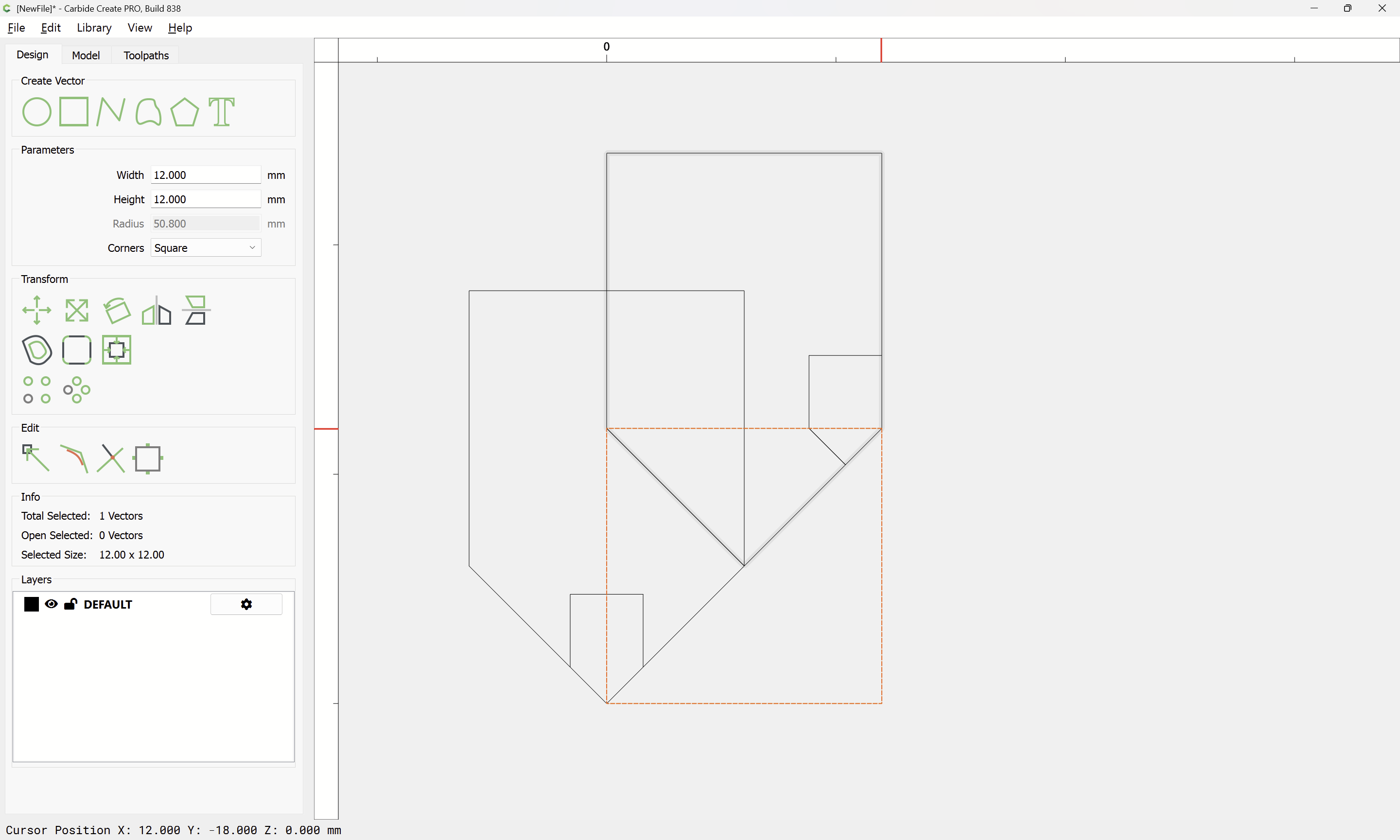

The box joints will be defined by the Stock Thickness, 12mm:
and the radius of the small V endmill making passes at top and bottom:

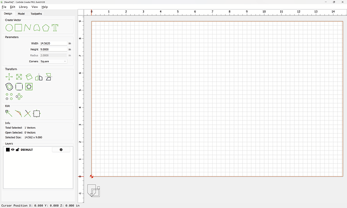

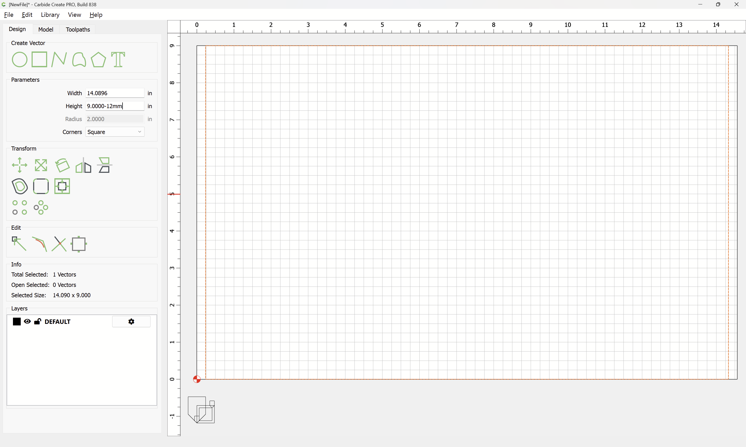

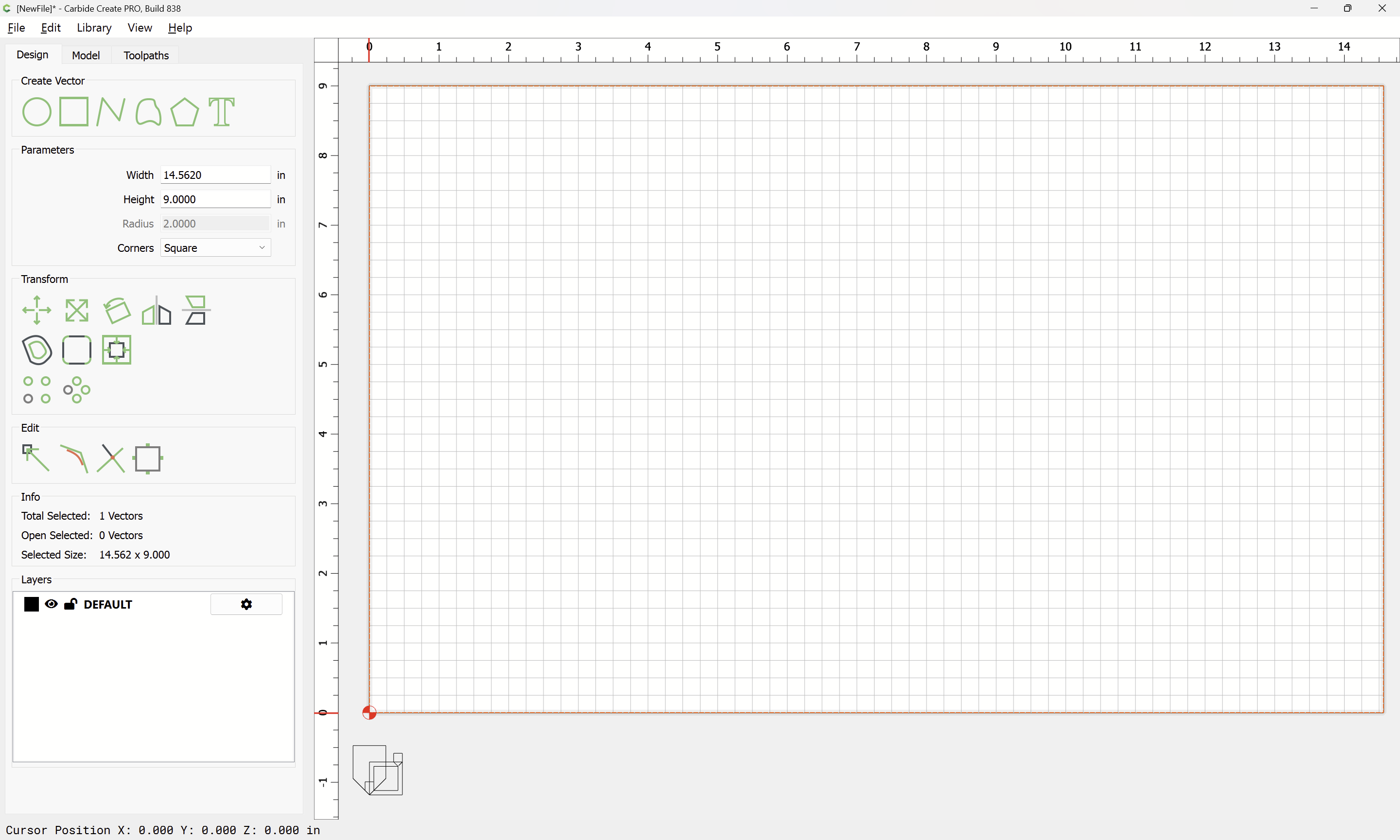

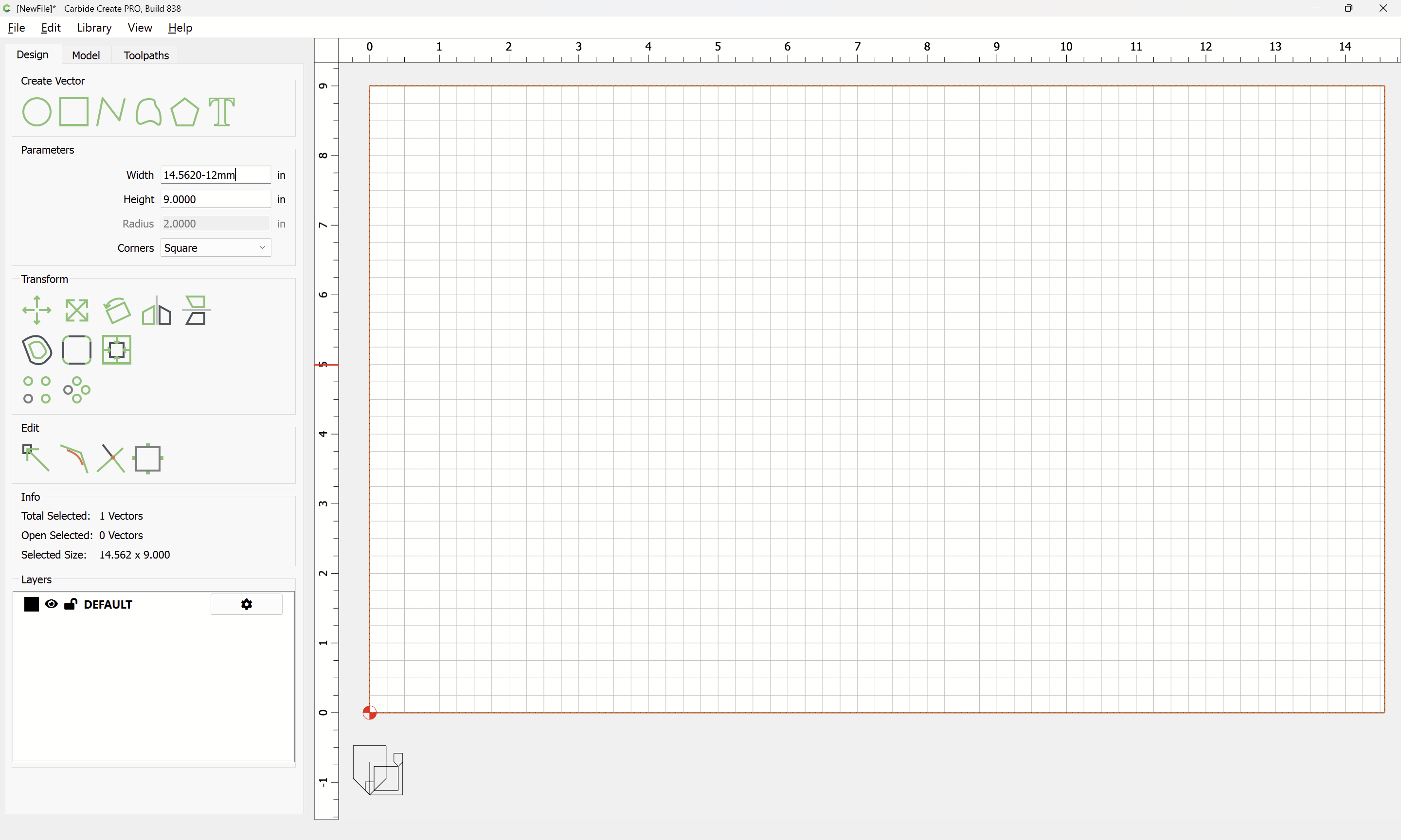

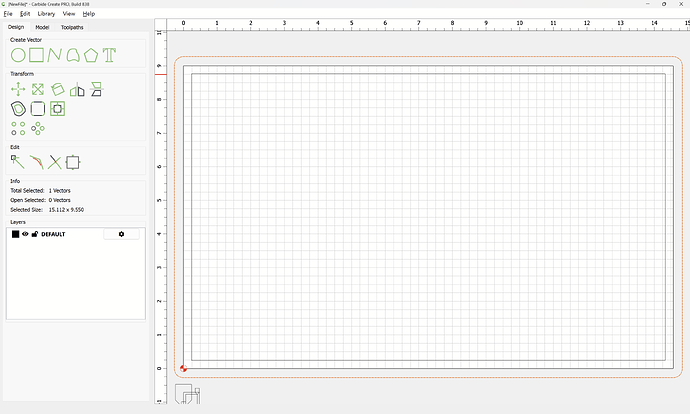

The next consideration are the overall box dimensions — the notable limit is the 9.5" of the stock to be used for the lid.
Setting a bit less than that (9") as the Y-depth dimension for the box, and using the golden ratio, we arrive at dimensions of:
  • Z (height): 5.562"
  • Y (depth): 9"
  • X (width): 14.562"
and as noted before the Stock Thickness is 12mm, a bit less than half an inch, which should yield a reasonable proportion and not too weighty object.
If the box has an inset/removable lid, then it will have 6mm showing, and a rebate/rabbet of 6mm, so the actual Z height is 5.562" - 6mm

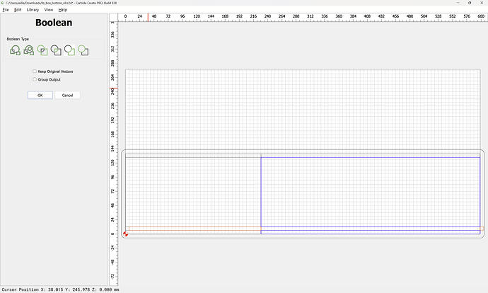

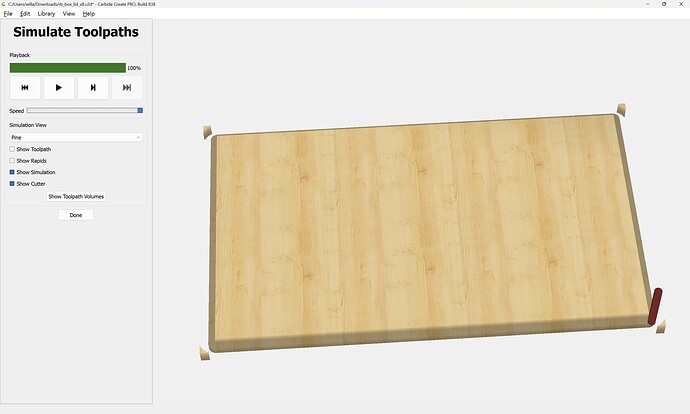

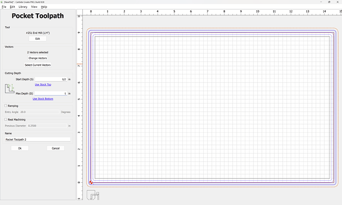

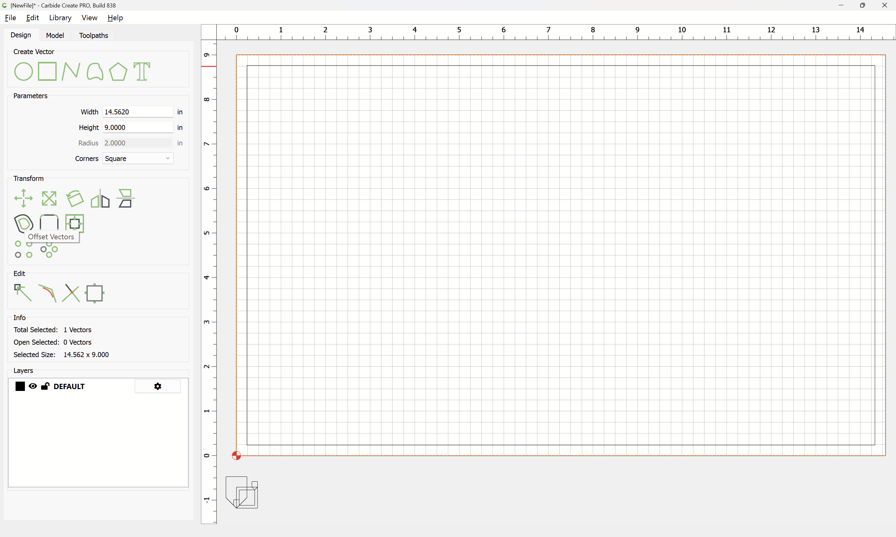

The lid is the easiest part to draw up, but probably should be cut last, after the box is fully cut out and glued up and cured — that way, the rabbet for the lid can be cut, the box test fit against it, then the dimensions adjusted until the desired fit is arrived at, this process may then be repeated for the outside dimensions of the lid to ensure that they match the box well.

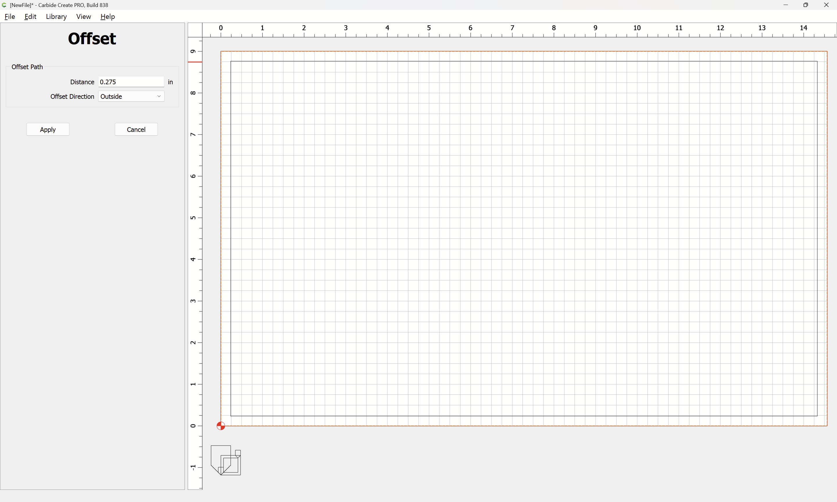

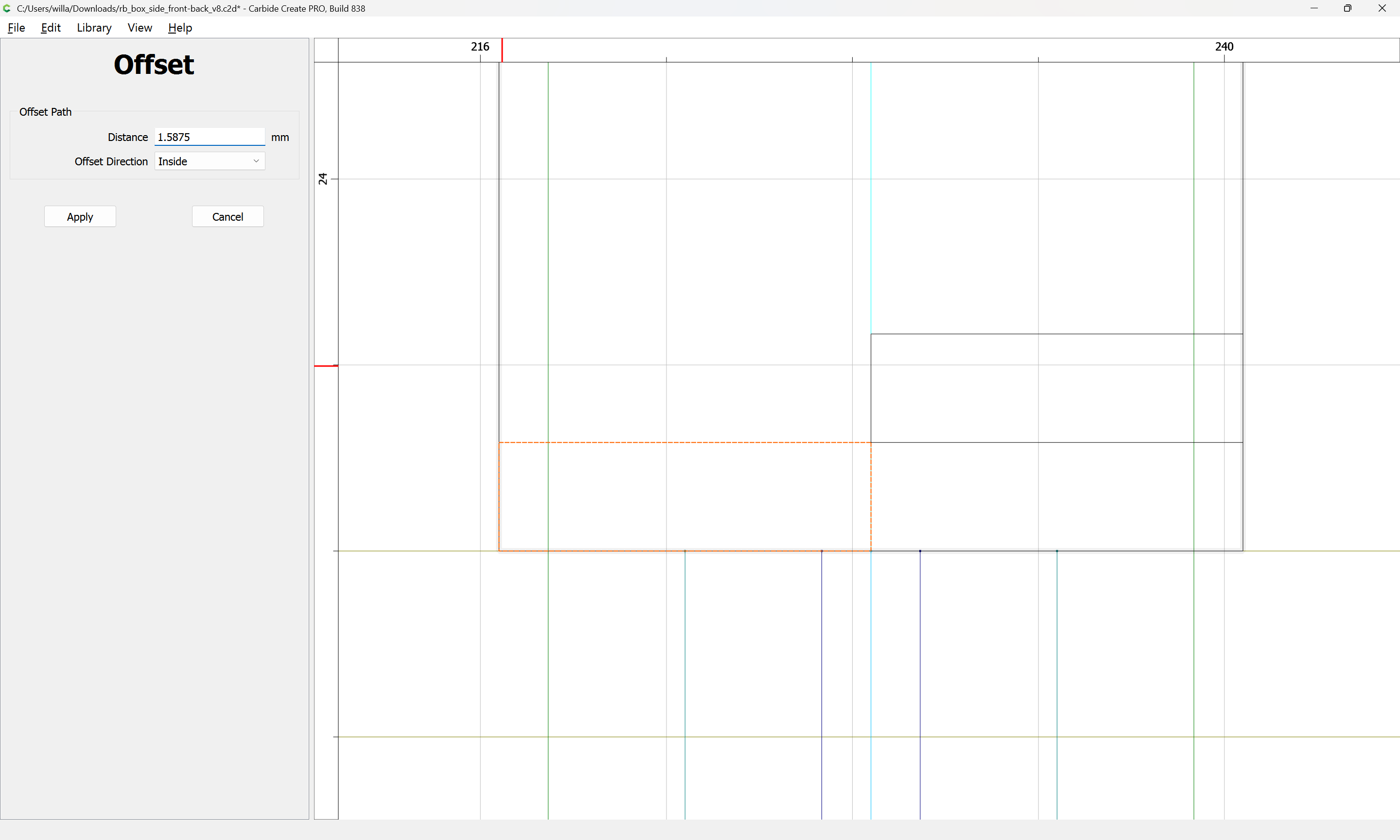

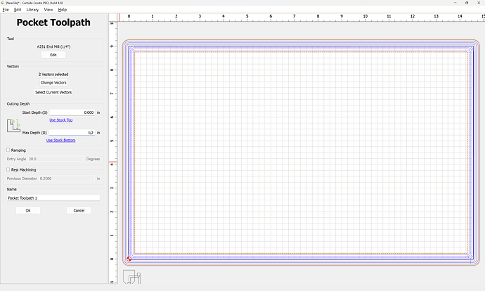

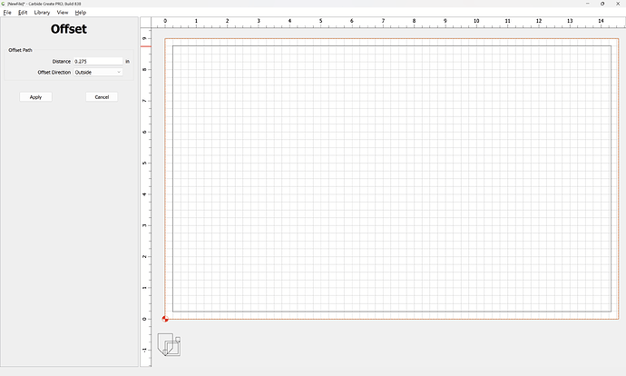

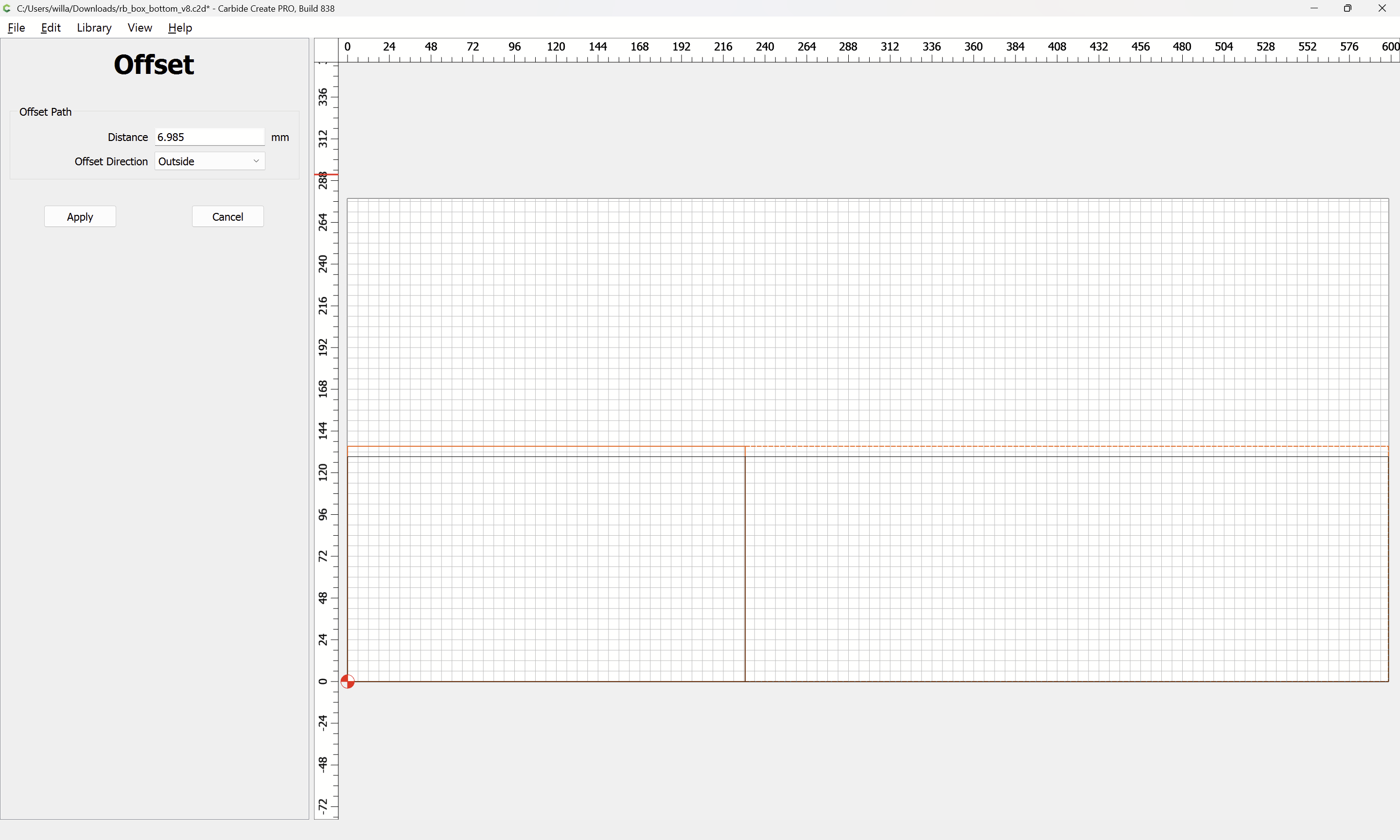

Offset to the outside by endmill diameter plus 10%:
which previews as:
Naturally, it may be set up as a two-sided part and a decorative design for the lid cut on the opposite side, and as noted, the dimensions will need to be adjusted so that the initial cut ensures that the parts are slightly oversized so that fit may be adjusted.
rb_box_lid_v8.c2d (68 KB)

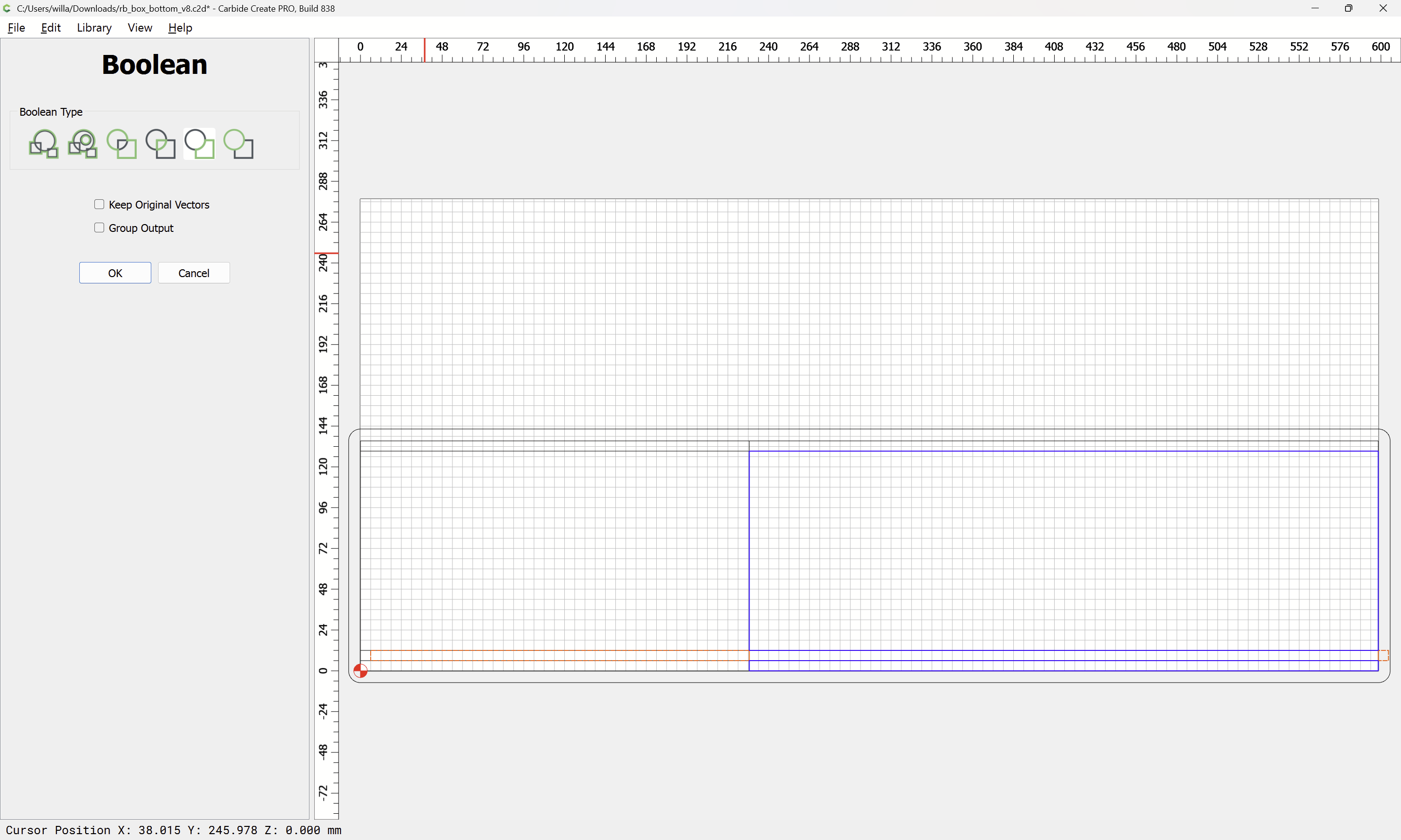

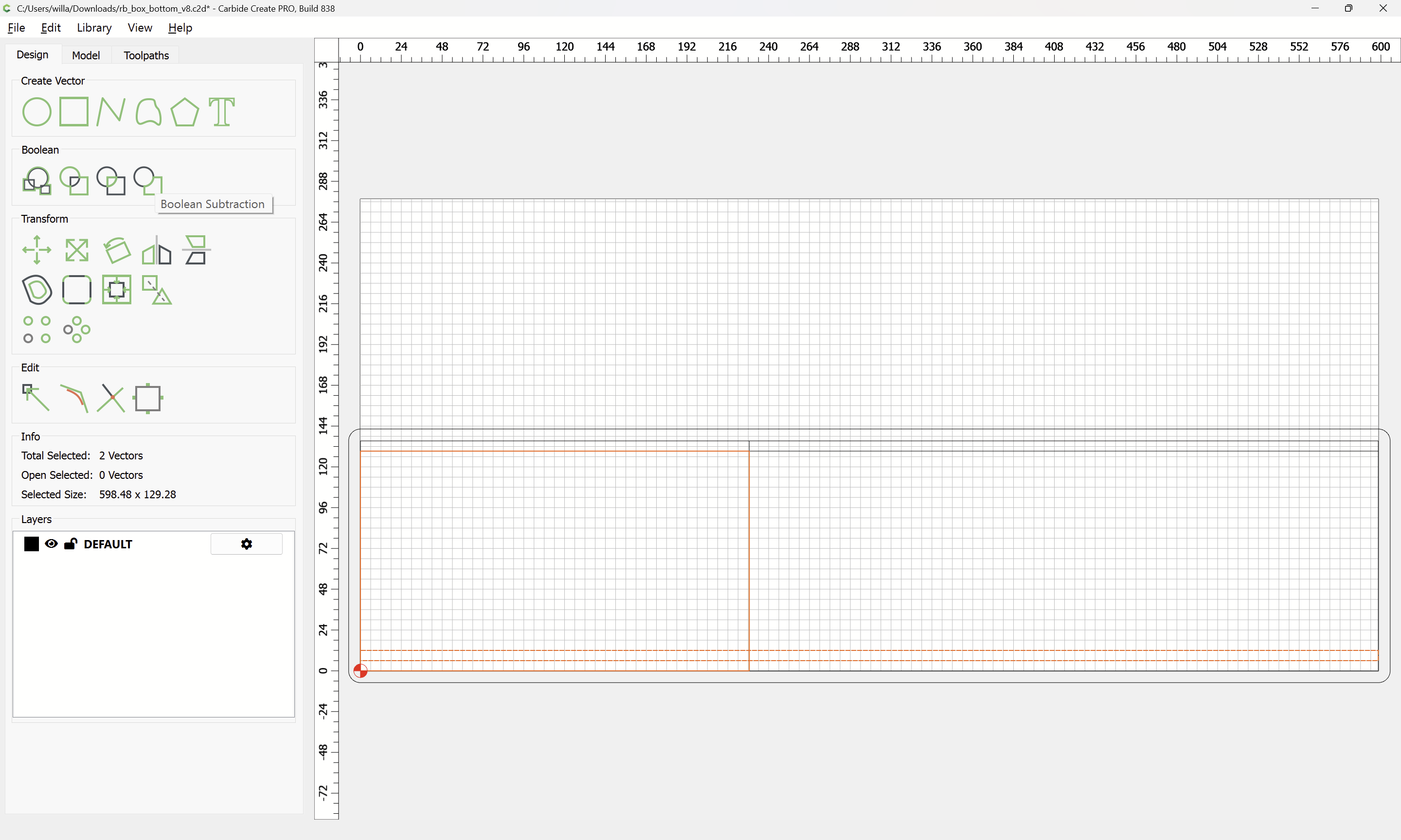

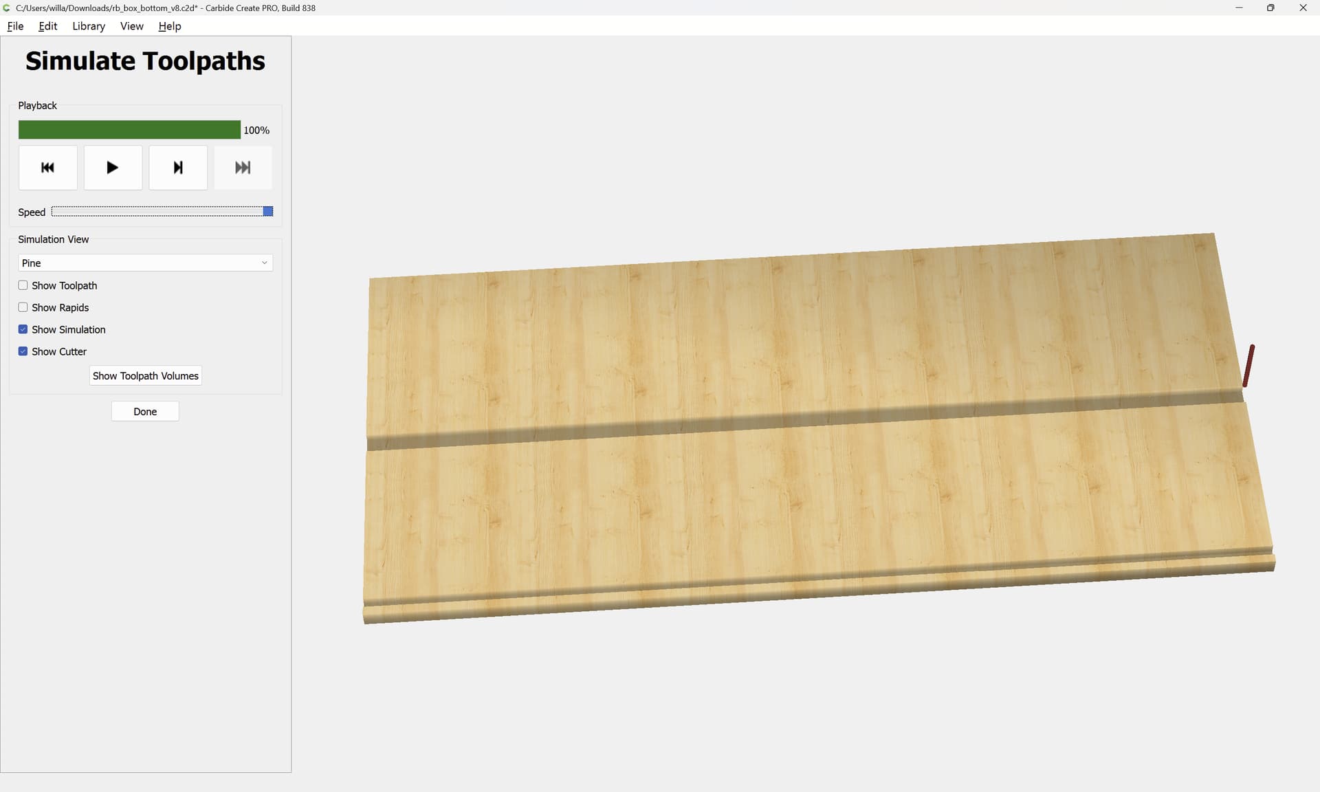

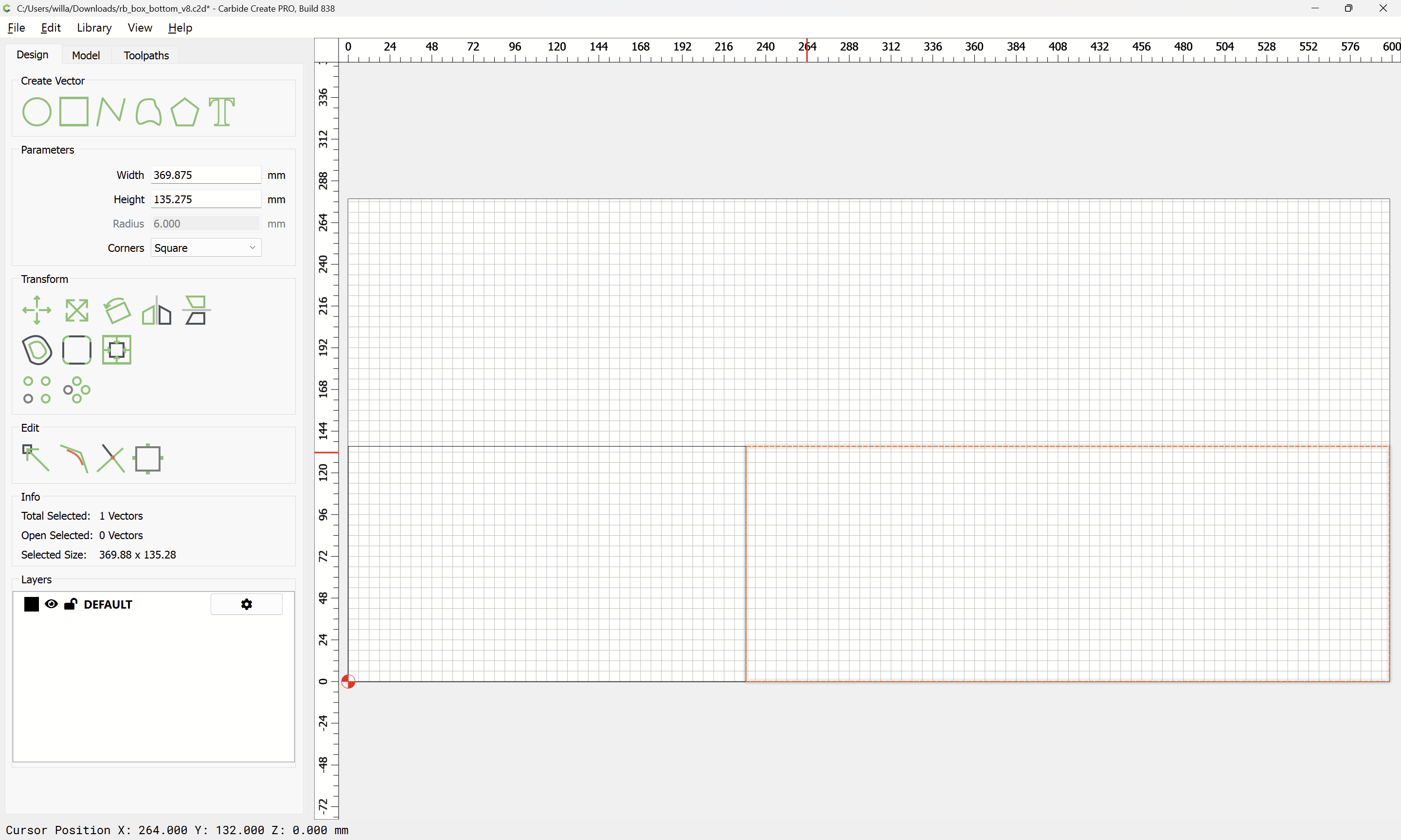

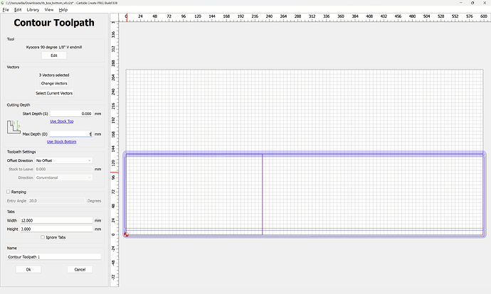

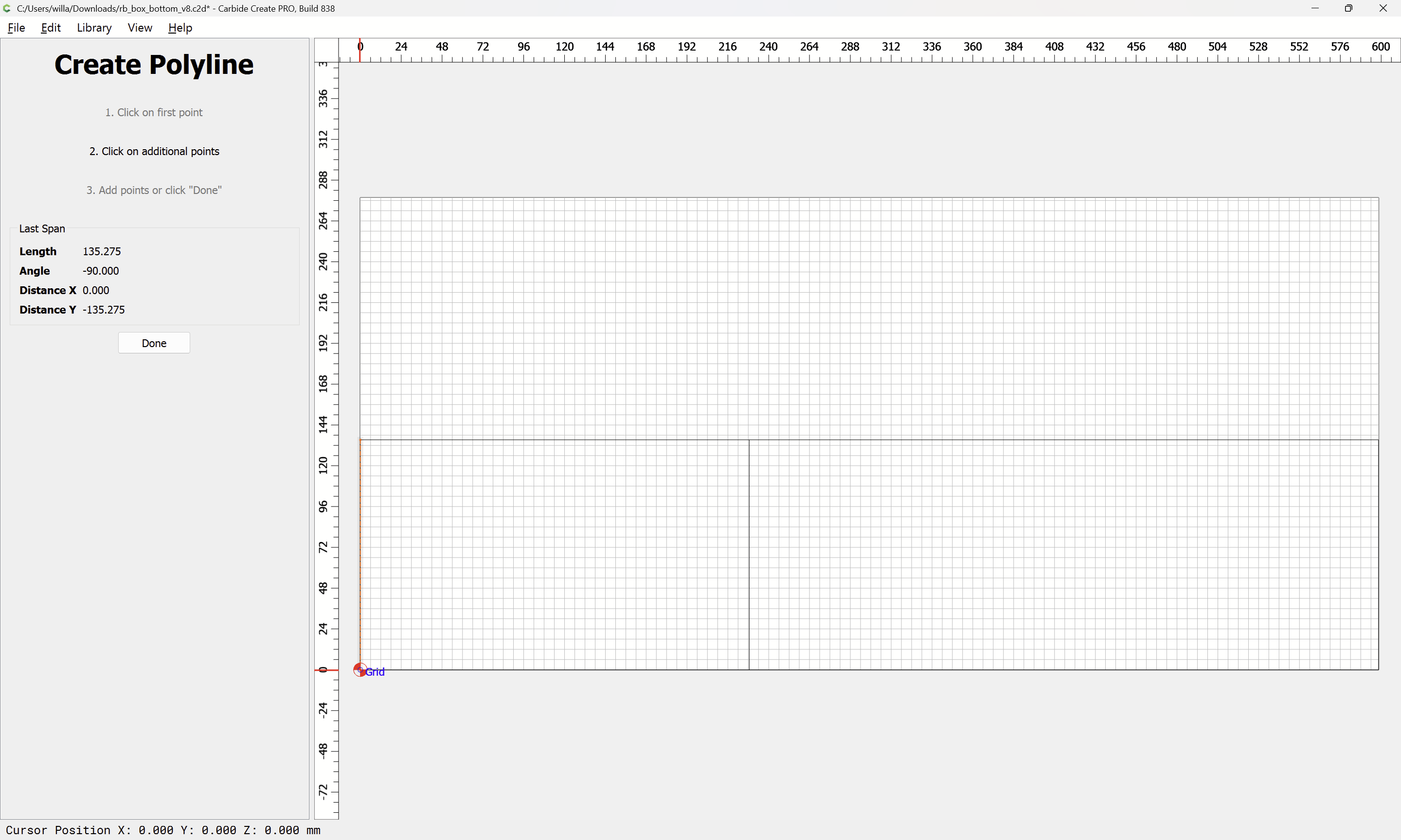

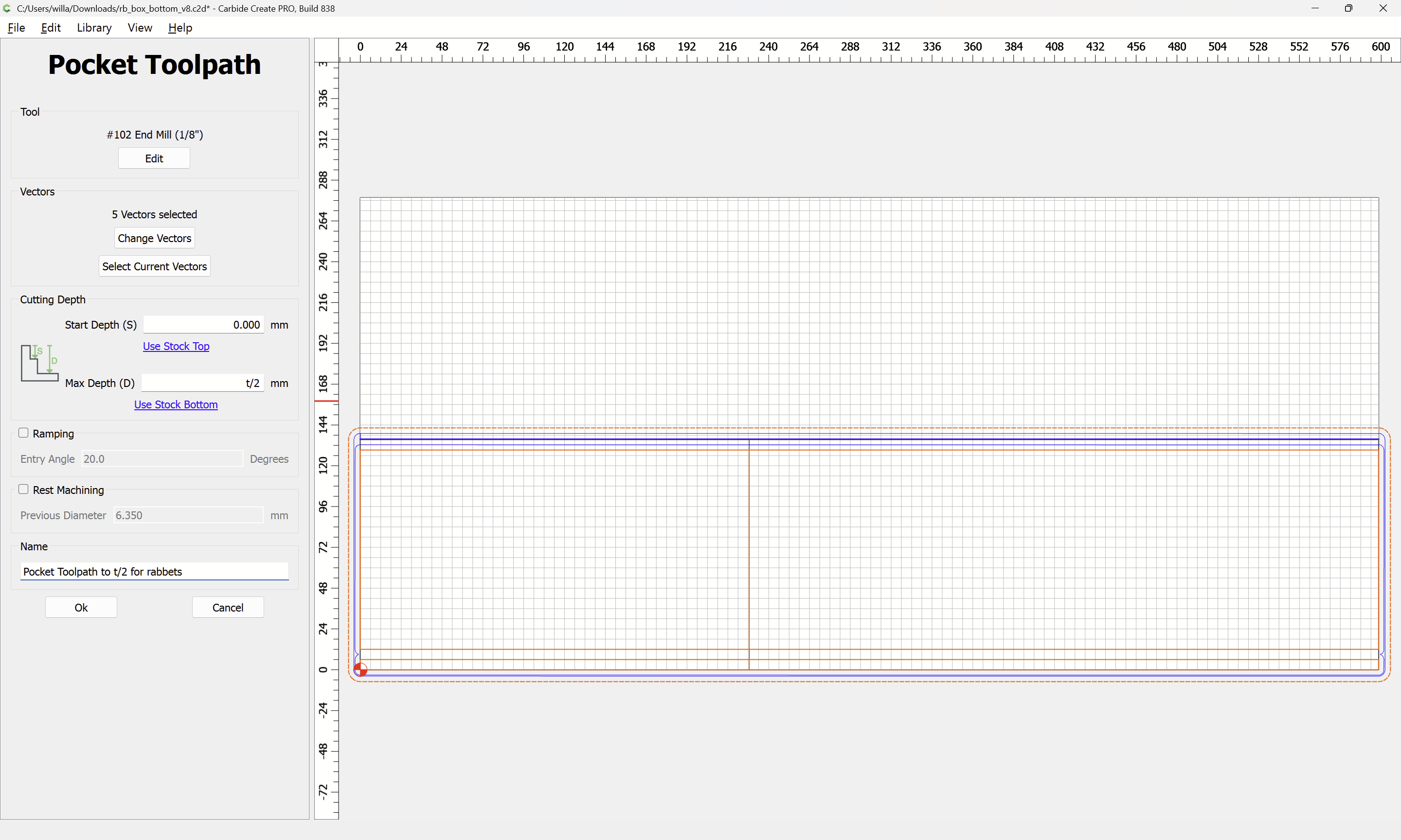

The lid may be used as the basis for the bottom which can be a similar panel inset into grooves of a depth of half the stock thickness. Rather than worrying about the corners, it is most expedient to radius them (if desired, the corners may be filled w/ “Space Balls”, small compressible rubber balls to prevent rattling).
It will be necessary to cut the bottom and fit it into the sides — since it is straight rebates all around, a rabbeting plane would allow quick and easy size adjustment.
rb_box_bottom_v8.c2d (68 KB)

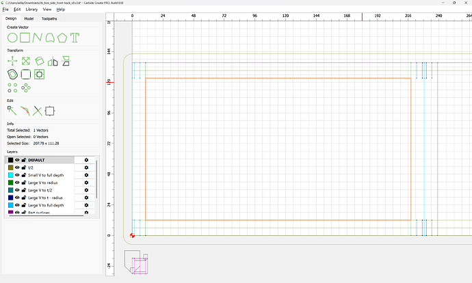

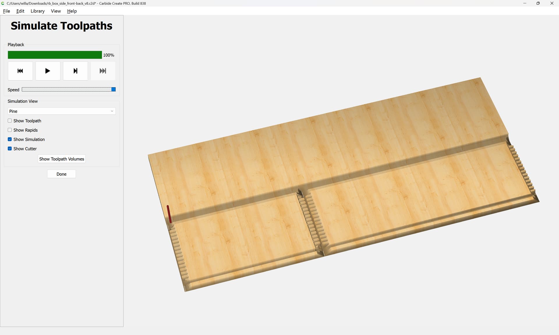

The front/back and the left/right sides are two pairs of parts which could be drawn up as a single pair, but since the stock is so large relative to the height of the box, duplicating the pair and cutting all 4 parts at once will be most efficient.

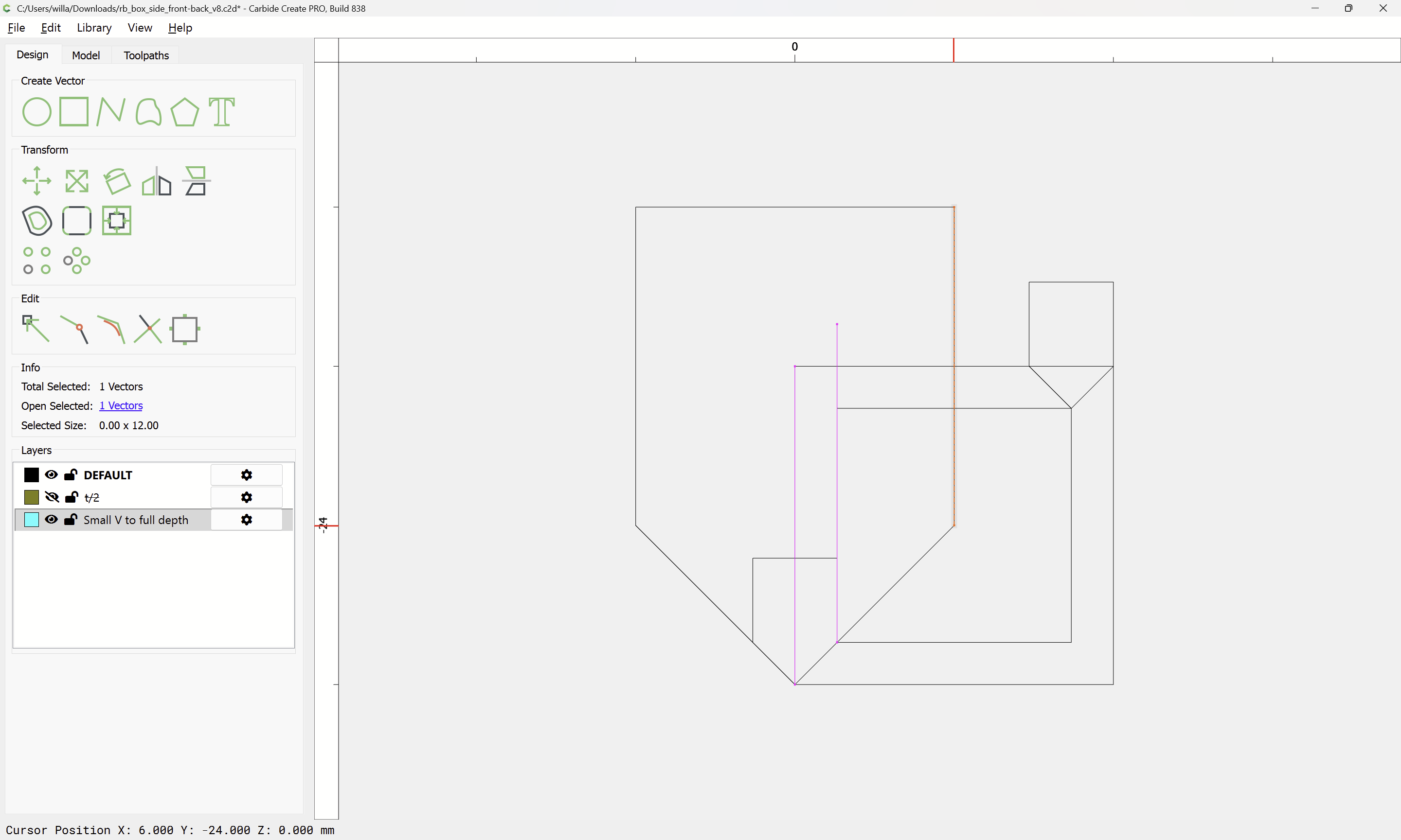

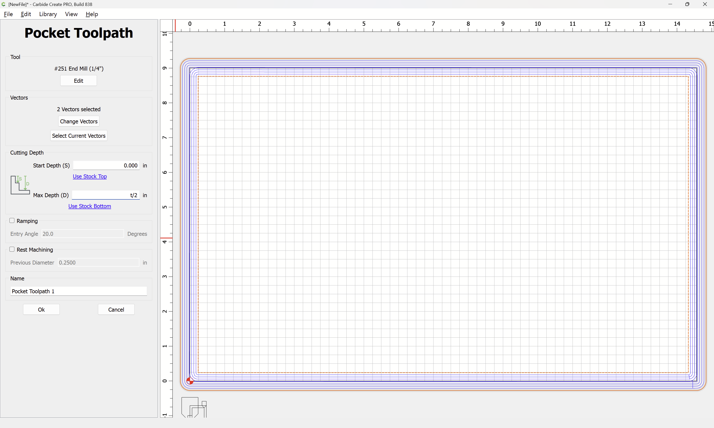

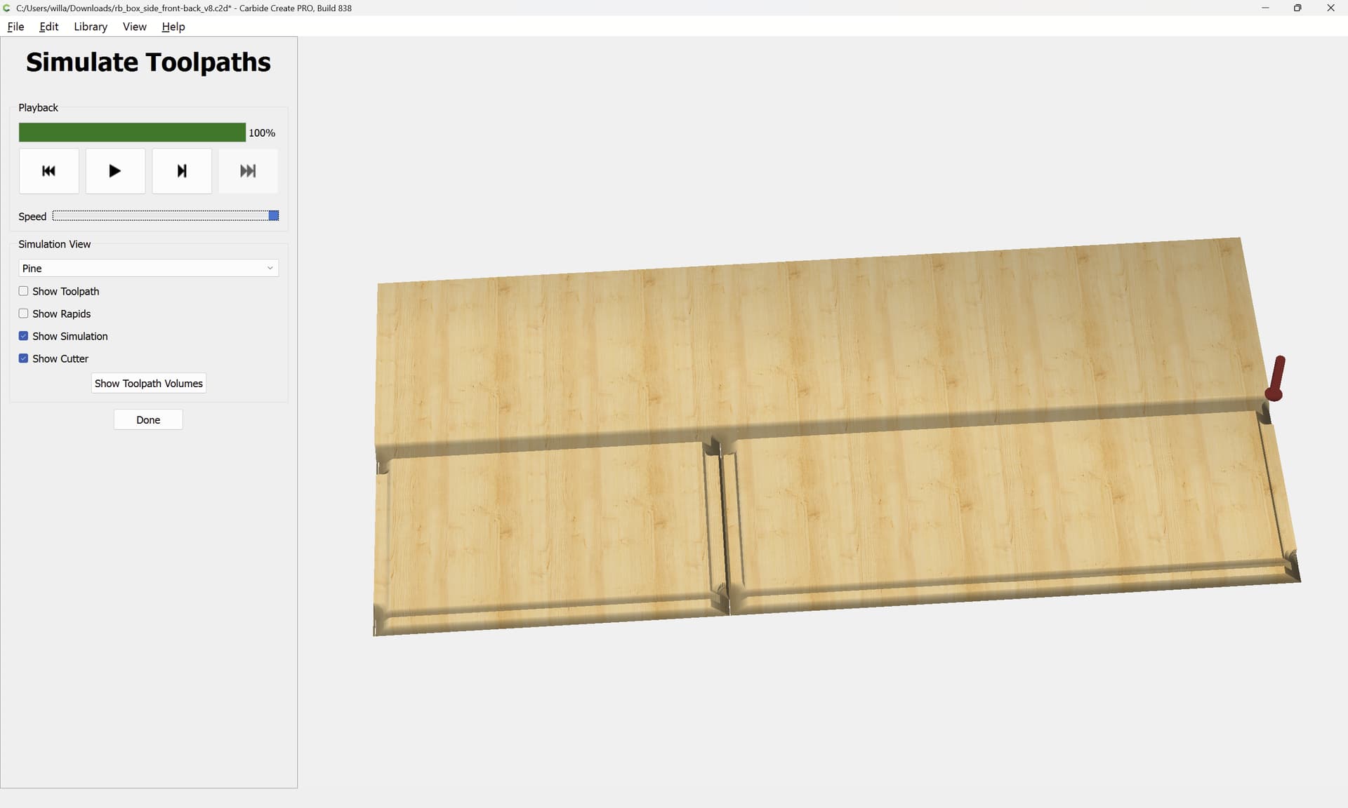

The most straight-forward toolpaths are the rabbets and grooves for the top and bottom:

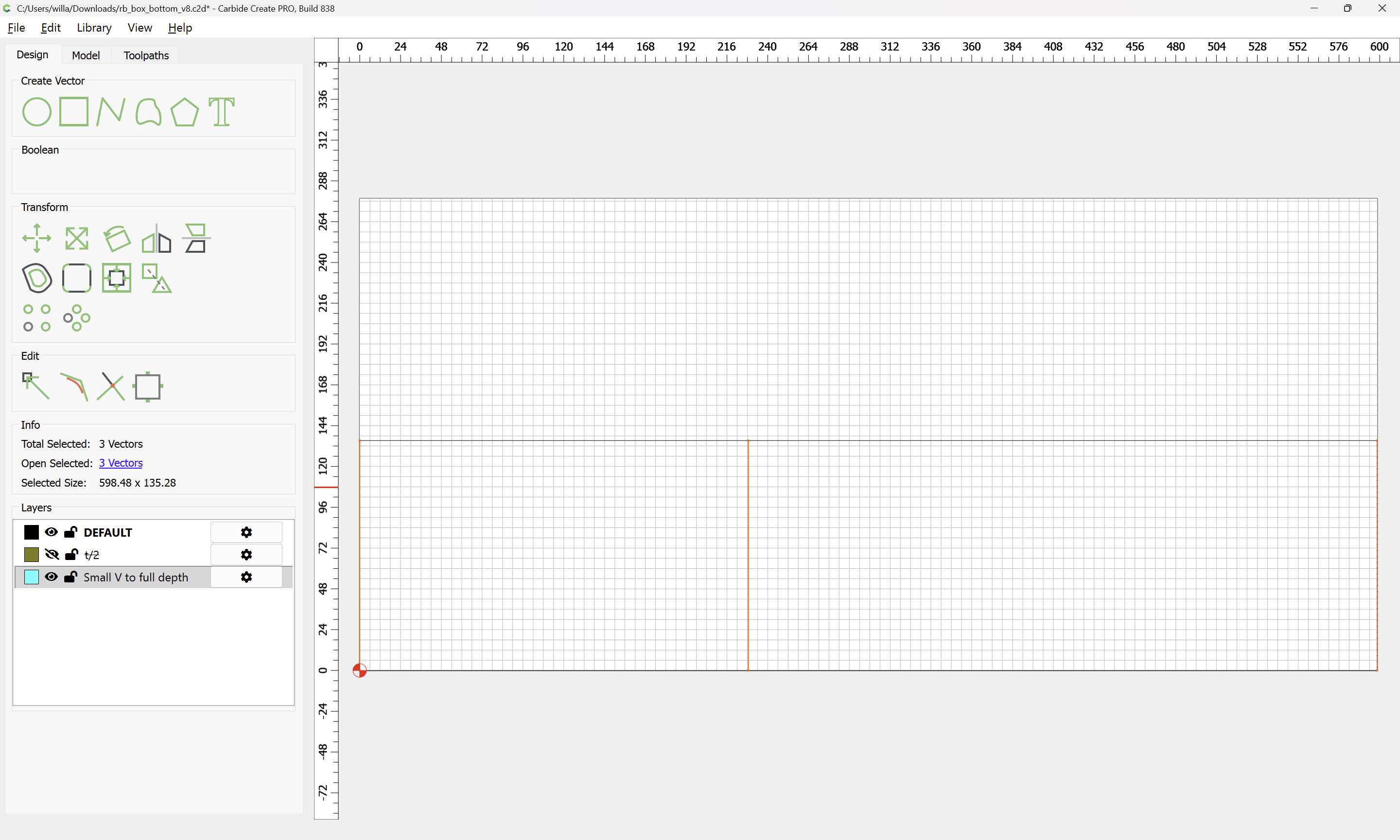

Next, are the small V tool cuts at the ends of the parts which are full-depth cuts:
(it will be easiest to put all geometry on appropriately named layers)
(it should be possible to adjust the Start Depth at the end when toolpaths are ordered for cutting efficiency)

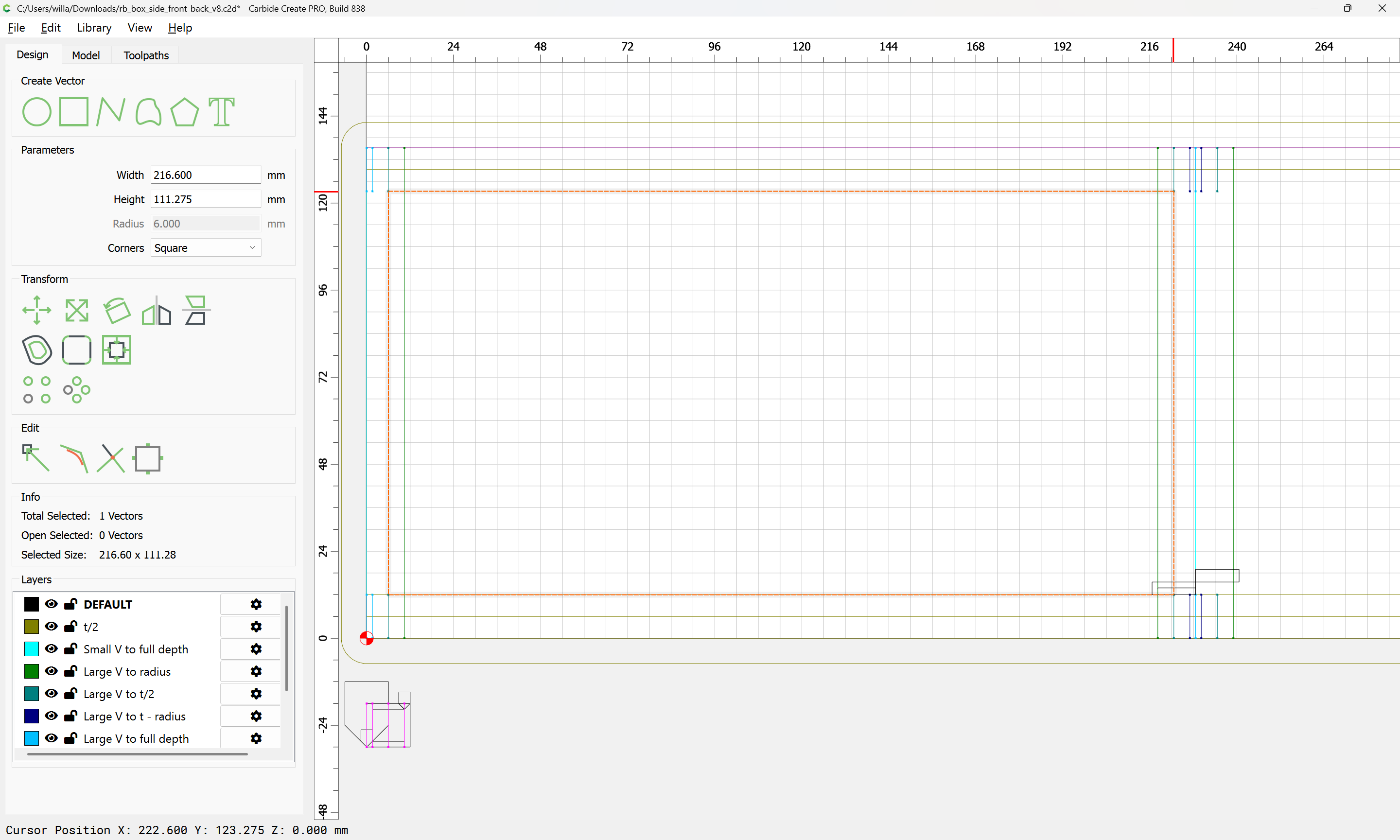

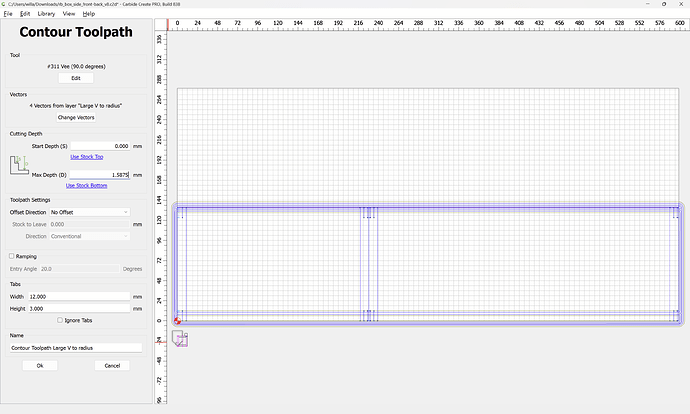

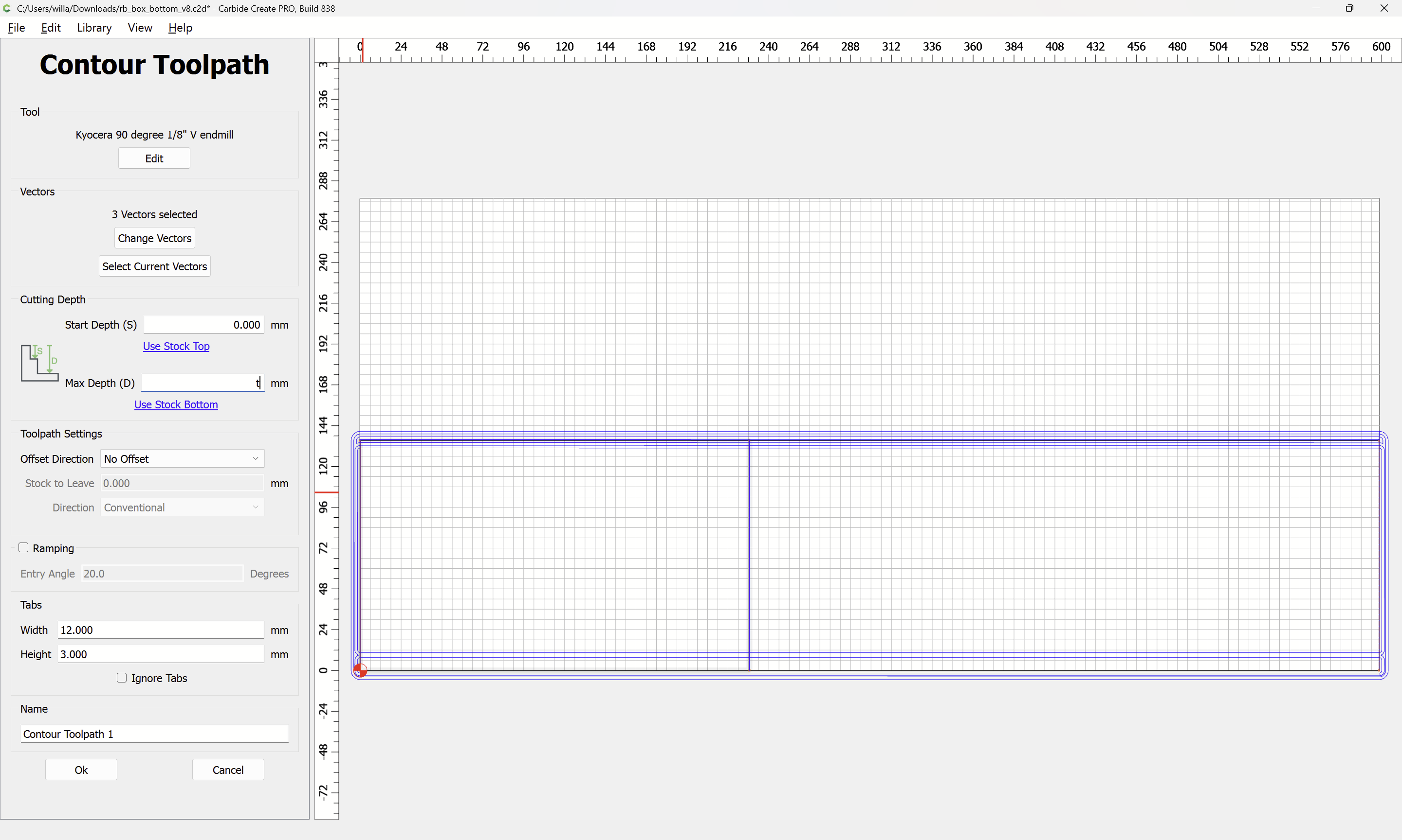

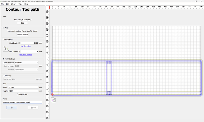

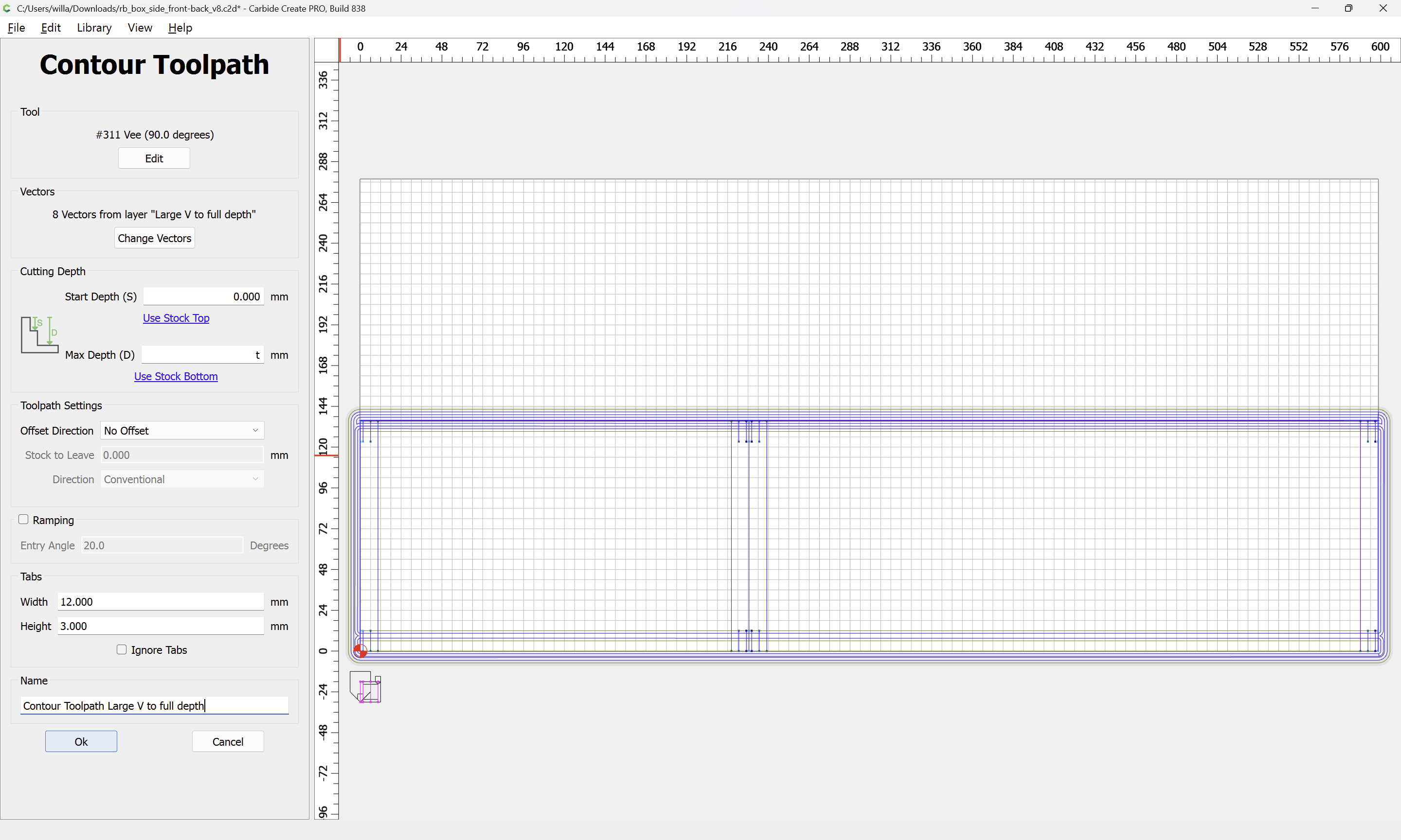

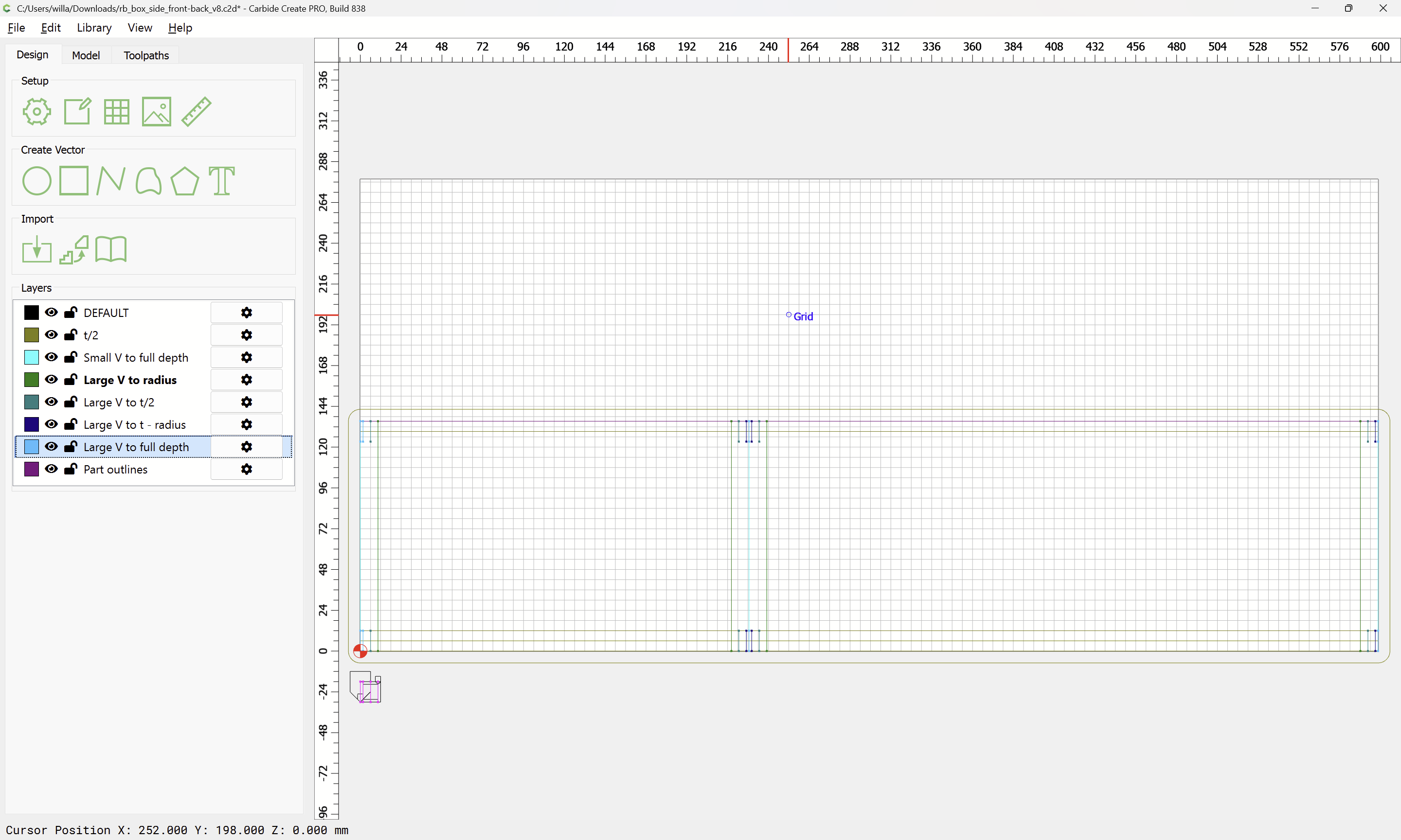

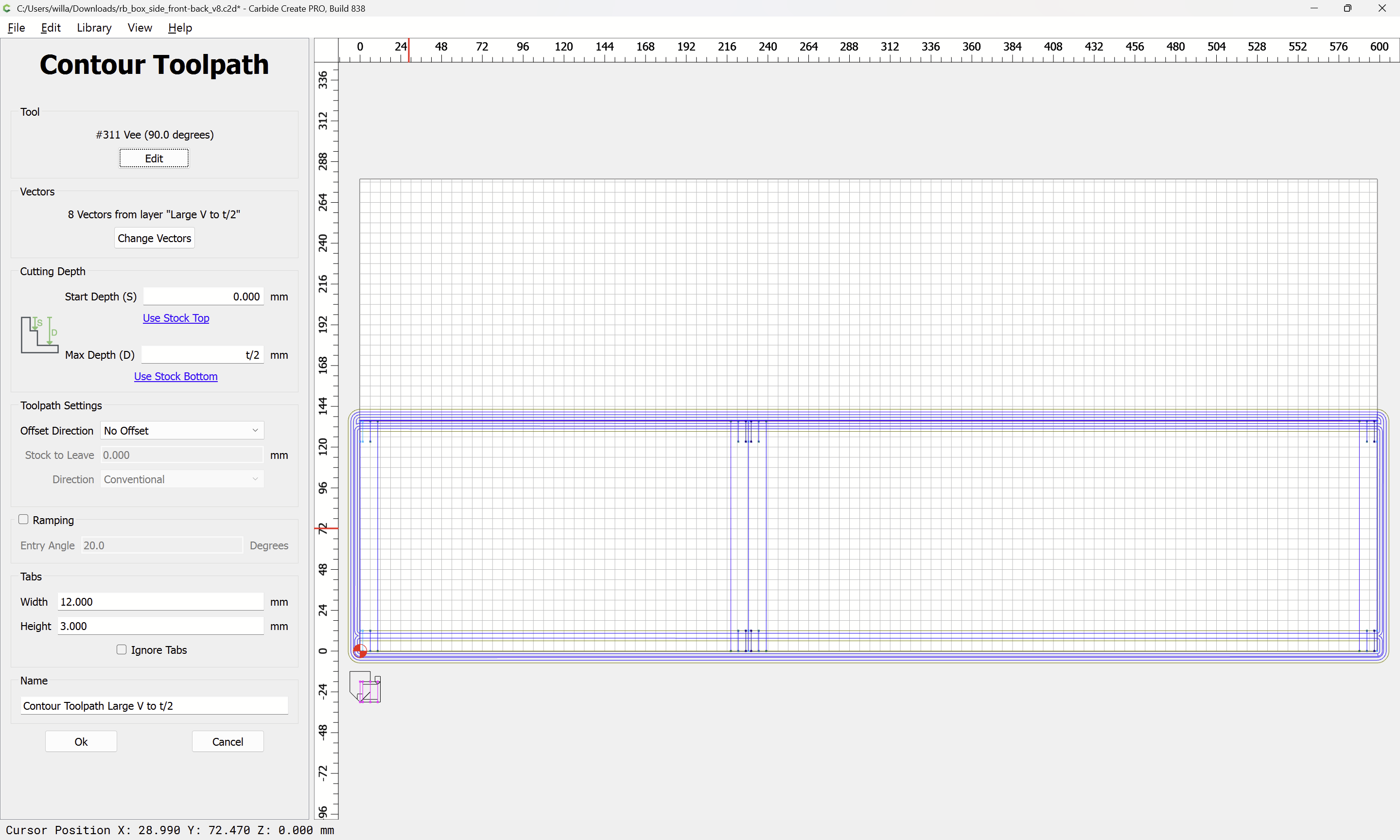

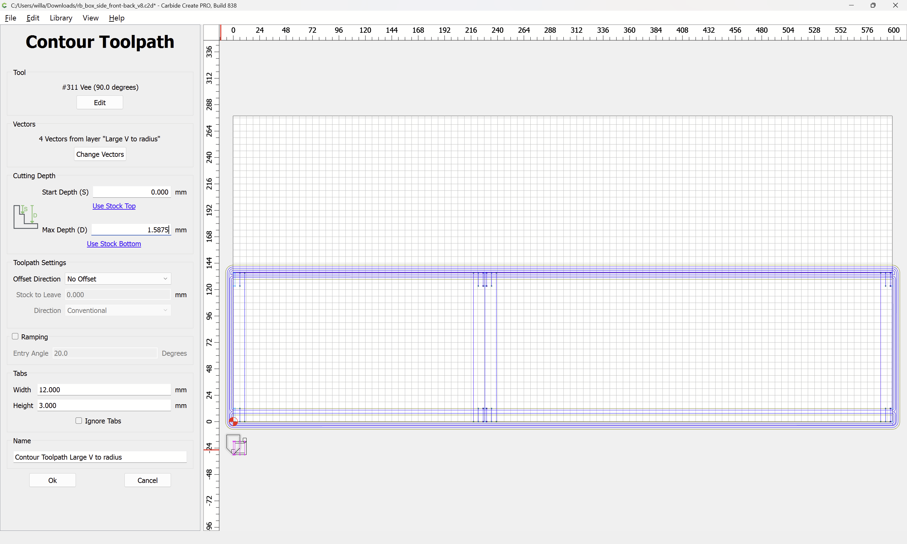

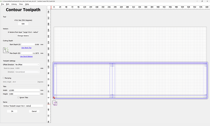

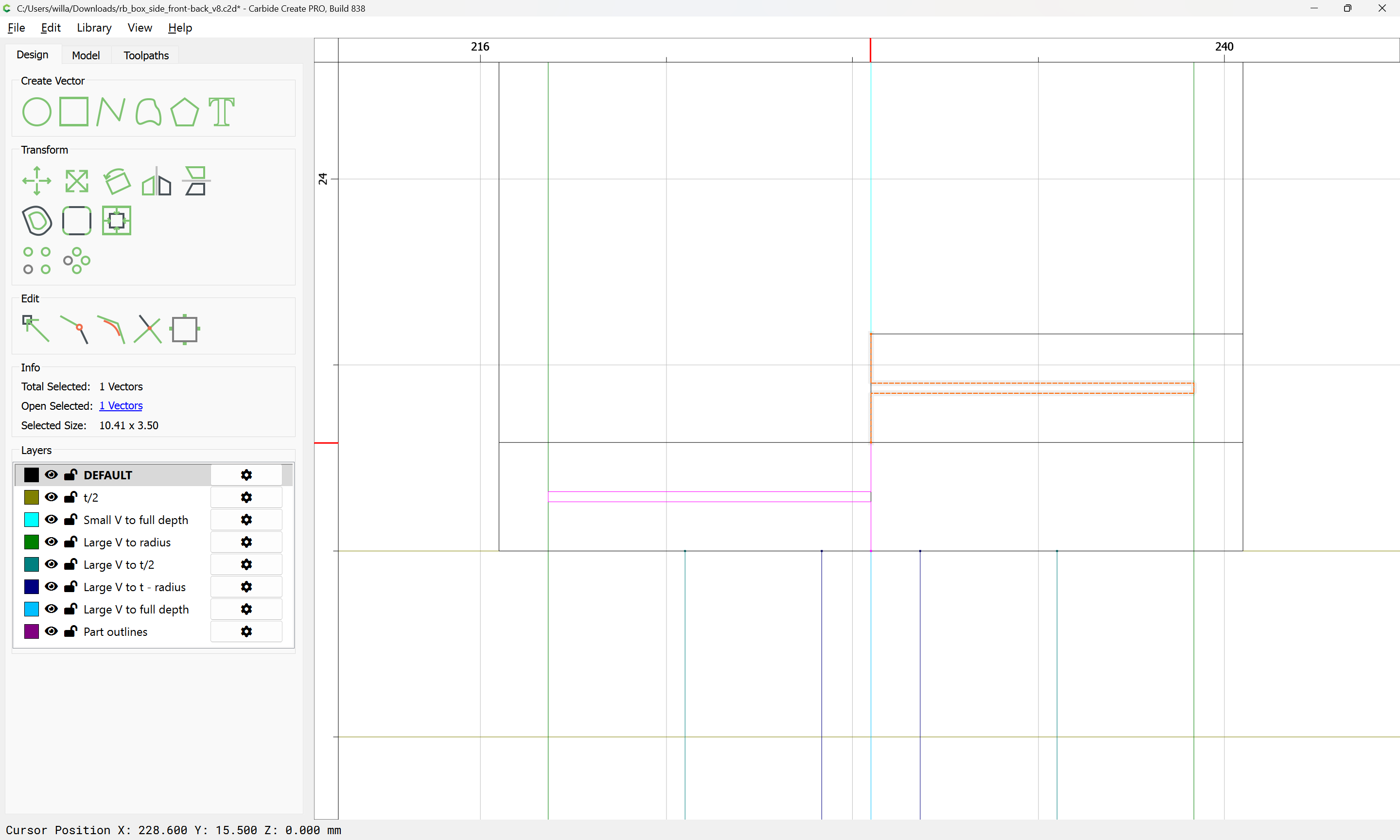

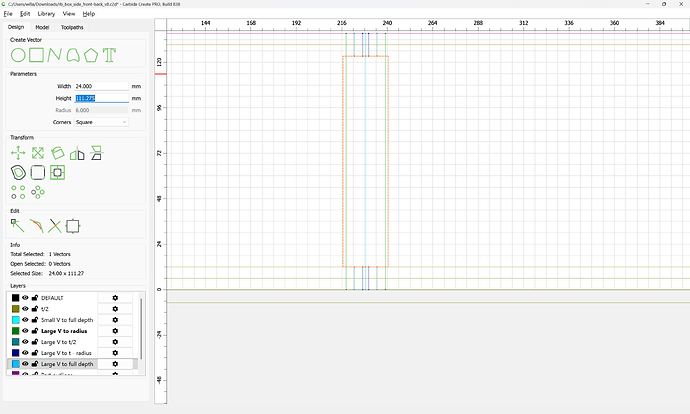

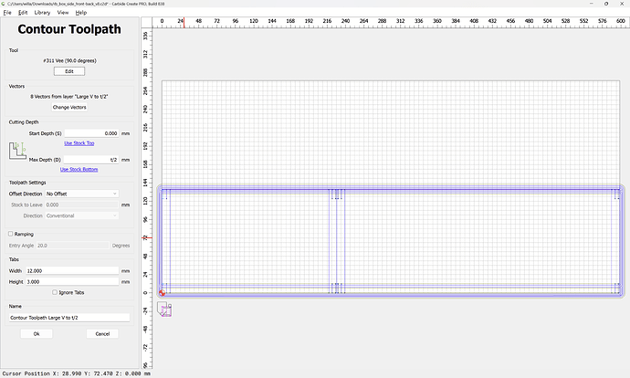

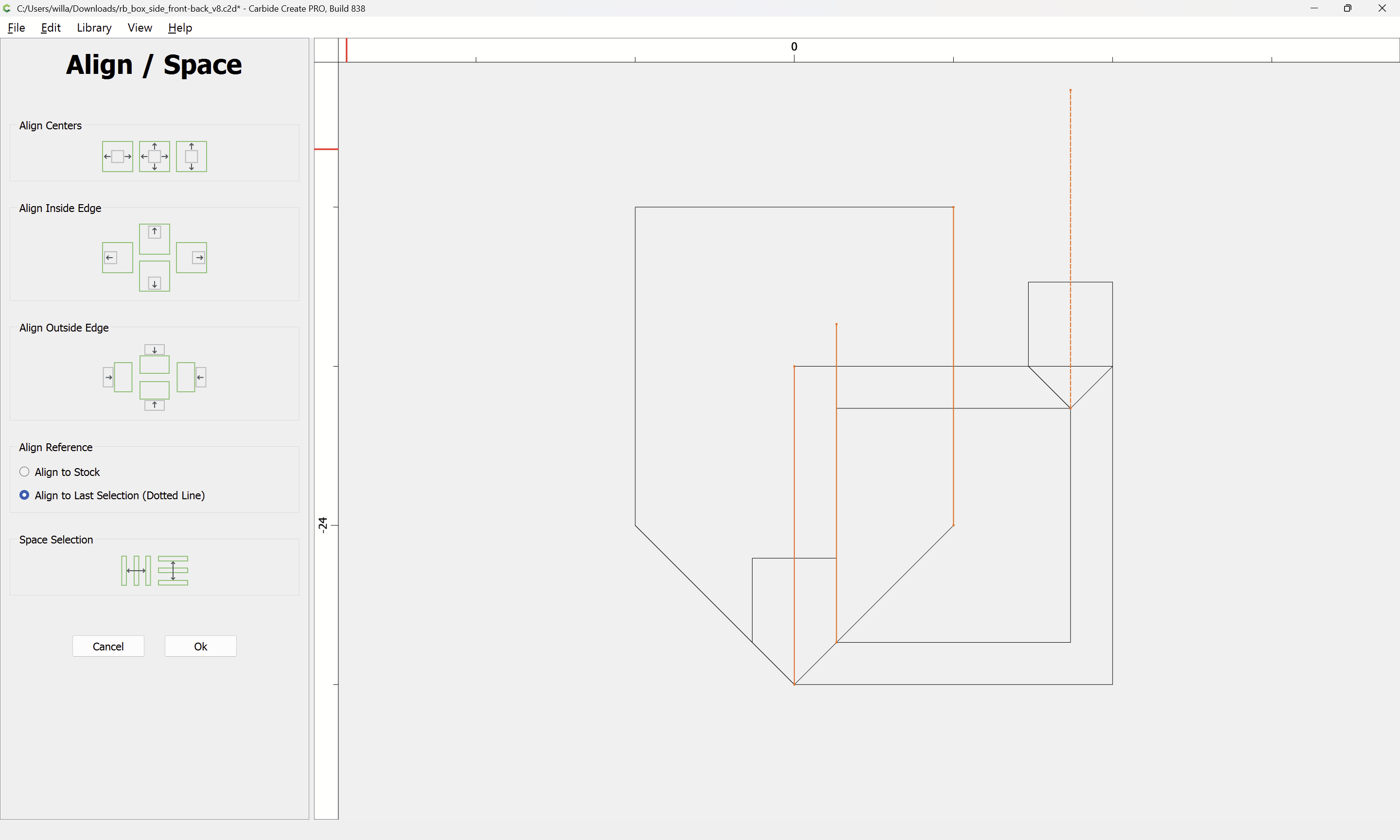

Next is a series of cuts with the large V tool which may be drawn up using the profile of the cut:
Note that that last will actually be a full length cut.
Then make a separate layer for each cut and assign the matching geometry to each layer:

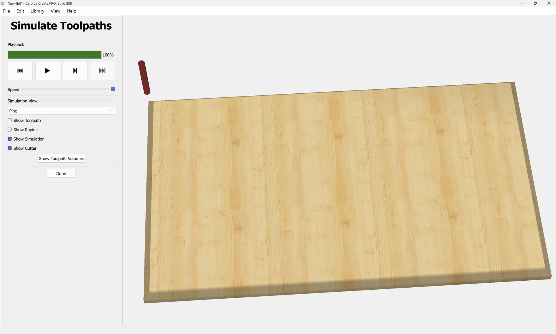

Then make the matching toolpaths:
which previews as:

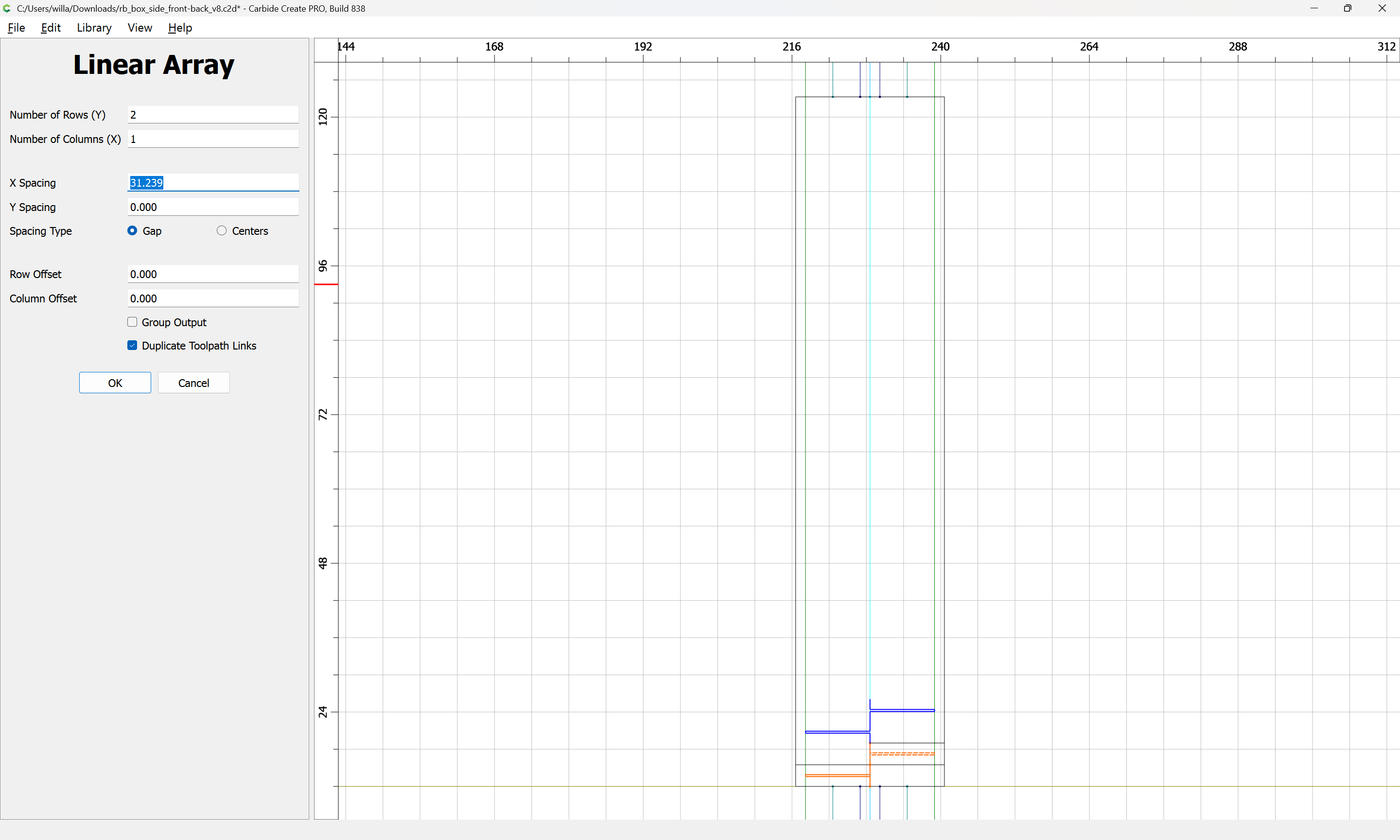

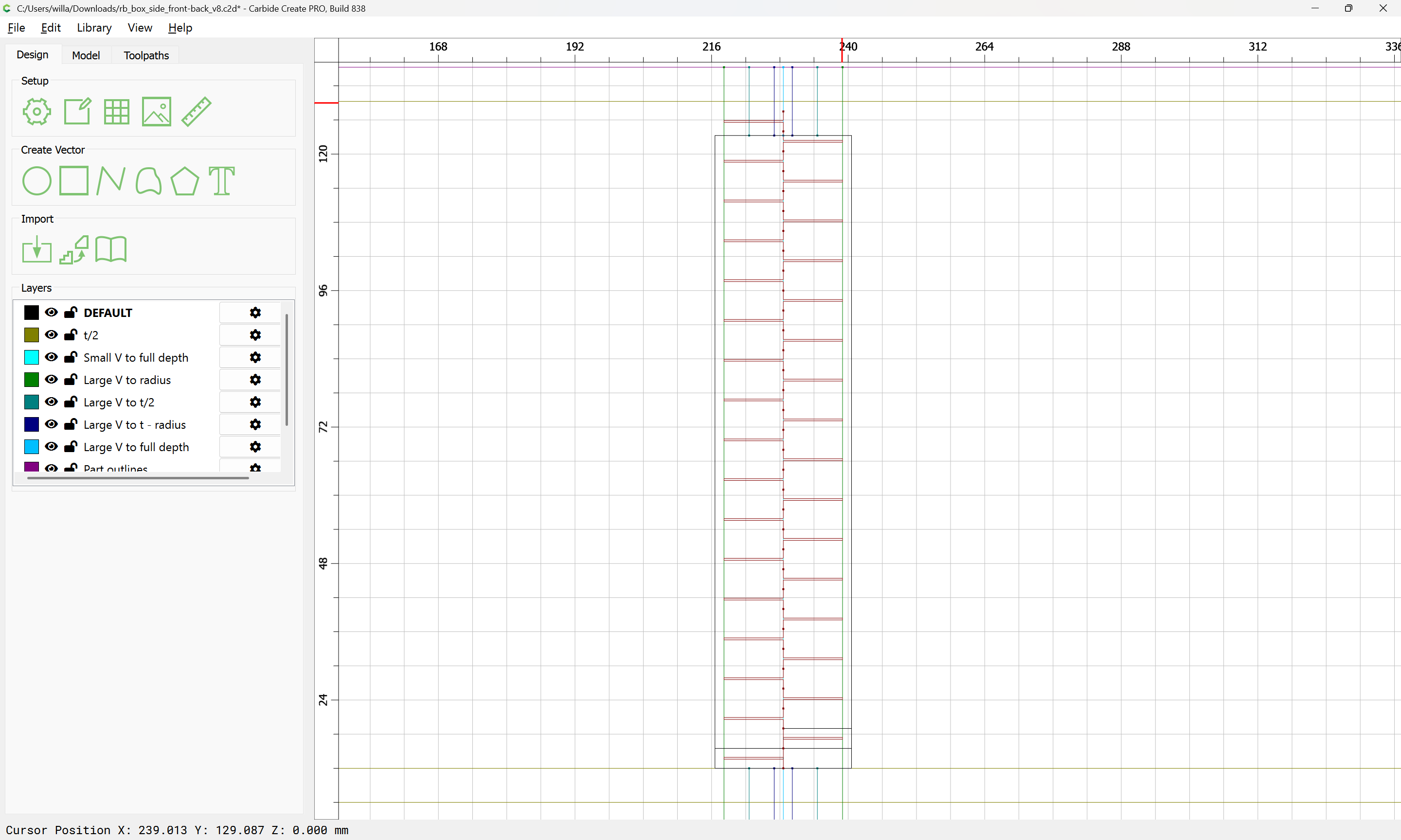

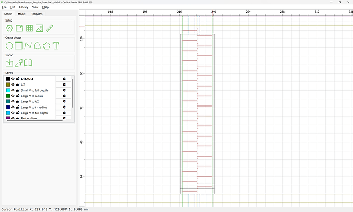

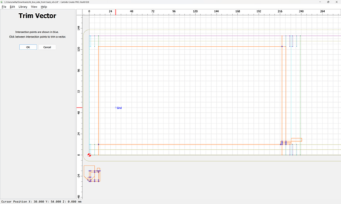

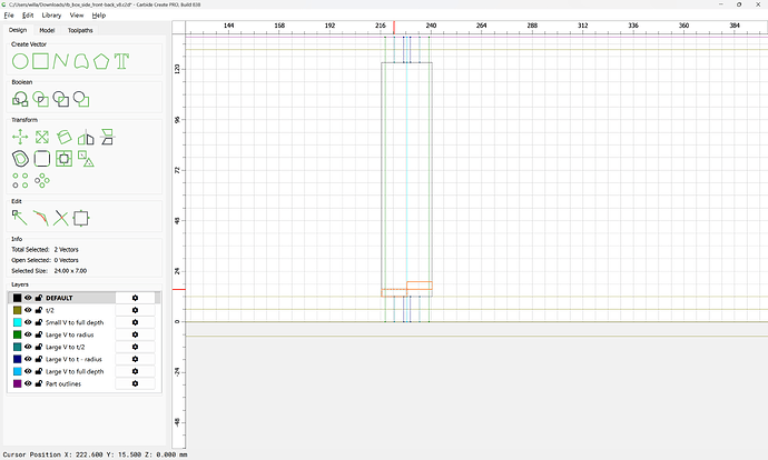

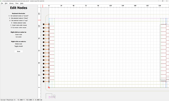

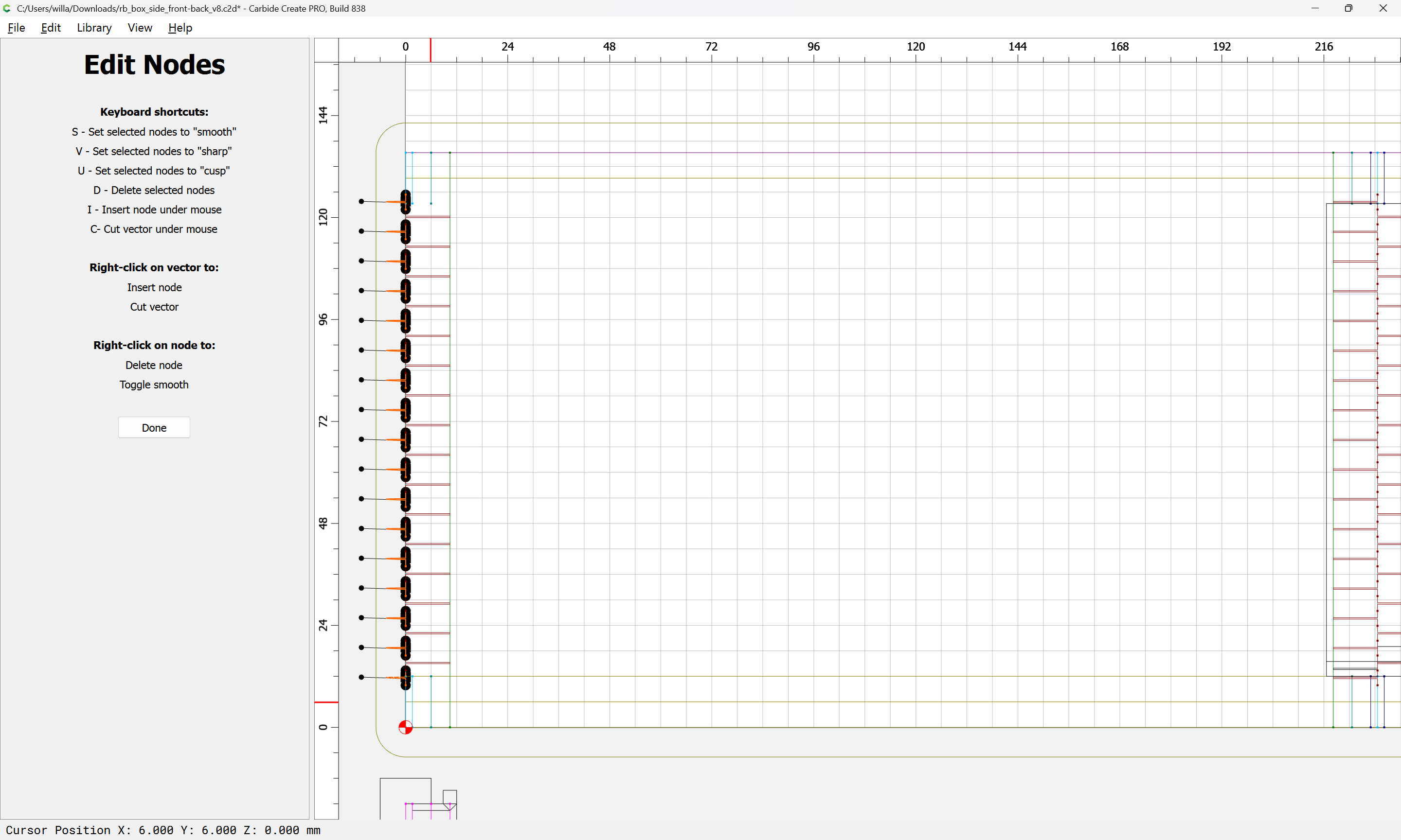

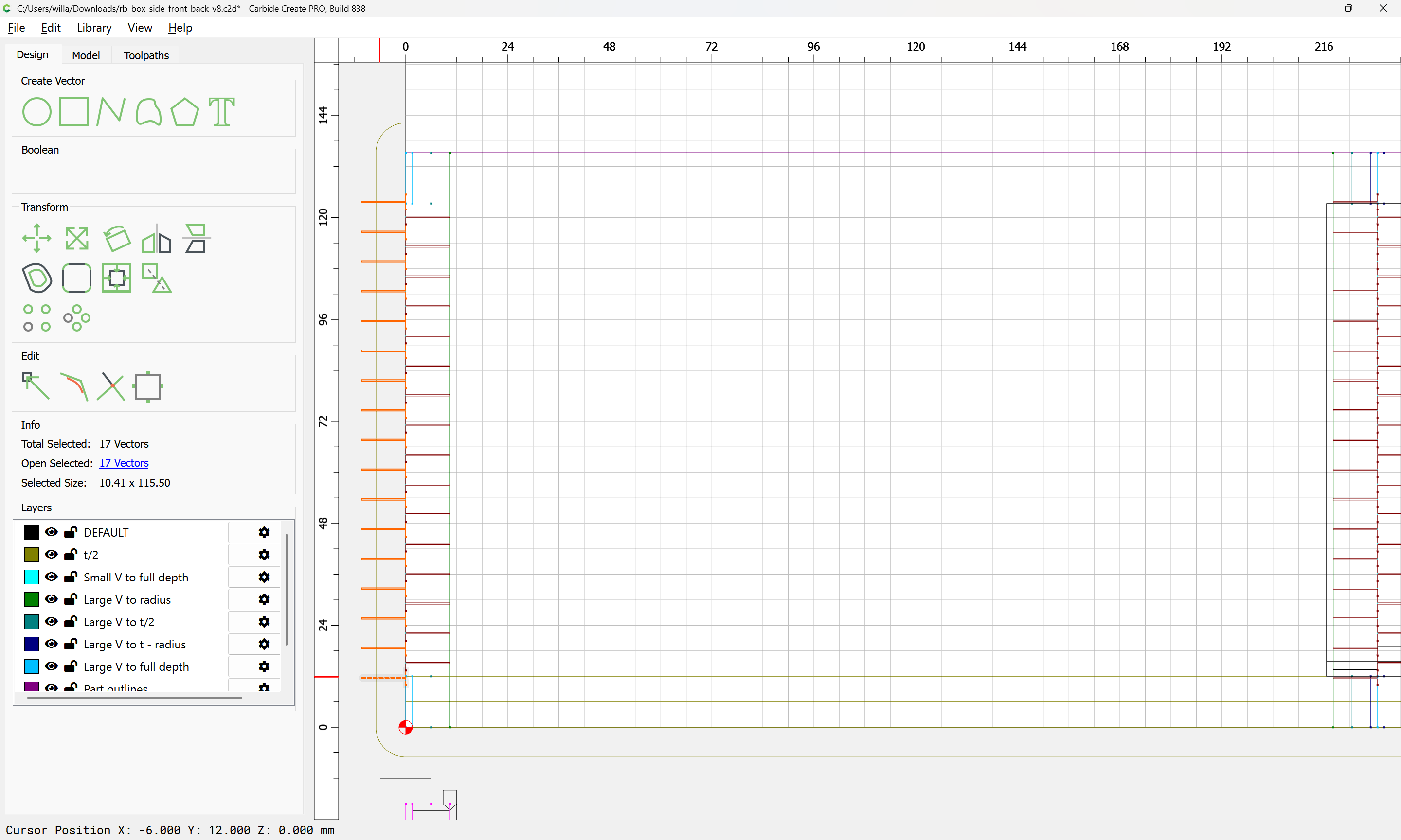

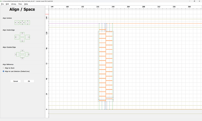

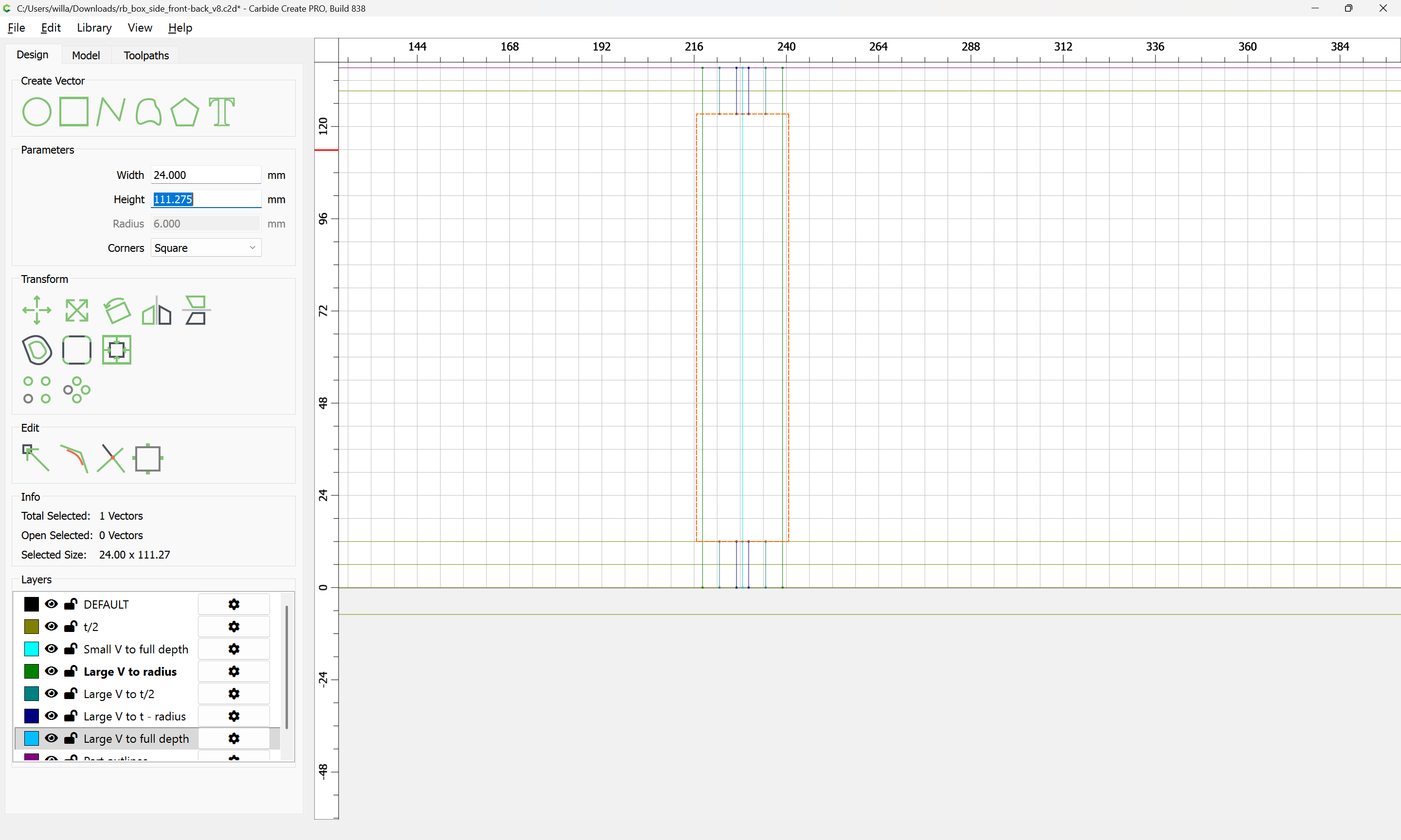

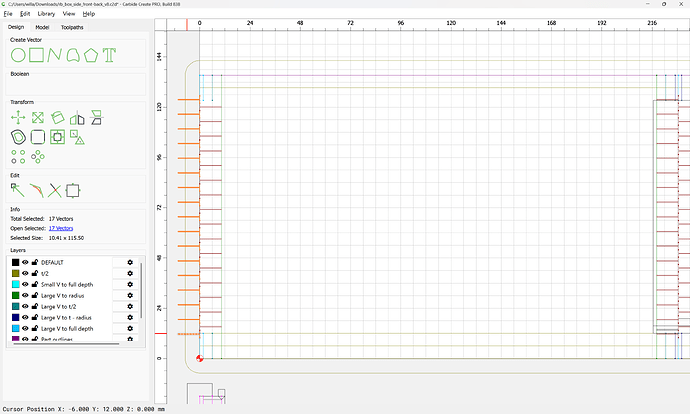

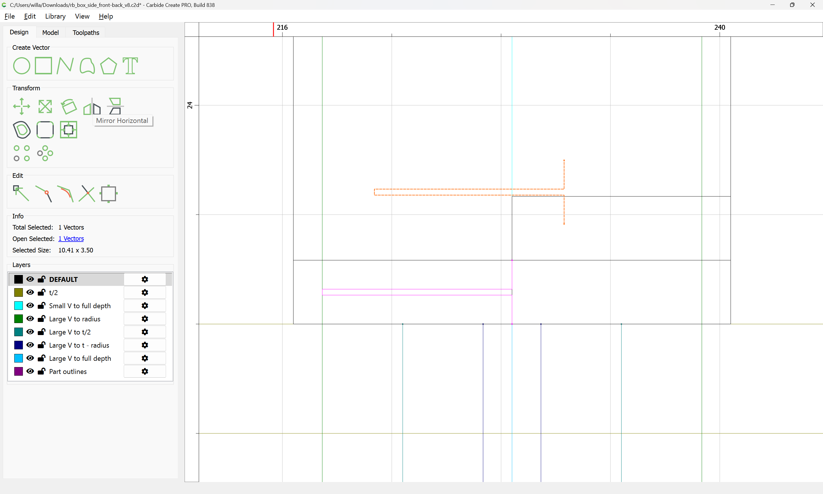

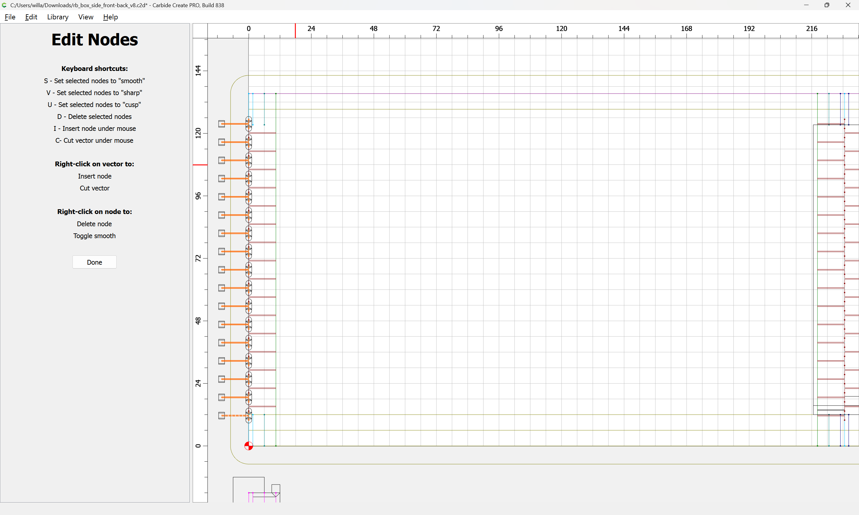

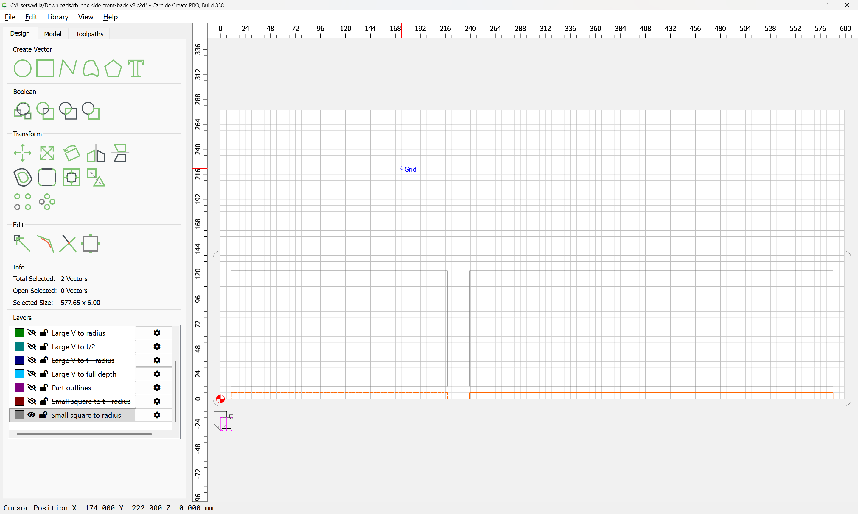

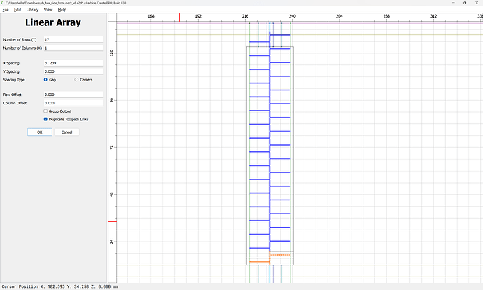

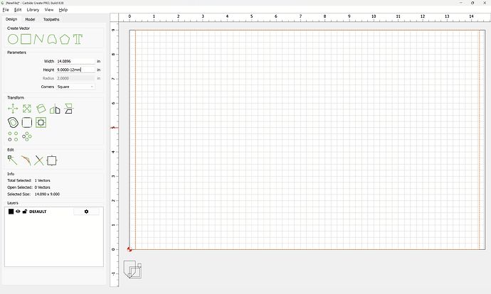

For the joinery, it will be easiest to draw the two sides along the middle and the duplicate. The box-joints will need to fill an area a bit larger than:
with an odd number of cuts on one side and an even number on the other.

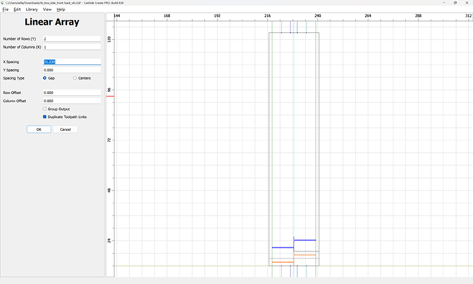

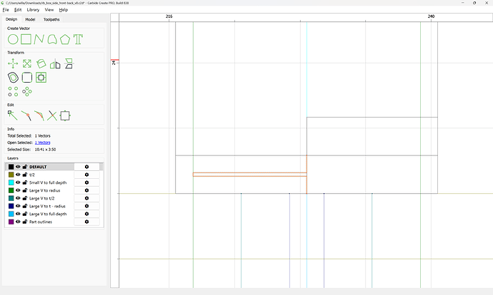

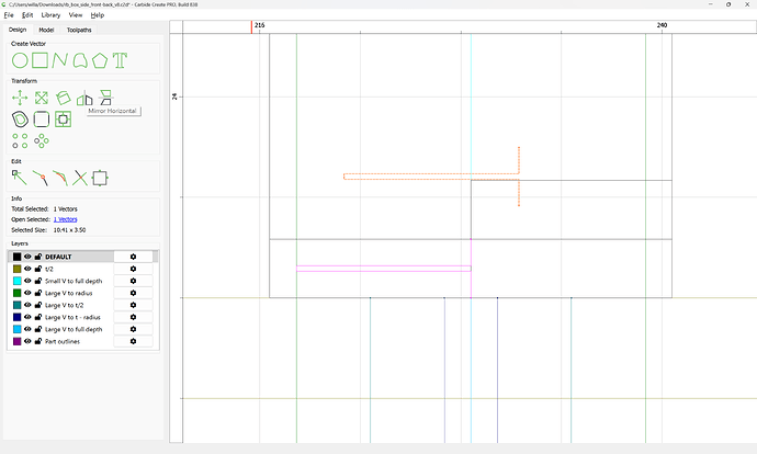

The cuts are most easily realized as filling a rectangle which is Stock Thickness wide for each side, and a bit more than Small V tool diameter tall, since that is 3.175mm, rounding up to 3.5mm is workable and results in a great deal of glue surface area.
One way to arrive at this is to draw the rectangles:
and then draw a series of lines which would result in cutting out each rectangle:

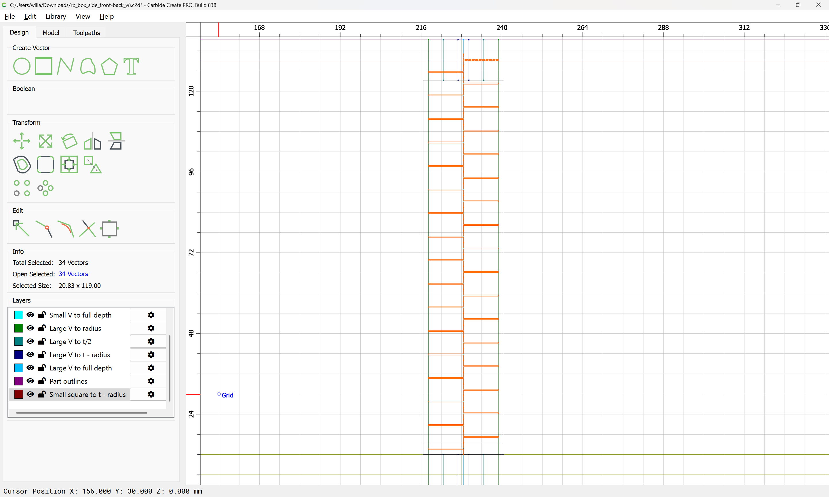

Duplicating it:
and mirroring it for the other side:

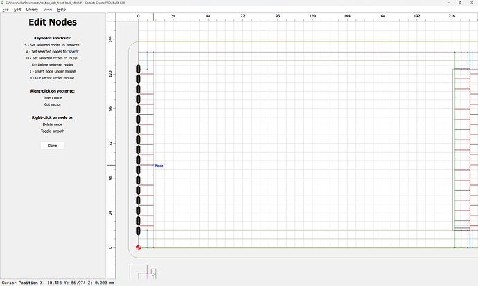

As always, move to an appropriately named layer:

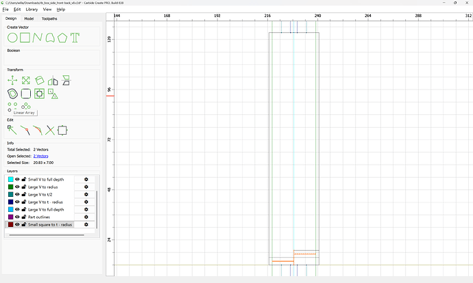

then use the Linear Array tool to replicate as needed:
OK

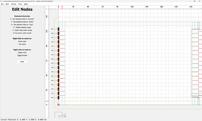

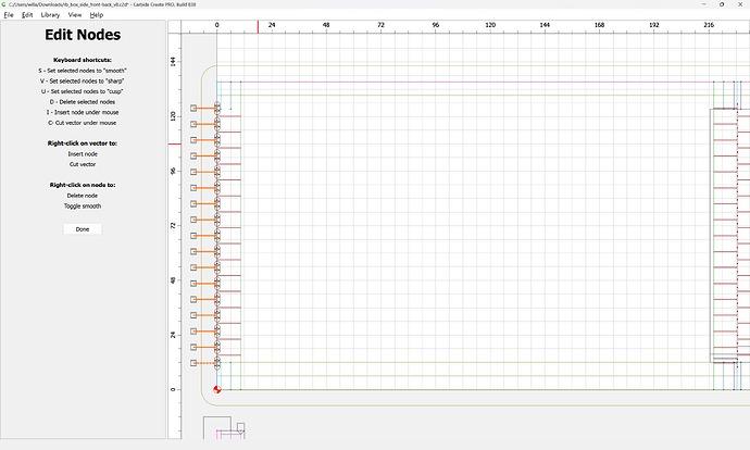

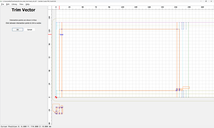

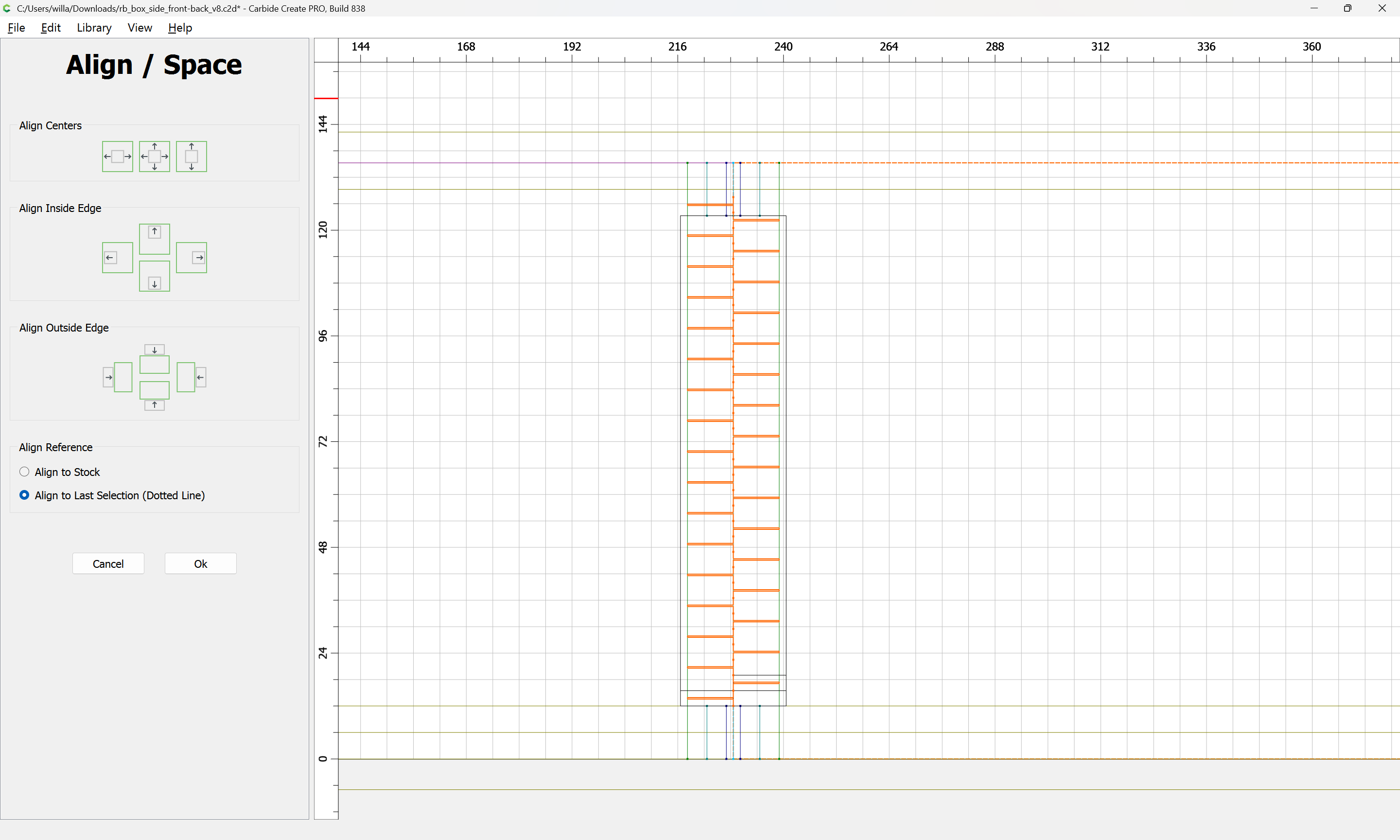

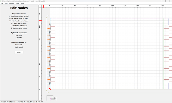

One element at the top will need to be deleted:

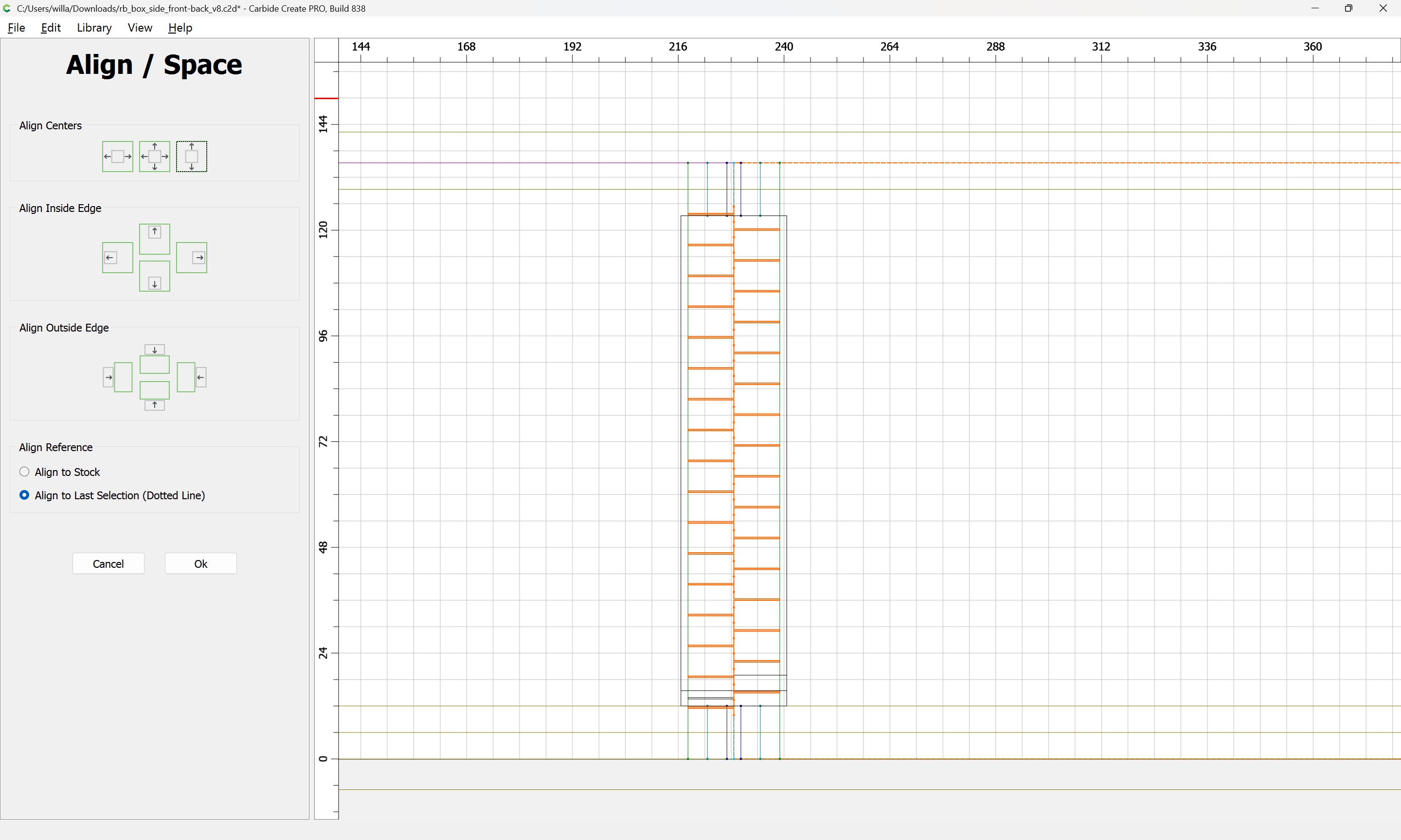

Then the geometry will need to be selected, grouped, then centered relative to the part outines and then ungrouped:

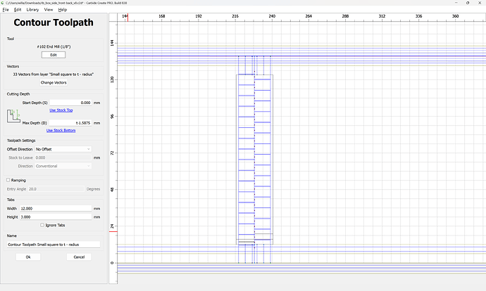

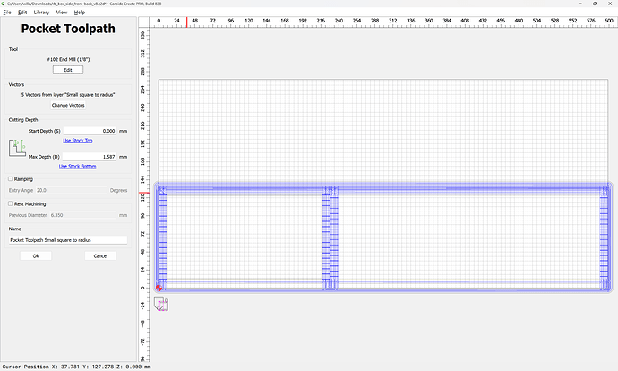

and a suitable toolpath set up:

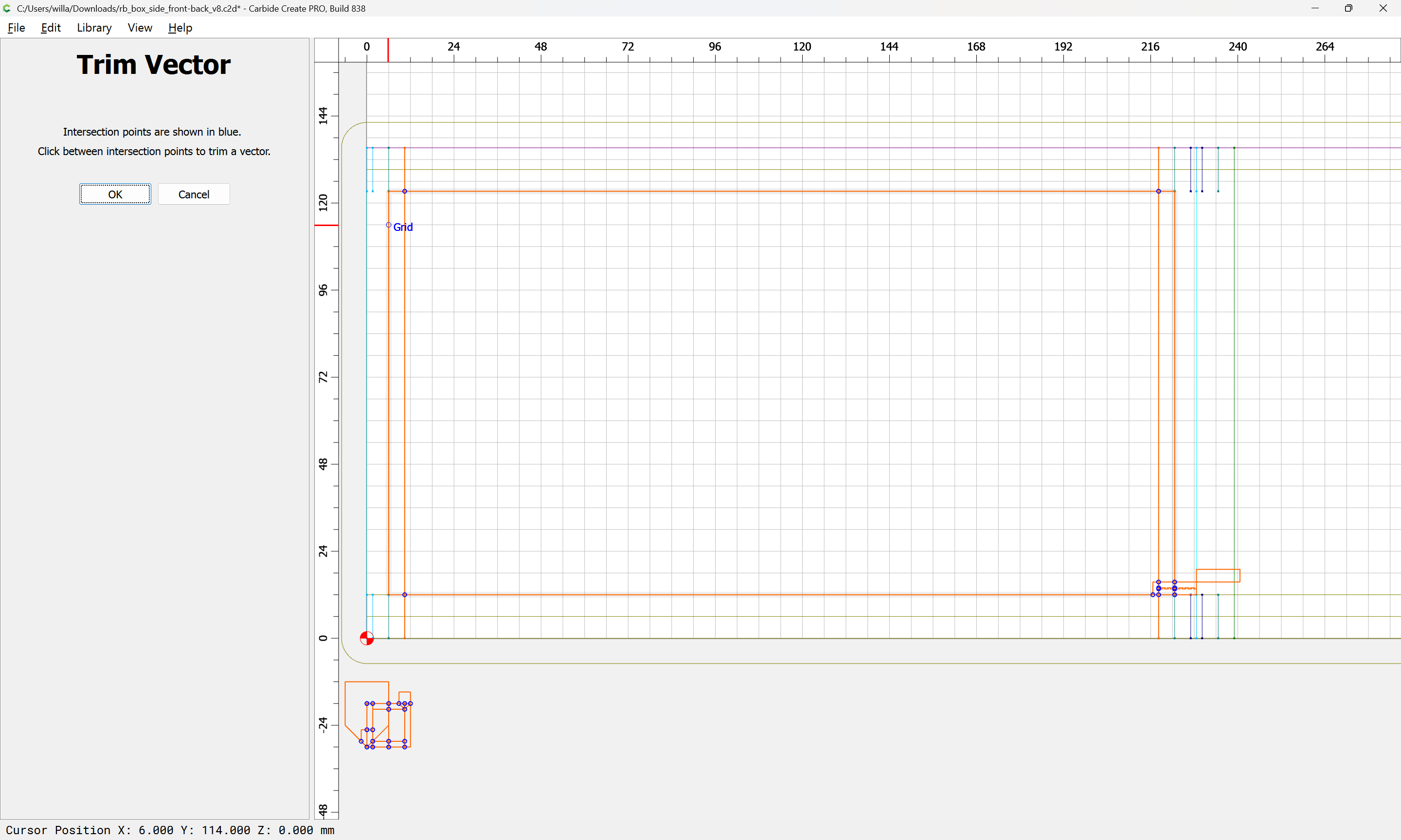

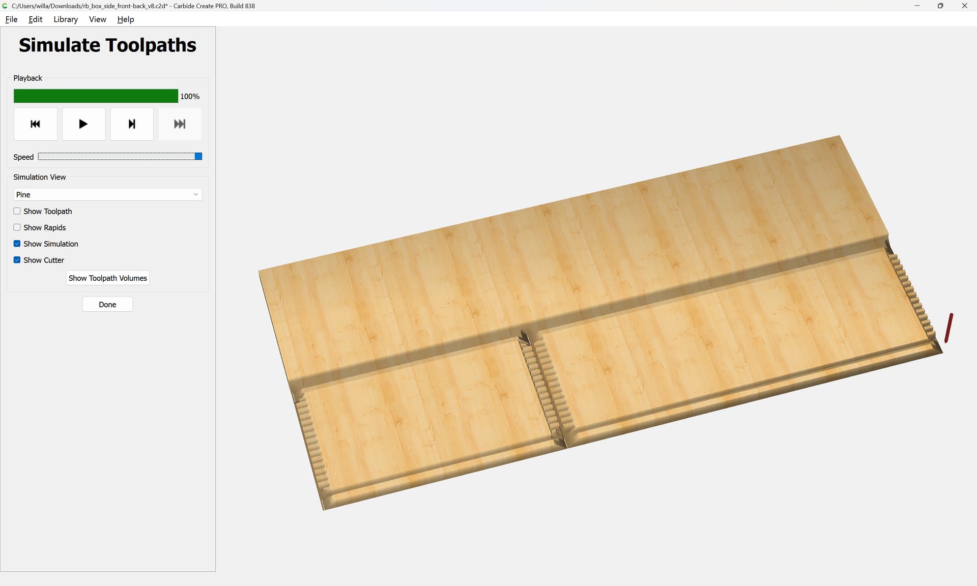

Next would be duplicating these toolpaths to the other end of each part, cutting away the tops of the box joints, arranging the toolpaths in optimal order, and duplicating everything to cut two pairs of parts.
rb_box_side_front-back_v8.c2d (120 KB)

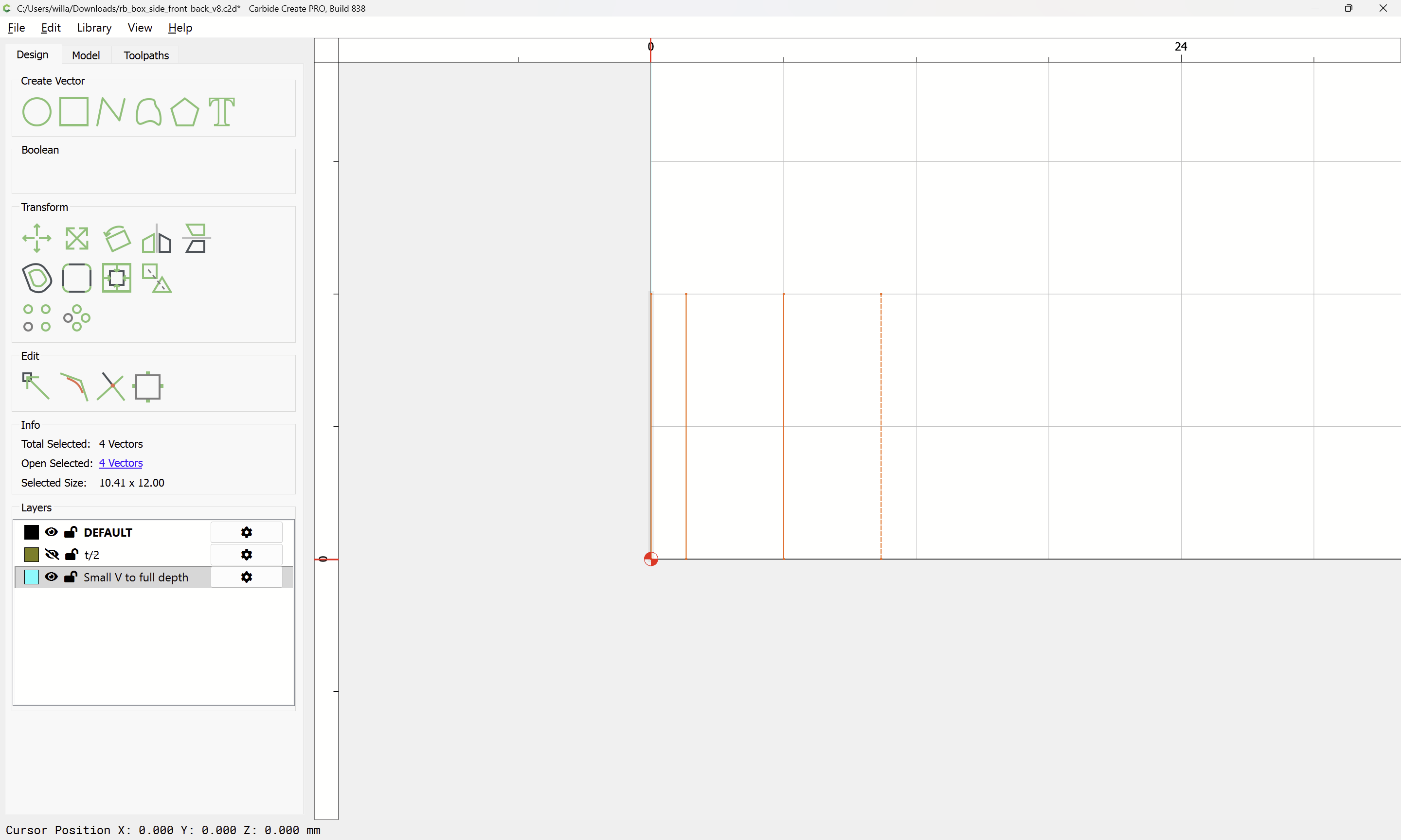

Note that when copied, it will be necessary to clean up one edge:
d
v
Except, when doing this, it is critical that one mirror things so that the joinery is consistent.
Lastly, a toolpath to clear the tops of the box joints will be needed:
It will be necessary to include the material below the rabbets at the bottom:
which previews as:
Then, just arrange the toolpaths and adjust the Start Depth as appropriate.
Attached as a v8 file.
rb_box_side_front-back_v8.c2d (172 KB)
