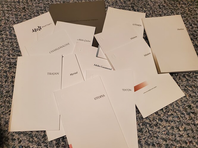

Ages ago, when I had more money than sense, I bought Adobe Garamond, and the matching Expert Set on floppy disks and got the originals booklet… bought pretty much every one of the originals as well as Garamond Premiere Pro, and even managed to get a copy of the booklet for it as well:
used to research each font which I purchased which didn’t include a booklet and then work up one, print, and bind it by hand — I think the one for Agfa’s Eaglefeather is pictured in:
and when I wrote up a bit on Prof. Hermann Zapf’s Zapfino, I was able to include a flipbook animation:

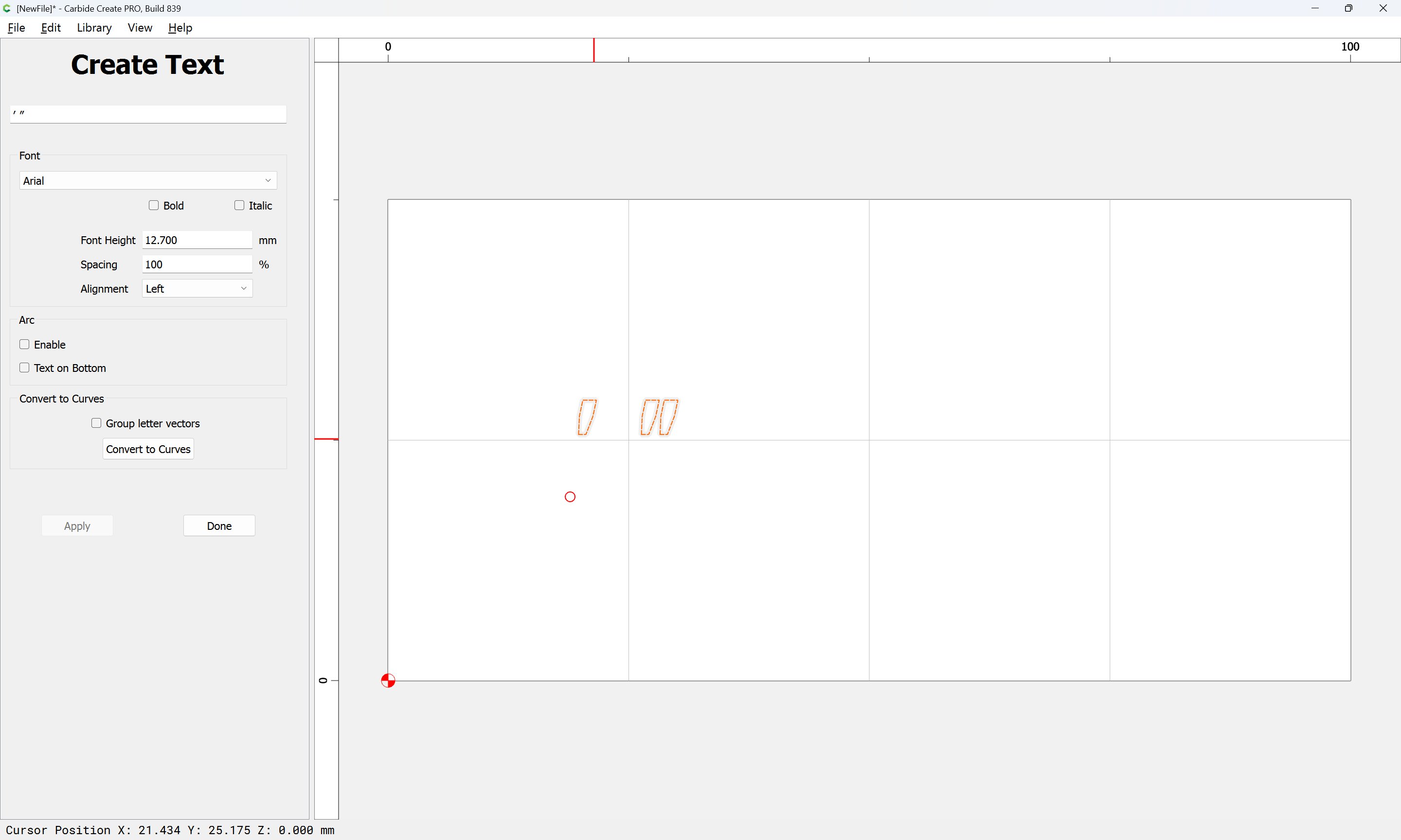

Unfortunately, if one sets a prime or double prime symbol using the correct characters: ′ ″ they will not appear in Carbide Create, in most fonts.
Arial is an exception:
Attached as a v8 file.
