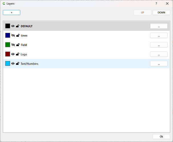

Make a new layer for the Logo:
and move the logo geometry to it:
Similarly make layers for text/numbers:
and lastly the holes:
With everything on its own layer, things may be unhidden:
and toolpaths assigned.

Since everything is on a separate layer, one may create toolpaths and associate each with a suitable layer:
Advanced VCarve
OK
VCarve | Select by Layer
Ok
Contour | Select by Layer
using a #302 to a depth of 0.0625" with No Offset
Ok
OK
Using a #302 to a depth of 0.125" with No Offset
Lastly a Drill toolpath | Select by Layer:
Using a suitable tool at suitable feeds and speeds to a suitable depth with suitable settings (test in a piece of scrap and consider: Cribbage Pin Kit - Carbide 3D )
