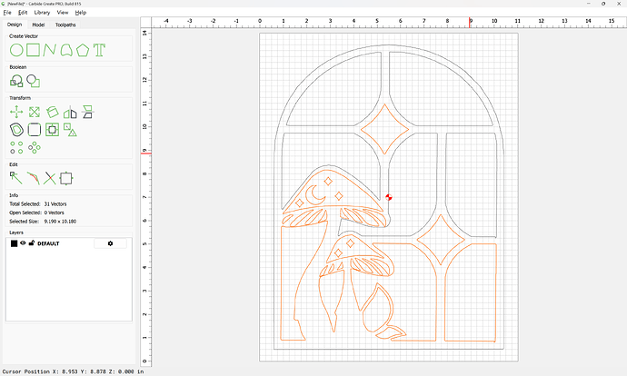

Given a design file:
and the request:
best toolpaths and bits for this project.
There are two possible approaches:
  • model in 3D (which should yield the possibility of a more organic appearance)
  • directly cut using selected tools and toolpaths
my understanding of my imprimatur is that the latter is a better fit, so…
First, group:
and center everything:
OK
and then Ungroup so as to allow selection of individual elements.
The first elements which will need to be selected are those which are decorative (as opposed to structural/functional), so shift-click on elements which will actual work as pockets/receptacles/outline to remove them from the selection:
and then assign a suitable toolpath:
V carve is usually best for decorative elements:

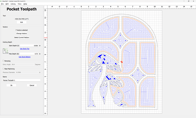

We then select the areas for the pockets:
which we wish to inset so as to have a rounded form at the bottom of the pockets — however, there are two very narrow regions:
Fortunately, the scale of the project is such that insetting by the radius of a #202 Ball-nose should work:
Assign a Pocket toolpath with the previously used #201:
which now previews as:
