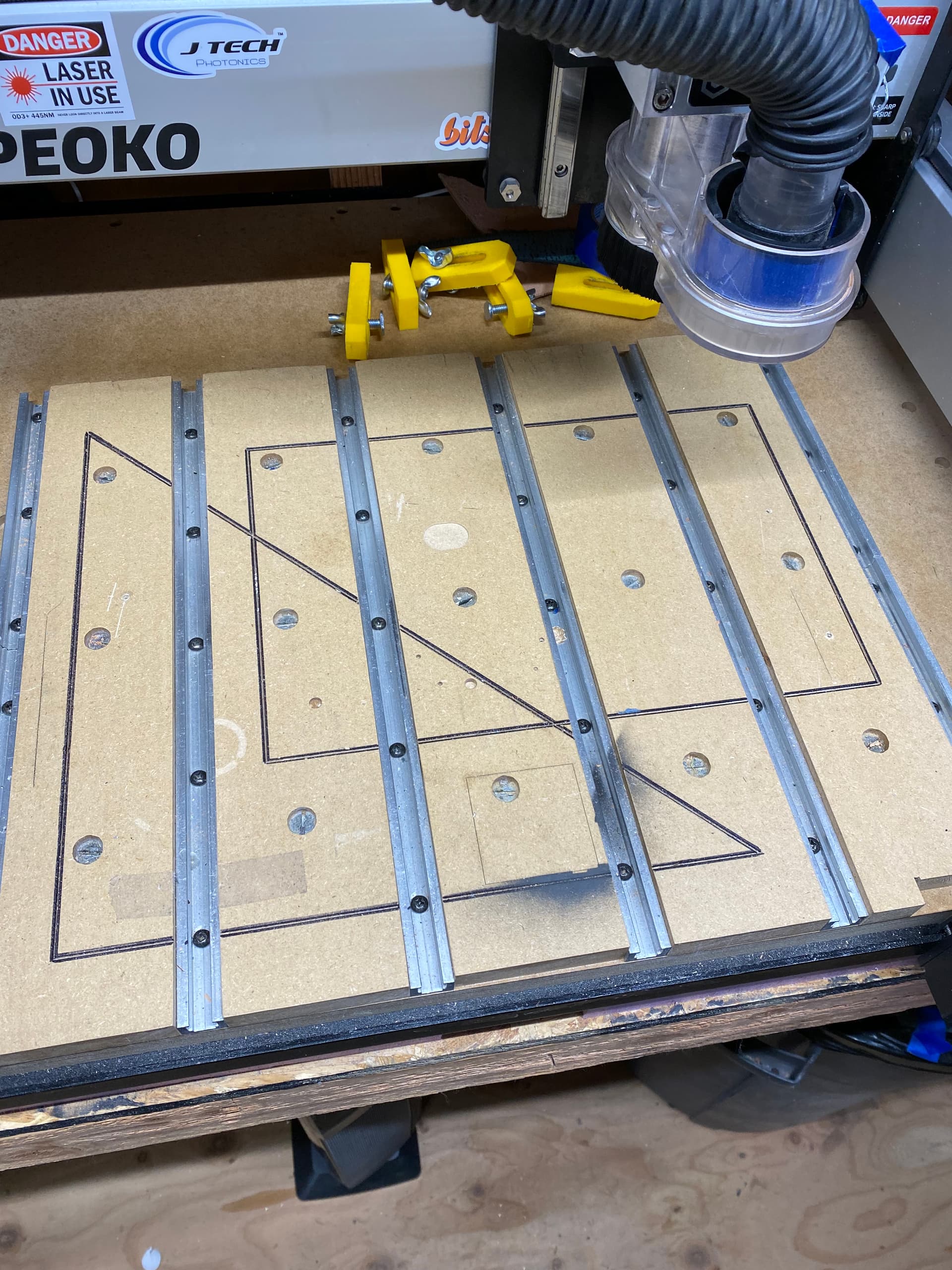

I take a different approach where I’ve cut a triangle and square in my spoilboard with a v-bit about .040" deep then marked the groove with a sharpie. I clamp my work piece or stop along a line that suits the project.
