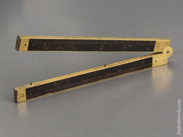

My inclination would be to go old-school and source the nicest piece of hardwood you could find and some brass sheet and make it using the traditional design-language of woodworking tools:
I’ve been meaning to revisit my first project on my SO3:
in brass for a while now.
