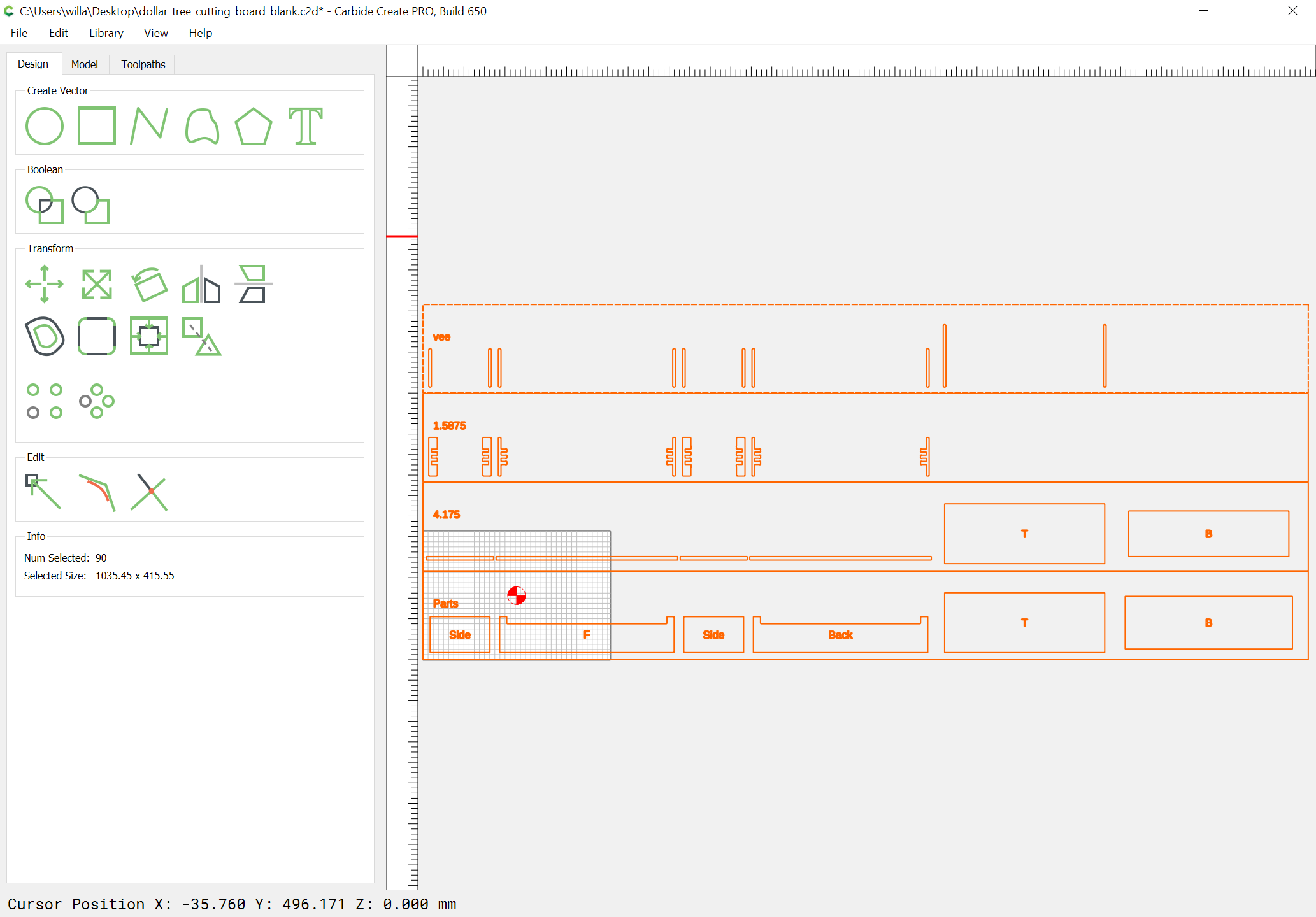

WillAdams
(William Adams (Carbide 3D))
May 1, 2022, 5:13pm
2
In Carbide Create, set the stock area to match the bounds of a single set of parts:
Then create a Layer for each thickness or tool type used in the design, group the matching parts, move them to the appropriate layer and align the group to the Stock Area:
Adjust the Stock Area to match the actual stock which will be used for cutting:
and arrange parts to efficiently use the stock:

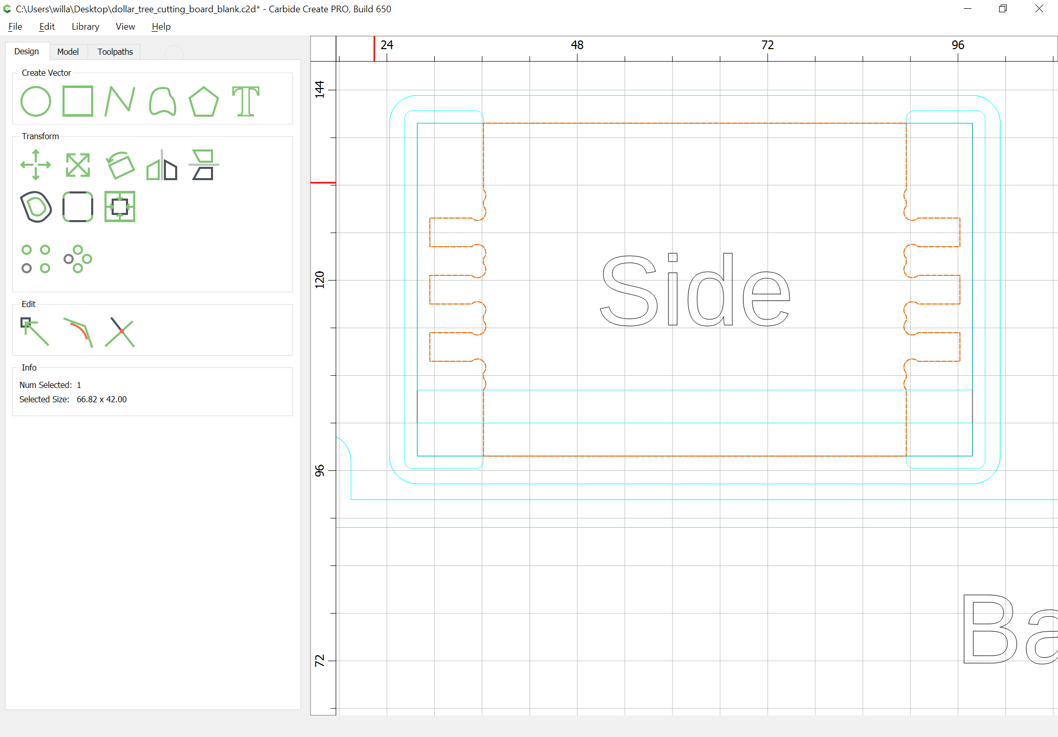

Select the part outlines and offset to the outside by the diameter of the endmill plus 10%:
Clean up where appropriate:
and duplicate the geometry which is affected by the rabbets so that the rabbets can be punched out:
Then select the outer geometry and set up a Pocket toolpath to the rabbet depth:
WillAdams
May 1, 2022, 8:25pm
4
Select the geometry for the box joints and copy-paste it in place:
Then Boolean subtract the joint geometry from the part outlines:
WillAdams
May 1, 2022, 10:06pm
5
Recreate, or copy-paste in-place the surrounding geometry:
select it and the joint-part geometry and define a pocket from rabbet depth down to the joinery depth:
WillAdams
May 2, 2022, 12:10am
7
If the endmill used to cut out the joinery is not small enough to cut out the dogbones, it will be necessary to define geometry to make this cut — select the geometry in question:
If need be, clean it up to remove any extraneous dogbones:
(repeat as needed for all copies)
Offset to the outside by the size of the dogbones (should be the small endmill diameter plus 10%):
then node edit to limit the geometry to where the cutting actually needs to be cut:
and duplicate the original geometry and punch it out of the offset shape:
and simplify the geometry to make the cutting more efficient:

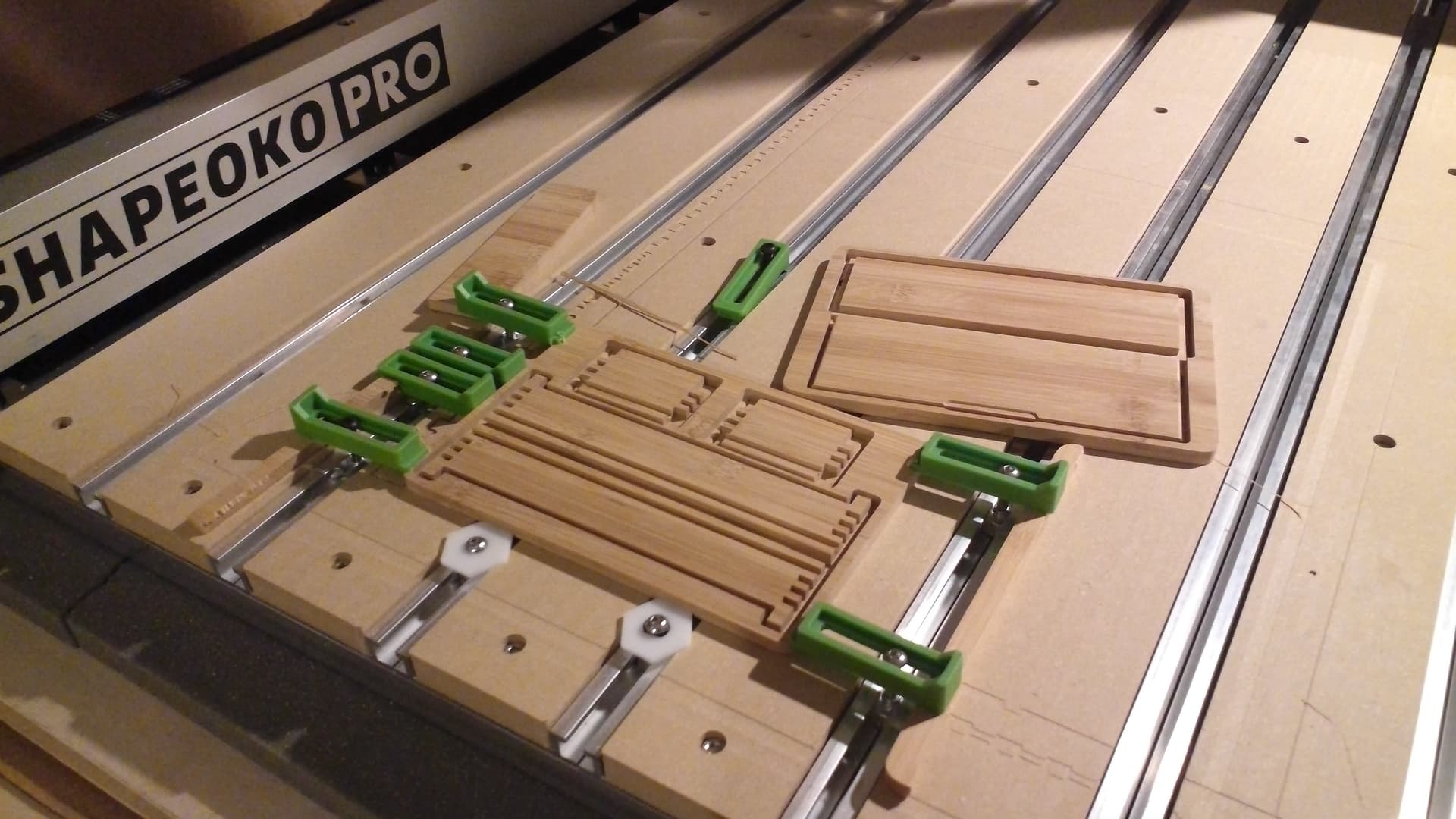

Files are at:
Design into 3D_ Pencil Case bottom and lid.c2d (742.6 KB)
Design into 3D_ Pencil Case front back and sides.c2d (921.3 KB)
Cutting (w/ a bit of adjustment reflected in the files above) went well:
separating the parts, cleaning up the edges, and drilling for hinges, glue-up and assembly will have to wait the morrow.
