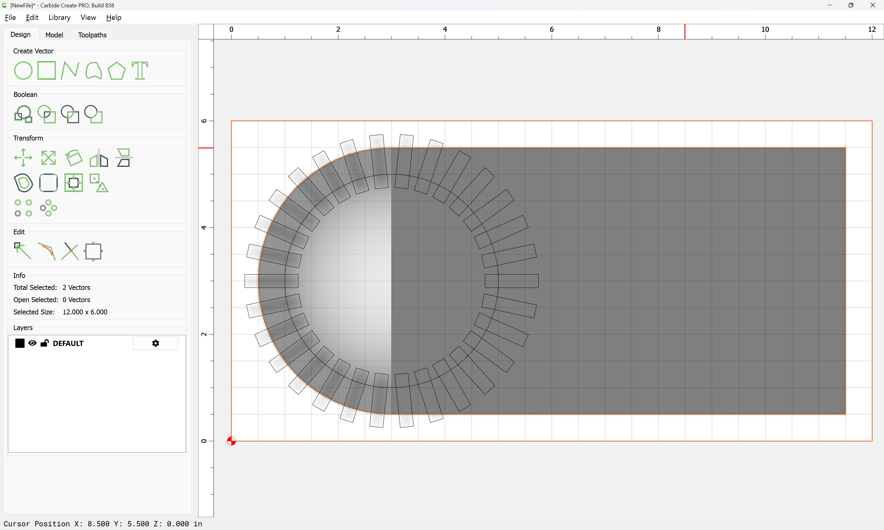

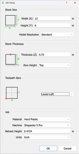

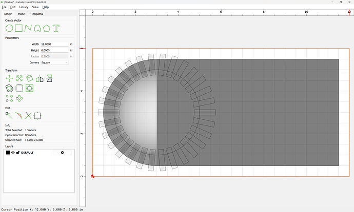

Making a wooden mold for making empanadas (or similar dumplings)
as requested on support…

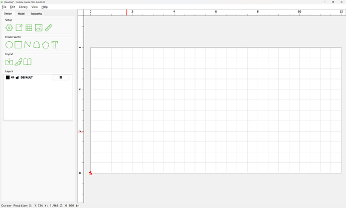

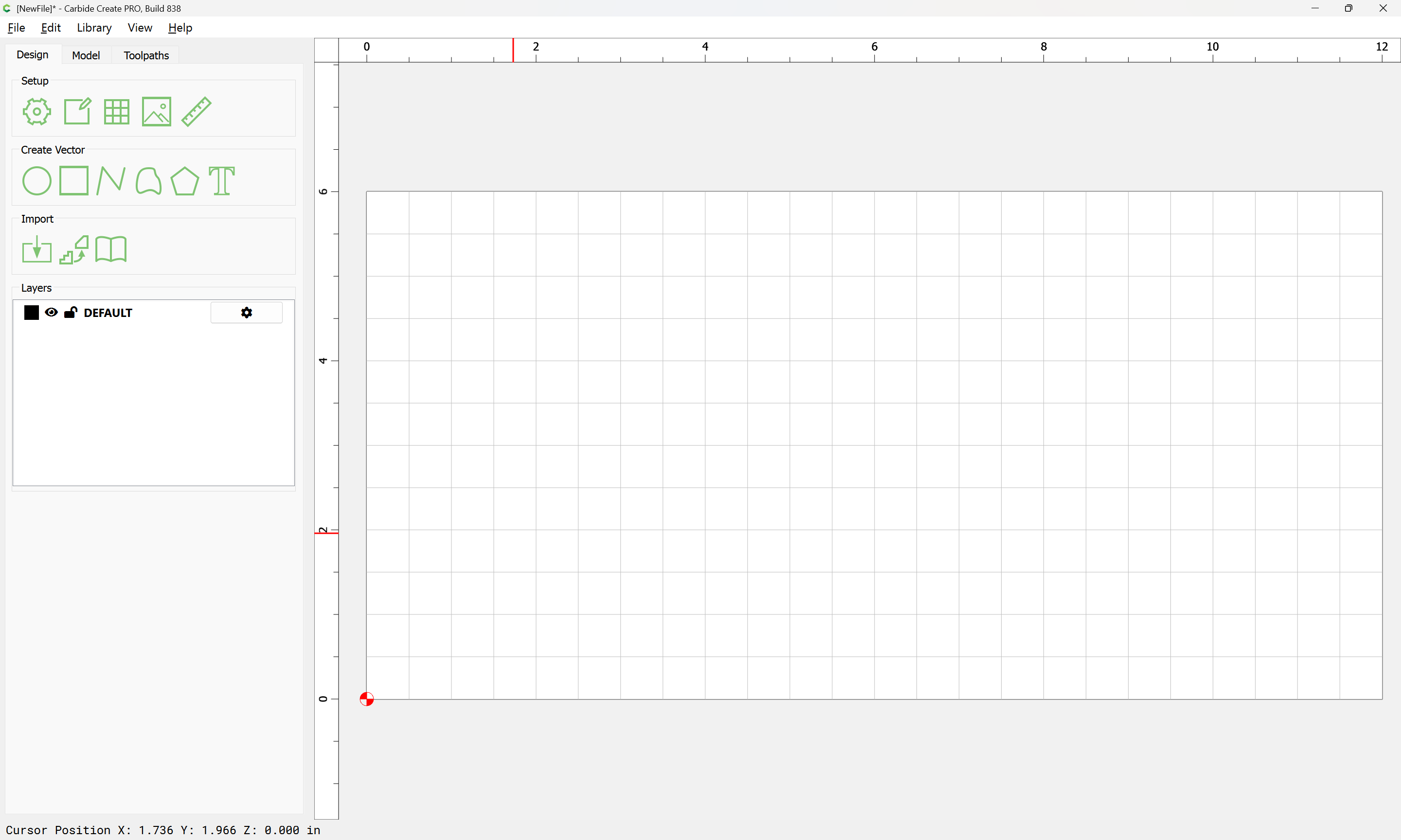

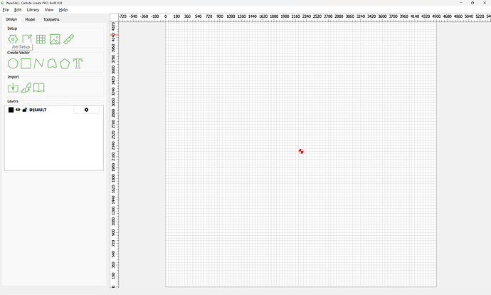

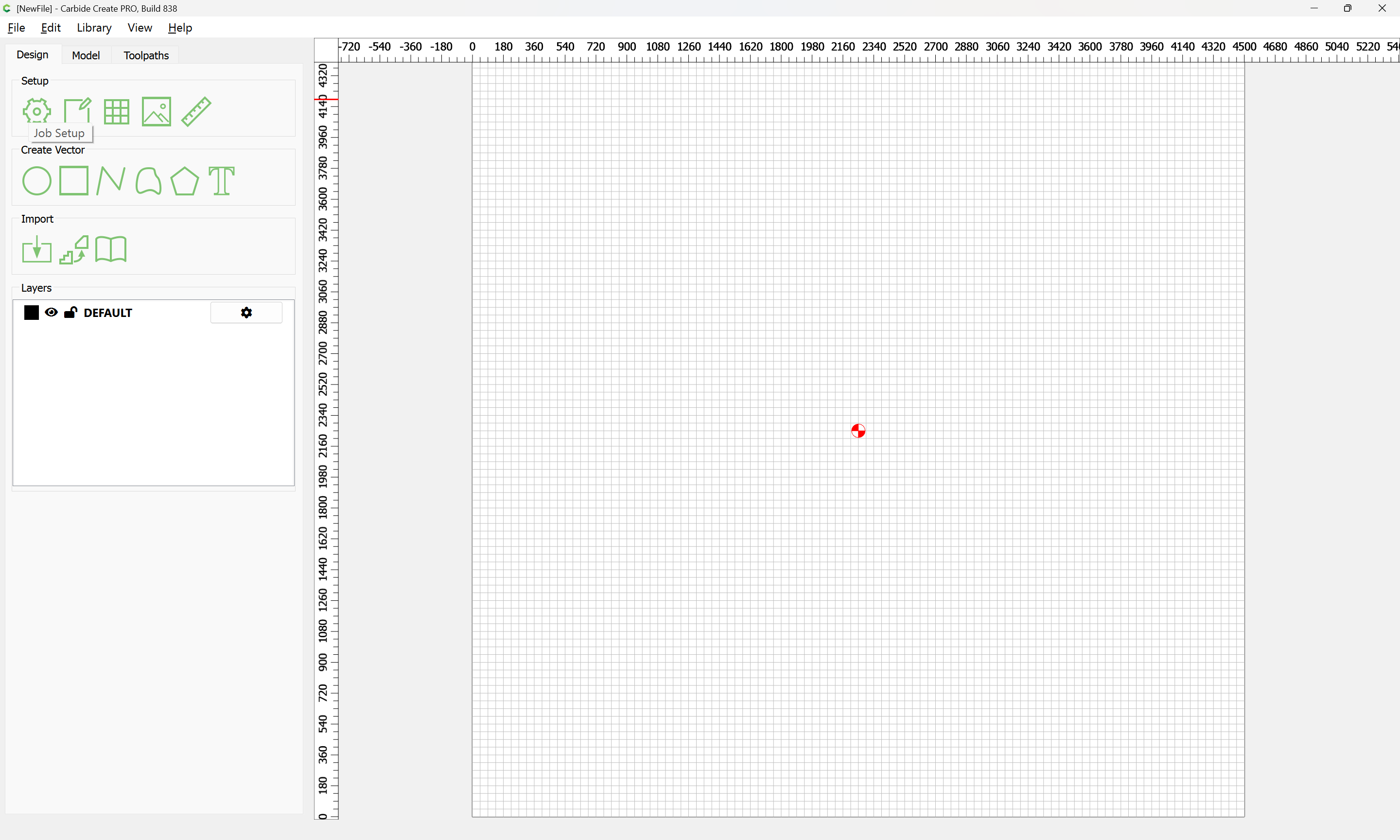

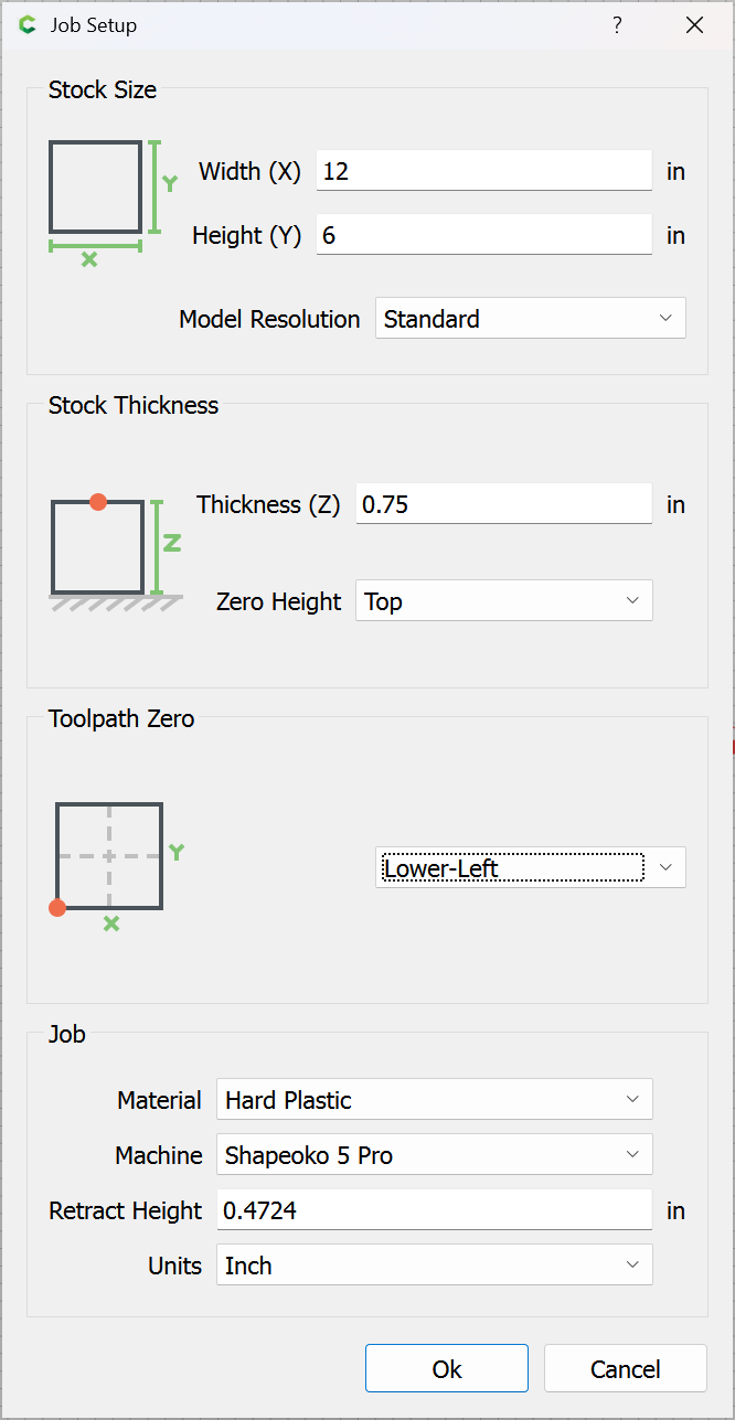

Launch Carbide Create:
go into Job Setup:
Ok

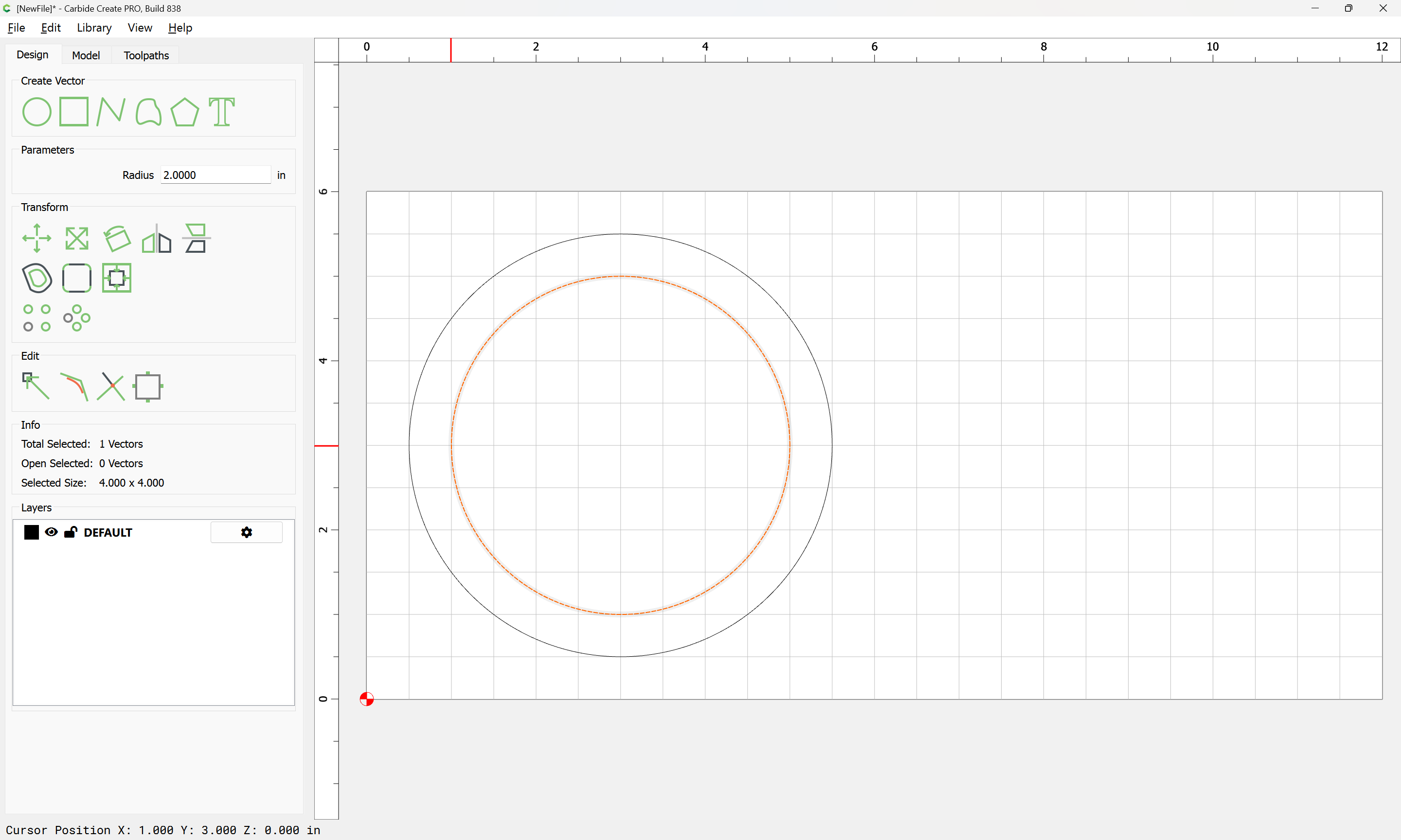

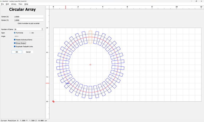

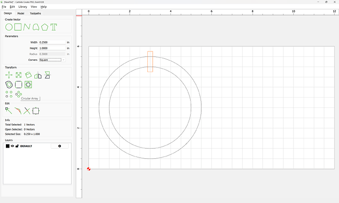

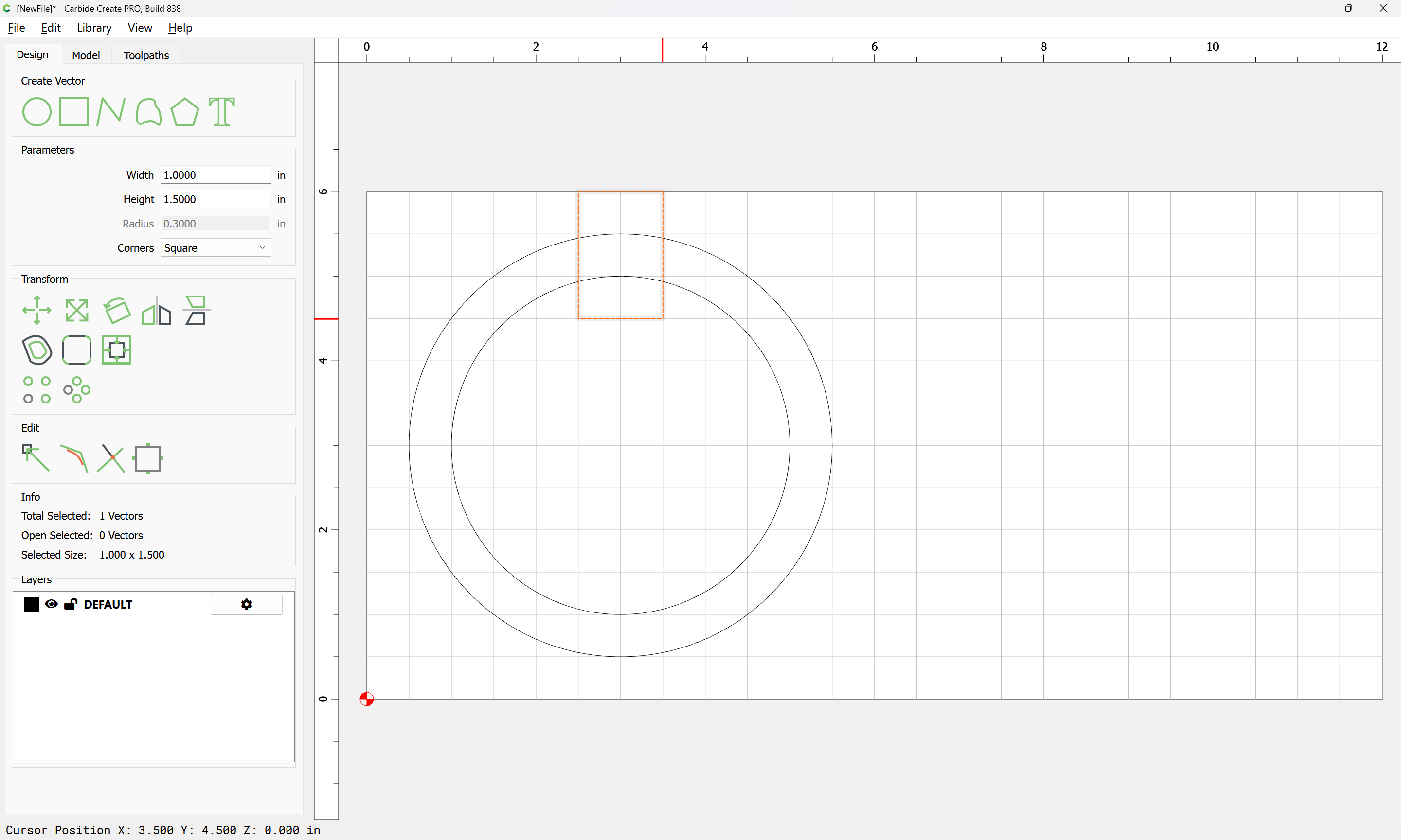

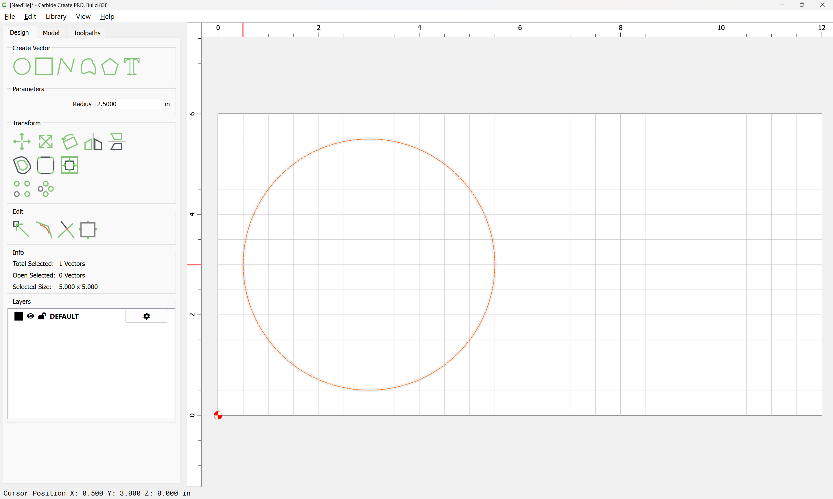

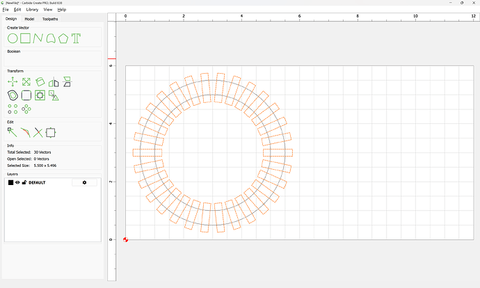

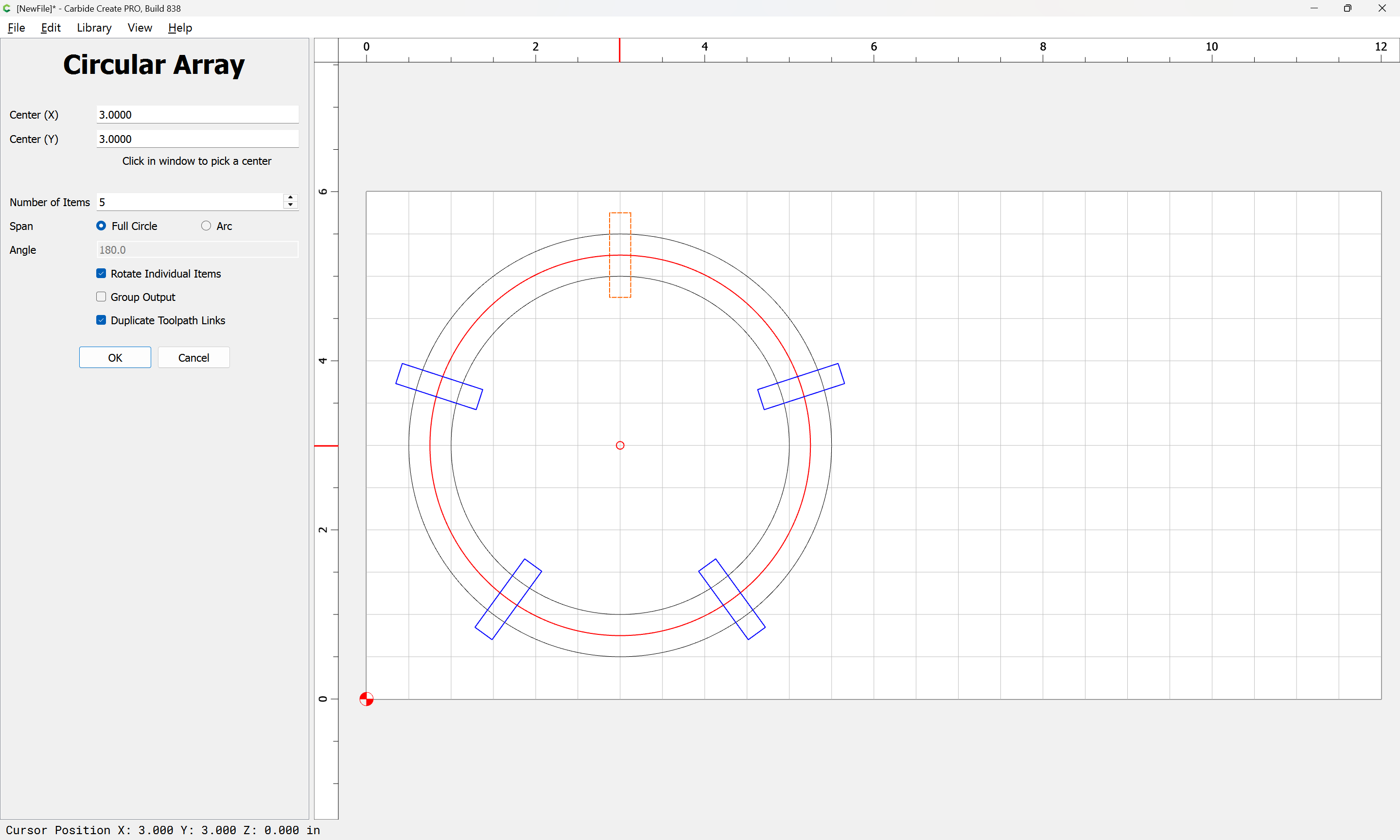

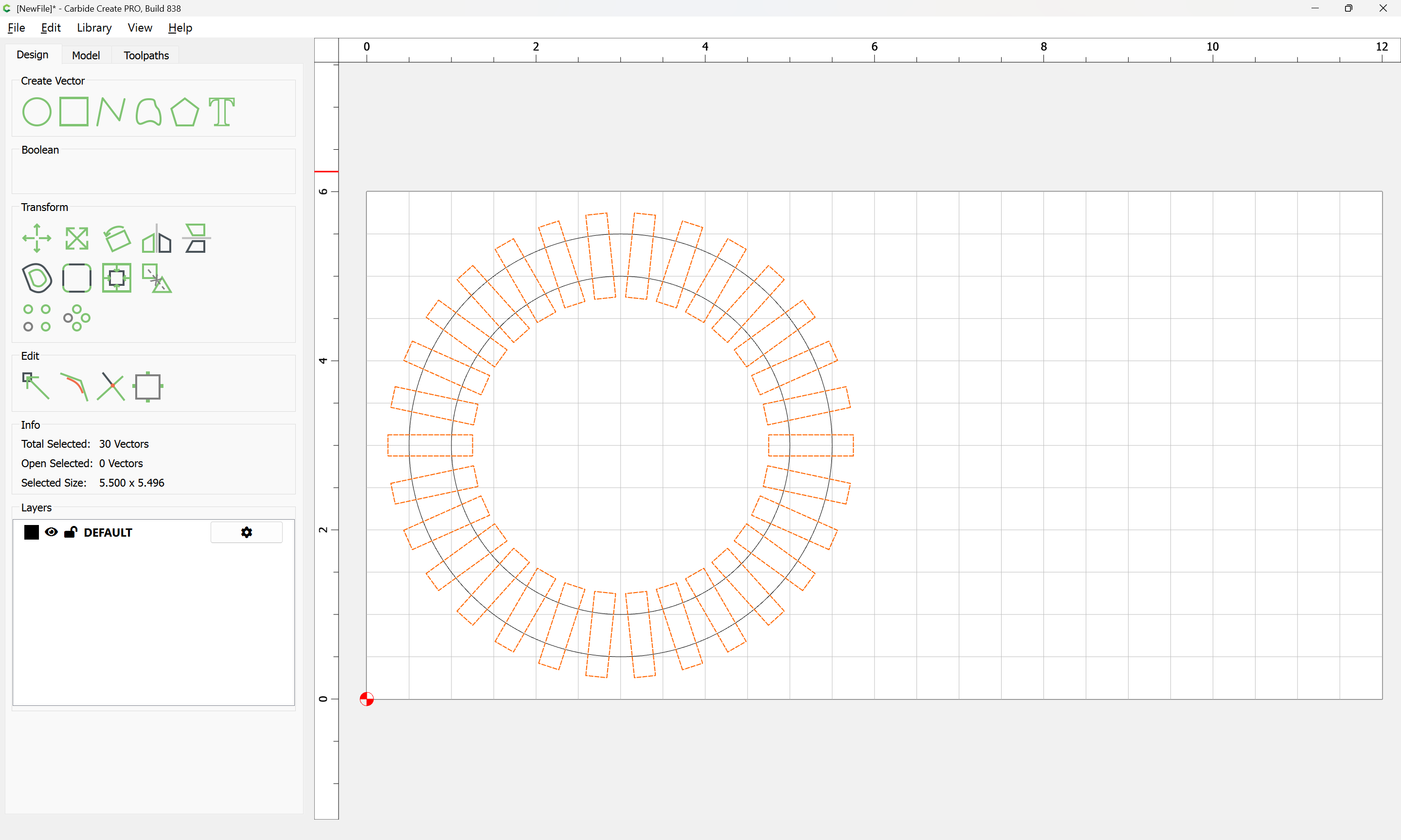

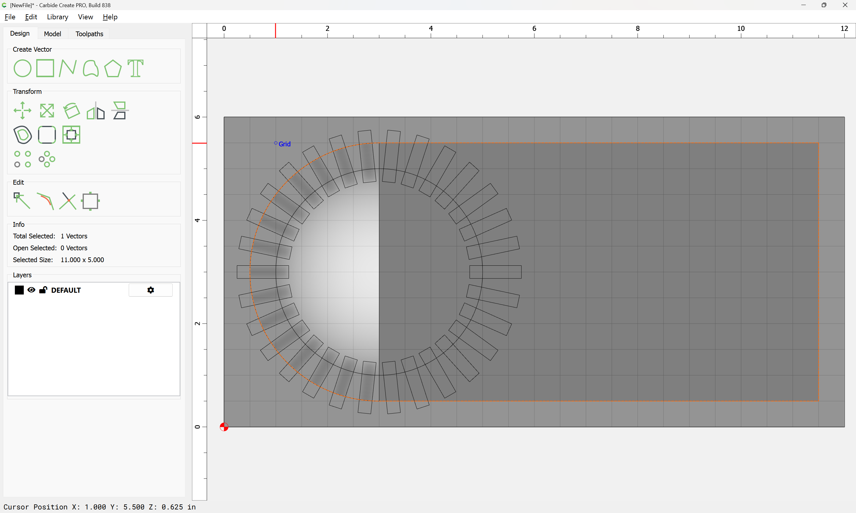

Draw a circle for the overall shape:
and an inner circle:

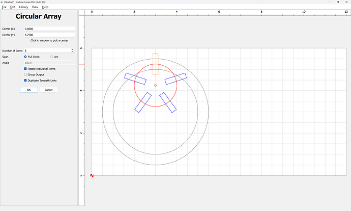

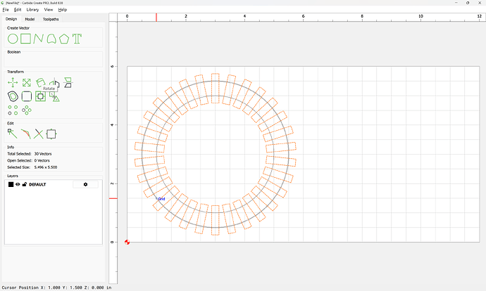

Then draw a rectangle for making an indentation:
adjusting the size:

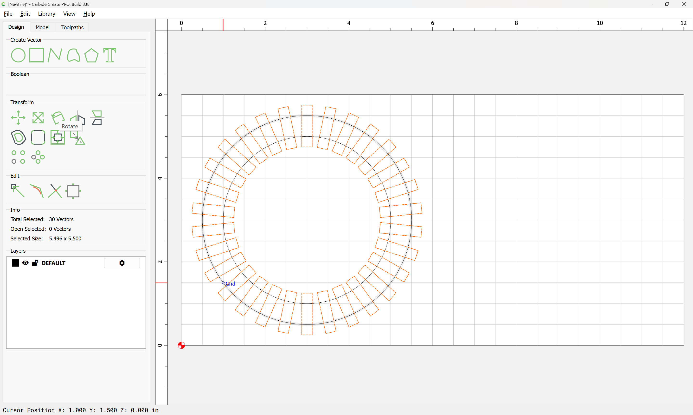

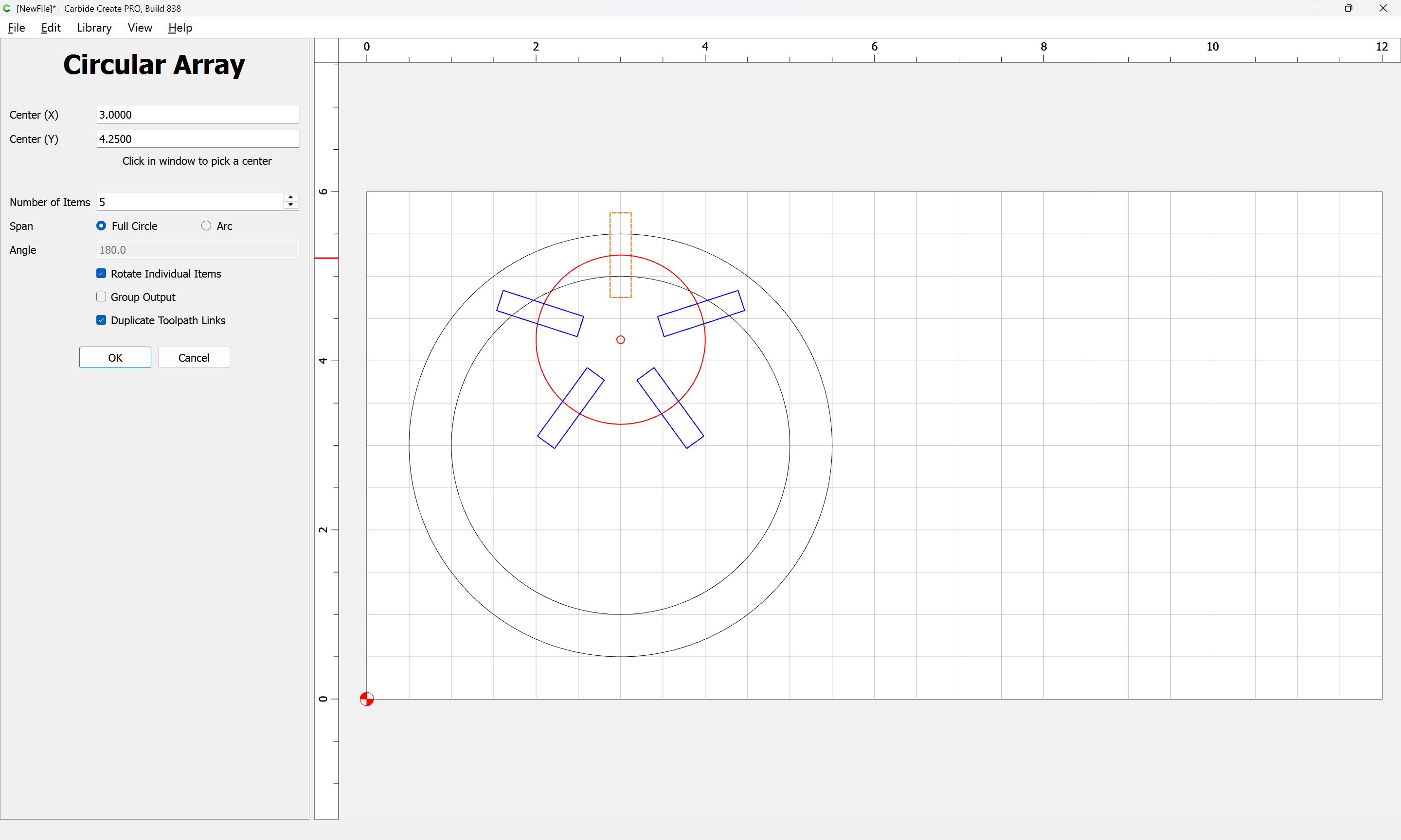

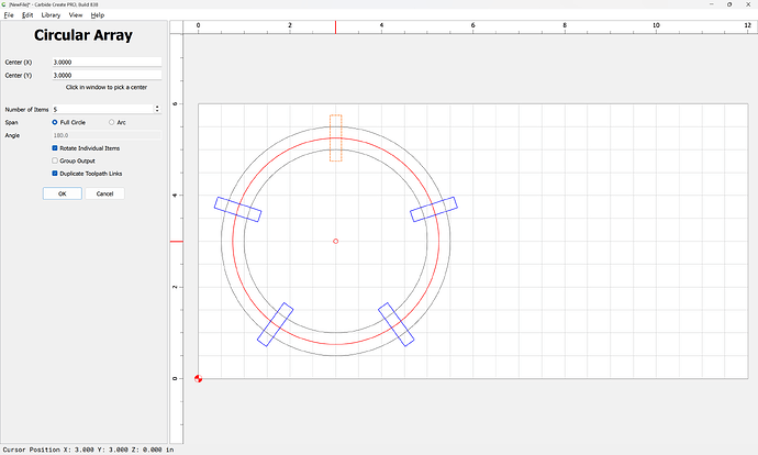

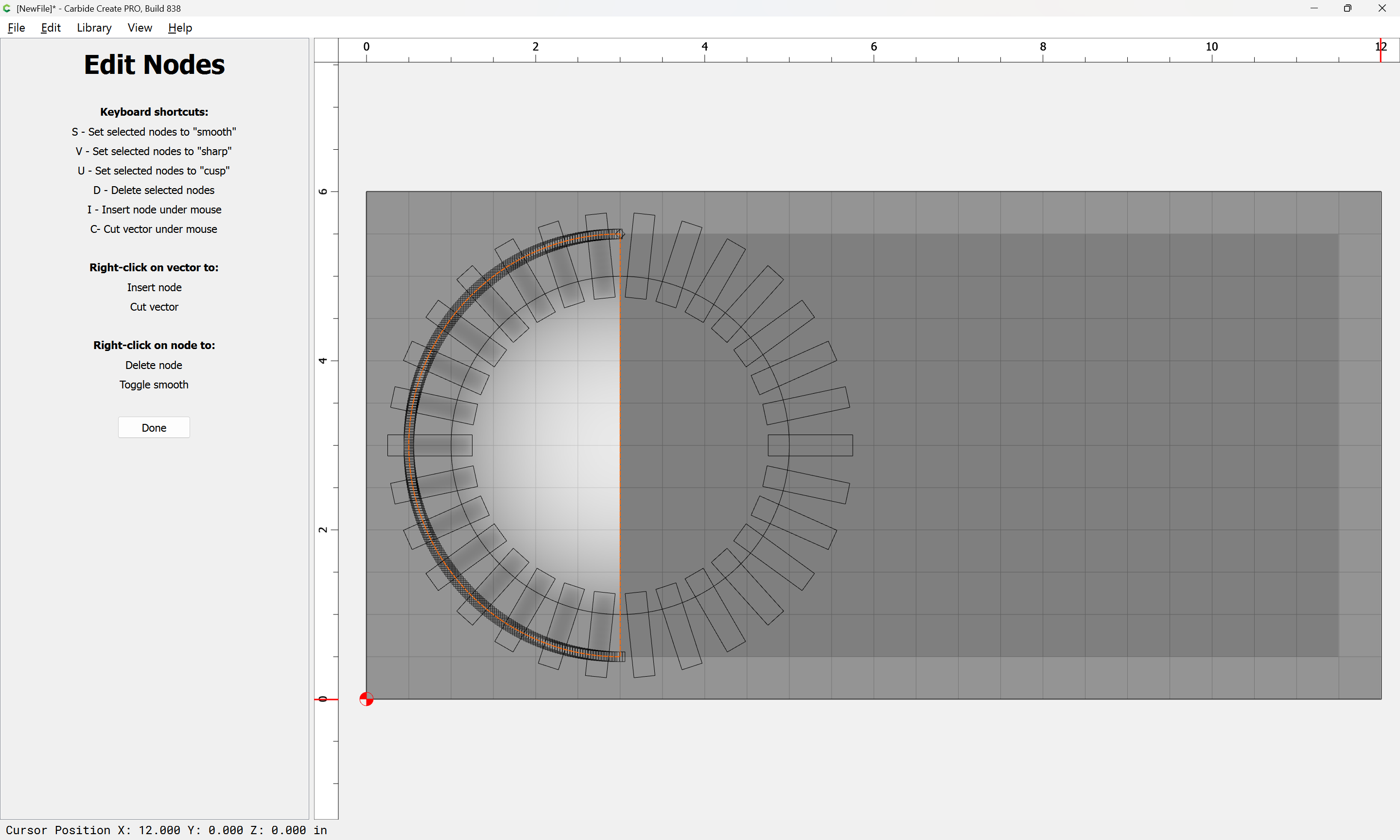

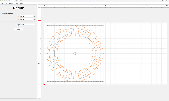

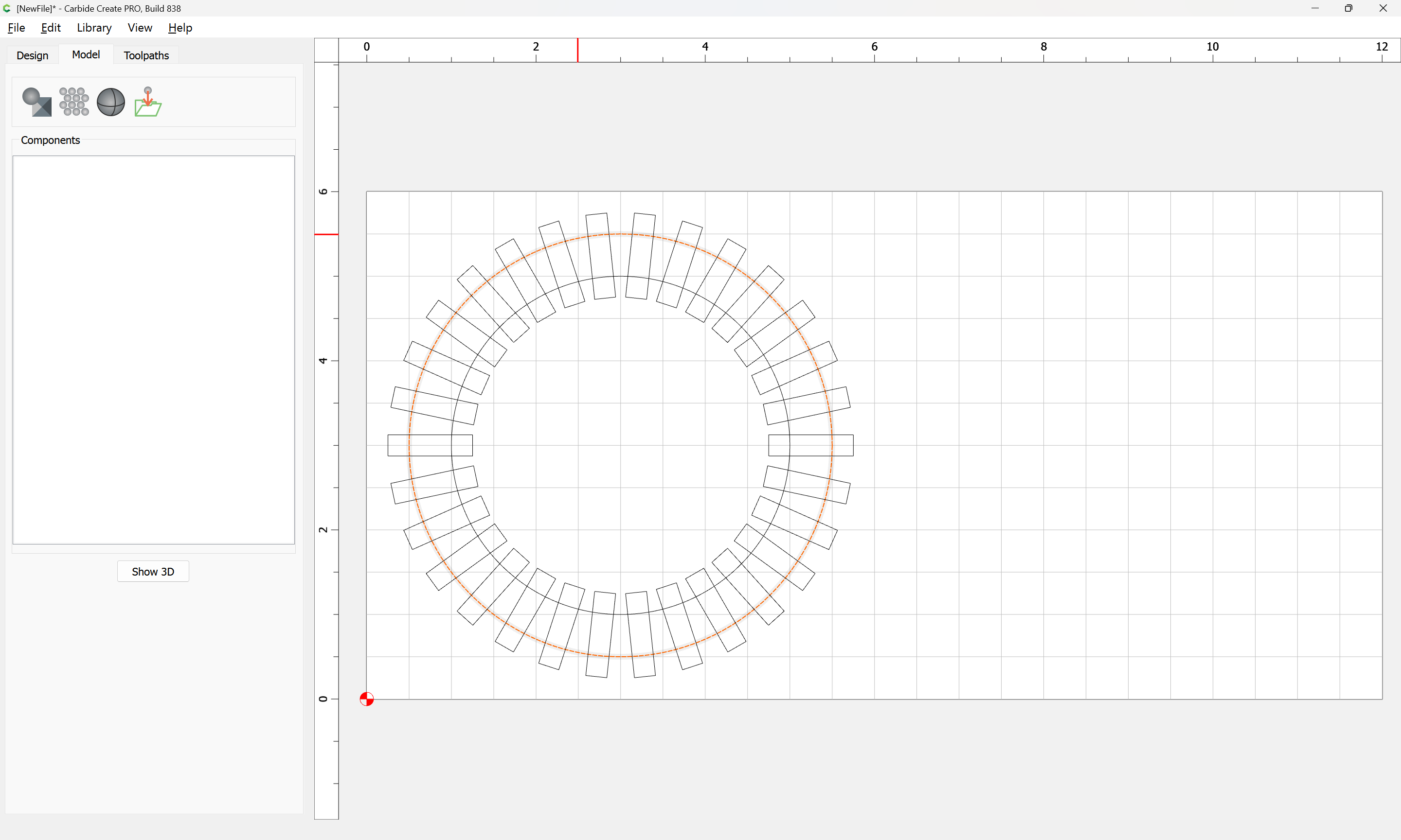

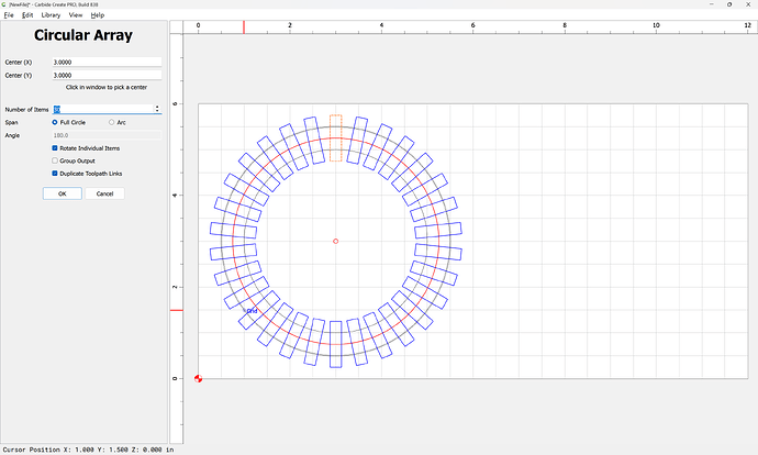

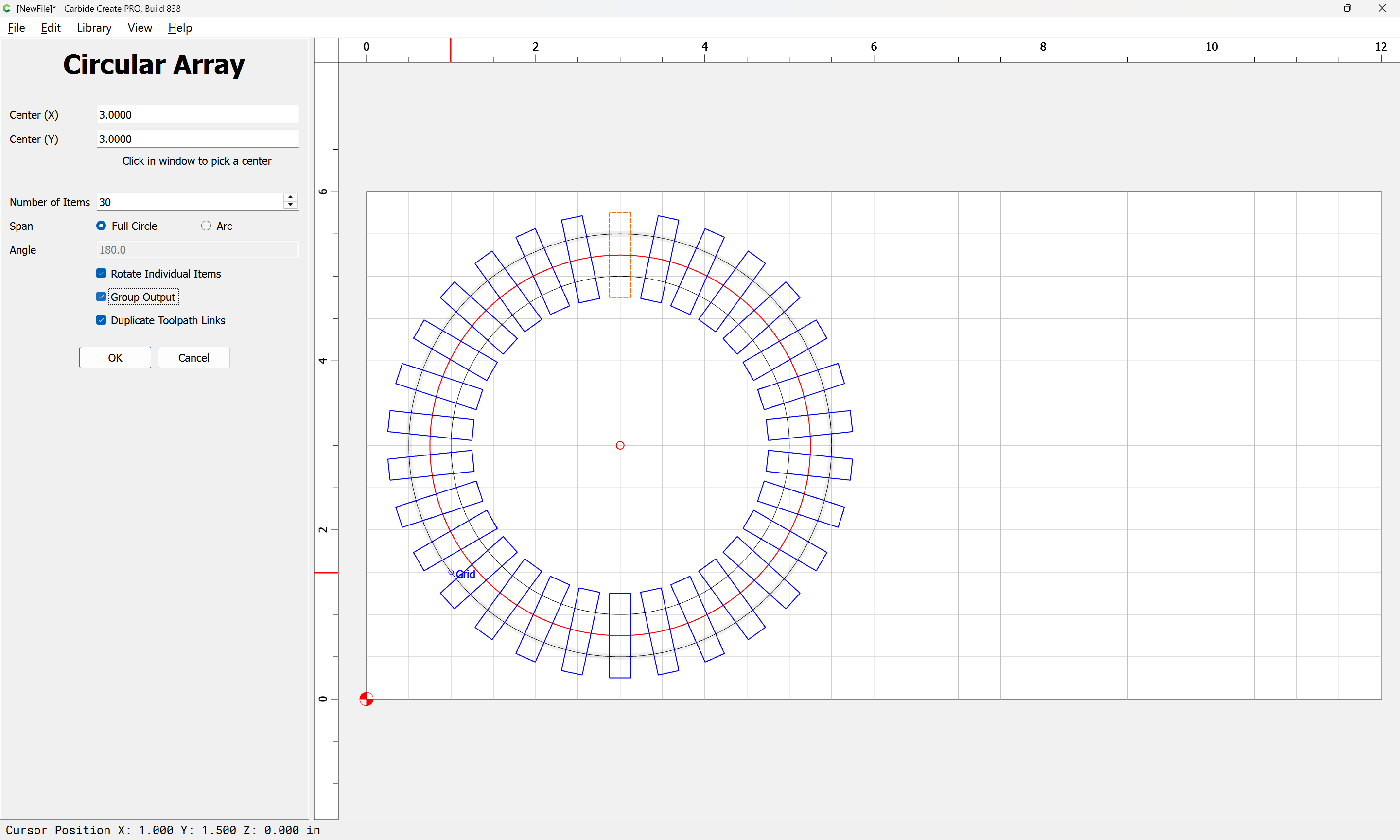

and then use Circular Array to duplicate it around the edge:
Drag the center into position:
and then adjust the number:
Group Output
OK

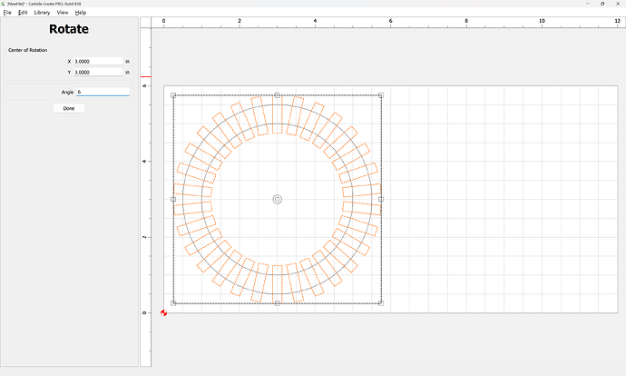

then rotate a bit:
Done

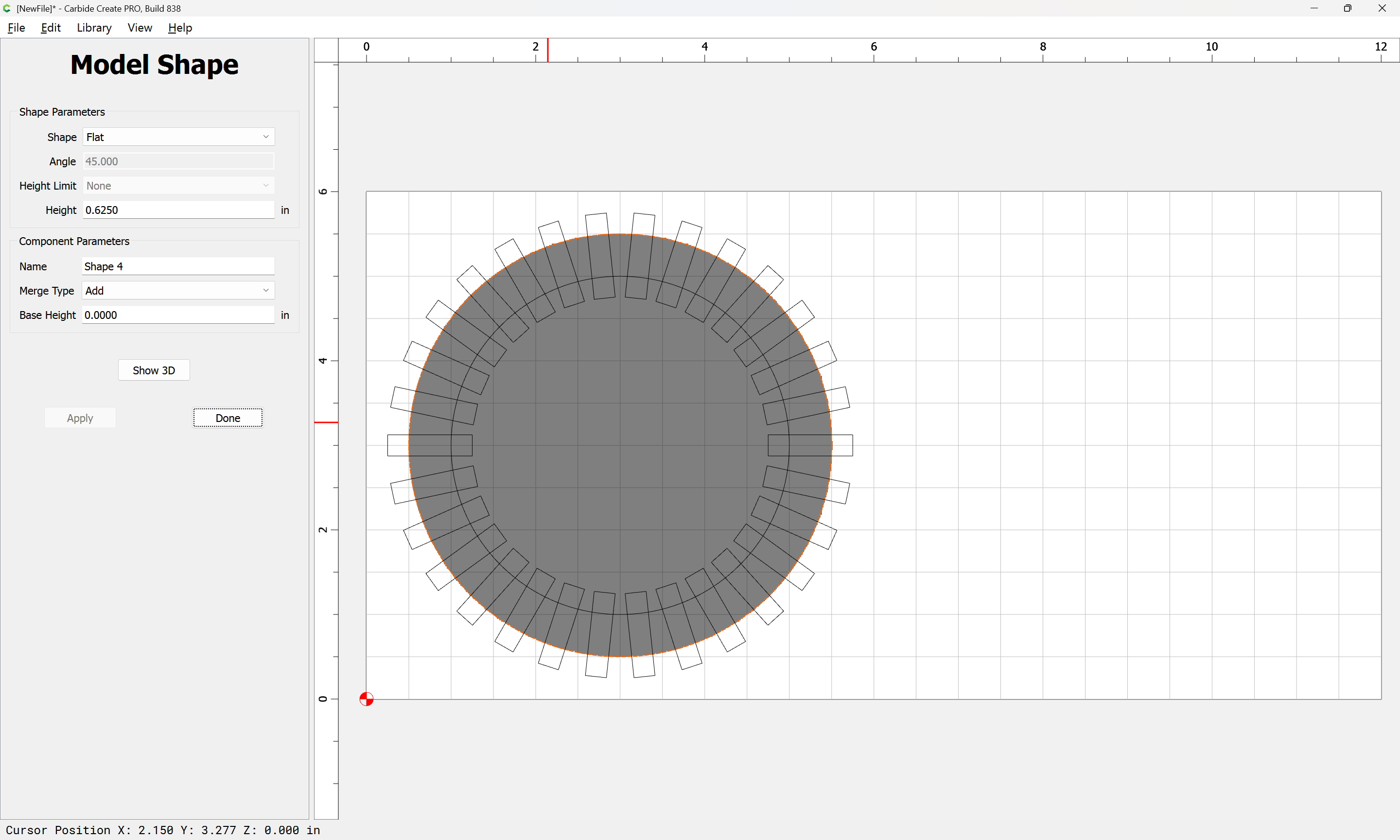

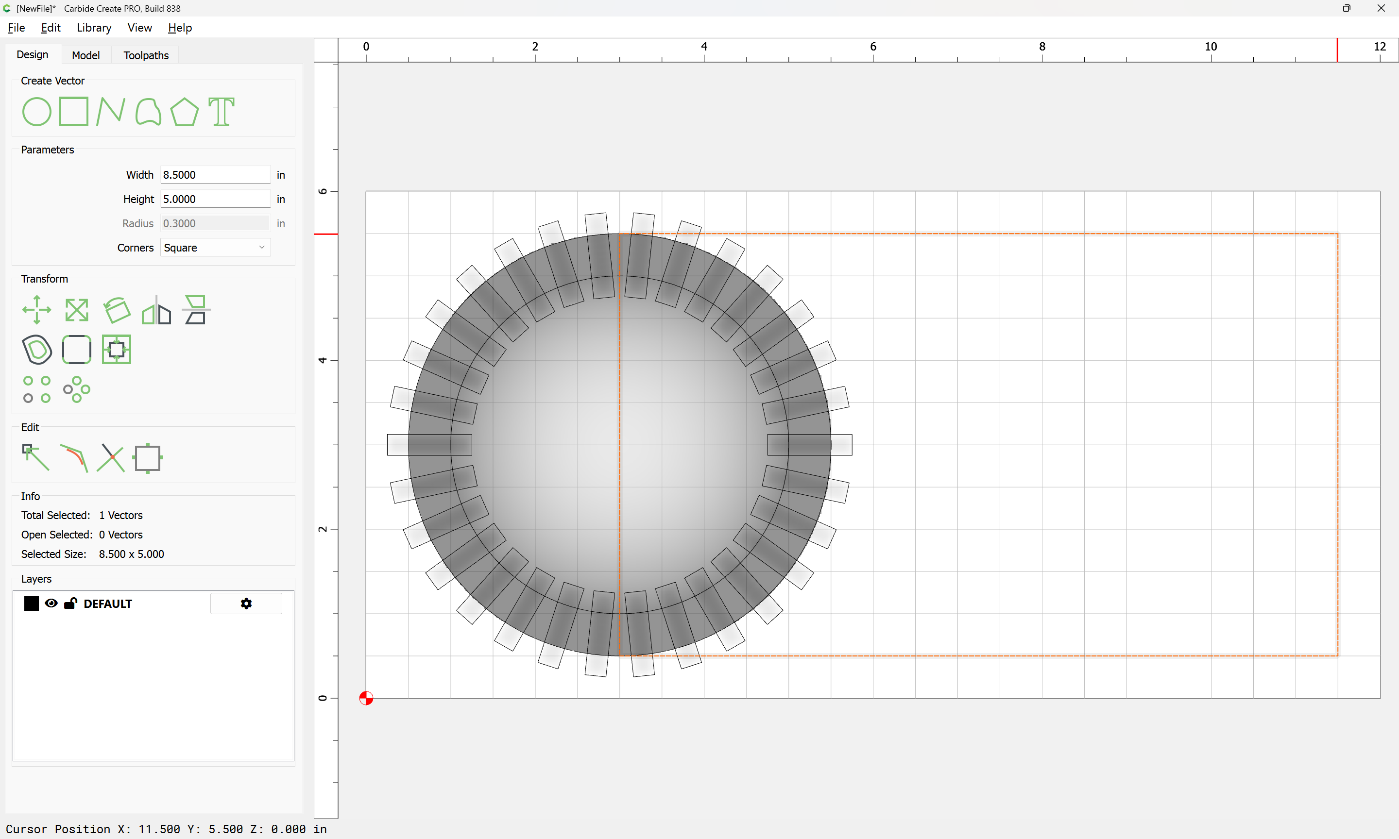

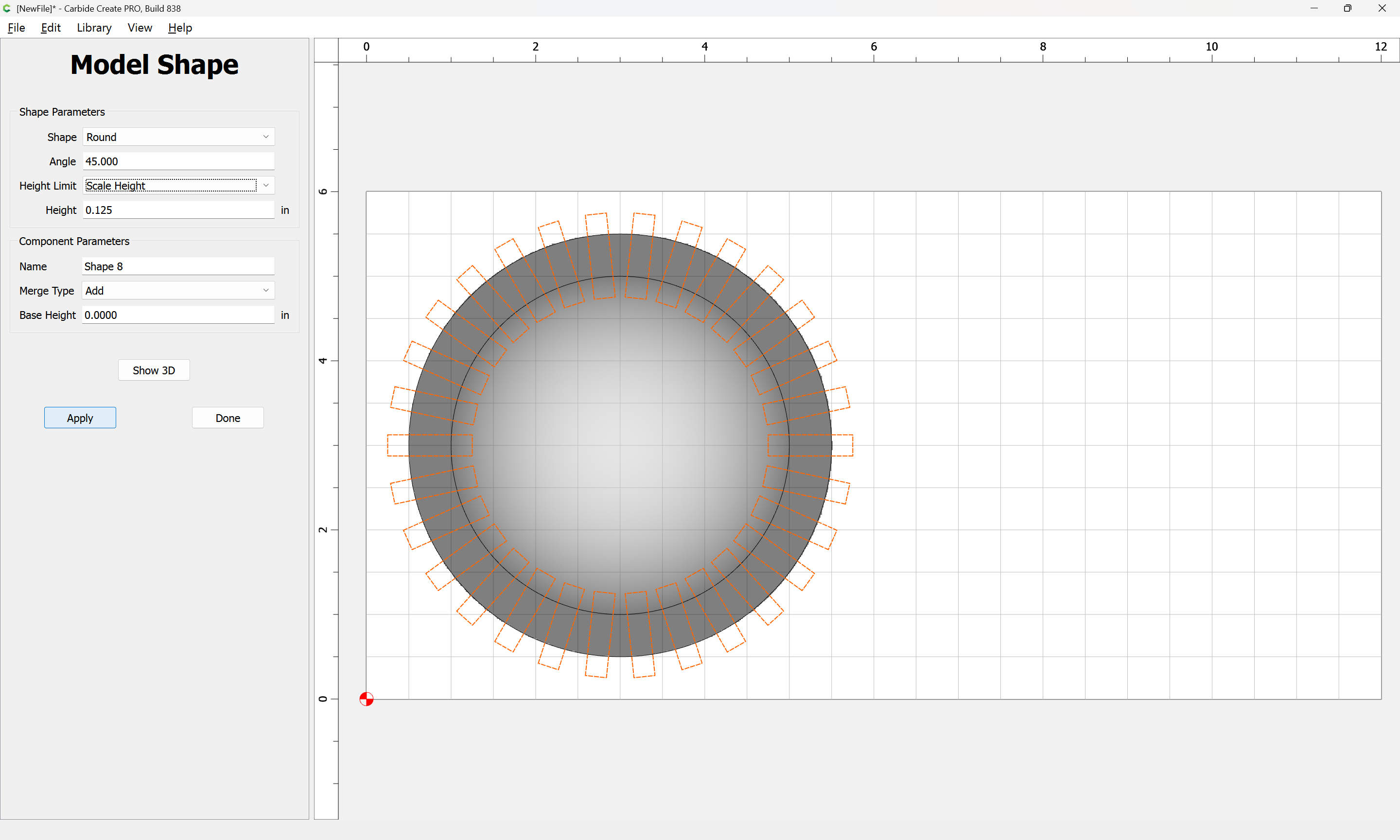

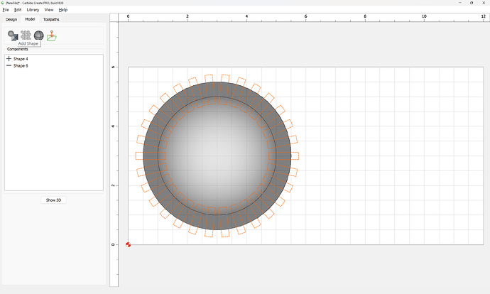

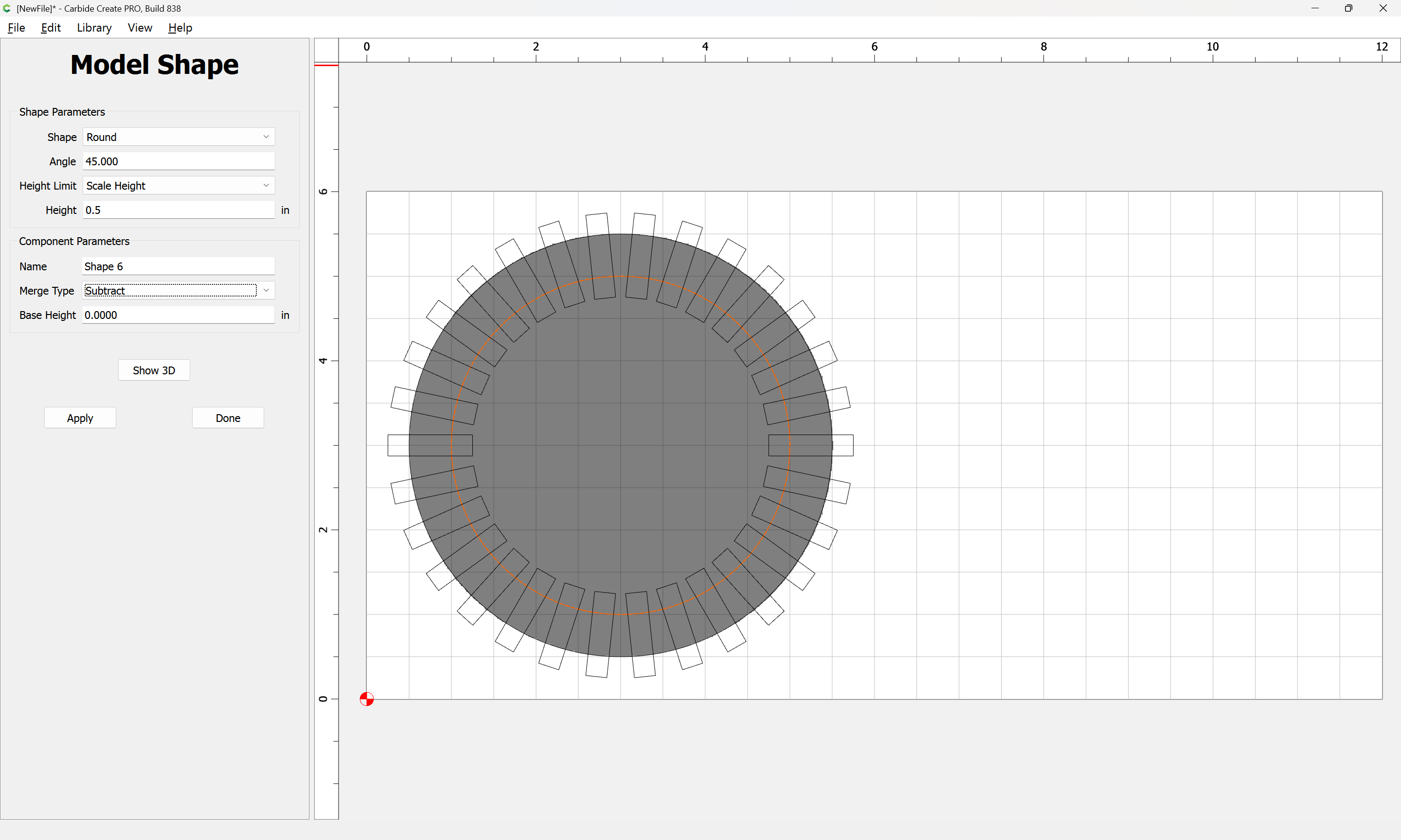

then go to 3D modeling:

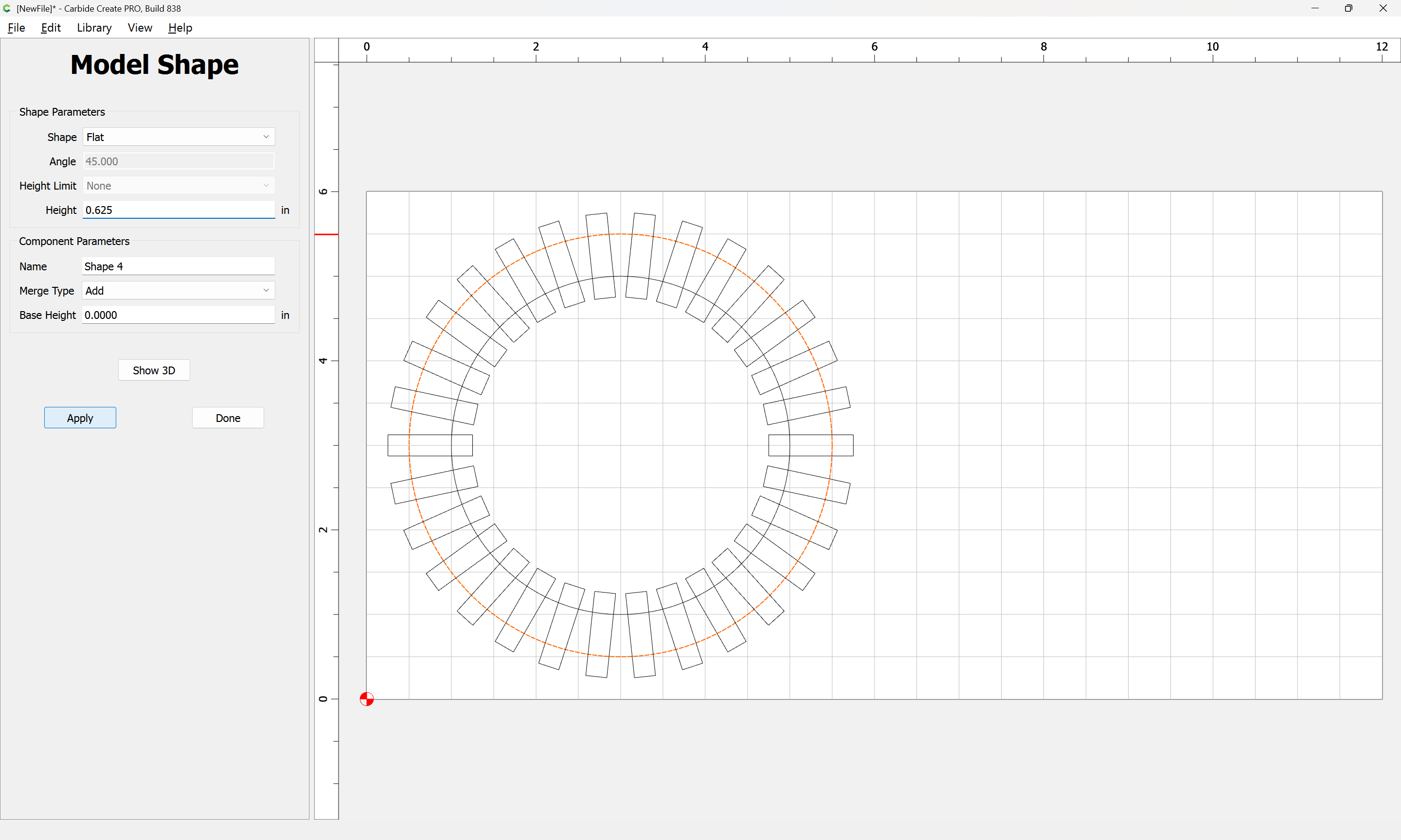

select the circle and model it:
Apply
Done

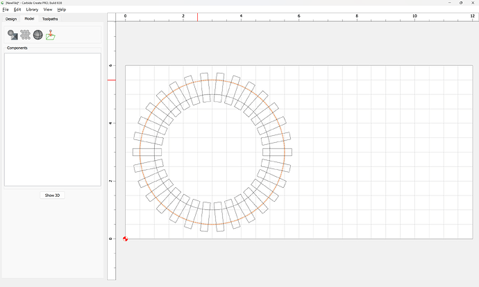

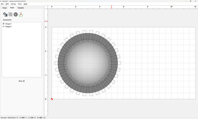

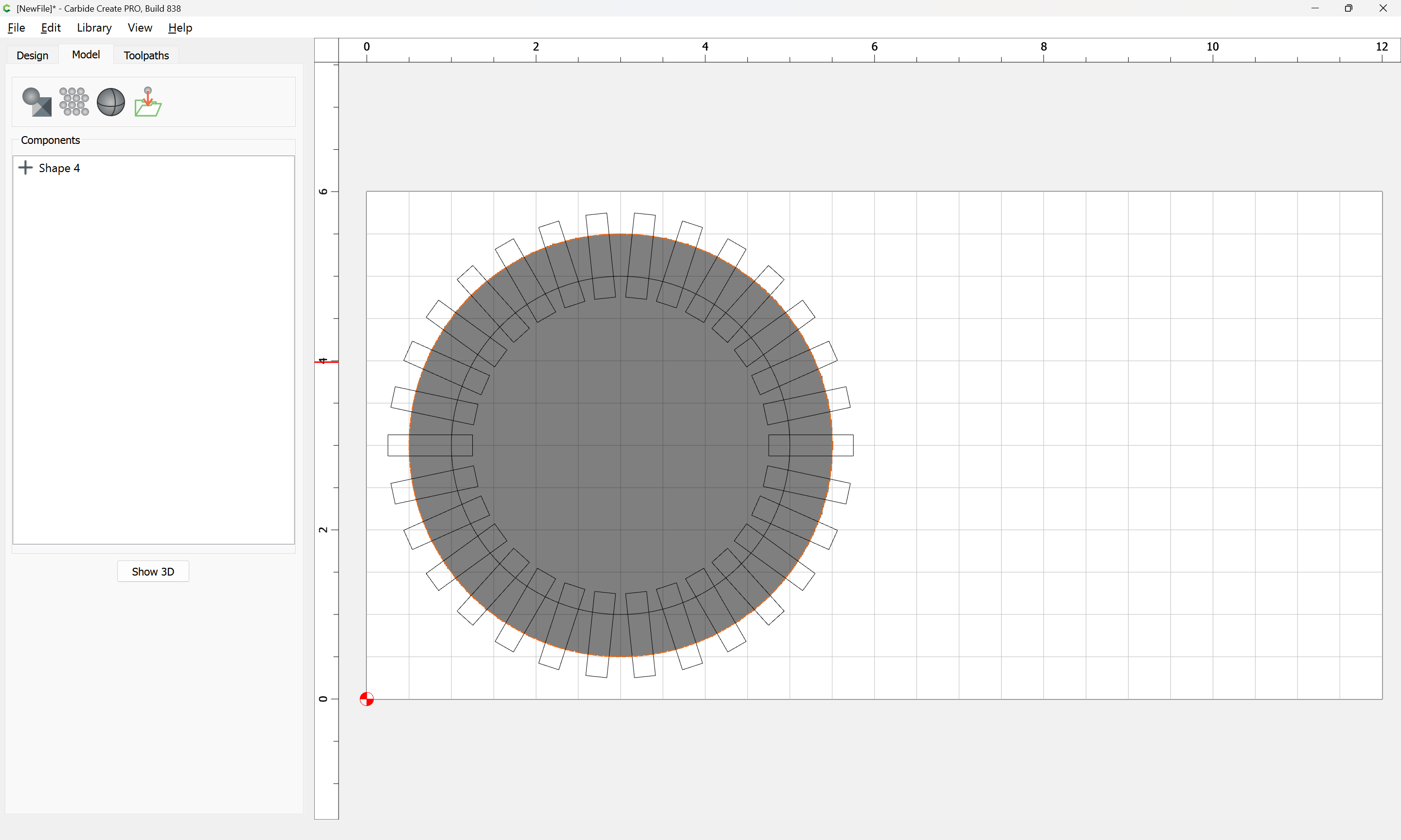

Select the inner circle:
and subtract it:
Done

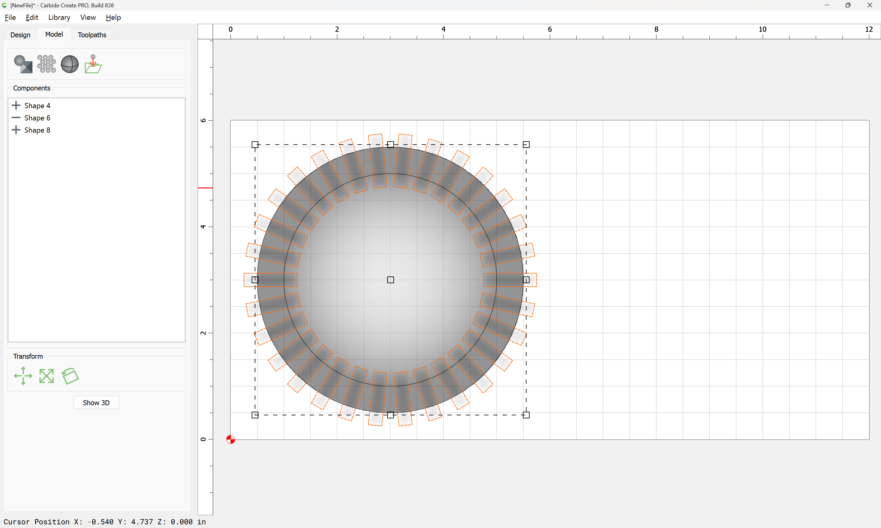

Select the small rectangles:
and model them to create the edge/indentations:
Apply
Done

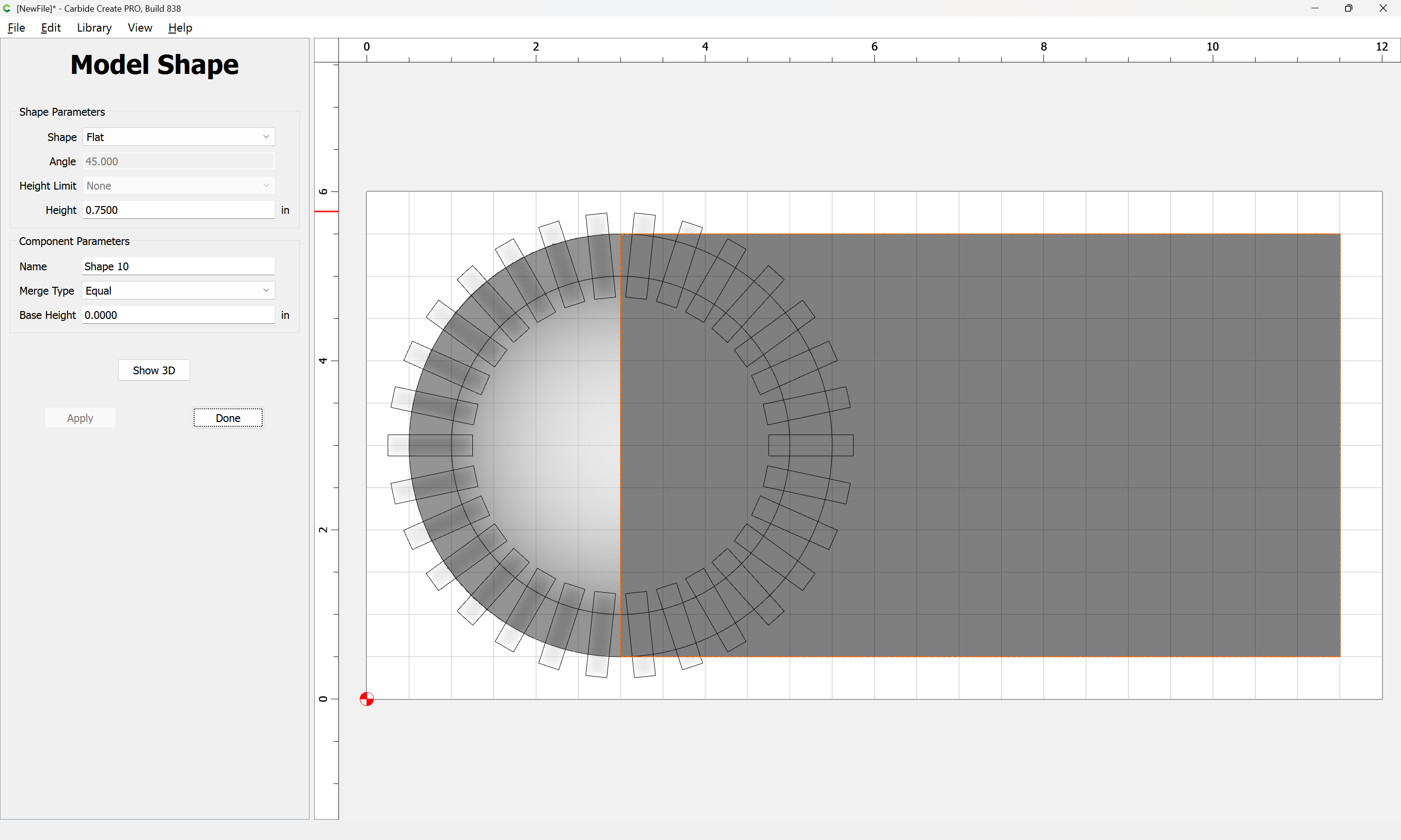

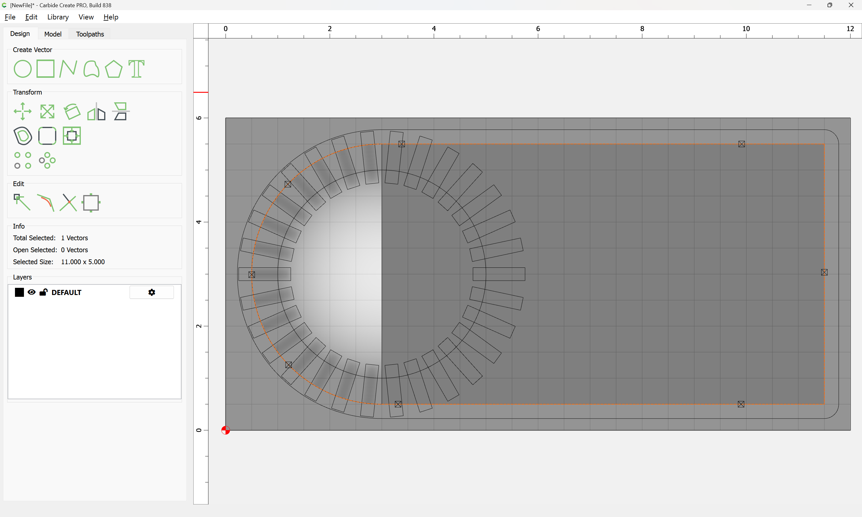

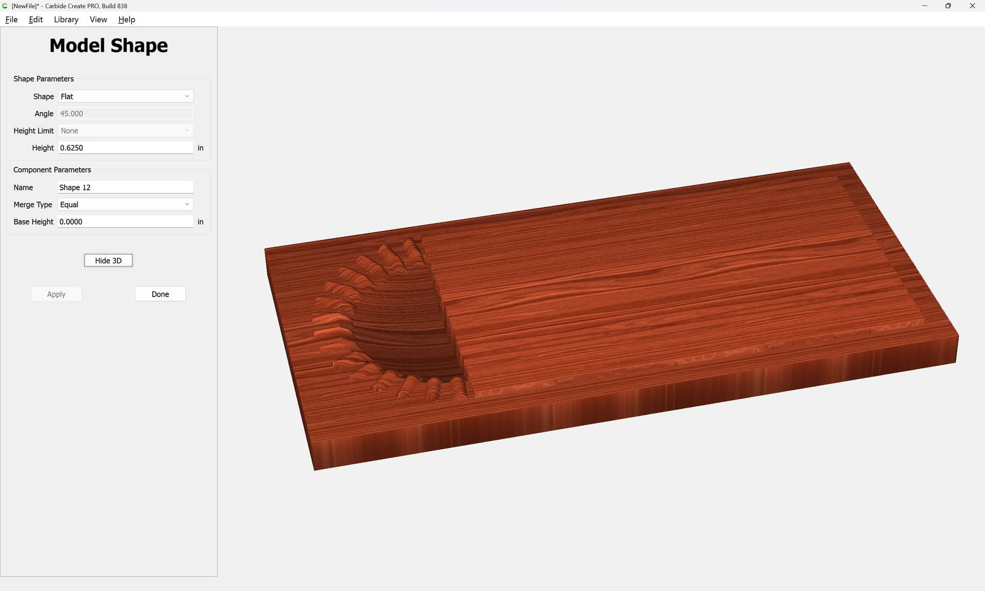

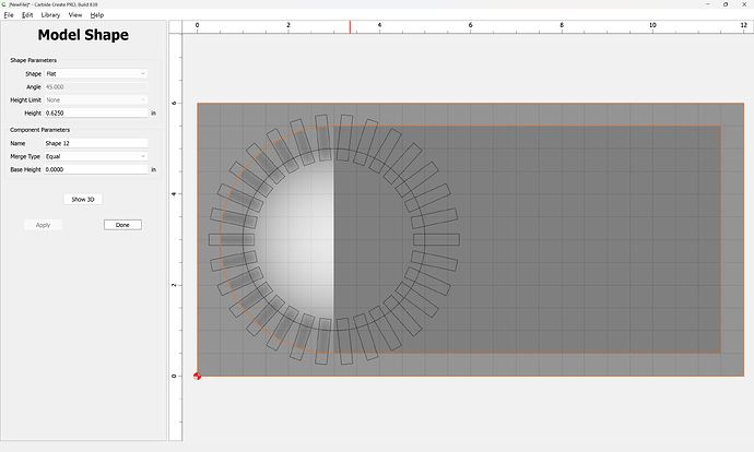

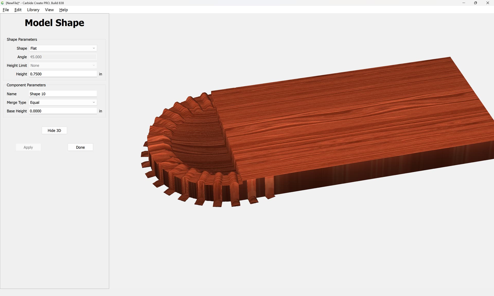

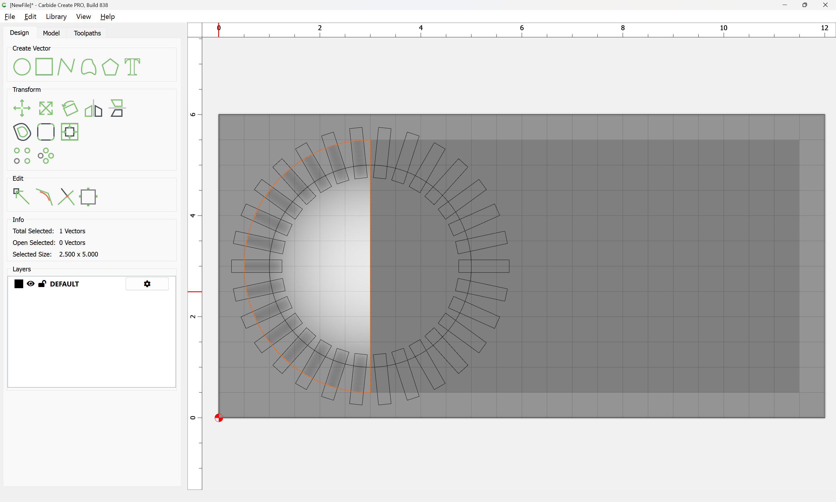

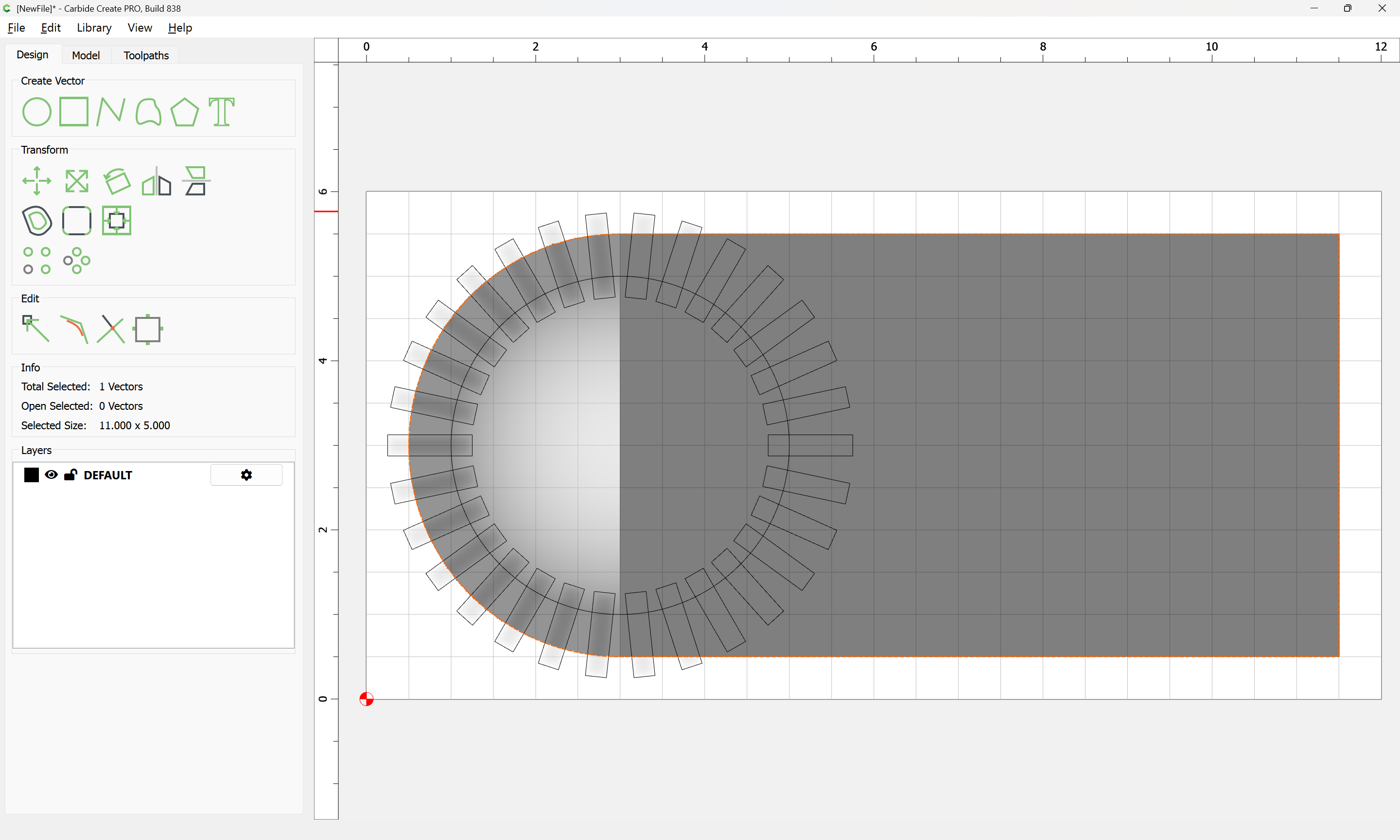

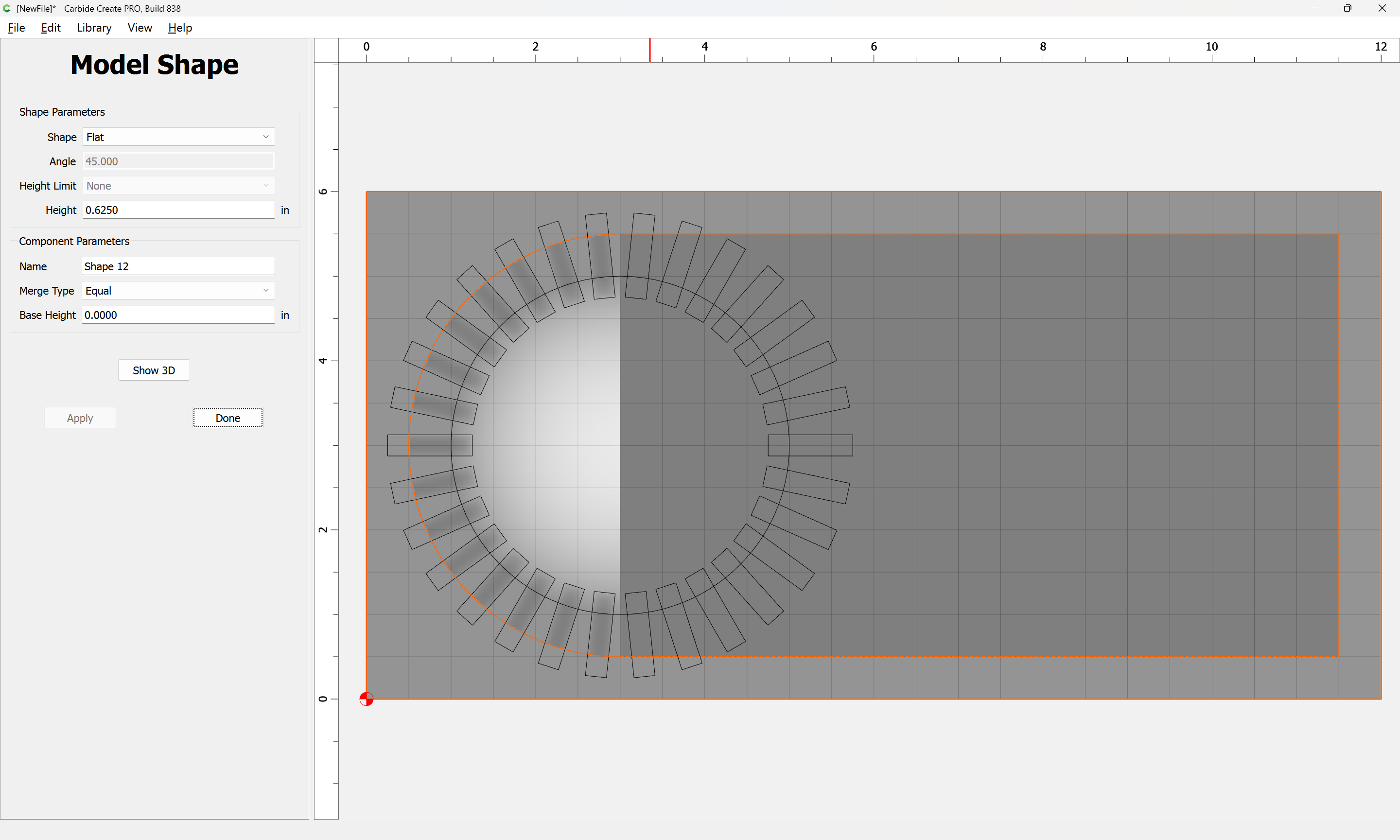

Draw in a rectangle for the flat portion:
and model it:
Apply
Show 3D:

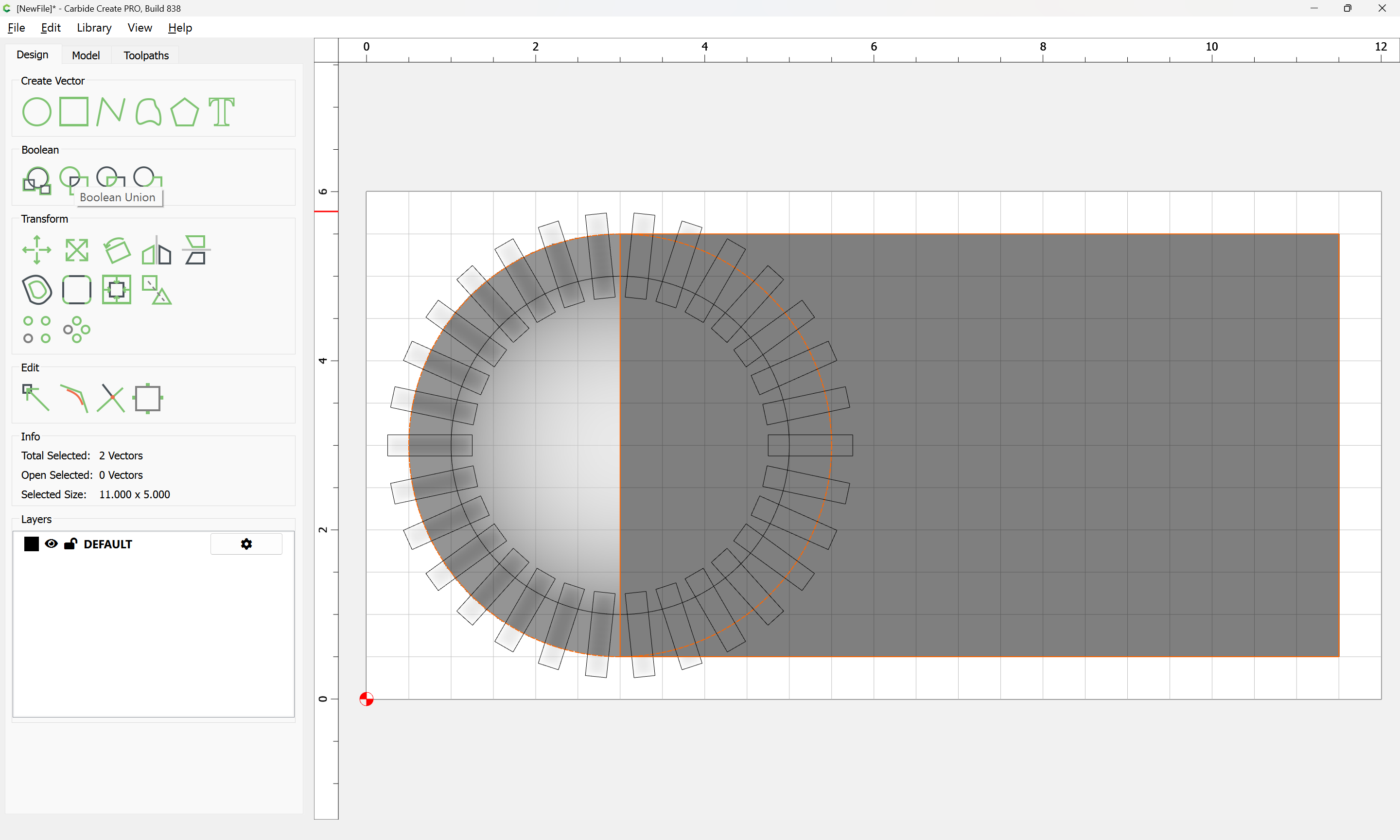

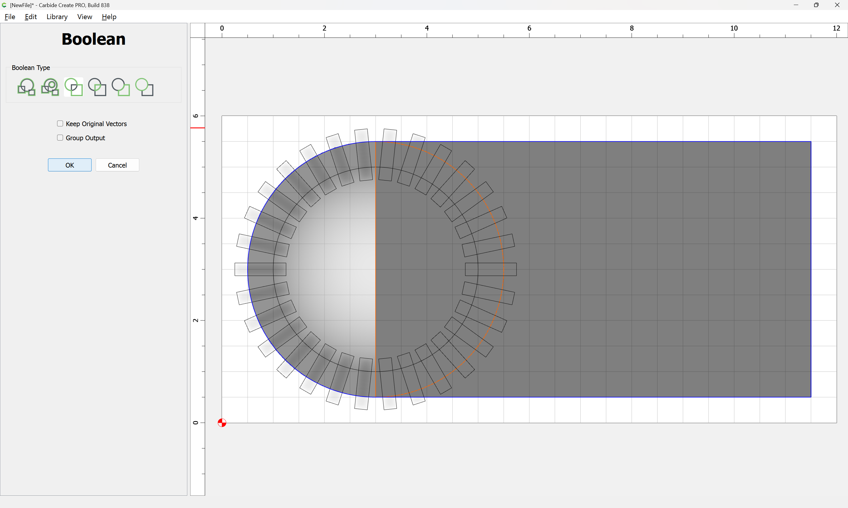

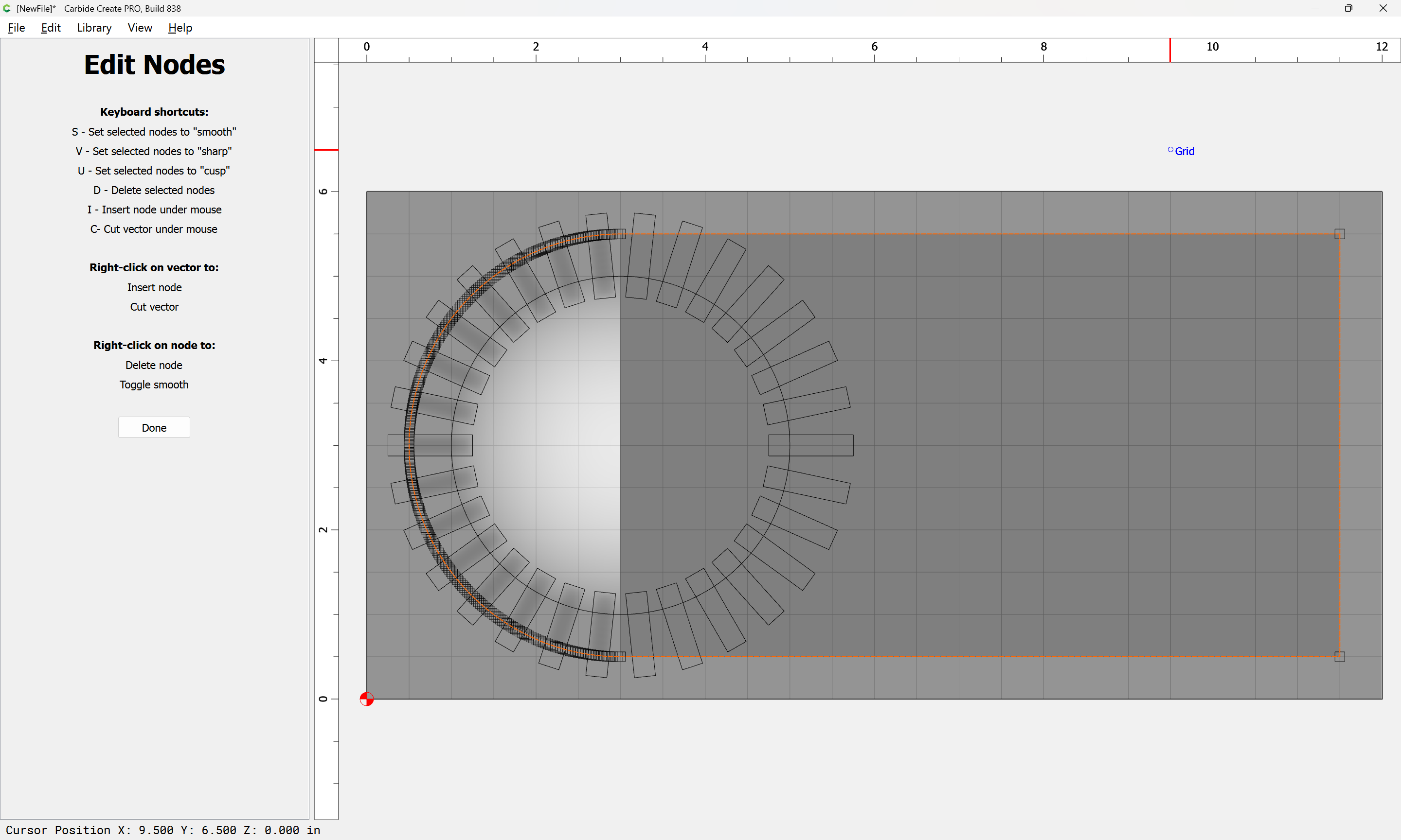

To clean up the edges:
Boolean union the two outer shapes:
OK

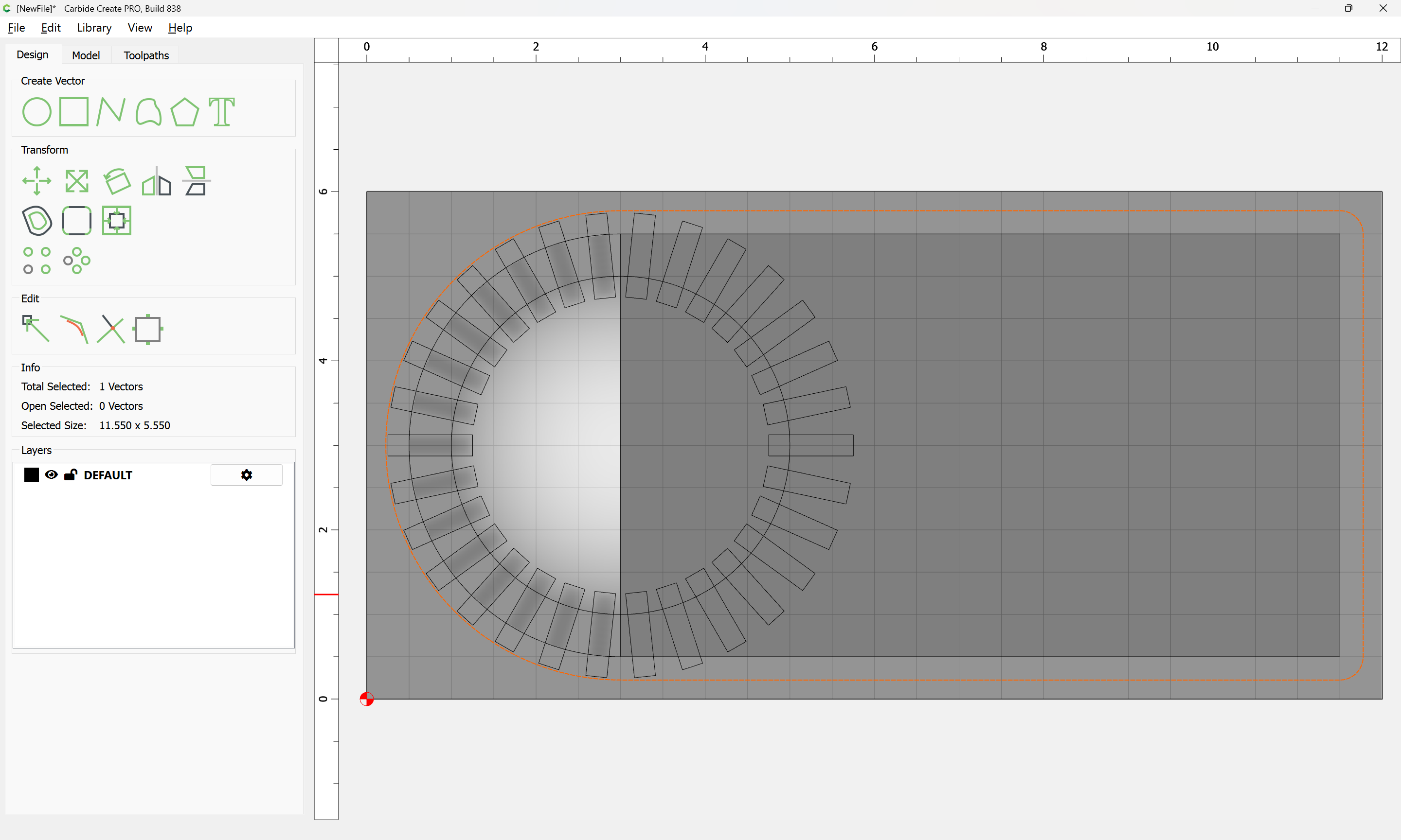

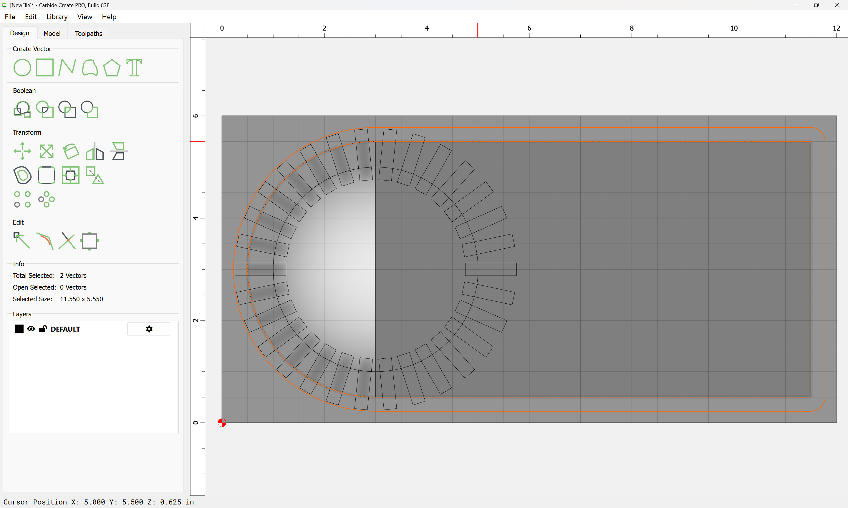

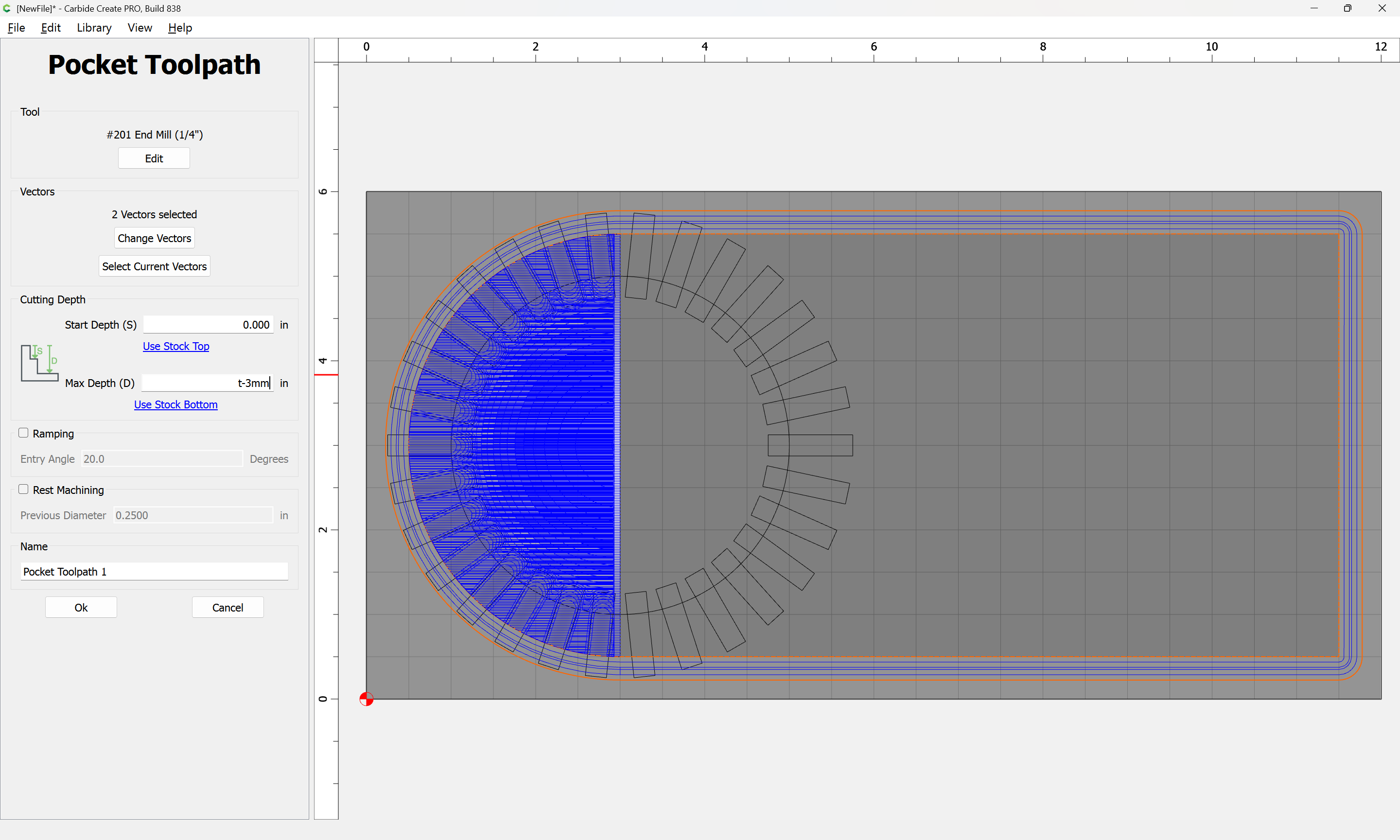

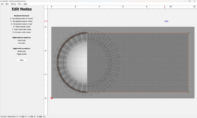

Draw in the stock:
Select the geometries which define the surround:
Apply

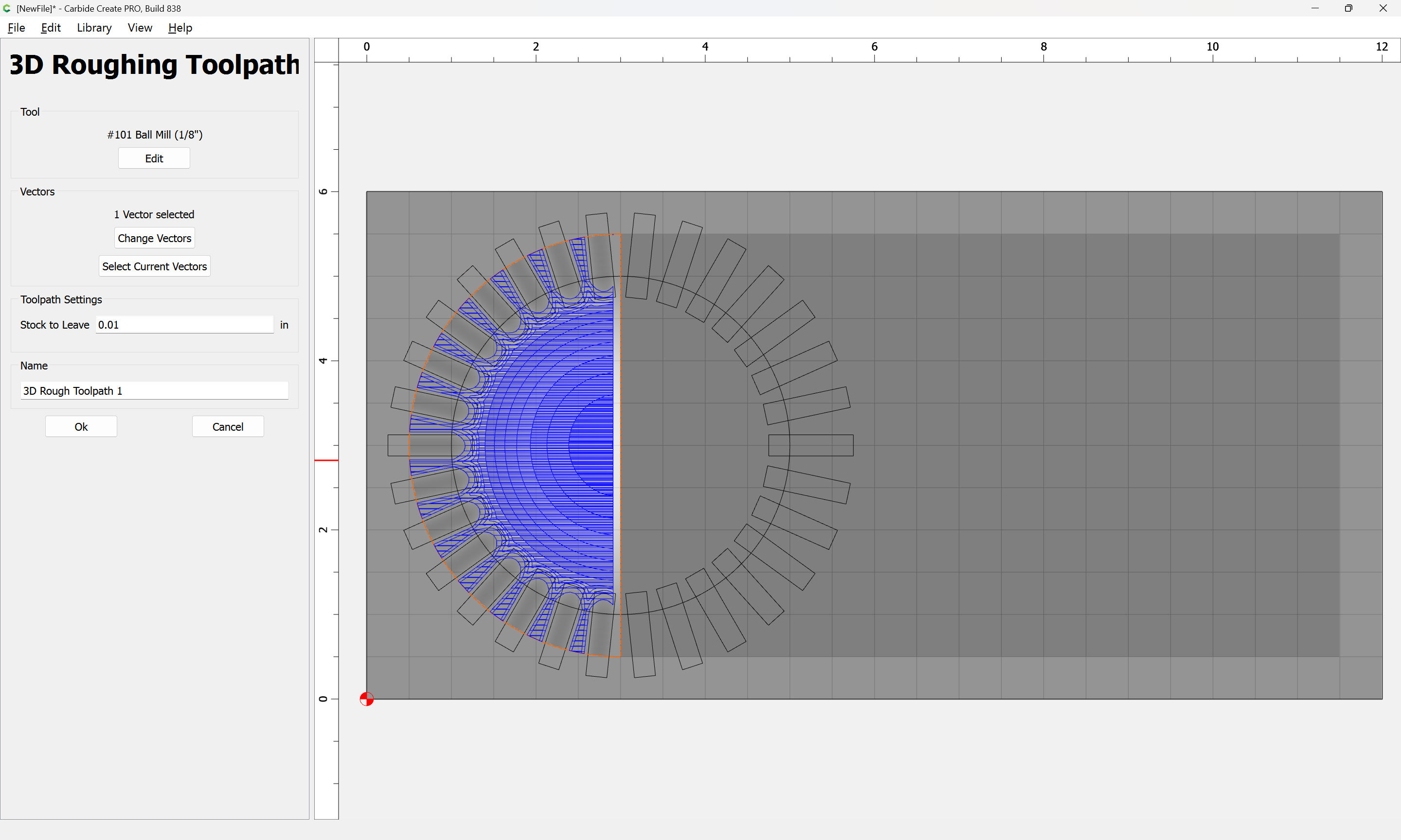

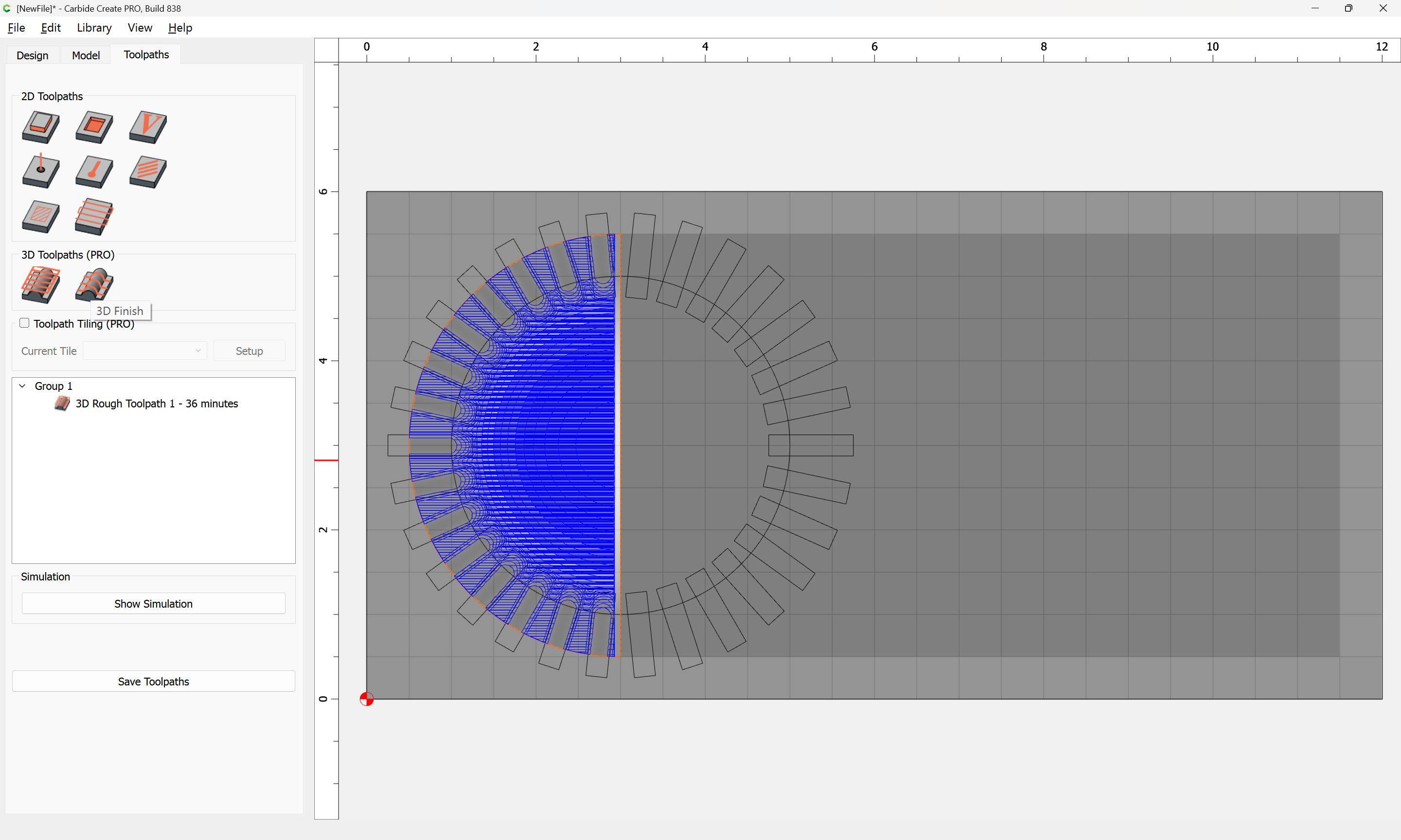

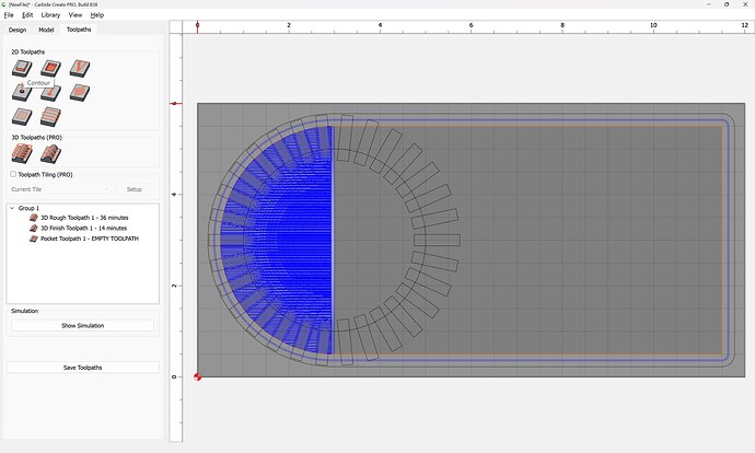

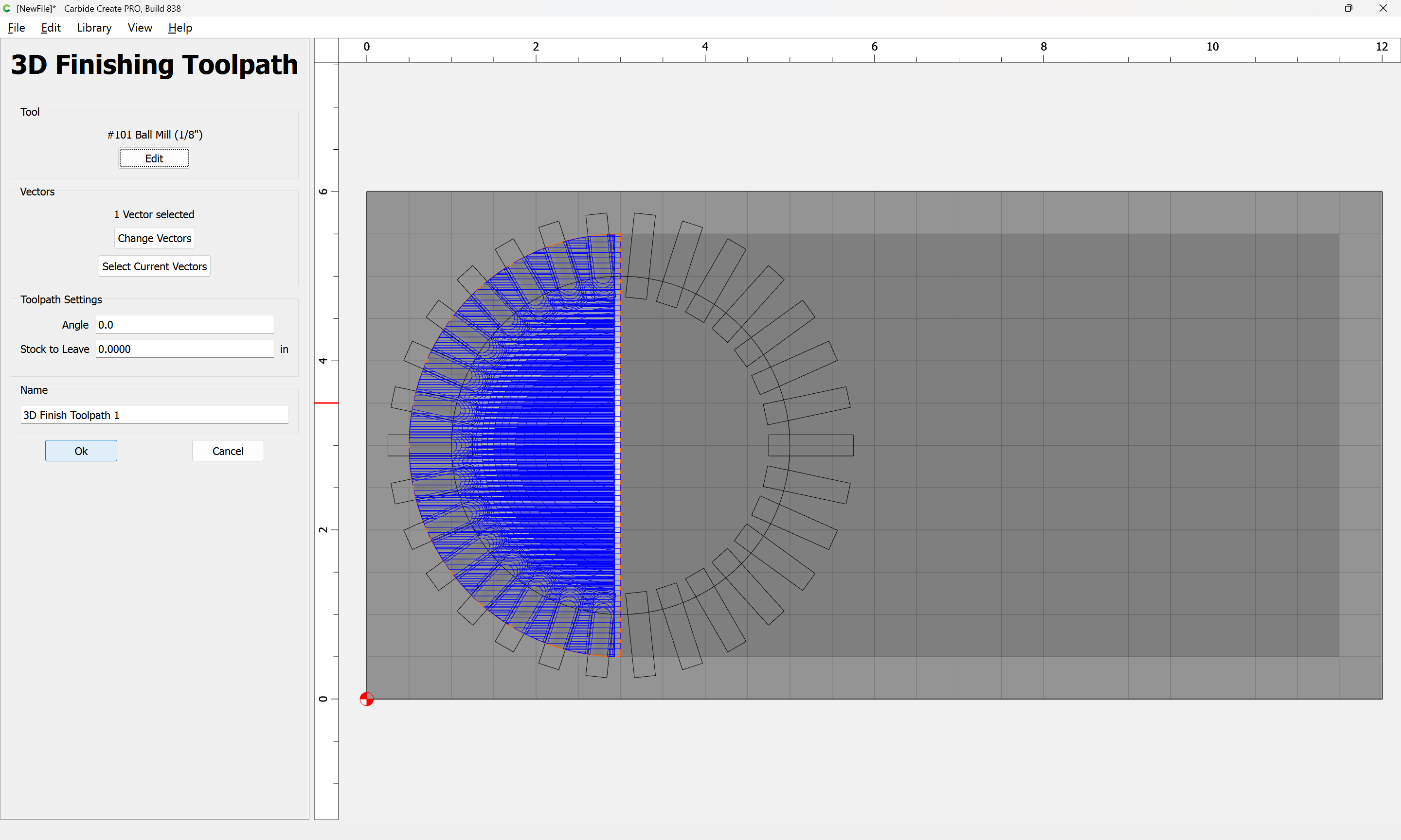

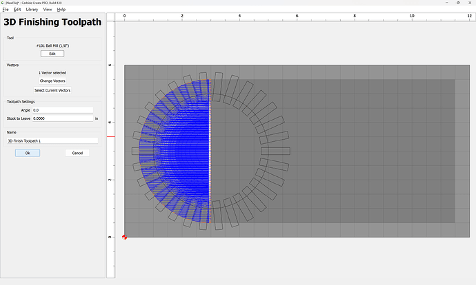

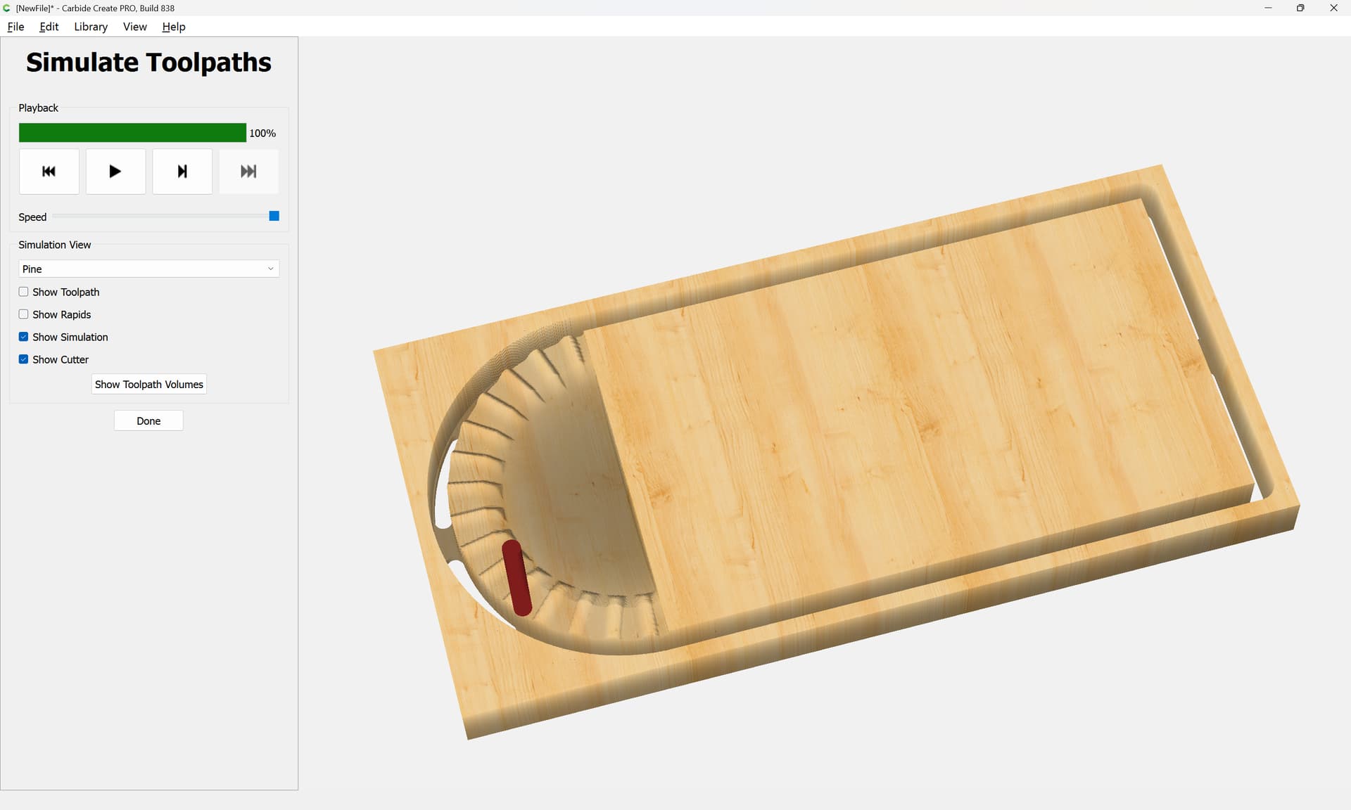

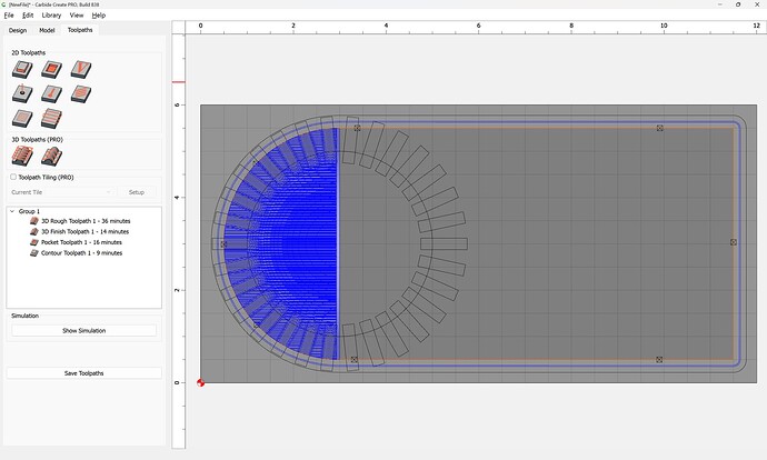

Then set up 3D toolpaths to cut the model:
d (for delete)
Done

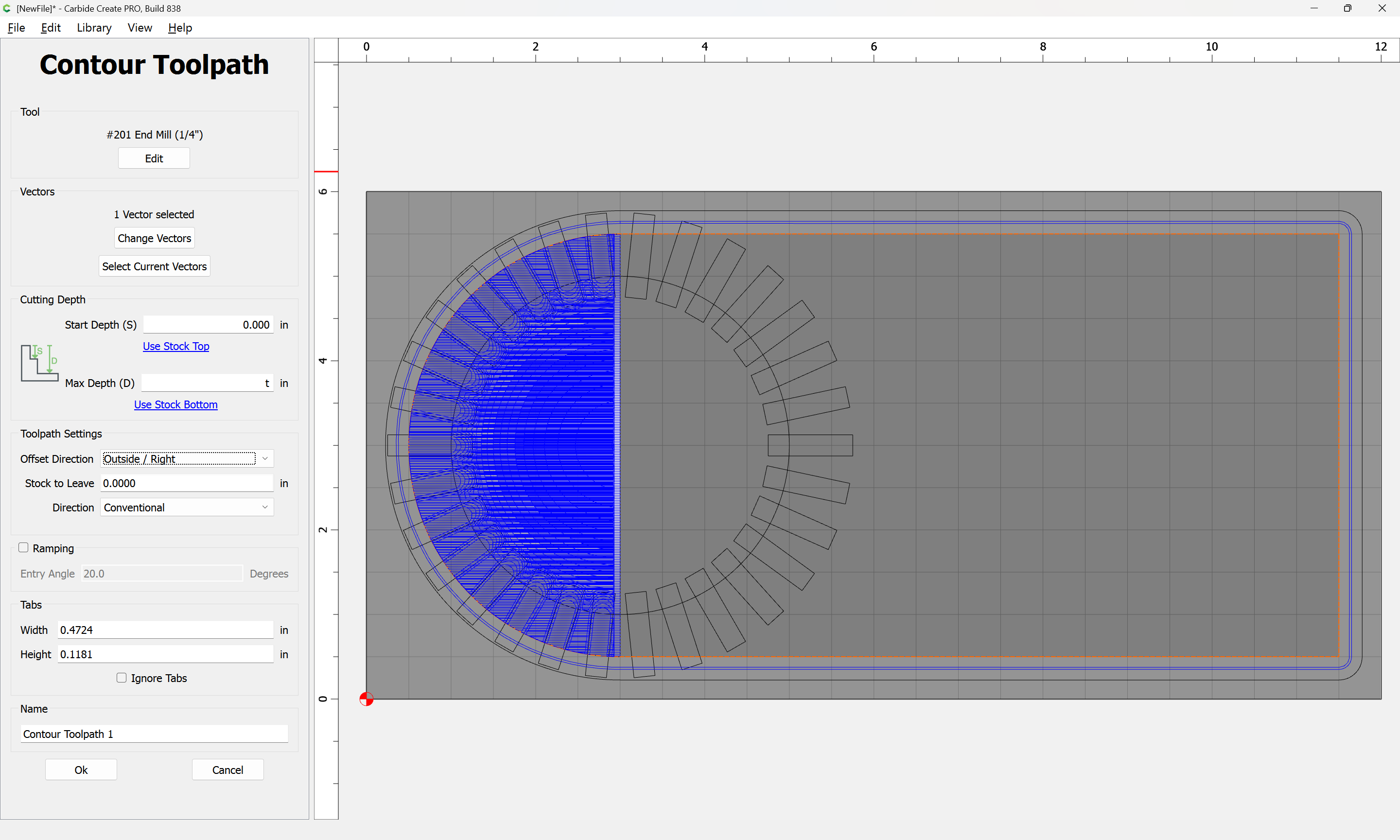

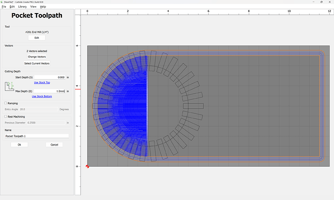

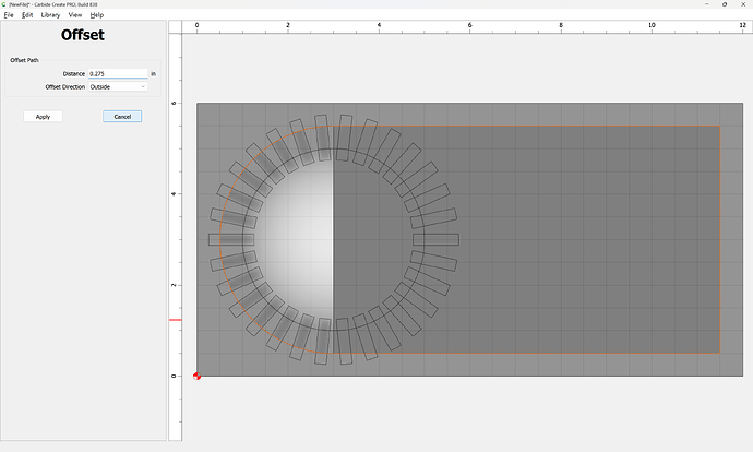

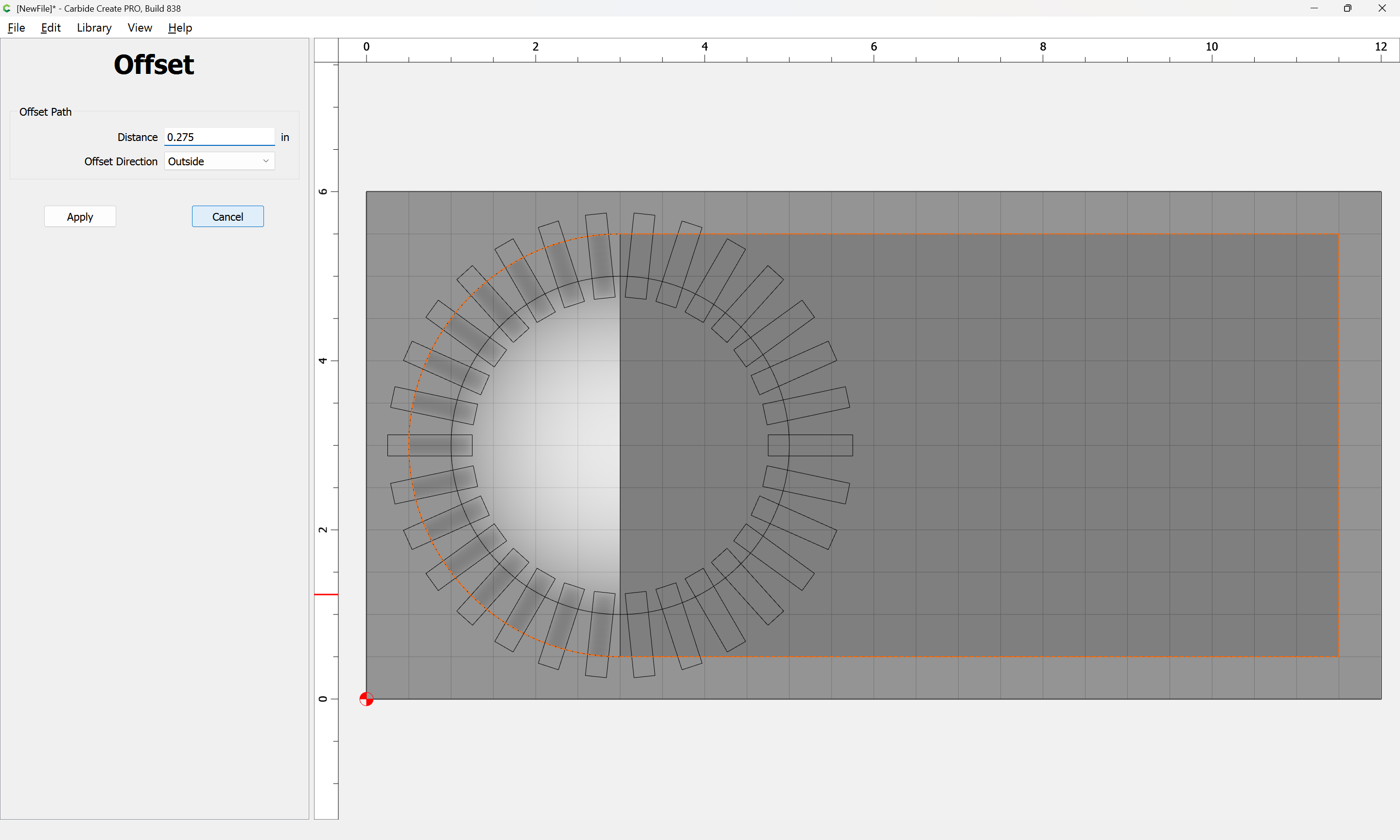

then recreate the outer geometry:
offset to the outside by endmill diameter plus 10%
Select both:

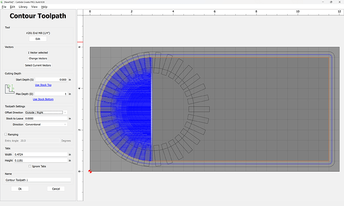

and cut as a pocket down to tab height:

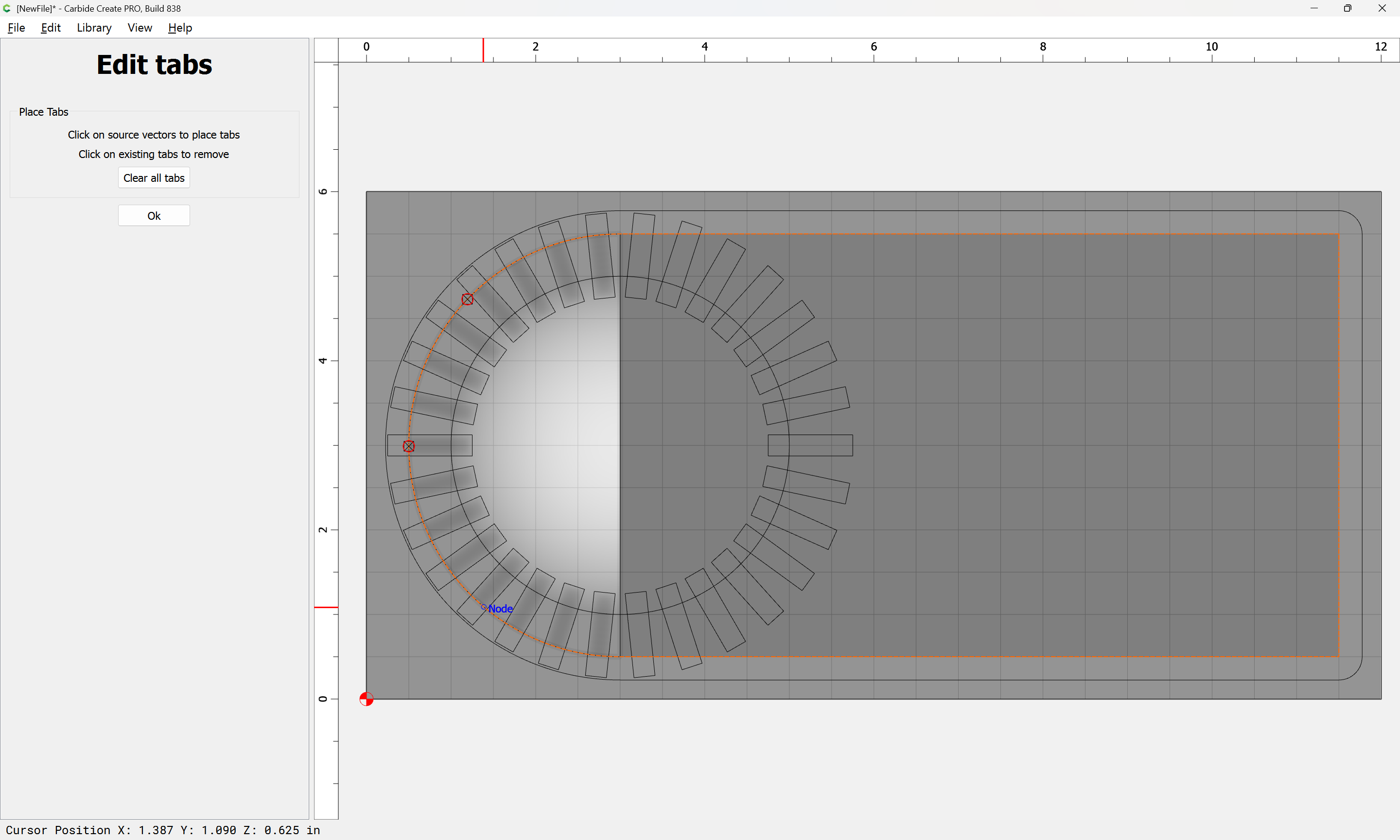

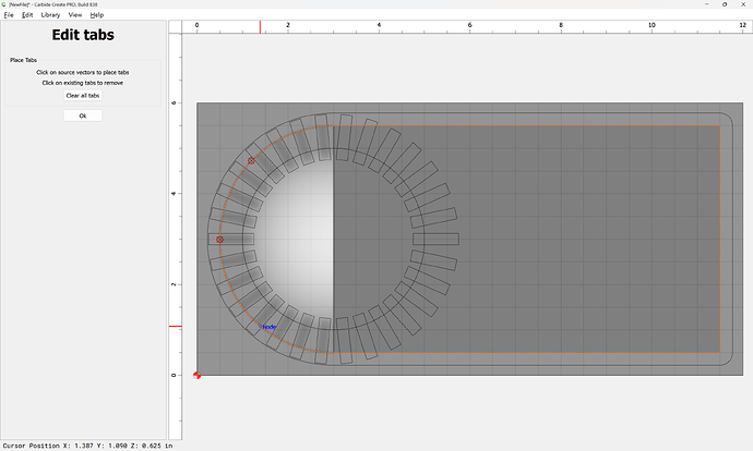

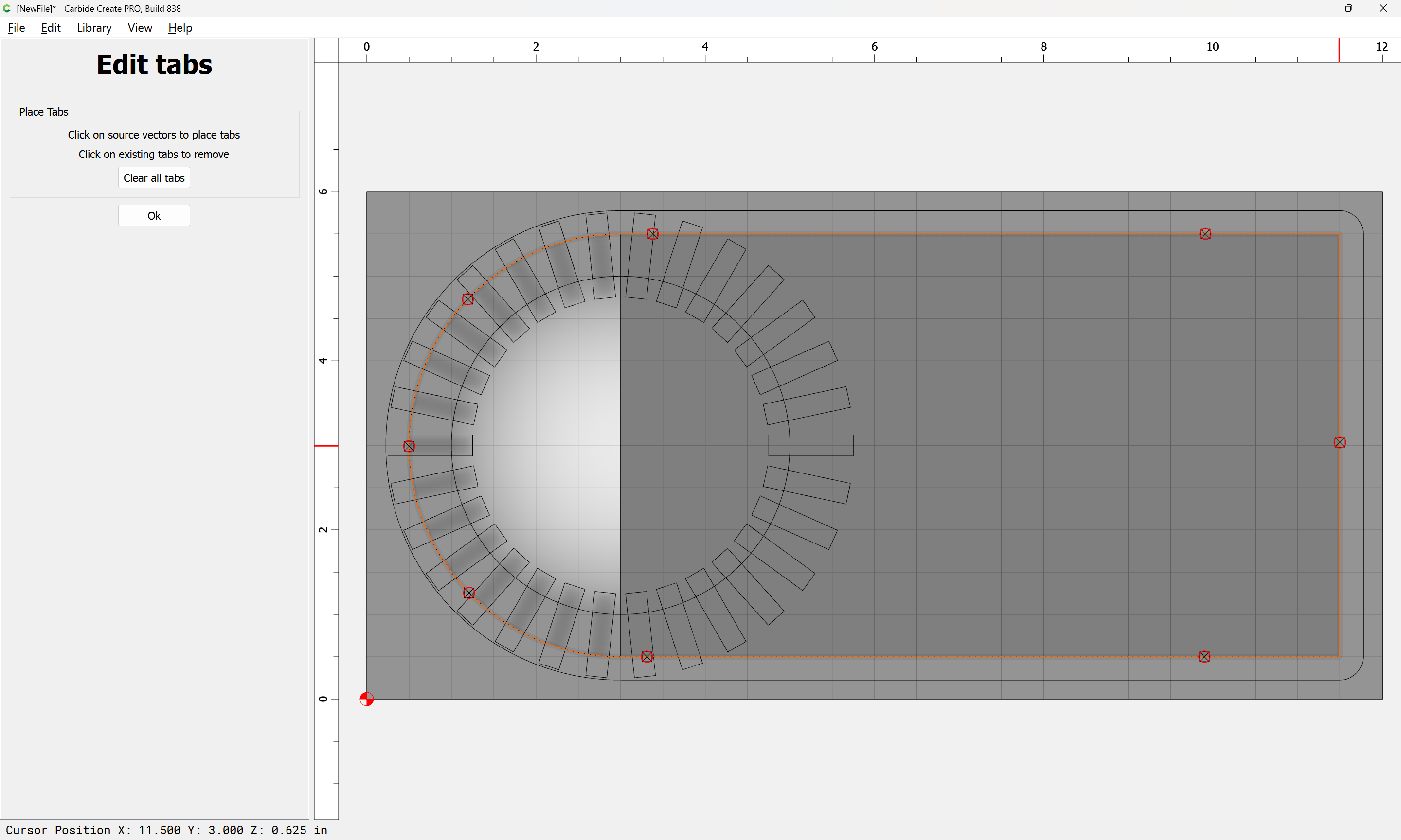

Then apply a Contour around the edge:
and add tabs:
Ok
which all previews as:

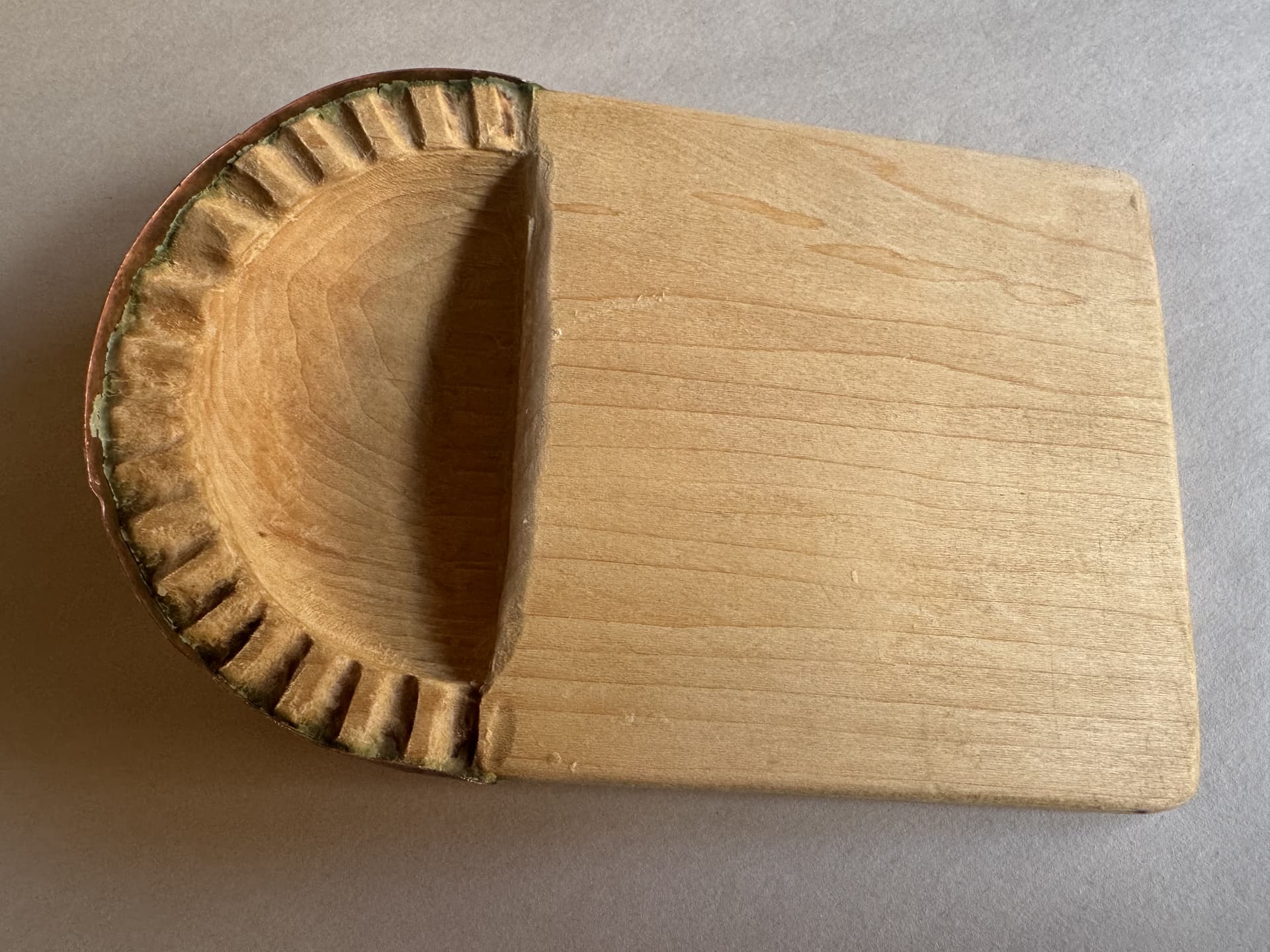

But what about the copper on the other side :stuck_out_tongue_winking_eye:
I do wonder why it’s there though. I’d guess it acts as a dough sheer but I don’t know why one wouldn’t just build the sheer into the wooden form :thinking:
Implementing that feature is left as an exercise for the reader.
Make the entire mold from one piece of copper :grinning:
The wood can’t be as thin as the copper without breaking. It will also wear down faster than the copper. Copper is better than steel, since it won’t rust - as in orange iron oxide yucky rust - but will patina. Stainless steel would be good as well, but is less available, more expensive and not as malleable.
