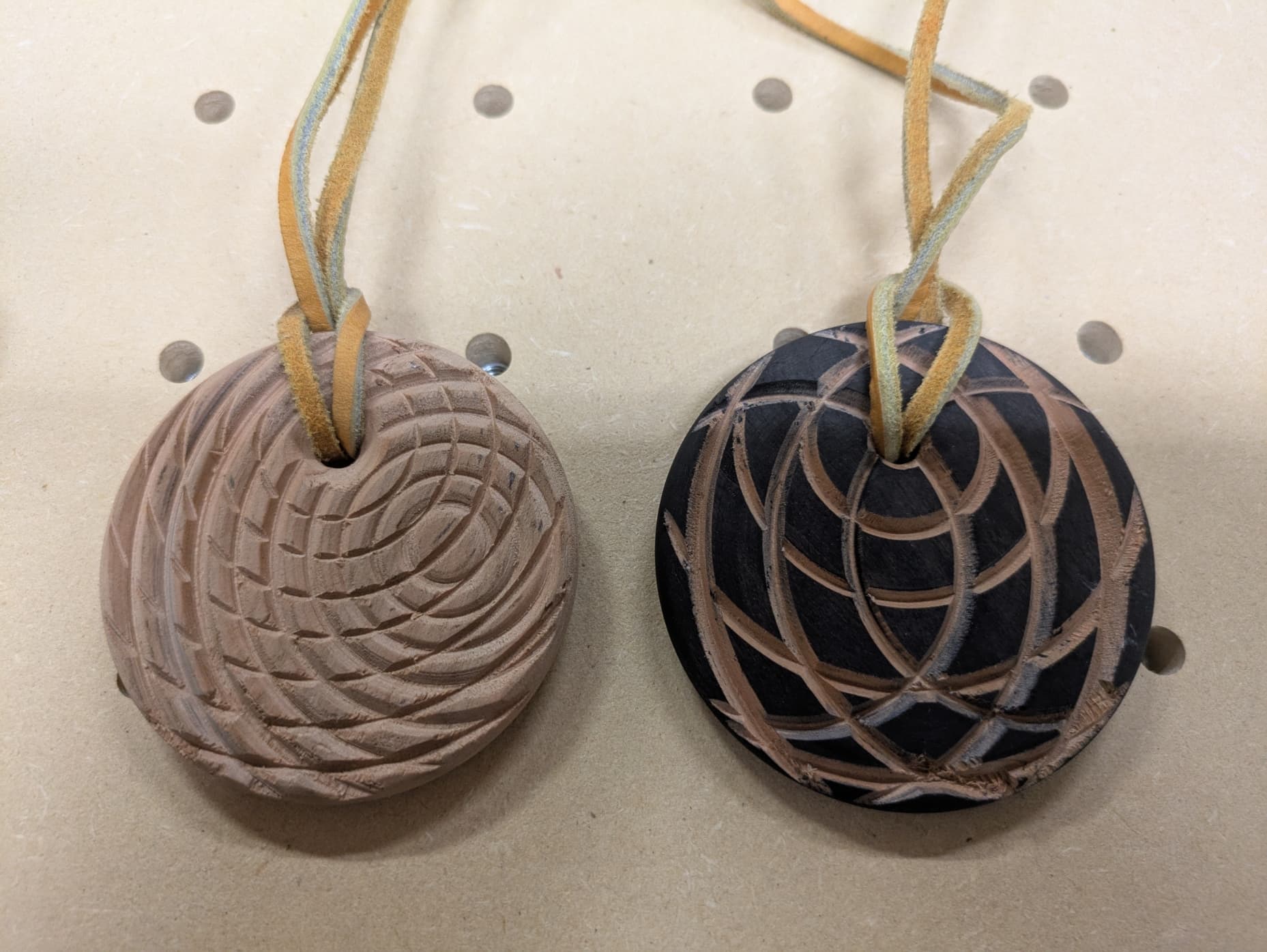

Here is one I made today. It is relatively simple.

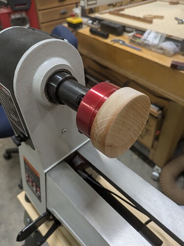

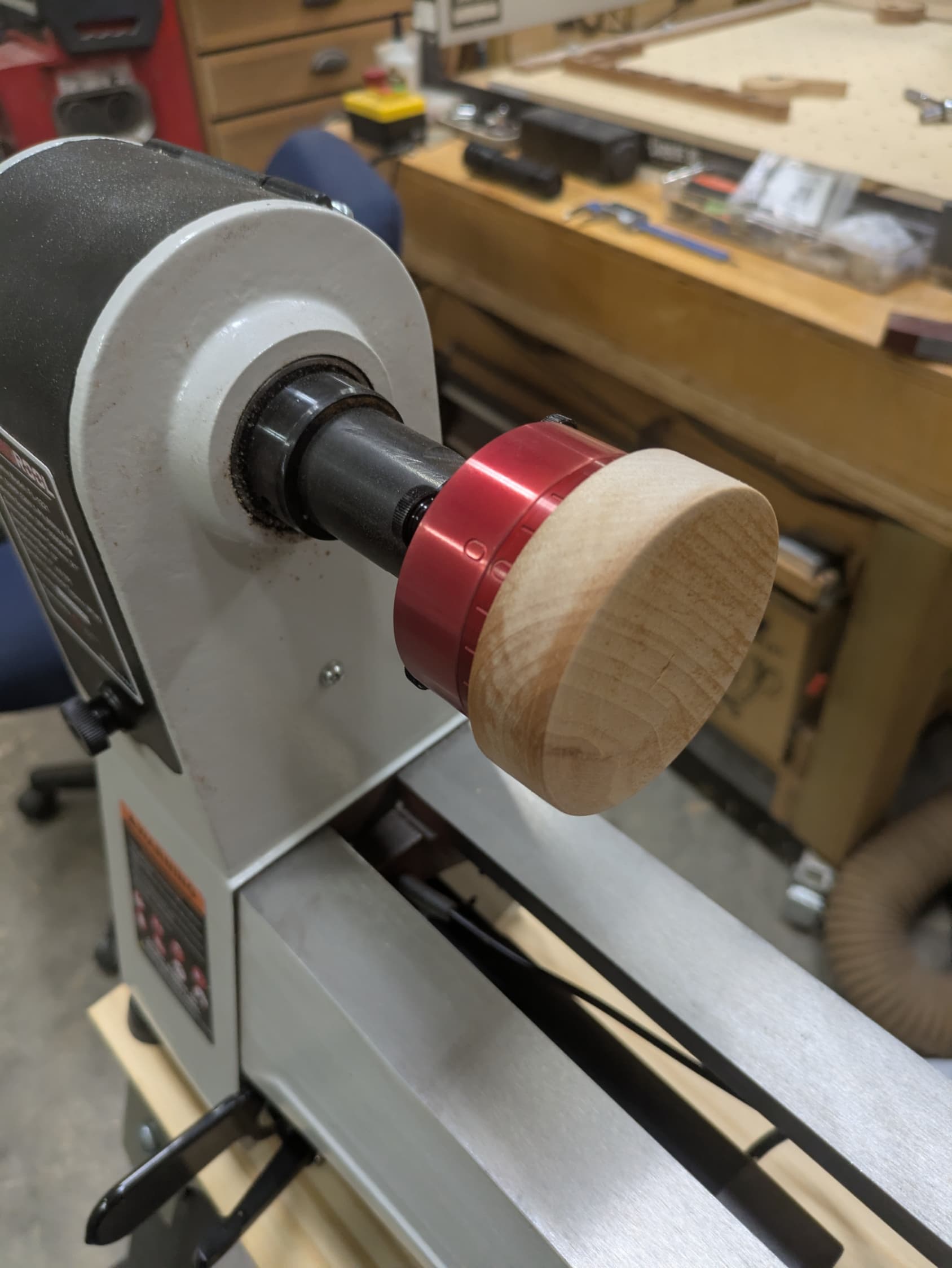

Here is the jig I made the above pendant on.
The jig consists of two parts. The back has 10 holes and the front half has 24 holes. You start in the center and round up the blank and then move the jig to some combination to make your design. The design process is quite complicated. Someone made a spreadsheet you can input your design and then visually see what it looks like. If you dont use the spreadsheet it is just a guessing game and there are literially thousands of possible combinations.

Here are a couple more that were just experiments.

Guy, the photos don’t show a domed blank, but I’ve been wrong before! :smiley: It looks like the finished parts are simple flat cookies with a rounded edge.
A round over bit would easily work on both the edge and the hole and look nice.

The pendants are slightly domed. The edges are rounded. After cutting the lines I went back and rounded the edge more and that cut the lines from going all the way to the edge. It is early days for this I have only made 4 so far.
