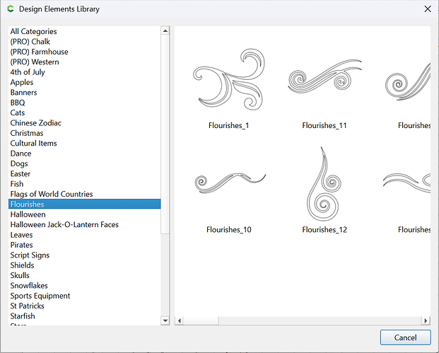

Where can i find and get botders to go around plagues with words to hang on the wall and dont want it to be just words on a piece of wood i wanna dress it up a lil bit

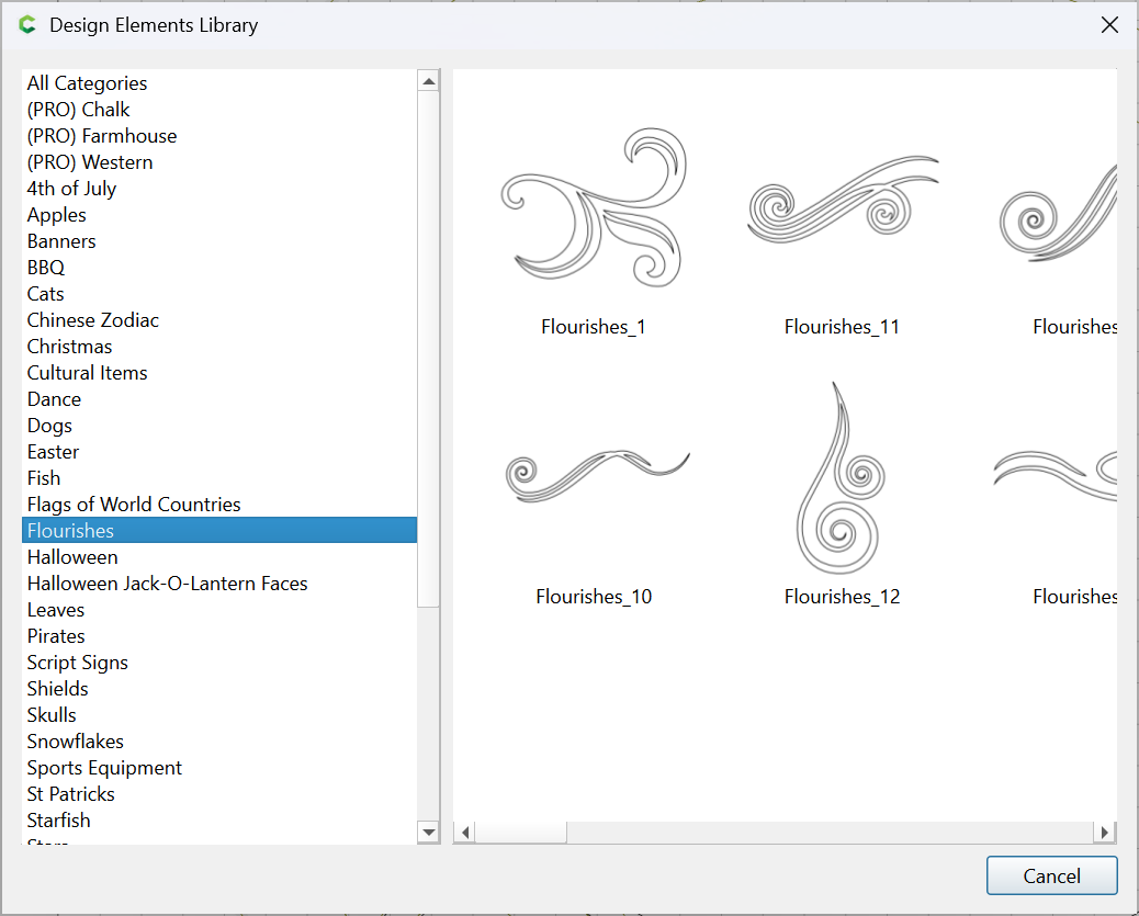

What style of design would you want?
  • geometric?
  • floral?
  • pictorial?
The Design Elements library in Carbide Create:
has a fair number of designs in it and is listed at:
https://cutrocket.com/tools
https://elements.carbide3d.com/

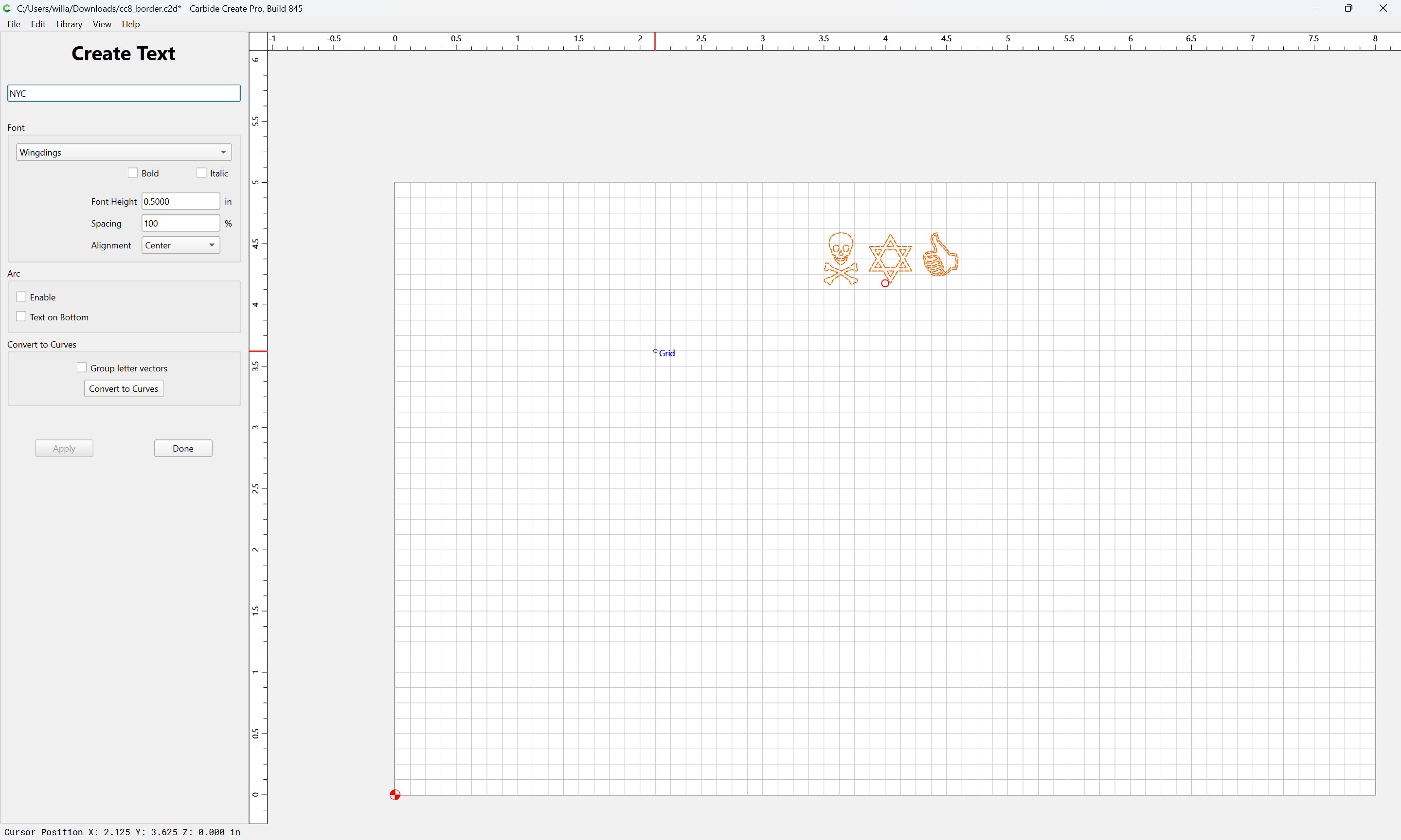

There are also fonts which have decorative/border elements in them, e.g., Wingdings by Bigelow & Holmes:

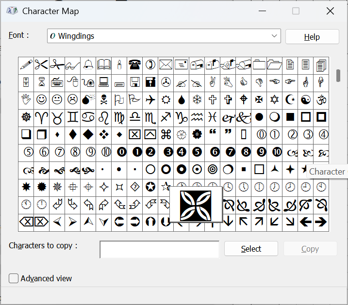

How di you get that to come up on your screen i have to type not select my stuff
For launching Character Map see:

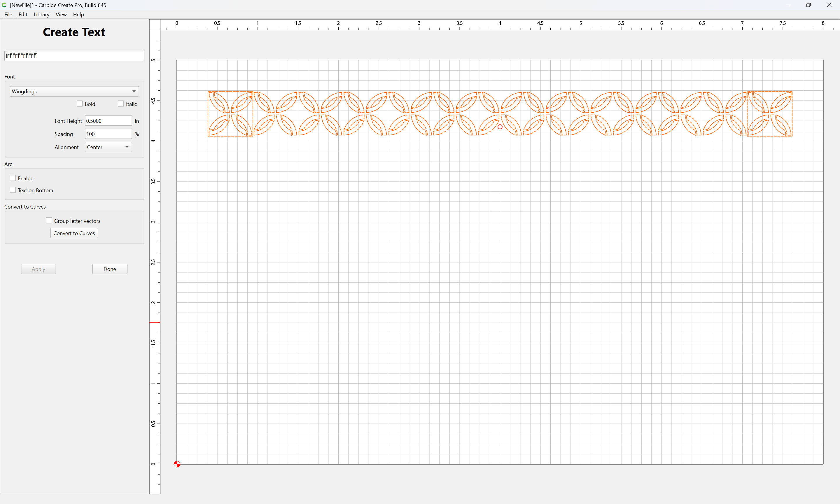

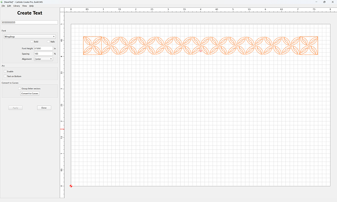

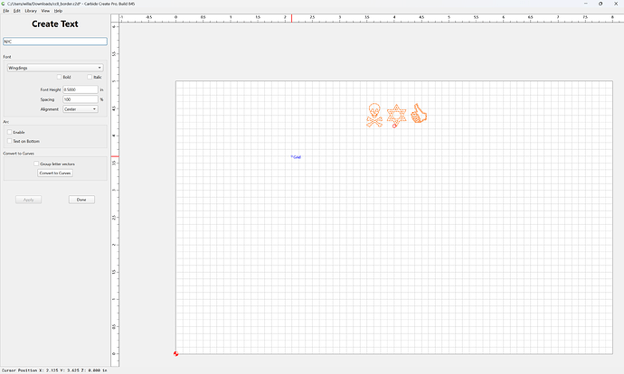

You can type whatever you want in the Wingdings font:
(that is a reference to a column by Penn Jillette)
Here is the file from above:
