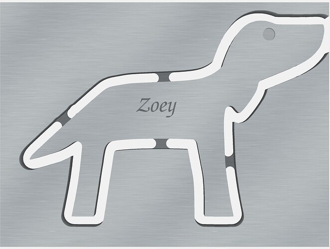

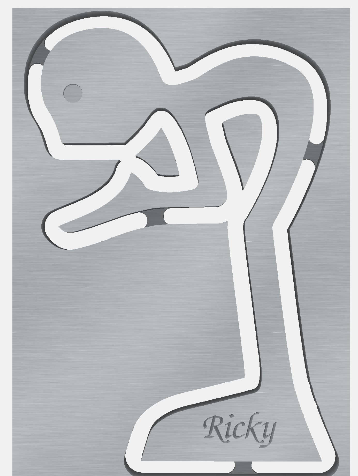

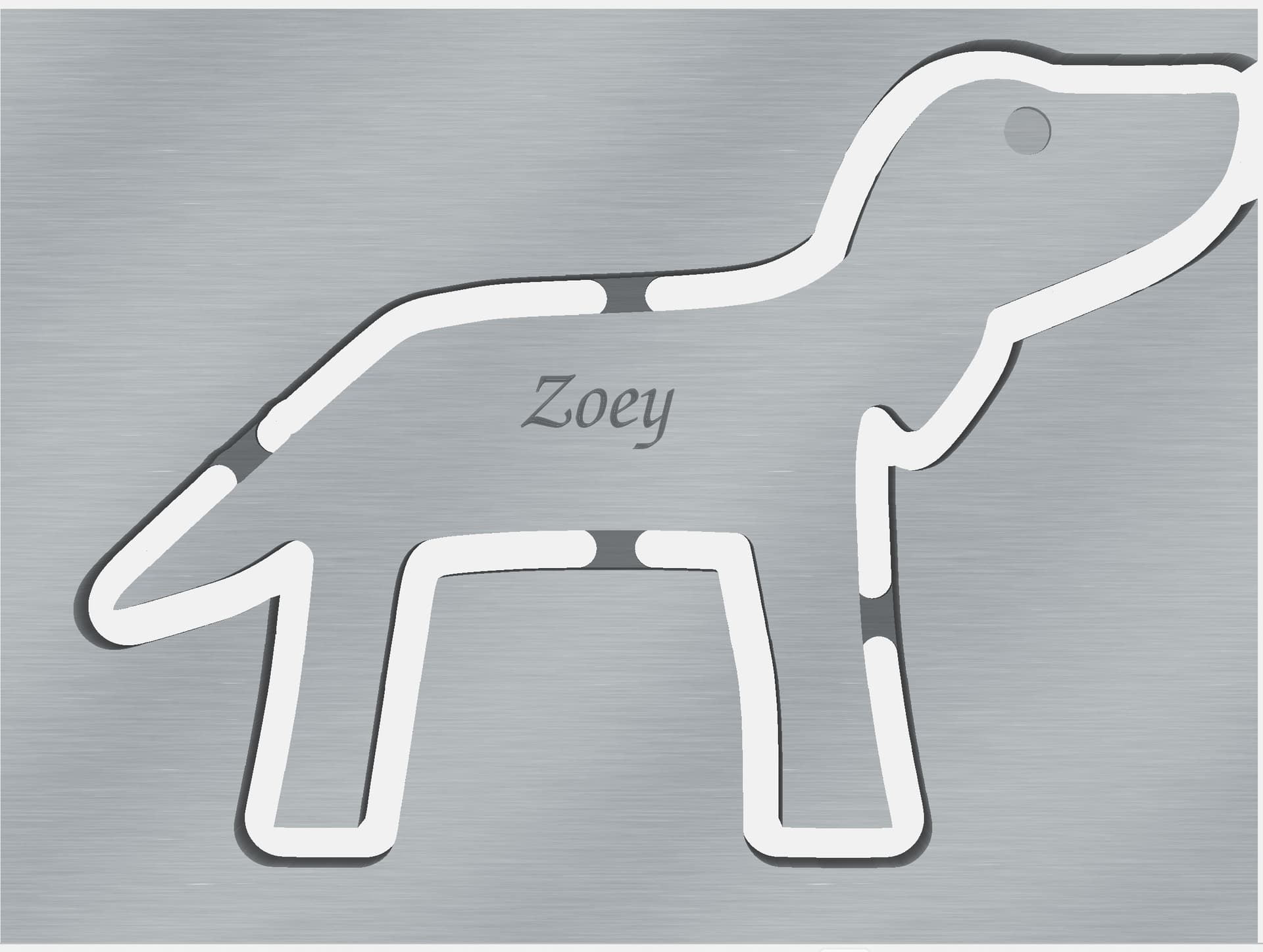

Here are the simulations of the dog and man. There is also an ear that I will cut as a 3rd piece.

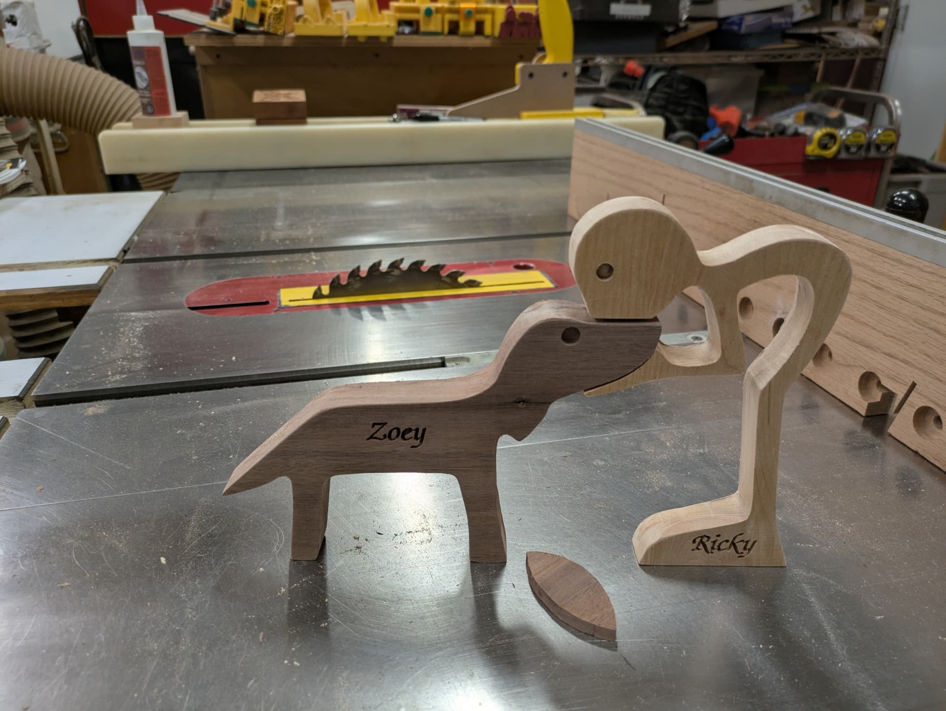

Got the man and dog and ear cut out this afternoon. The kids came up for Easter and left about 2:00 PM to go home. I just wasnt in the mood to do a lot of work so I cut the project. When I got part of the way through the man I realized that there were a couple of parts that would have become detached. I stopped the project and added some tabs. Measured how far down I cut and disabled some tool paths that were already cut. Restarted the project. Came out well. Have to finish sanding it and add some finish. Likely some Watco Danish Oil.
In the simulation you could see there would be some islands that would become loose. Not sure why I did not catch that before starting cutting. Alls well that ends well.
After I get it finished sanded I will glue the ear on.
If you want to make one yourself here are the files. The text was cut with a #701 (custom tool) which is a 15 degree vee bit. The other bits are #201 and #251. Be sure to check the setup for your stock thickness and your top/bottom. I usually use bottom.
