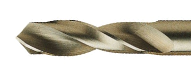

With one of these?
That does look like a good option gmack. I have to try and source one in the UK. Do Carbide 3D supply these, couldn’t see one listed?
Not that I know of, but I understand that Carbide Depot ships overseas if you can’t find a local distributor for them or something similar. Maybe @LiamN knows of one/some? Or if this is even a worthwhile pursuit!
Edit - OOPs noticed that the cutter length for that one is <5 mm, but this one is ~10 mm, less expensive, and likely shippable overseas @TDA would know about that.

For your purposes, I’d just use a generic carbide drill, either a spot drill to just punch a few mm in and guide your secondary drilling operation off the machine, or a jobber and actually peck drill the full hole.
