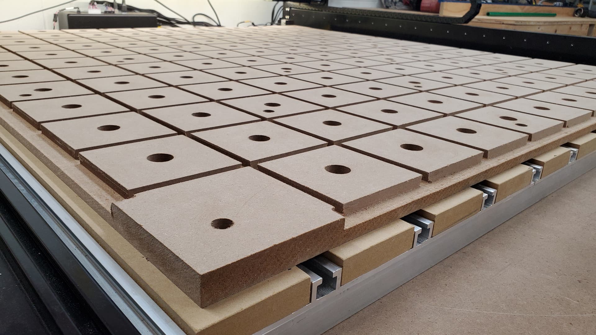

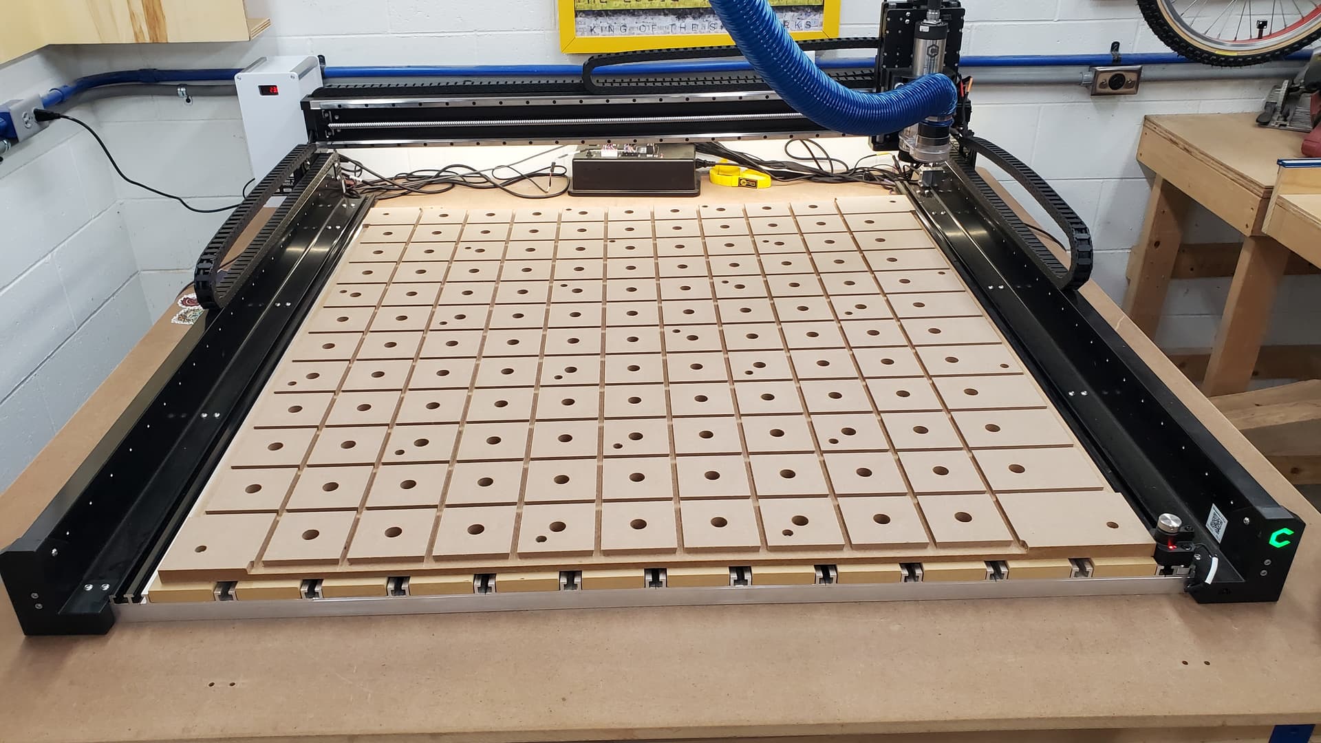

Just finish cutting it this evening. Designed with inserts in the stock base and M6 hardware fasteners. Now the fun begins!
I have been integrating the MatchFit dovetail system in my shop. I have made a plywood setup that is as long as my tablesaw fence and 10" wide to use as a tapering jig and a way to put a straight edge on crooked boards. So far I am liking the MatchFit system. I have also made a 20" x 40" grid to use on top of my bench to clamp down things. I have a Jessem Pocket Mill Pro with their workstation that had the MatchFit system integrated in.

Let us know how you like using the system. I see you have a larger hole in the center of each grid on your spoilboard. On the MFT tables they use that to put a clamp through and hold things. How are you going to use the dog holes?
I have several shop projects planned with the MF system. I think being able to do workholding with less hardware involved (inserts, tracks, etc) is a smart design.
I put the dog holes in which while similar to MicroJig’s design is not designed (currently) to fit their hardware. I’m using the holes as locations for my PVC dowels. If MicroJig comes out with improved workholding specifically for the CNC I could always redesign the holes sizes to match.
I left the corners blank, especially the front left which I will mount L brackets to as another option. Just for fun I plan to carve my new business logo into the right front corner.
After I test it for a bit I will upload the files to Cut Rocket if anyone’s interested. I figured this is version 1.0 for me. Being new to this segment of woodworking I’m always up for improving a design.
