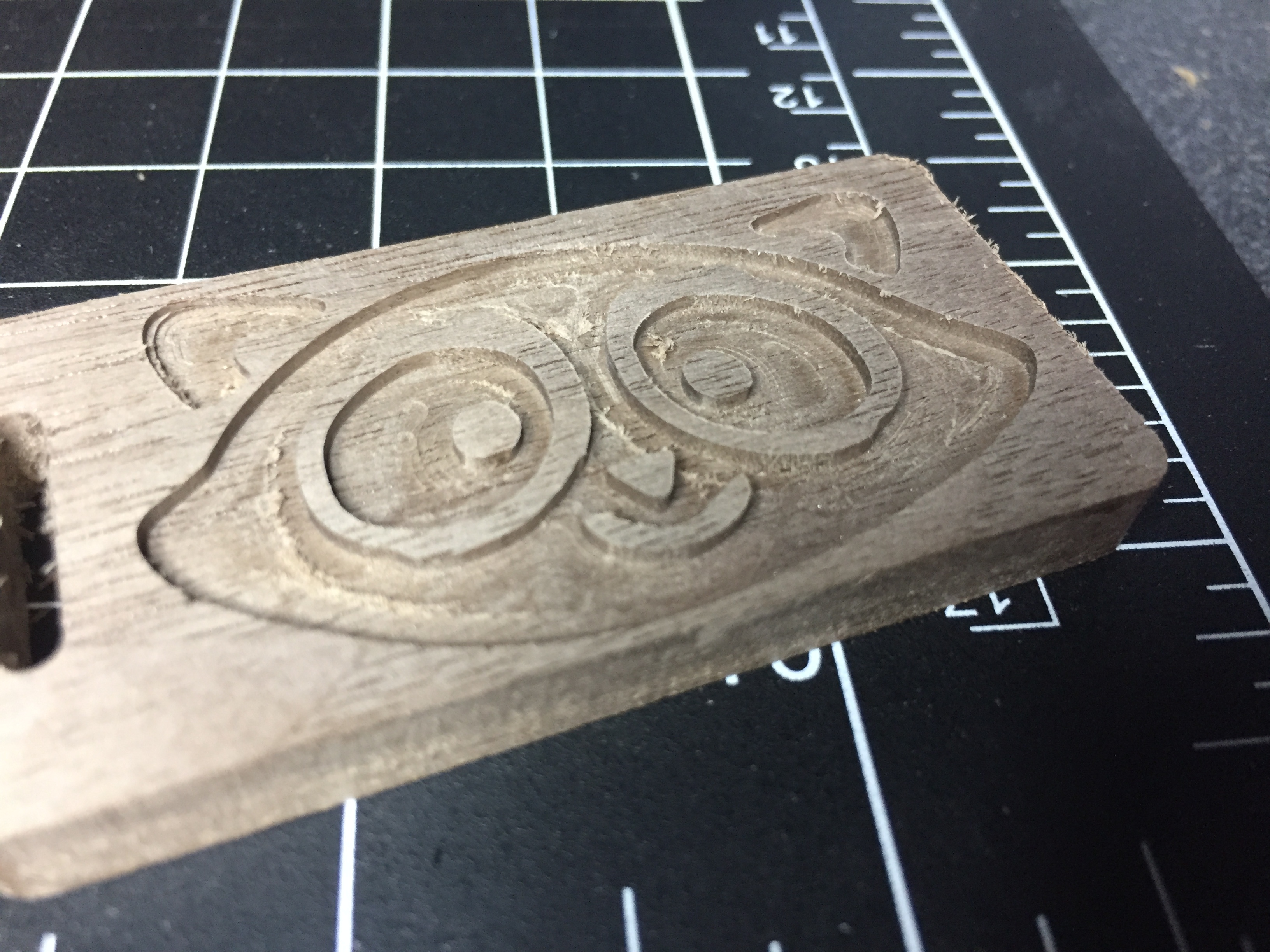

Carving with a 1/16" square endmill and I’m getting these small pockets of uncut material. It happens on most of the copies of this though not all. I tried bumping down the stepover a little, should I just go a bit more? That seems like the right solution but again didn’t seem to have an effect, though only went from .028 to .025. I also tried speeding the router up but that didn’t seem to have an effect either.

Sorry about that, Carbide Create. Calculated path shown below. The issue on the ‘cheeks’ seems centered on where it starts hollowing out the pocket.
The fix is to keep tightening the step over smaller and smaller. CC is not well-written piece of software and you’ll find yourself doing some things that don’t make sense. I often use a 3/4 inch cutter and if I go more than 0.400 step over it misses spots, which make NO SENSE!

I did another batch tonight and had similar results with the stepover at .020 but I can’t actually compare because I noticed afterwards that the set screw on the X axis was loose. Ironically I had trouble getting it out because of the loctite… Hopefully it’s fully seated this time, so I’m not sure if that was my problem all along or what.

Looks as if you may have some backlash or be loosing steps:
- check pulley set screws: http://docs.carbide3d.com/shapeoko-faq/shapeoko-3-how-to-check-the-pulley-set-screws/
- belt tension — guitar string tight for Z, not much less on X and Y
- check V-wheels
- wiring

Yeah I buried it in my comment but the X axis set screw was loose. When I removed it to apply loctite I must not have put it back in all the way, this making that procedure rather pointless. The backlash around the ear was from stopping the job and restarting it, but that means it didn’t find it’s way back to the original zero so, yeah it’s all making sense. I’ll try another tomorrow see if this cleared it up.

So yeah, double checked the set screws and added more tension on the Z axis, while giving the rest of the machine a good look over and I got a much better result.
I did get the ‘scalloped edge’ issue I’d also had elsewhere but that seems to be me having damaged the bit by running it in such a poorly setup machine. Luckily C3D sells them 3 at a time
very nice,Id assume the scallop is from the spindle not being square,watch this vid and see that you think. below the vid is the svg for the tram mount if you want to use it.
Mark thanks I did see the video and that could be part of it. I may try slower settings first but checking square is on my to do list.
