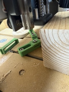

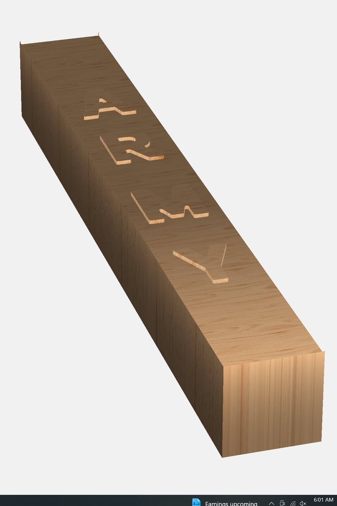

Hi, Thanks for your post.
the pic here is a table leg I am working on for custom tables I build… legs are 3in x 3in x 24 tall.
I have the clearance as the the spindle moves , However in doing a pocket cut as seen in the attached, I am curious if my 1/4" upcut endmill will allow this action to happen being the leg work surface is 3 inches from the spoil board… or will I break a bit.
v/r
I don’t think the bit will break for a pocket cut around the ARMY letters just because its 3” above the spoil board as shown above?
You should be fine cutting at whatever height you can fit, so long as you stay within the bits performance capabilities.
The real question to me is how you are going to hold the stock. CA glue and tape are ok, but you are creating a leverage action that maybe pull the glue/tape way.
I used an aluminum bar on both sides and butted clamps to it. The bar is 1 1/4 x 1/4 bar on both sides. This is ok, but I had to add the clamps to keep the top of the bars against the stock.
I probably should have use 1 1/2 wide bar.
I did not use glue/tape.
