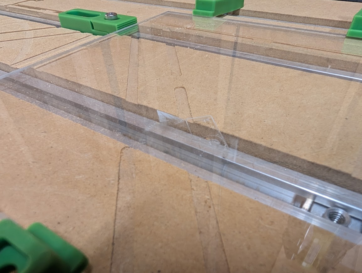

I set my cut depth to the 0.015" recommended on the product page, and then set XYZ using the Bit Zero and the BitSetter.
When I plunged to make the etch only part of it etched. It looks like the material thickness is inconsistent.
If the M.C. Etcher can compress a bit more, say .05, then I should be able to go a bit deeper and solve that problem. As you can see in this image only part of logo etched.

If your logo did not completely carve because the tip of the MC Etcher is over a low spot, increasing the pressure will not help much if any. When the tip is over that low spot it’s possible the tip is extended as far as it could go. Increasing depth of cut would help. The down side to that may be where the higher spots are the etching may be bolder because of spring pressure.
Ideally, I believe the best way to remedy this is to shim your work piece level so even pressure is applied to the tool as it does its thing. Maybe another location on your spoil board will level up the work piece.

I will take your advice and set the acrylic on a piece of scrap MDF and try to find a cleaner spot on the spoil board, because I want to increase my chances of success.
But I am also going to increase the depth, so far I have found that default settings and recommendations from carbide 3D are excessively conservative. The recommended 0.015" (0.38 mm) seems far to shallow given that the bit has two or three mm of play in the spring. I think I should double that. I will report back with my results.

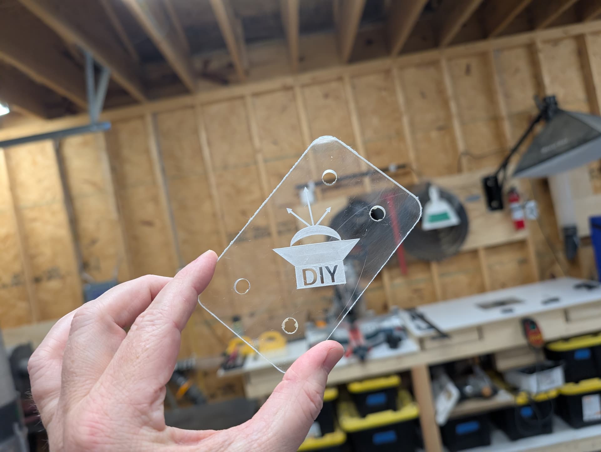

Edit: Clamped down a scrap piece of MDF to the spoil board, used double sided tape to hold a piece of acrylic. Followed the steps outlined here.
The carve was fine, but the tape left adhesive on the edges of the cut. So I will not use tape future.
I use the bit setter with my etcher. Spring in etcher is much stiffer than the spring on bit setter. If you want to be cautious you could mark the shaft of the etcher where it goes into the shank of the bit, then watch as it plunges on the bit setter to see if it moves.
I use a DOC of 0.03" on my etcher, but I’ve only ever used it on stainless and aluminum.
Regarding your cutout, you could keep it in the same file as the etcher, just turn the VFD on after tool change.
I found the spring to be the easiest way to control the degree of etching.
I use the default settings in CC and set the top of stock as the origin.
Cast acrylic varies in height. I learned to measure to touch off ( reset Z aero ) for each piece.
I start with a half to three quarters turns in, and adjust from there. You can get a wisp or a hard line based on the spring pressure.
