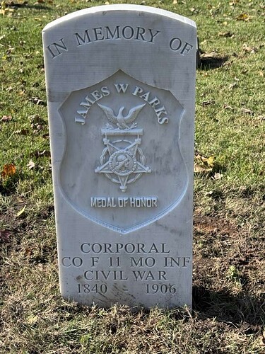

Got ya. I have designed a few monuments for a fella that carves gravestones. There are a few cnc machines made specifically for that. They handle a water bath and manage the slurry. If you want deep relief it’s the only way to go. I designed this (or rather recreated) this 1904 Medal of Honor for him and he cut it. He has a couple of machines now, I think. This is one of them.
Its nice work. Im just trying to use what i have to its ability hence etching. I know the Shapeoko isnt meant for stone work of that caliber. Ill call around to the stone tool suppliers to see if they have anything for me. Thanks again

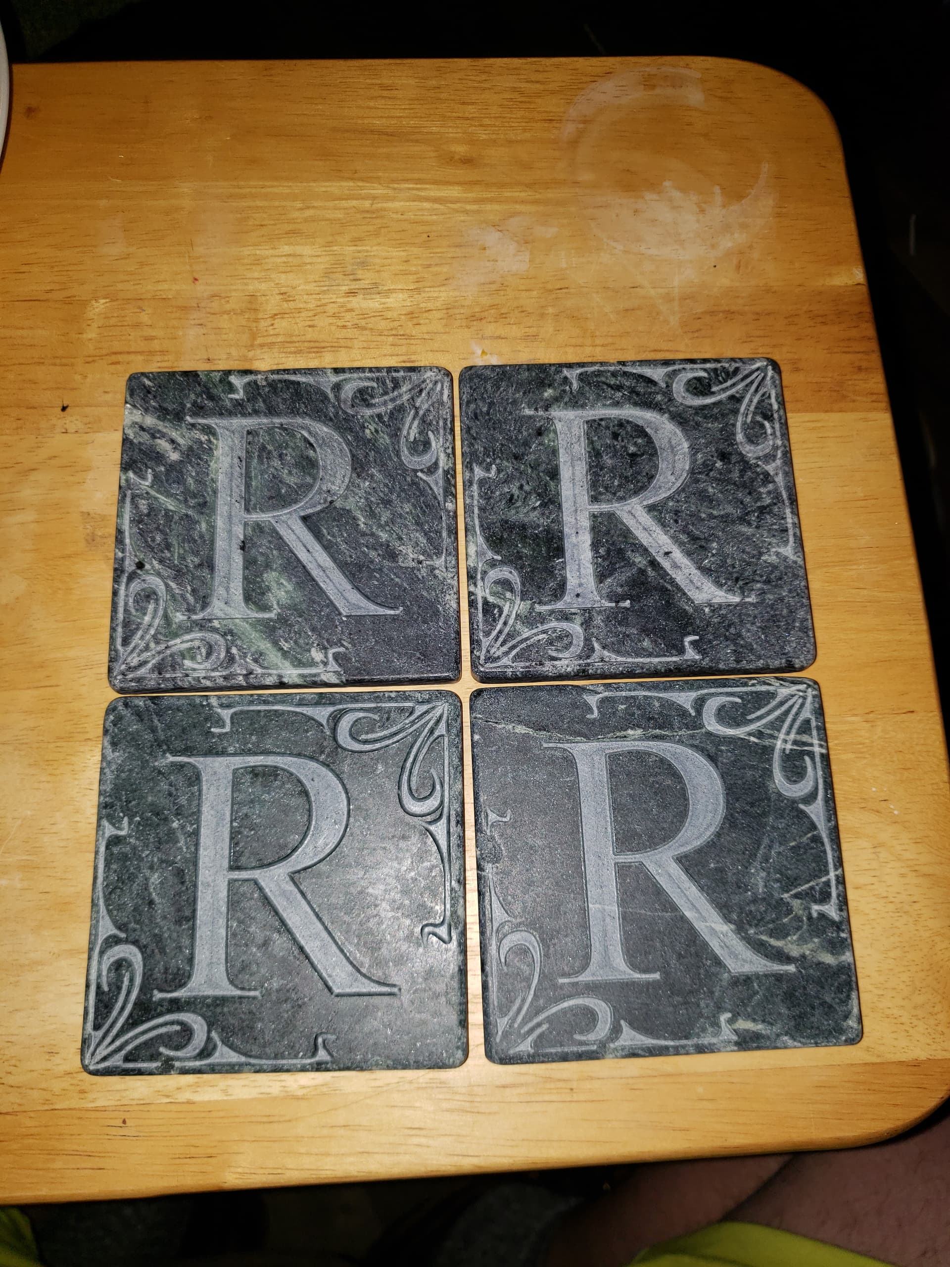

Here’s some of the things I’ve done on my SO3.

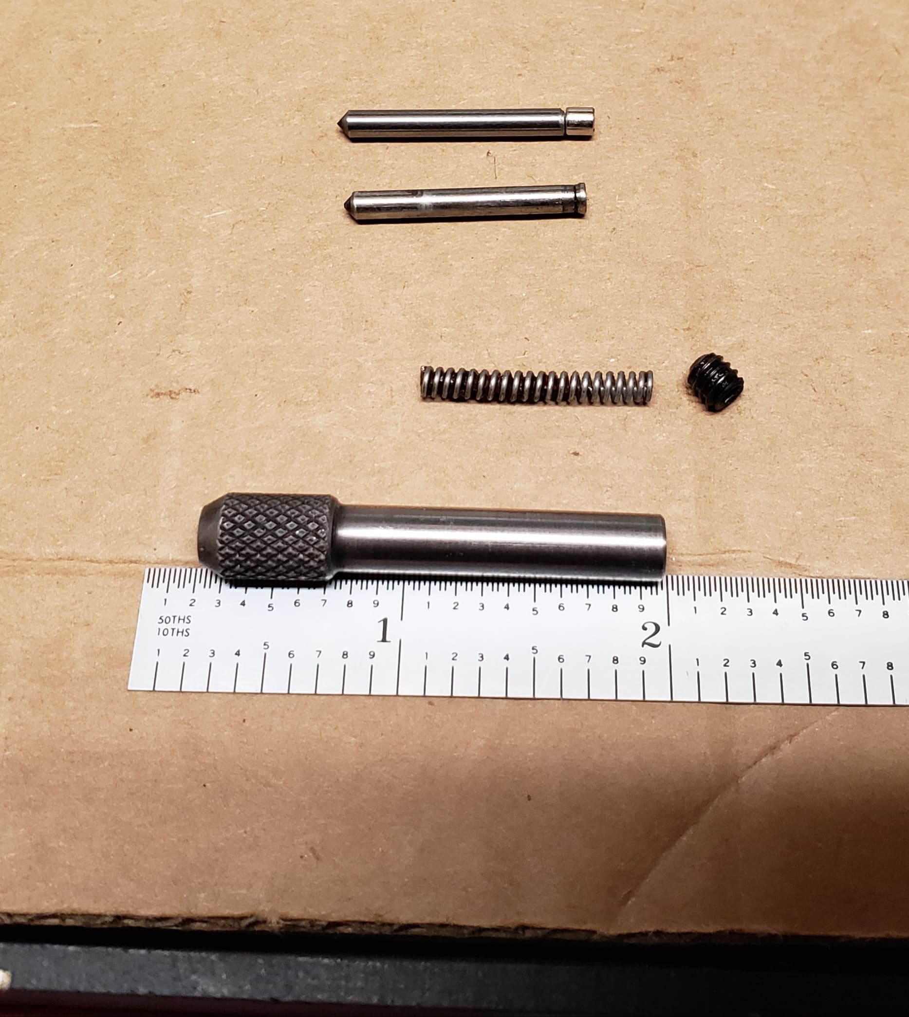

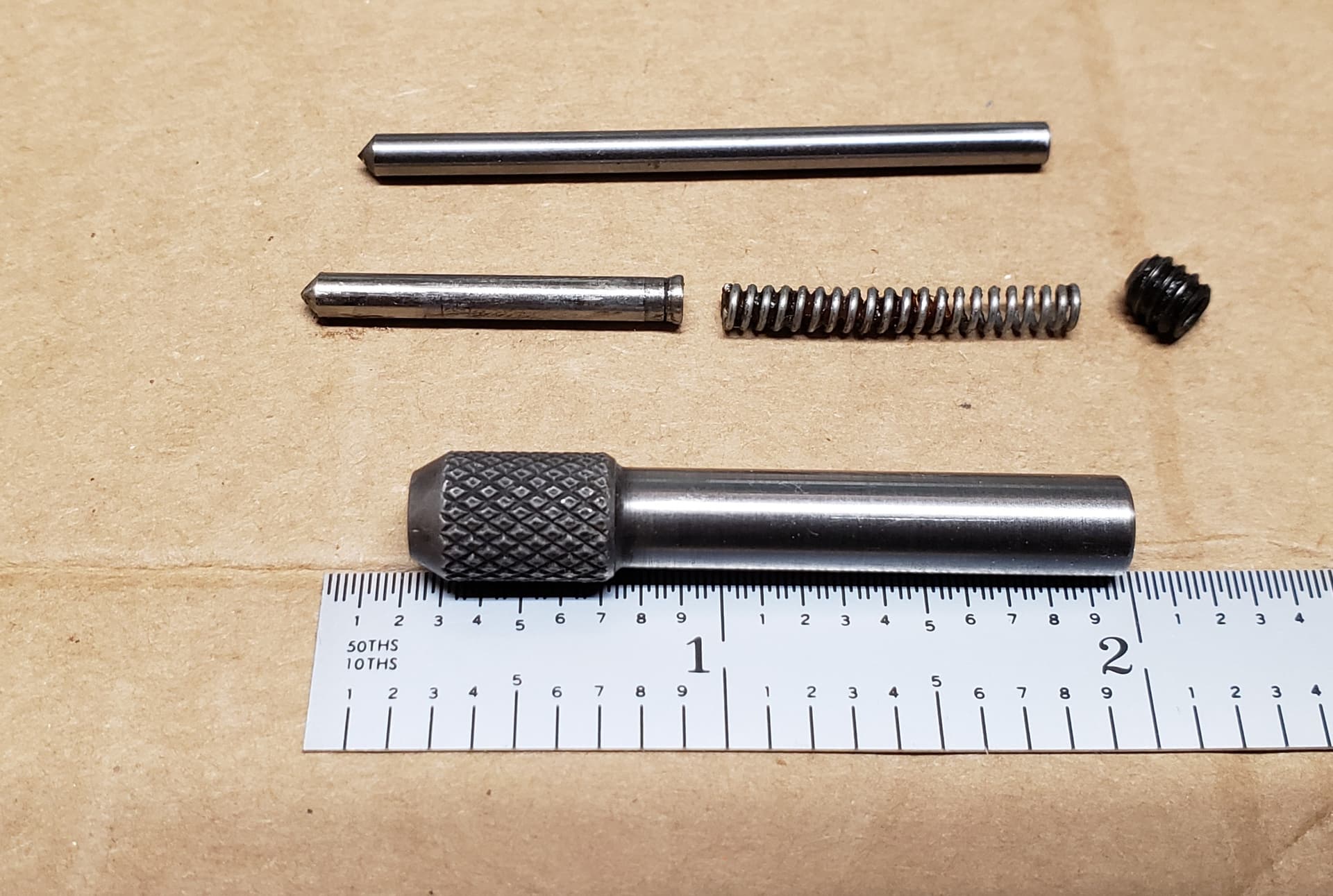

It’s great because it uses 1/8" shanked diamond inserts, which are $5-ish on AliExpress. I just have to use my Dremel and cut the shafts to length. The original inserts - that I could not get any more - had a small shoulder that held them in the holder, but when I couldn’t get any more with that little shoulder, I just put a 1/8" magnet inside to hold the diamond insert in place.
Here is a new diamond insert at the top.
One of the original diamond inserts, spring and tension screw.
And the diamond holder.
Here is the replacement diamond insert cut shorter than the original, so the magnet that holds it in place makes it the correct length.
Also, made it easy to swap inserts - just pull it out and pop in the new one - no need to have to take it out of the spindle.

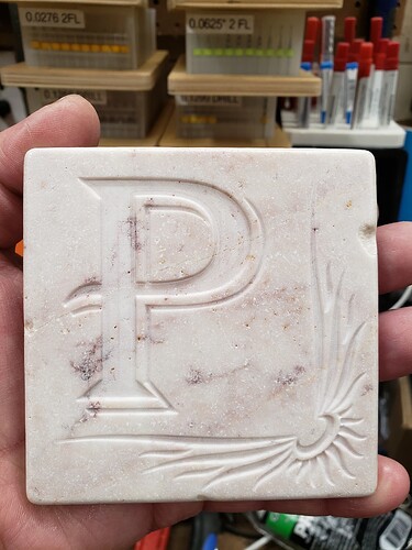

I would use a PCD v-bit. I have used them on marble coasters with good results.
Here’s a video of a carve using a PCD bit.

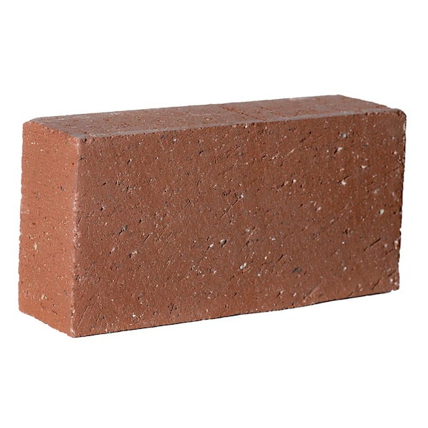

Thanks for the feedback on the brick question. I accumulated a few different bits awhile back with no luck. It seemed the variable composition of the brick (some soft chalky material as well as small rocks) made it difficult to find successful parameters. Someone in town was doing it commercially but they have since stopped. I have sintered bits and will order some PCD. Thanks again.
Are you talking about a red clay brick - 2.25" x 4" x 8" like this?
Are you carving on the 2.25" x 8" side, so it is seen when in a wall?
Or on the 4" x 8" side, as if it were used as a paver.
Well now that I’ve seen this, I have to try it. Thanks for adding another item to the todo :beers:
On the 4x 8 side. The sample brick (I no longer have but may request another) had larger "rock " fragments imbeded in the clay.
