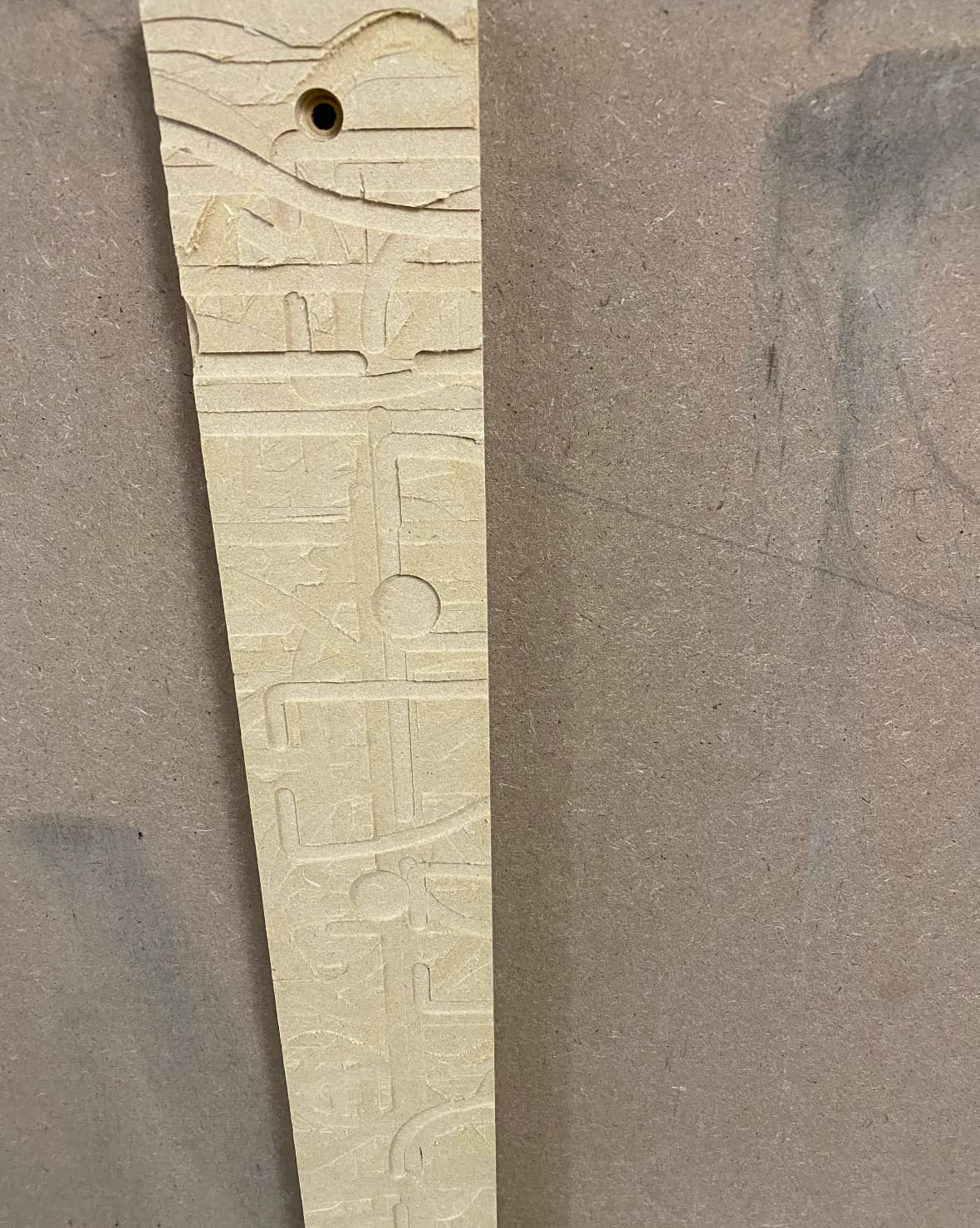

What material is the stock spoil board slats that come with the SO5? It’s a different color than what I got replacement MDF stock to make new slats with - Stock slats are light brown/tan and the new MDF is the classic dark brown. When I surfaced and with a few of my first cuts, the new MDF shreds and leaves frayed edges where the stock SO5 slats cut clean.
While it would be nice to replace it with the same material, it’s not necessary — whatever you can source which is:
  • easily cut/kind to endmills
  • stable/won’t warp
  • inexpensive
would be fine. I use PVC lumber on most of my machines.
I like the stock material because I dont have to sand down the frayed edges of the MDF I replaced it with. Until it get more gooves, it’s annoying to do, which is why I’m trying to find out that material of the original so I can buy that next time I need to make new slats.

Are you using MDF from the bix box stores or MR-MDF (moisture resistant)? MR-MDF is much better quality. Medite is a brand name in the UK, I think you can get that in the US.

There’s different grades of mdf. We use a premium mdf for cabinet doors at work, and the lower grade for crown moulding. Still considered mdf, but the lower grade fuzzes a lot when cut, making it harder to seal. I’d go with a lower grade, because it will still be dimensionally stable but put less stress on the bit.
