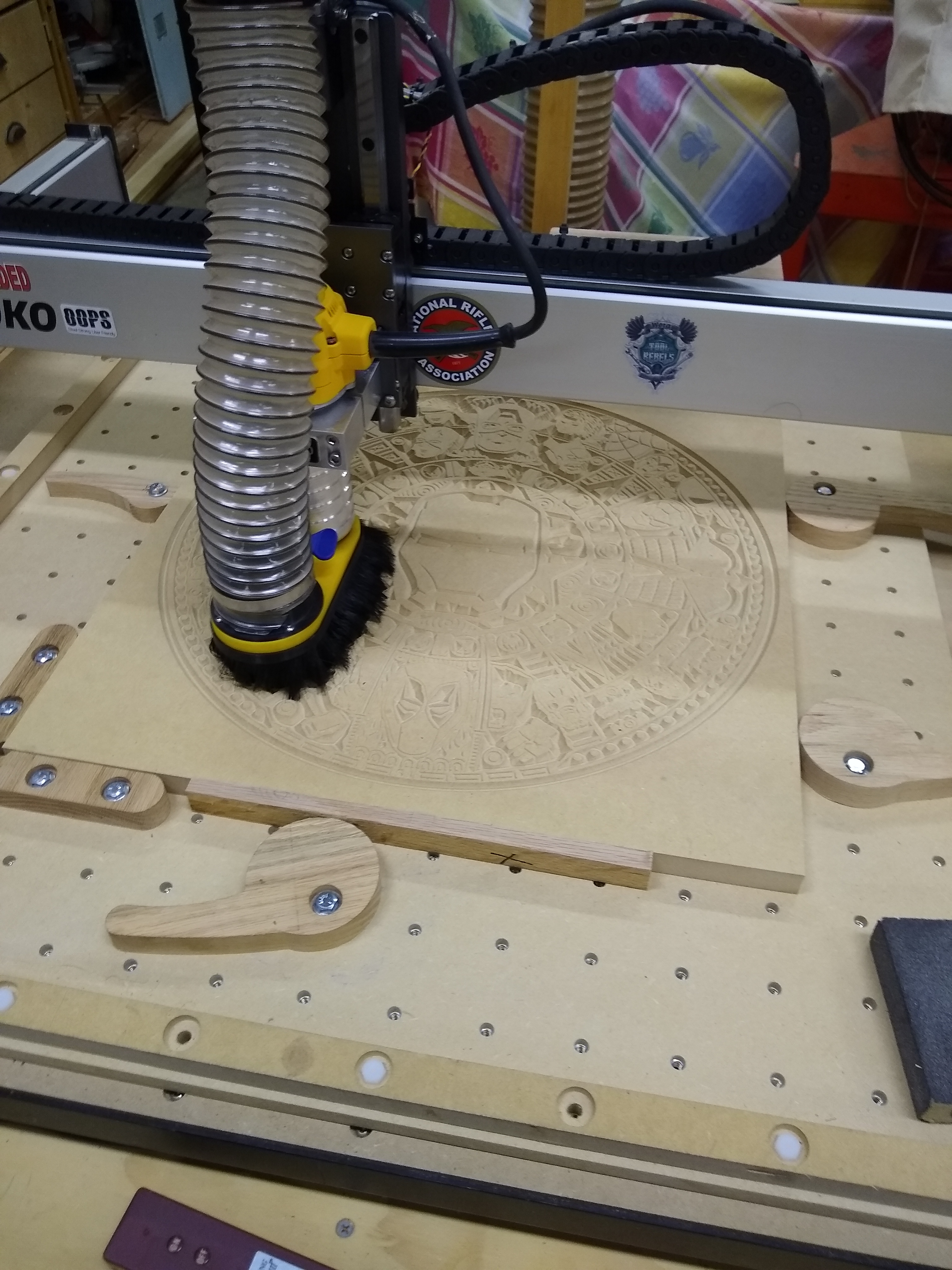

Your method works great as long as the edge does not show. For a plaque or other project where the edges show I like cam clamps. An upcut bit can shift the piece but you have to clamp down hard for the part to come loose. Any downcut bit would not likely come loose. I am not implying that upcut bits would pull your piece up and out of the clamp but these clamps allow you to hold pressure on the clamp as you tighten.
What you have got there is a Carbide3d gator tooth clamp made out of wood. I have the gator tooth clamps, the tiger clamp and the lock stops as well as OOPS clamps. However I use the cam clamps 90% of the time.

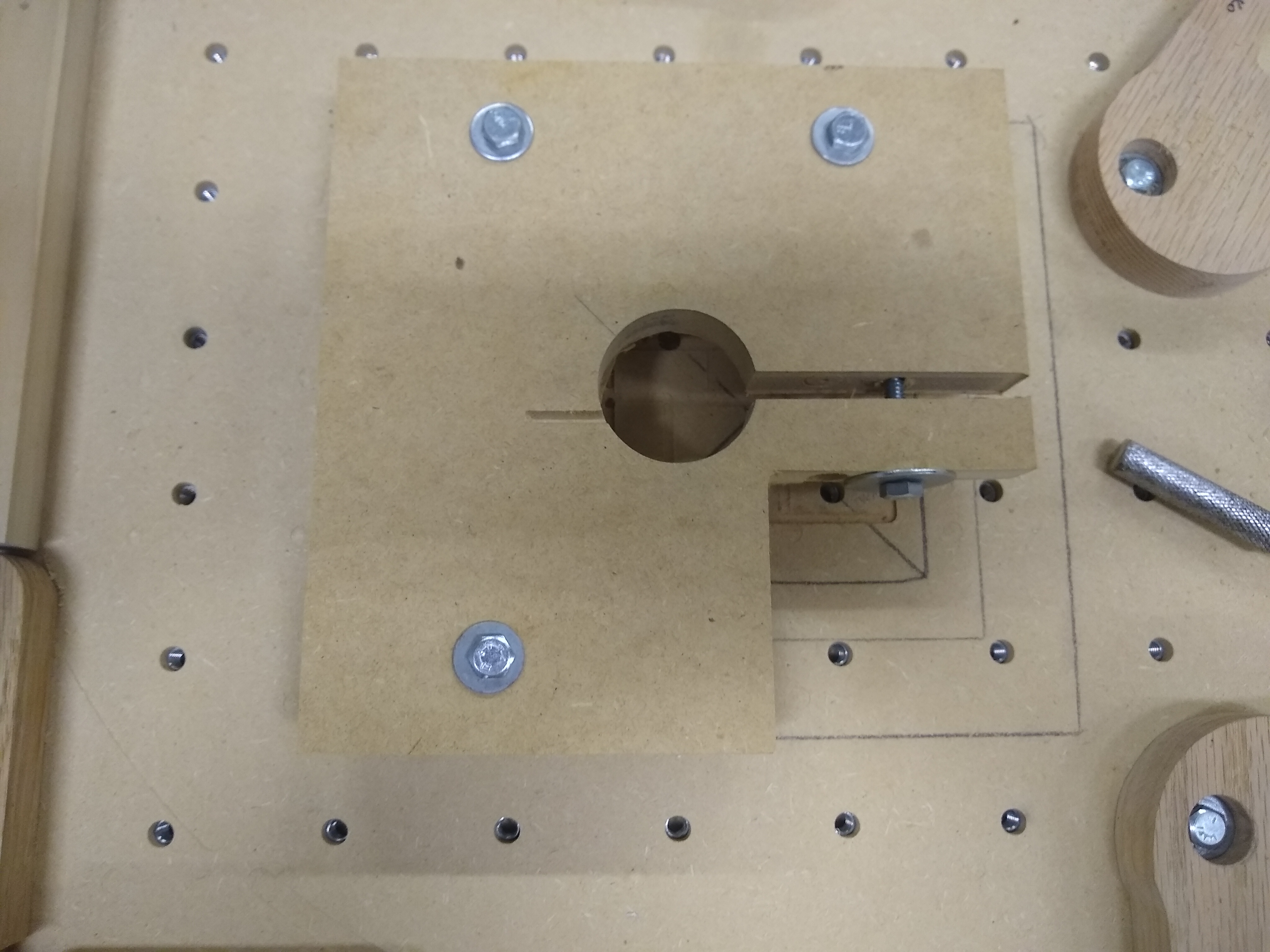

I sometimes make custom clamps
As you can see in some of the pictures I use an L bracket to capture smaller objects near the center of the table. I also have fences along the left and bottom sides of the spoilboard.
I like the circle clamp you have! I’ve used CAM clamps with no real success. That said, I agree, if you need your edges to show, you need a different hold down method. For that, I use a clamp with a kerf cut in the and and a slot to adjust to edge of piece.
