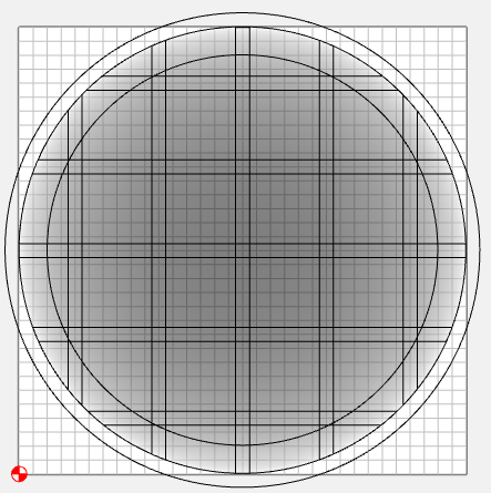

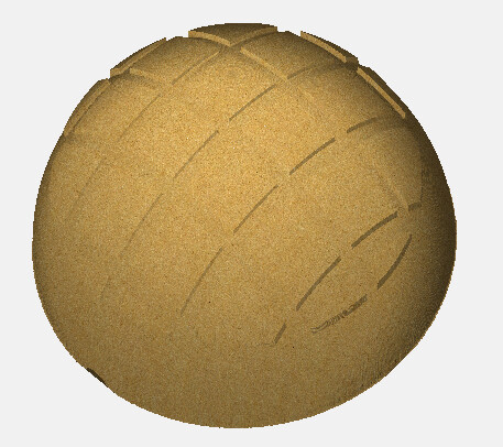

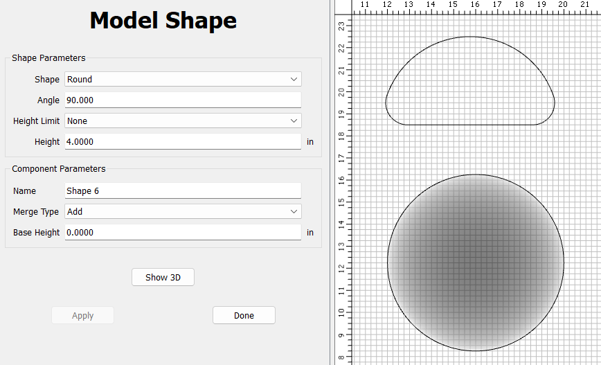

Modeling (Carbide Create Pro)
Round model with height about half of diameter.
I created a rough path with 0.1 stock to leave and a 0.010" depth of cut for display purposes only.
Then I created 2 finish paths along slots to cut the grid, and a finish path to clean up the outside edge.
Concha.c2d (3.0 MB)
