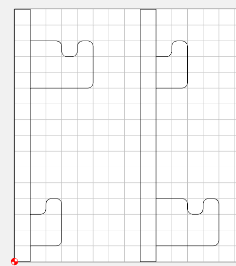

My father was a retired Marine Corps Officer and passed away two years ago. My mother gave me his sword and scabbard. I’d like to make a wall mount where they cross over one another, but as they are curved, I’m having a hard time coming up with a tool path to put them in the mount. Any chance anyone has done this before and can help or has a good idea how to come up with a path? Thanks in advance.

I made some sword mounts. One is a Marine Corp Association Ceremonial Sword and the other is a WWII Japanese NCO Sword. The thing is to put them up against a wall and measure how far out you need to make the mounts stick out. The attached file is 2 for the non handle end and two for the handle end. The Marine Corp Sword has a large hand guard. The Japanese NCO sword is fairly straight.

Here is the CC v7 .c2d file. The material was walnut. The swords will be mounted onto a piece of 1/2" baltic birch. I inserted threaded inserts into the back of the sword holders and drilled a hole in the backing 1/2" baltic birch. The backing board will be covered in red velvet.
Jess_Harper_Sword_hanger.c2d (68 KB)
