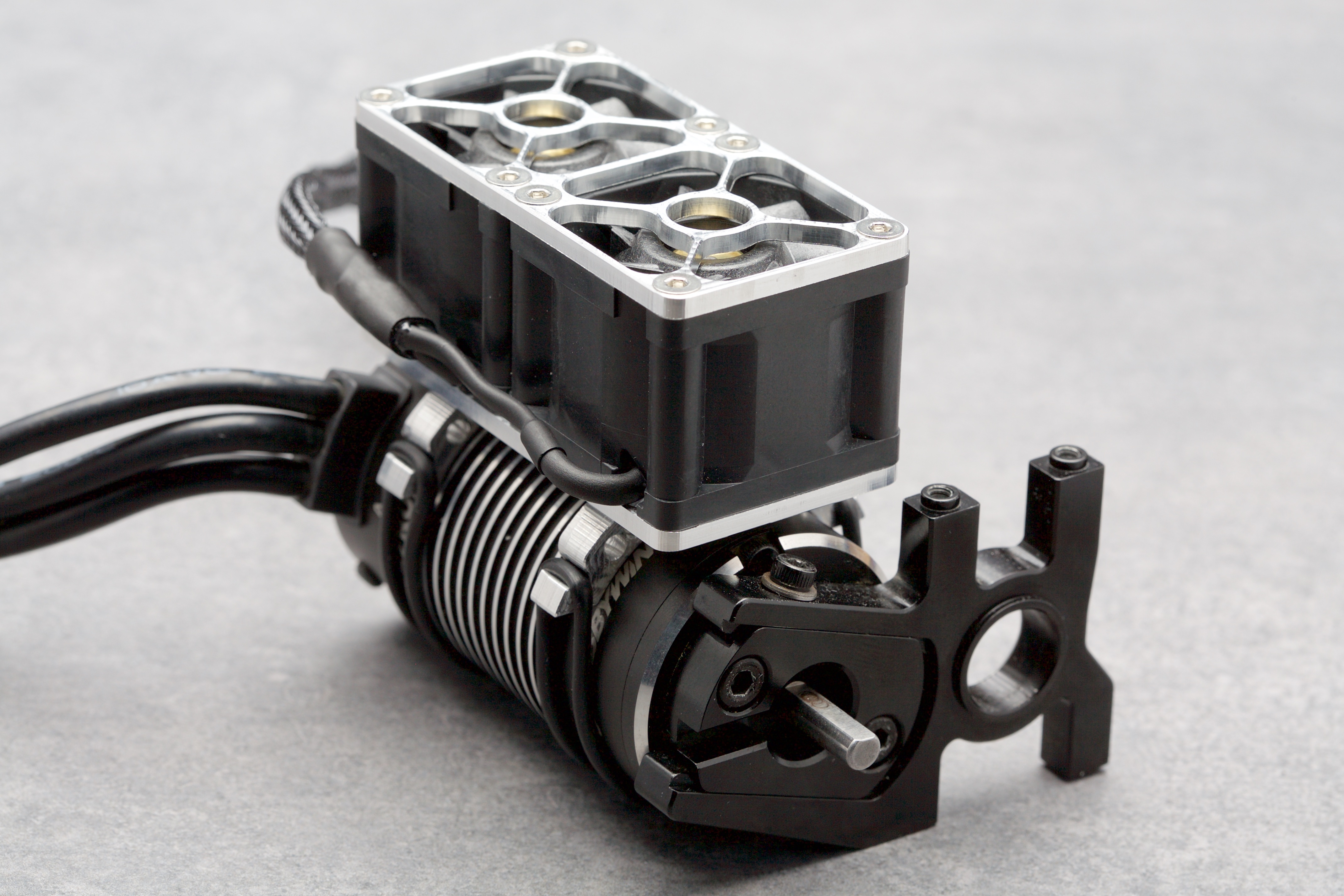

Below are some of the aluminium parts I have designed and machined on the Shapeoko. At the moment I am mostly using 6061-T6 aluminium and single flute end mills for machining. I’ve spent the last few months refining my speeds and feeds for fast material removal, whilst still providing a good surface finish. All these parts had custom fixture plates designed for them and I was using Mitee-Bite fixture clamps for the main work holding. I do also use adhesive work holding with blue painters tape and superglue, which works well for most parts that have a large surface area for the tape to adhere to.

Also here are some images of the finished parts.
