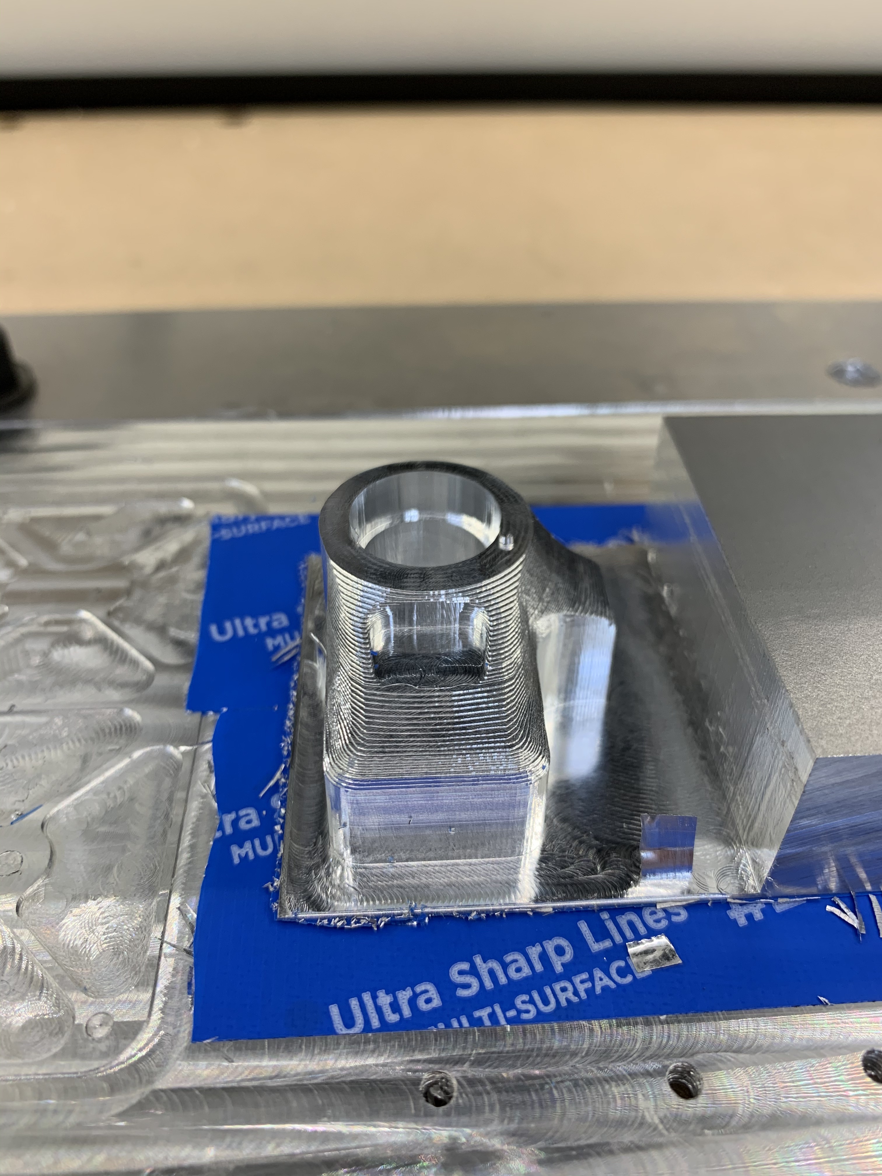

Had some holders to make and my machine made a few shiny boys :slight_smile: I would love to share. Single flute 8mm cheap Amazon cutter quite decent results!!!

10k RPM is only 100 SFM. Recommended for aluminum is much higher. Are you just trying to reduce heat as much as possible?

For the first cut I just wanted to see how that endmill was going to react. I ended up running the 1mm endmill at 30k RPM for all the other parts.

A few more parts in the works. These are just some prototypes to test the design concept. I was using a 3D adaptive strategy for the majority of the roughing and then predominantly using steep and shallow with a ball end mill to finish the parts.
The first few stages of the roughing.
The surface finish left by the 3D adaptive was surprisingly good and definitely helps produce a better overall part finish.
All of the roughing on the part finished.
Ball end mill with steep and shallow, still room to improve this further.
Another prototype part just after the steep and shallow pass.
It was good fun machining some more complex geometries and there are a lot more parts similar to this that need to be machined in the coming months.
