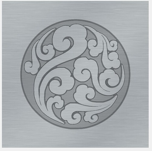

This is my design:
I’d like to mill out the negative space between the patterns, not the patterns themselves.
How would I go about doing that please?

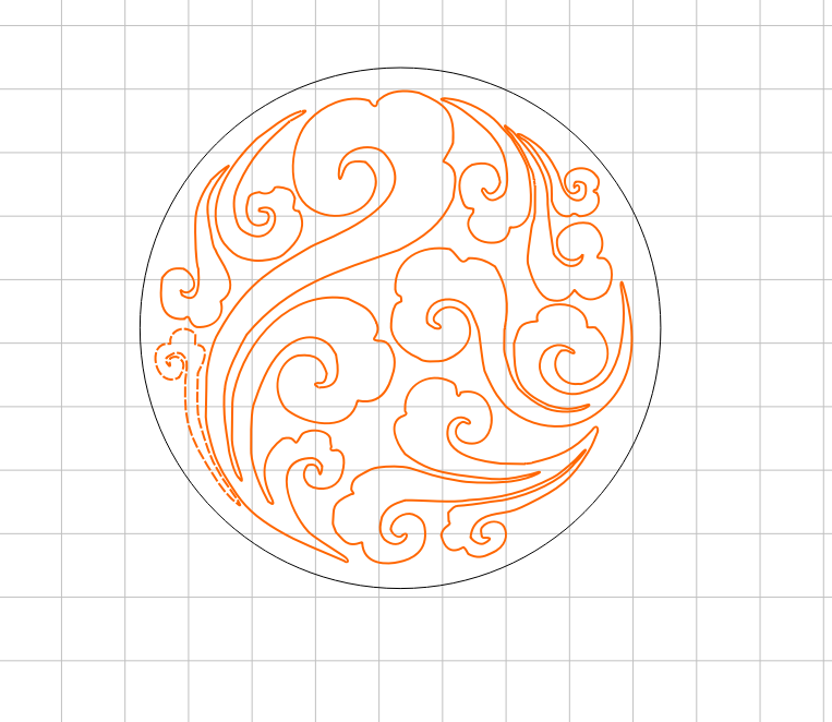

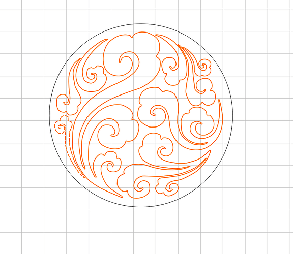

This is my design:
Many thanks,
Gunter
Also pick the outside circle
Note when doing that you’ll probably want an Advanced V carving rather than V carving toolpath.

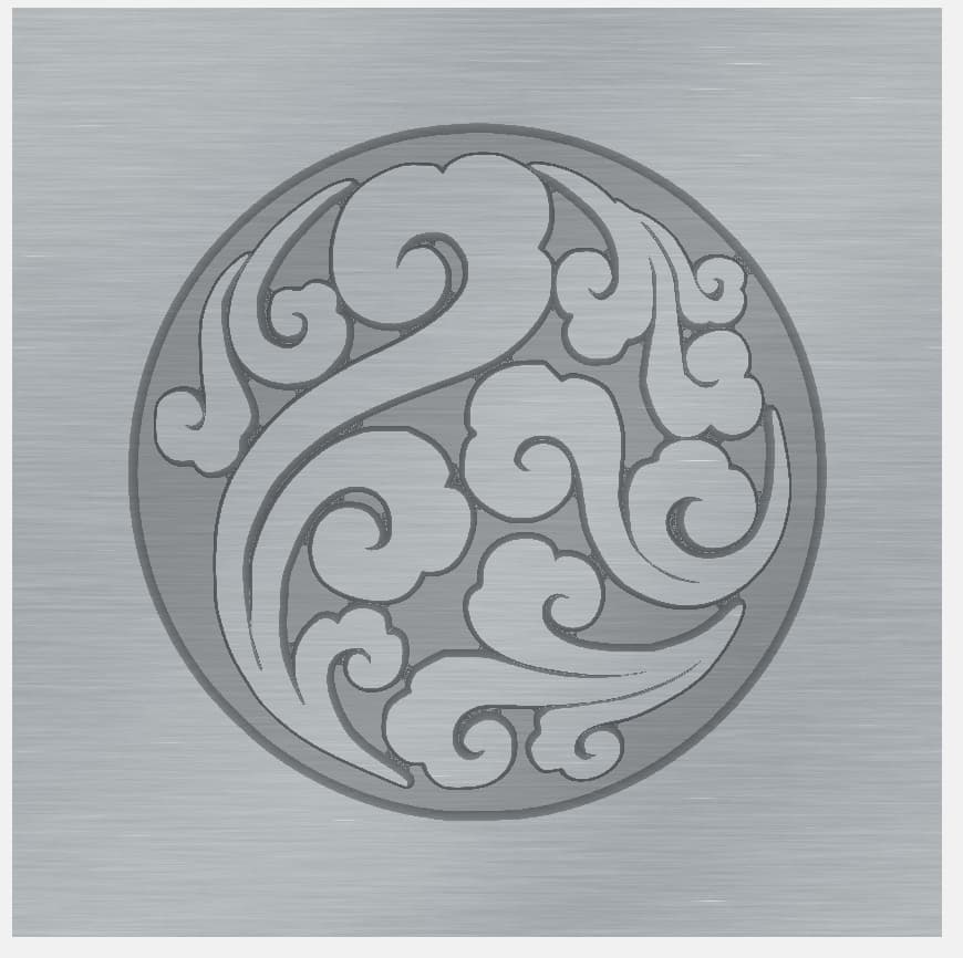

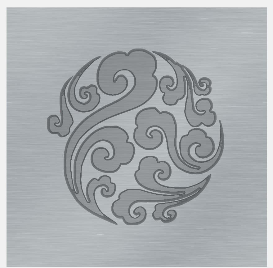

For others that may see this post in the future here are examples of picking the outer circle and not picking the outer circle.
Picking the outer circle and doing an advanced vcarve to .2"
Not picking the outer circle and doing an advanced vcarve to .2"
By picking the border around the center design you get a negative space effect and not picking the circle around the center design you get the opposite effect.
