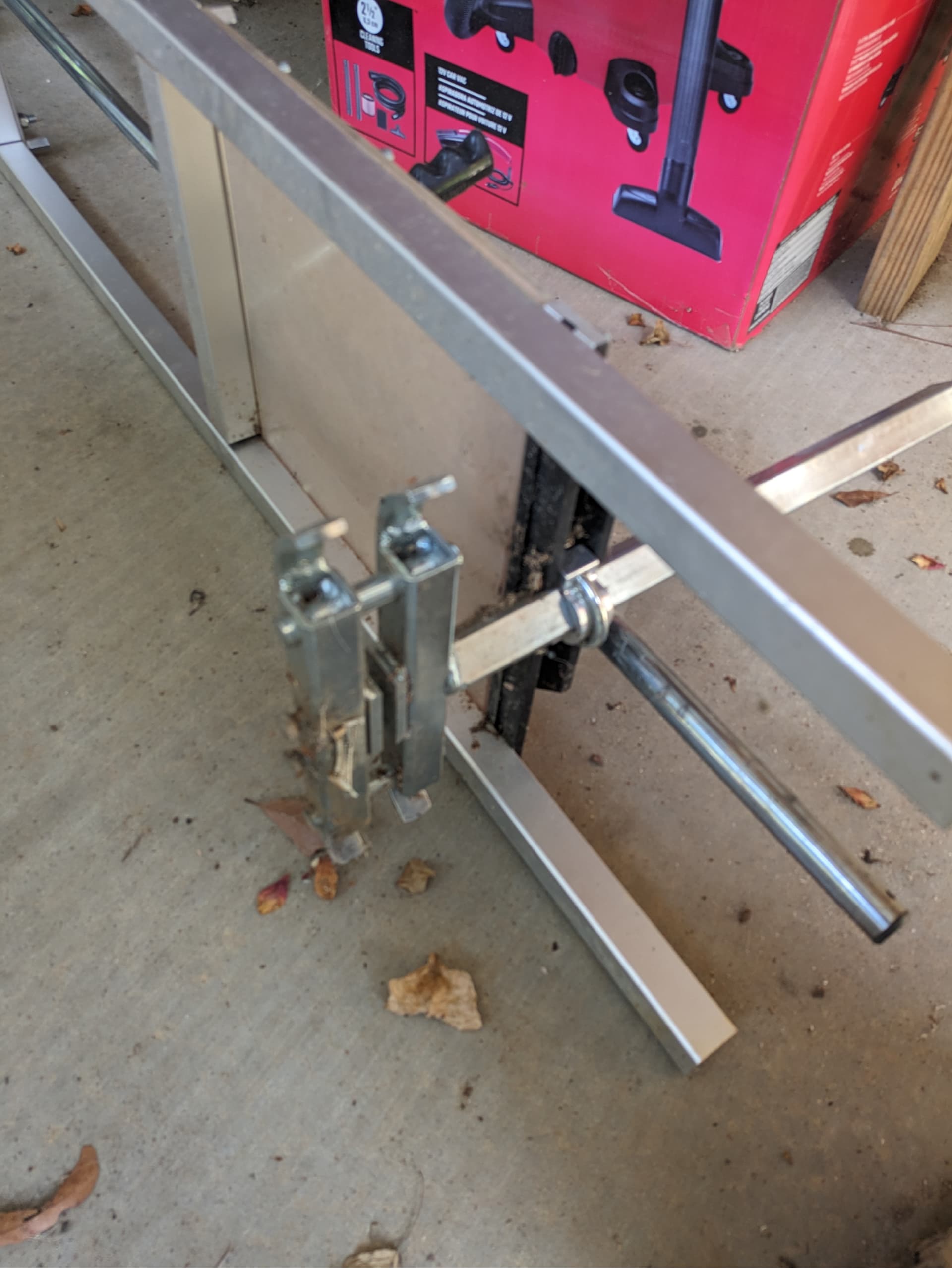

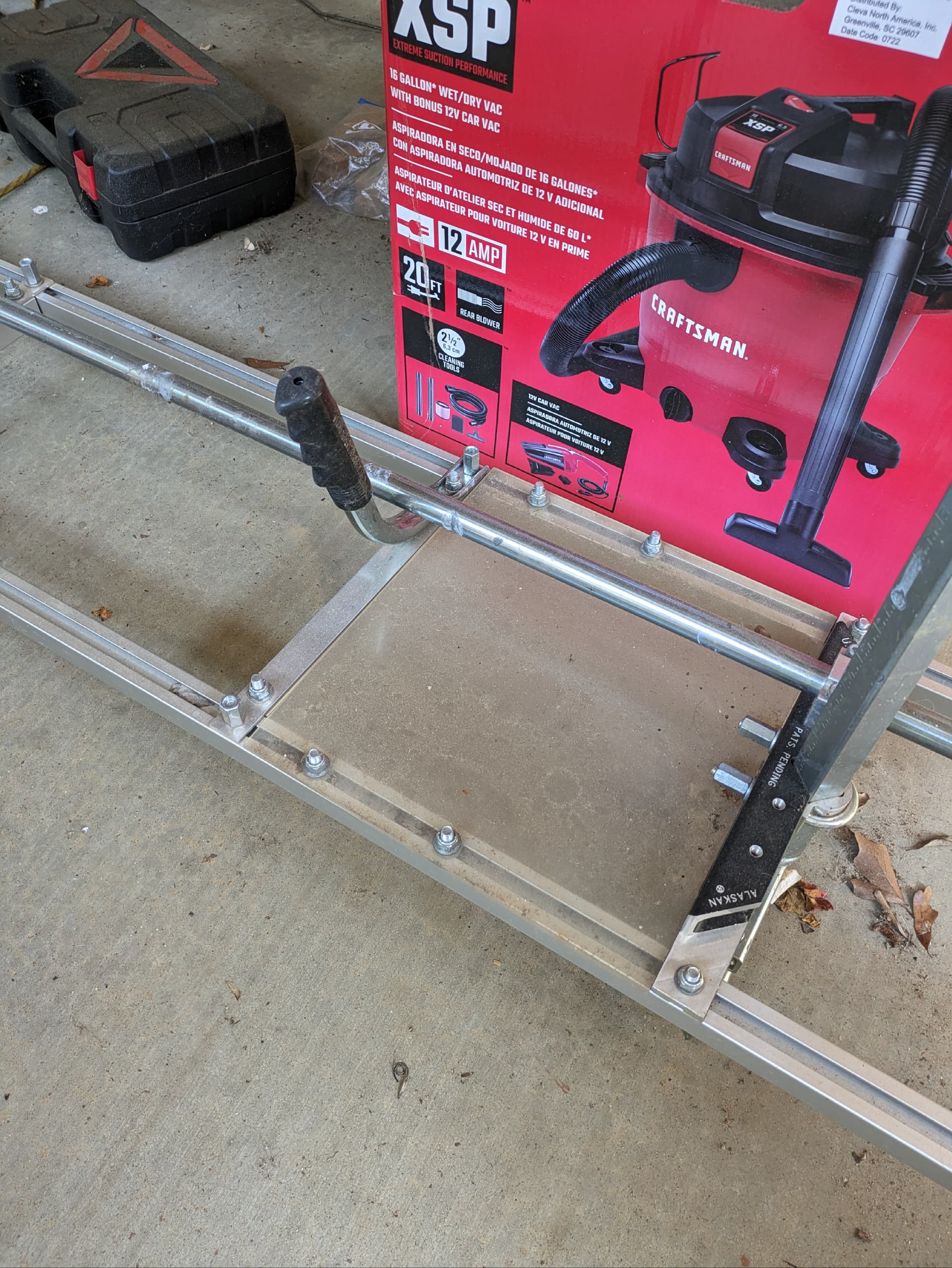

I have seen this as a cheaper option that looks as if the average handyman could configure. Lots of videos and information out there for this chainsaw mill.
Luckily I had a friend that had a saw mill. We have cut up several trees. However he sold the saw mill. Another friend gave me a 52" Alaskan Saw Mill. That requires a rather large chain saw and ripping chains. The big saws are $800-1200. I will eventually get a big chain saw. My friend with the saw mill had tractors and equipment to move the logs. I do not have all that equipment. So cutting the tree up on site to get it loaded onto a trailer is my best option.
The Alaskan Saw Mill requires a flat surface for the first cut. Like in the video they are using a section of a ladder. You can make your own with some square tubing or buy some commercial ones. However the commercial ones on Amazon are pretty spindly. Using a ladder or buying some 2" square tubing and welding or bolting them together is not too expensive or hard. After the first cut you have a flat surface that the Alaskan Saw Mill rides on and the ladder is no longer needed.
The key for any saw mill operation is the equipment needed to handle logs. Thus the reason I am going to use an Alaskan Saw Mill because I can cut up the tree where it fell and load it into a trailer to bring it home to start the drying process.

Granberg Alaskan Mill is what I am looking at, a quick google or amazon search will show it,depending on the size they are reasonably priced.
Someone gave me the Granberg 52 inch. You can use a shorter bar because it is adjustable. So get the new longer than you think you will need. The limiting factor is your chainsaw bar length.
