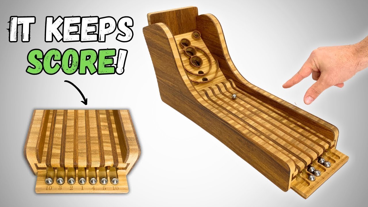

I bought the file and the Bamcore material from him and did a couple of test cuts this weekend.
His depth per pass is way more aggressive than I am used to using. In fact he does the majority of it with a 1/4" downcut bit and is going .315 or more in some places. I did one test and it seemed OK albeit noisy and I wasn’t really happy with the edge finish.
Then I tried another test with a more complex profile and my bit pulled down and chewed into my recently smoothed spoilboard. Then I did a third test with #201 and a more conservative .125 depth per pass. That one produced much better edge finish results but of course didn’t look as good on the top surface.
I just reworked the file splitting each of his 1/4" downcut toolpaths into two. One is still using the downcut but only goes .14" deep (top layer thickness on the material) and then the second uses #201 with a .125 depth per pass up until the various required depths.
Naturally that takes runtime on the job from 38 minutes the CIC way and 1:45 my way. Hopefully I can give it a go this weekend. Curious if anyone else in the group has tried it.

When I bought the file I figured I would source the plywood locally but I was not happy with what I could get so ordered the panels from CIC. The multi color layers give it an interesting appearance.
One of the tests I did was a back plate with an outline of a horse carved into it. That one was acceptable so I at least have one piece done.
I got all the pieces for the first one cut out. I had to stop the job a couple of times and make changes to correct something but those were all BEFORE I screwed something up not after.
The tabs for those long pieces with the holes were not thick enough and there was not enough surface area for the tape to hold good so as it was doing the Final Cut out on them I would pause and remove the piece.
There is one piece that I see some chipping on but it will not be visible in the final product. I need to pull the rest of the pieces apart, cleanup, glue, assemble, sand and finish. Tomorrow is another day.
I had time this weekend to glue up the subassemblies, finish and then final glue up.
It turned out pretty good. There are a few lessons learned and things I would change.
The 1/8” holes that are used for alignment for gluing the subassemblies are too small for the bamboo skewers that were linked in the YouTube video. I enlarged the holes manually but that added some slop and in the end I didn’t use them. I just bought a mini Rockler panel clamp a few days ago so I put it to use here. I did use one skewer until I had the panel clamp tightened up.
The backplate (thing with the horse) is a little too narrow for it to be glued in place so I let it be removeable. When I make another I will have it slightly wider.
It would be nice if there was a covered compartment to store the balls. Something else for V2.
The ball bearings are kind of heavy and have a tendency to jump from one score slot to another on occasion. I am not sure there is a good solution for that.
The material is nice (and heavy) but there were some discolored spots that are apparent on the main deck. Since that’s edge grain from the plywood you can’t see the issue until the cuts are done. I rolled with it this time. The 2x2 sheet has enough space to cut a couple of spares so maybe next time I will try that.
The plans didn’t call for a roundover on the edges, but I put one on manually in all the places that seemed like it made sense.
I bought Odies oil to finish it but decided to use wipe on poly instead. I have not tried odies before and I was concerned about being able to properly buff off the oil given all the nooks on that piece with the rings. I would have liked to sand that piece a little better but it’s tough getting in there.
All in all it was a fairly quick project that I am sure my kids will enjoy. I mean fight over until I get more built.
