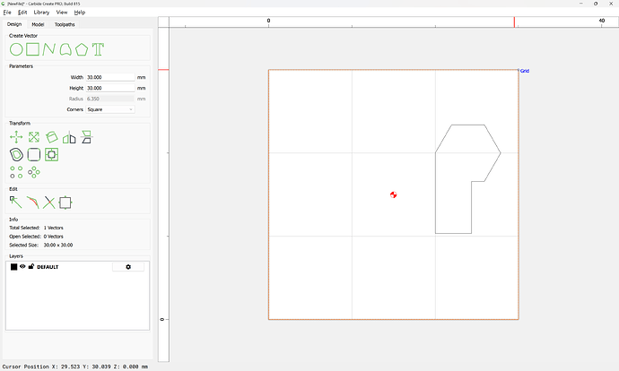

Thanks for the quick reply. I’m not sure I’m following exactly. My goal is to position a few items on one side of a board…then, mirror/copy those exactly the same to the other side using a line positioned in the exact center of the board. Does that make sense? Does “mirror” have that option in CC?
Mark
No, one has to have symmetrical geometry with a greater extent, centered on the desired line of rotation.
If one wishes to flip this so that it is mirrored on the Stock:
Then draw geometry representing the Stock:

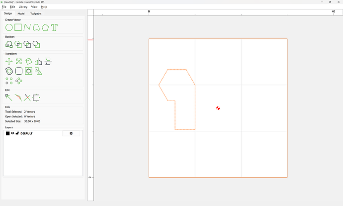

Select it and the geometry which you wish to flip:
and Mirror:

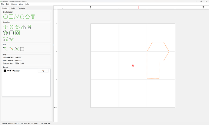

Usually, I just do the flip and then “drag into alignment”.
I believe you are interpreting this correctly. I would draw original element with geometry (square the size of workspace or project) and then draw in a reference centering line based on where you want the object to reside. Then copy/mirror object and paste/align on centering reference line with specific nodes to match original as Tod1d stated.
