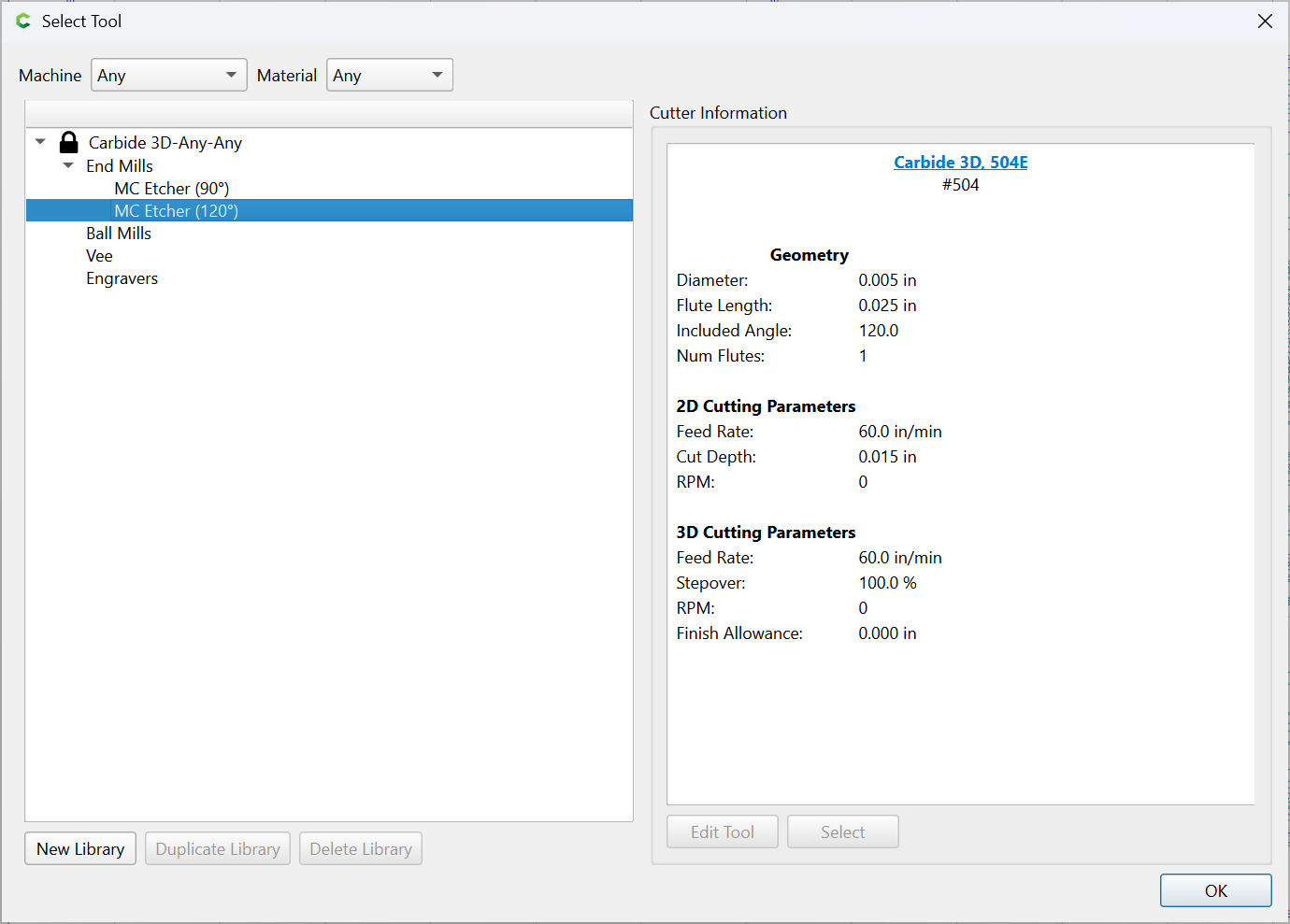

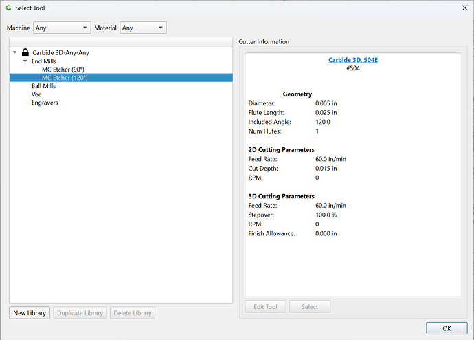

I was trying to add the IDC database but apparently messed something up. Now I cannot see any tools including the ones from Carbide 3D. All I get when I open the tool database is “Carbide 3D Any Any”. There is nothing underneath it. Since rebooting didn’t help I uninstalled and reinstalled Create which did not solve the problem. Anybody know what I did and how to fix it?

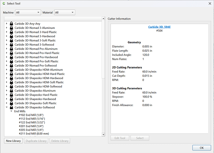

For Any/Any, you should see:

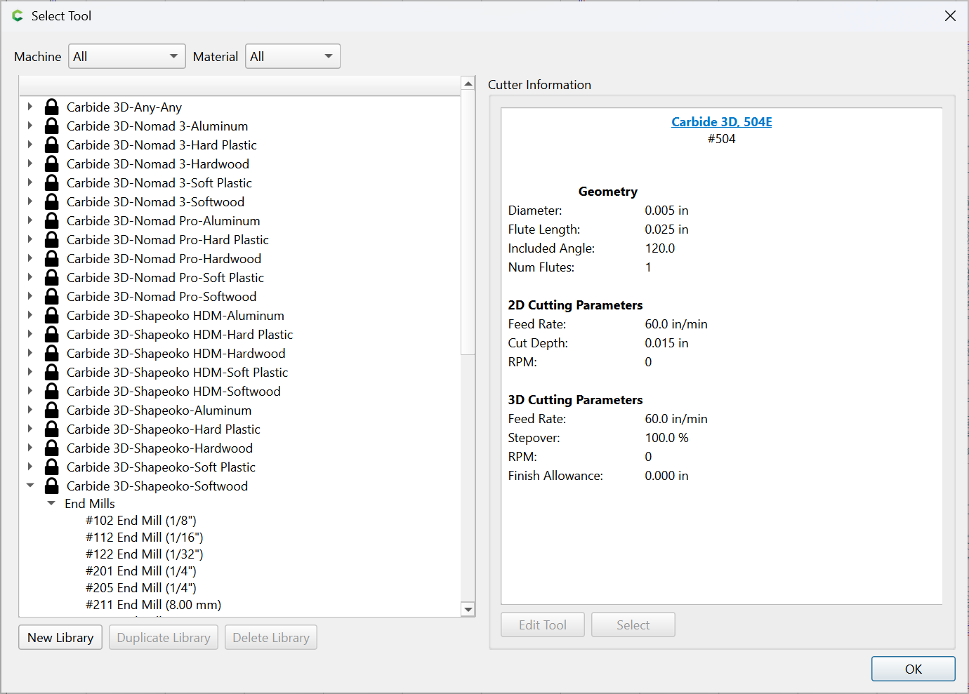

If you change it to All/All, you will instead see something like to:

Thanks, Will. You were right on. It turns out my window for the tools database was so big I could not see the Material setting. Once I scrolled over ( lots of scrolling) and found it I changed it to All and things were working again.
