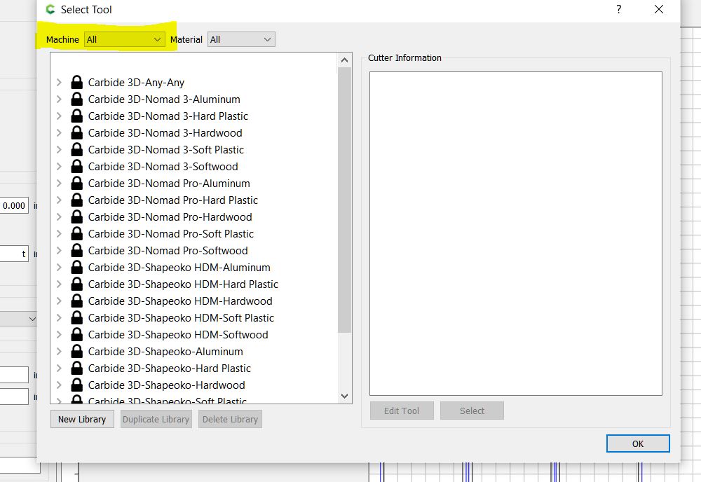

I purchased carbide create pro, and I was wondering where are all the tools are in the tool library, it seems like I have a limited selection. When I watched the training videos it looks like there is a lot more in his library
On the Tools menu, in the area I have Highlighted you can choose what machine you want to associate with.
The pro and free versions are identical in tools. The only things pro adds is more advanced tool path but all of the free functions are identical. It may be as @Zman suggests you can filter what machines you want to display. If you have custom tool then the naming convention needs to include the machines you select so you see them as well. You can always change what is displayed as @Zman showed above.
