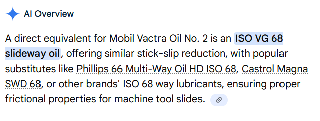

Hello all,
I run a Shapeoko 5 Pro and need to lubricate the linear rails ASAP. I know they make a product specifically for this. However because I already have pipettes and syringes for applying lubricant and the fact I’m in Canada makes it impractical and longer shipping times to purchase small accessories from the states, I’m looking for another place to acquire some of the oil recommended.
Does anyone know of a Canadian supplier (especially if out in BC) that sells Mobil Vactra No 2 Oil in quantities of 1 gallon or less? Am also open to suggestions on comparable lubricants if anyone knows of any that would act as a “dupe”, i.e. similar viscosity, corrosion resistance, etc.
Any help would be greatly appreciated!
I did a google search and found this. The thing about this oil often called way oil is it is used in large quantities in a machine shop. That is likely why you cannot get it in small quantities. I bought a quart off ETSY and that is likely a lifetime supply.

@gdon_2003 It’s not related to environmental laws. It’s available in Canada but every distributor that I talked to only sells it in 45 or 55 gal drums.
You can try calling around to a few local machine shops. Most should have huge jugs of the stuff. I bet one would be more than happy to sell you a small quantity of the stuff for a few bucks if you brought your own container.
