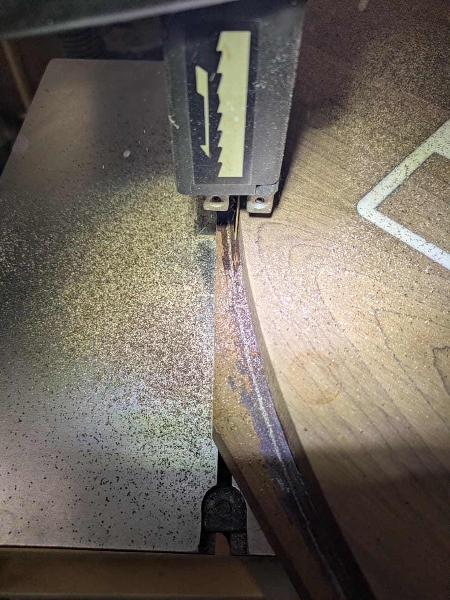

So Guy, are you planning on sanding the glued ring to match the table edge? Or do you have some other diabolical trick? :smiley:
I will take the glued up ring to the bandsaw and cut close to the line of the top and then use a trim router bit with a bearing to clean it up.

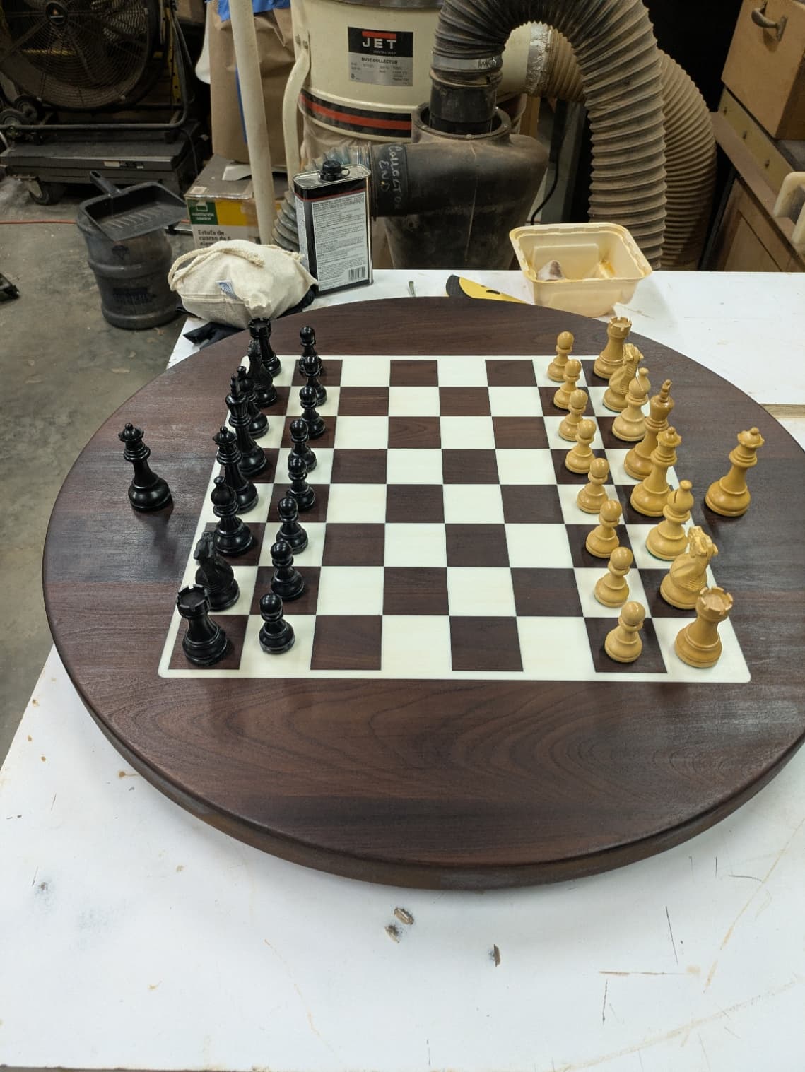

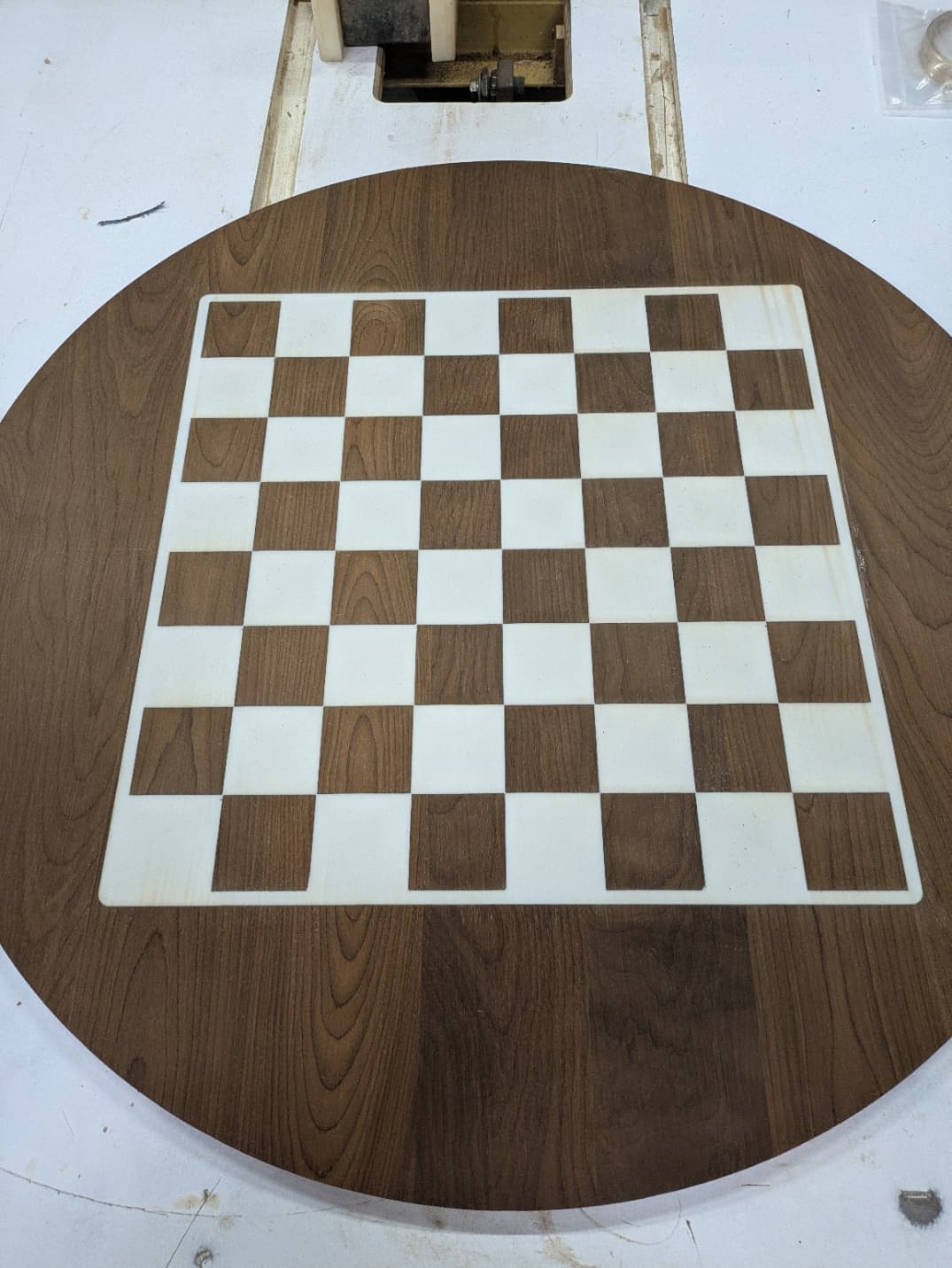

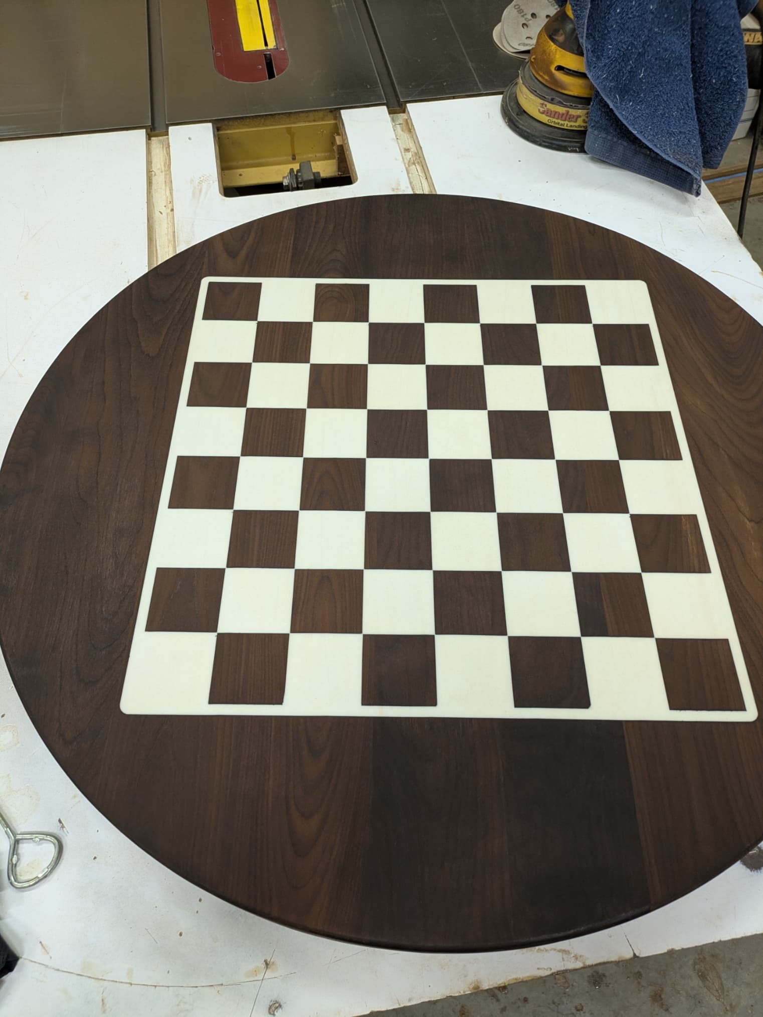

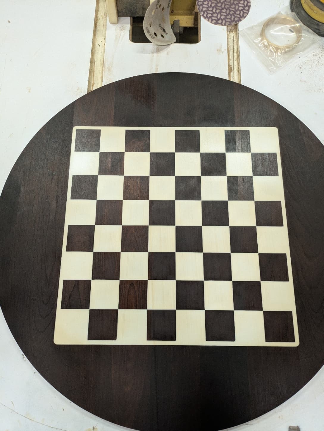

Wow. Got my chess board top sanded down to 220. I applied mineral spirits to clean it and after drying I will go 320 and 400. This looks fantastic and beyond what I expected.
Before mineral spirits.
After mineral spirits.
I plan on using wipe on polyurethane so the mineral spirit pic is what the finished piece will look like. The Peruvian Walnut really darkens when a finish is applied.
I ordered a nice set of chess pieces from Amazon.
I could make chess pieces but frankly I am ready for this project to be over and done.

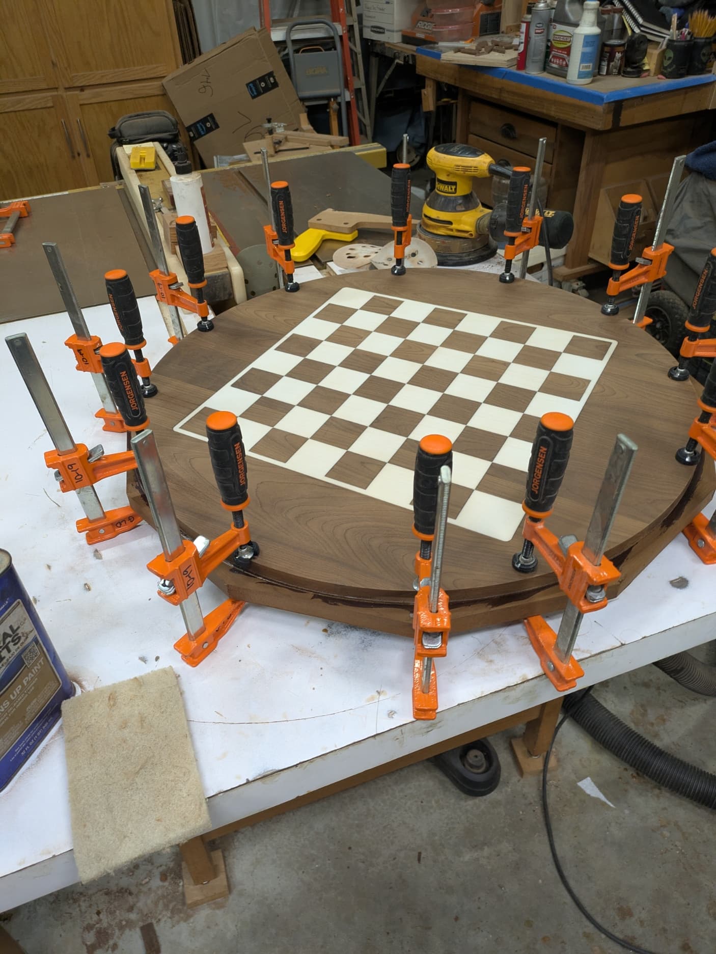

Next is gluing on my segmented bottom of the top and let it dry overnight.

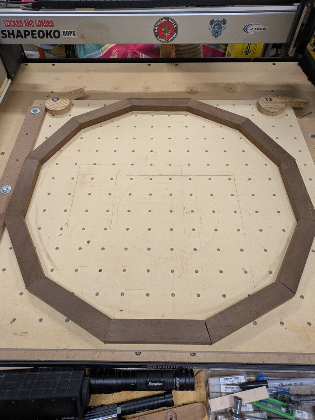

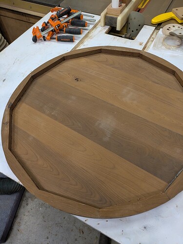

Got my segmented ring glued to the bottom of the table top. This morning I used my little bandsaw to remove the excess part of the ring. Later I will use a flush trim bit on the router table to clean it up.
The segmented ring was to make the top appear thicker. My next step is to attach the top to the base. The top ring of my base has 12 sides. So I think I will make a segmented ring to fit inside and use my SO3 to cut the 12 sided recess in the bottom of the top. That way the top can be removed but the 12 sides will keep the top from rotating. With a game in progress you dont want the table spinning and knocking your chess pieces off the table, specifically if you are winning. :grin:

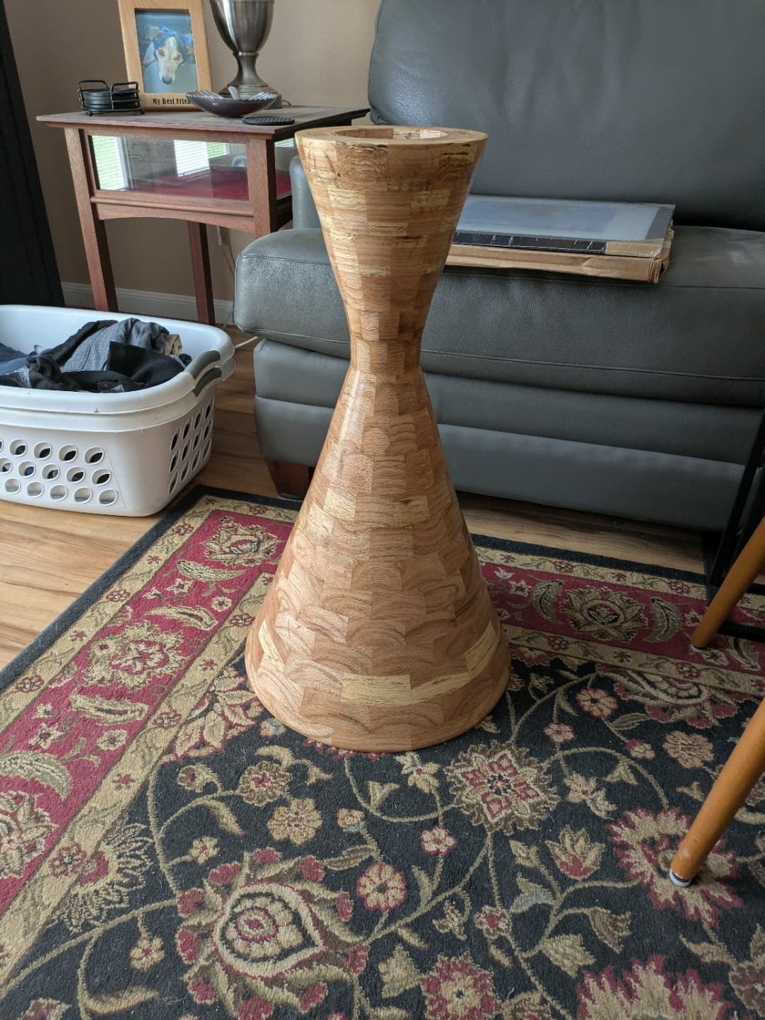

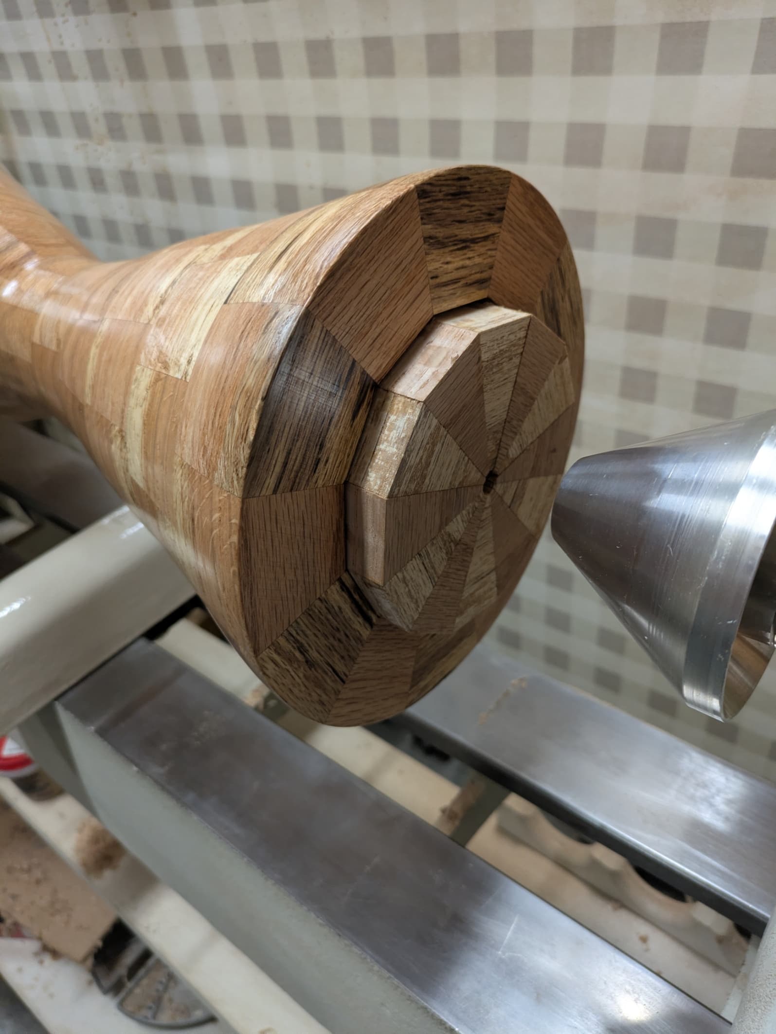

Getting closer. I had to add some layers to my base. I had the base sitting in the living room and sat the top on it. I pulled up a chair and thought it was a little low. I added 3 layers to the table. The beauty of segmented woodturning is you can add/remove layers if proportions need it. The added height is very close to the golden mean in proportion. Here is a picture of the addition.
I got my top finished sanded and the first coat of polyurethane on it.

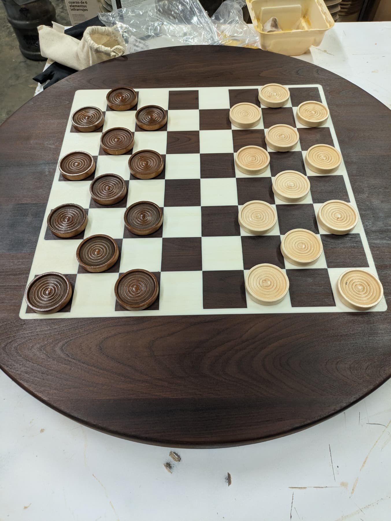

Amazon delivered my chess pieces and the checkers today. So the project is coming along.

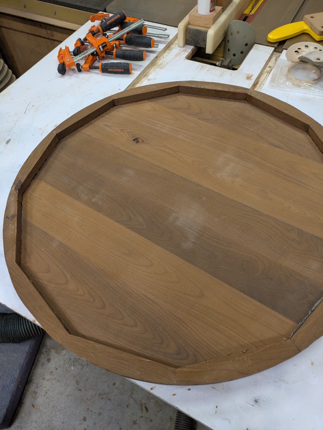

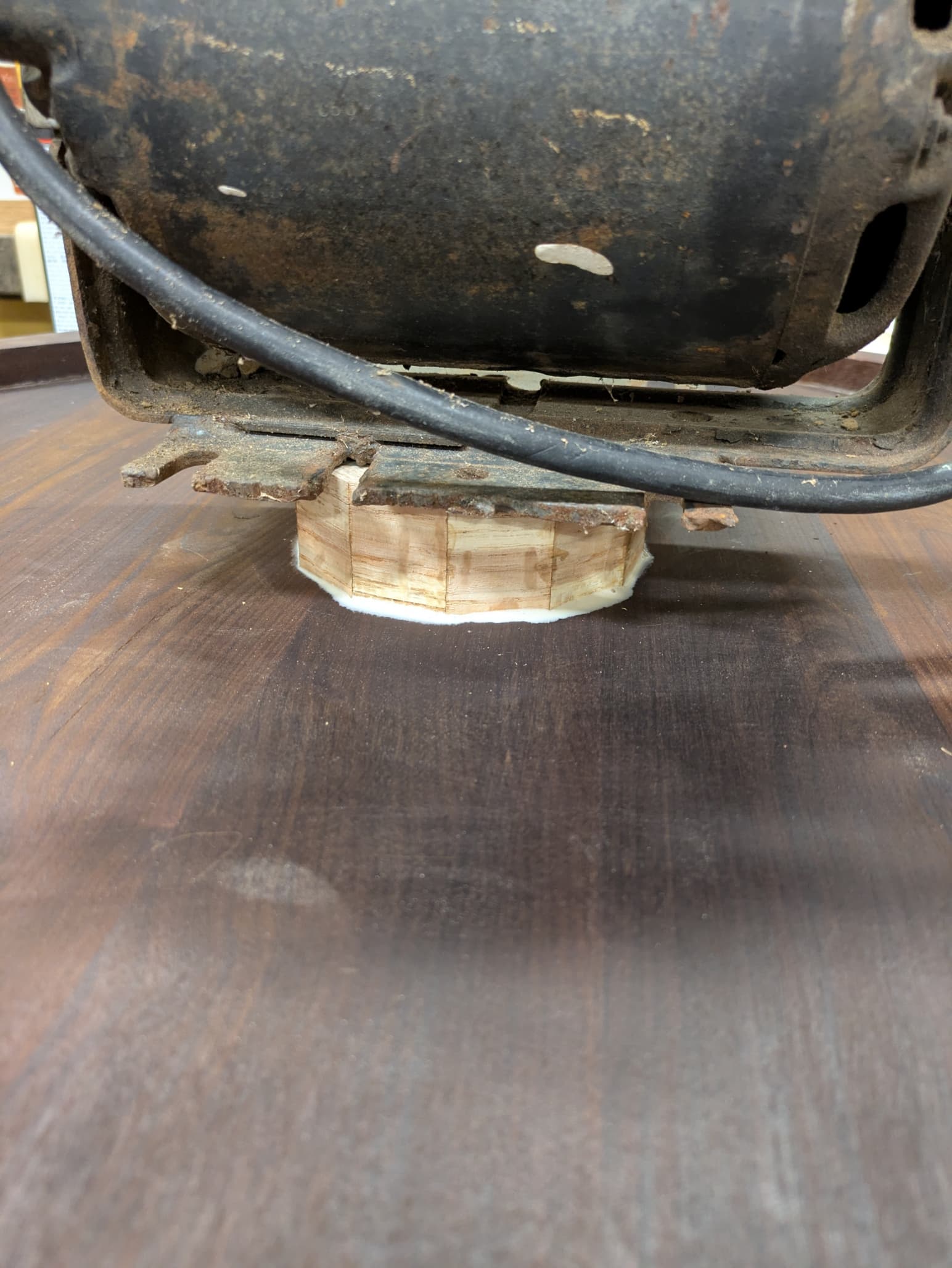

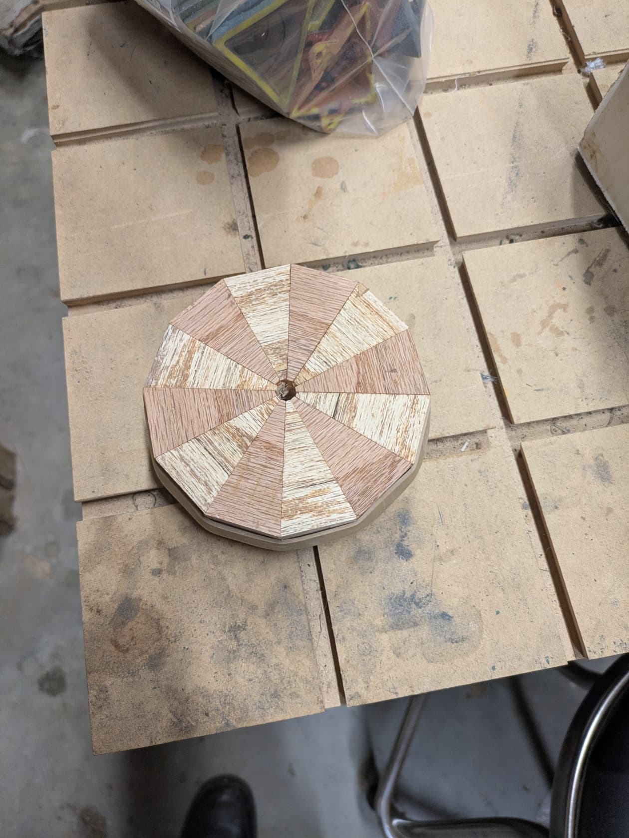

My last piece of the puzzle was to attach the top to the base. I wanted to be able to remove the top for transport but be stable when on the base. I made a 12 sided ring that will fit inside the top of the base and will use my SO3 to cut a corresponding pocket in the bottom of the top. It was glued up earlier and still needs some sanding and possible some fitting.
Here are a few shots of my chess/checker pieces. Also how I am going to mount the top to the base.

I got my plug in the bottom of the top machined and the plug glued in.
I sat an old motor on top while the glue is drying.

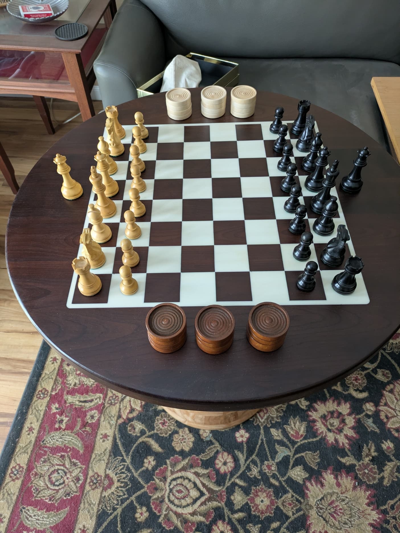

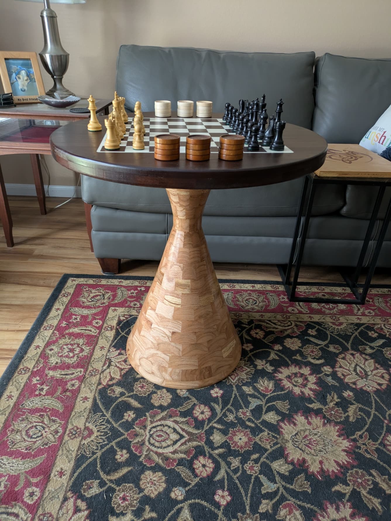

The chess table is complete. I enjoyed this hybrid project. I combined segmented wood turning, CNC work on the chess board and epoxy with traditional finishing.
Here is the finished project.
Anyone interested here is my build document on google drive.
