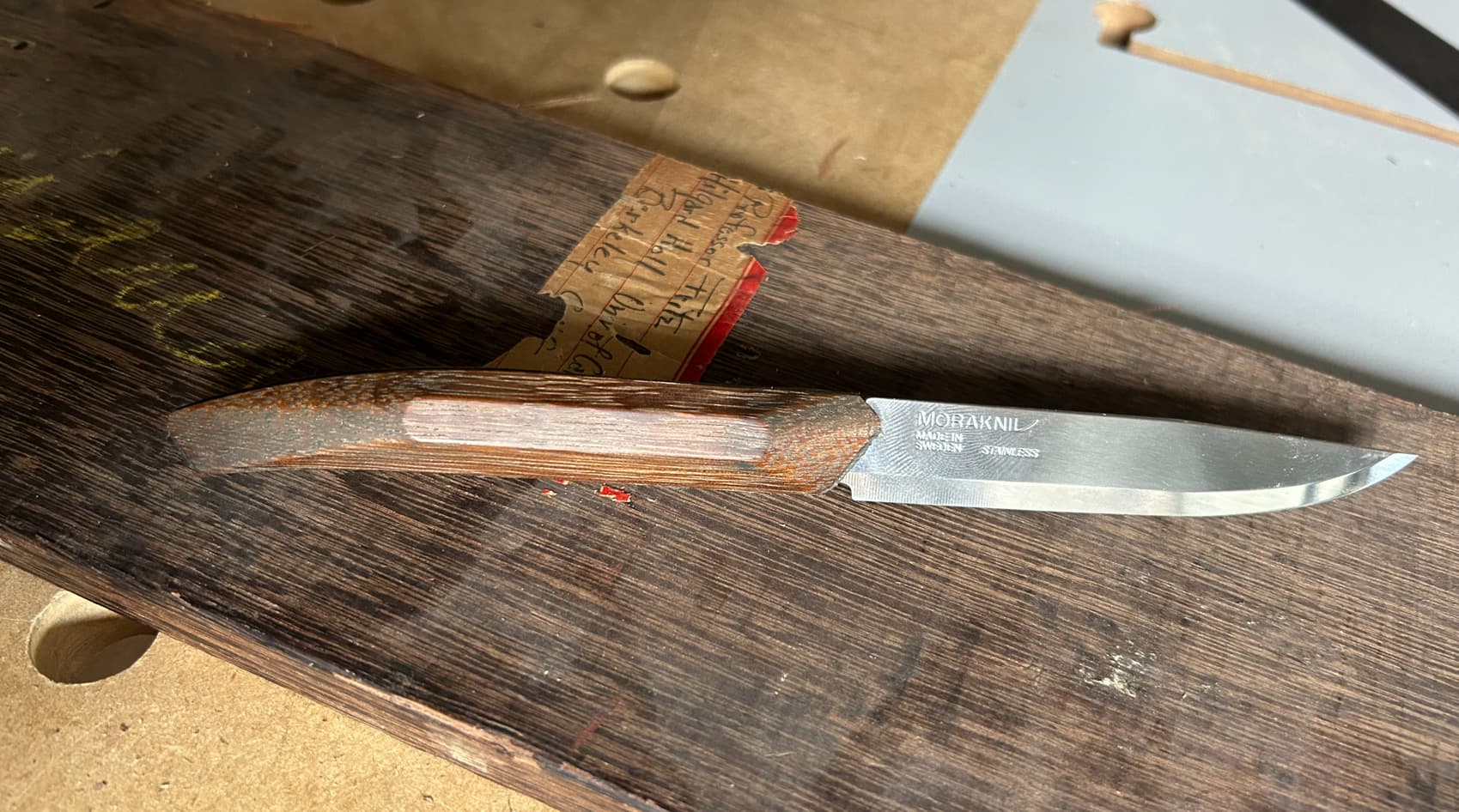

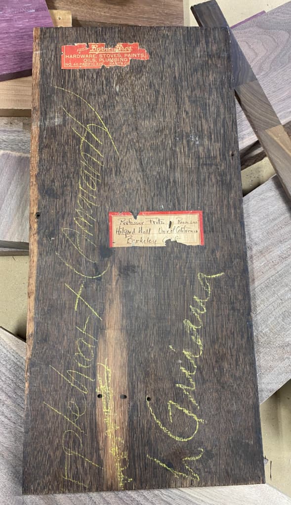

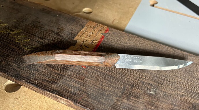

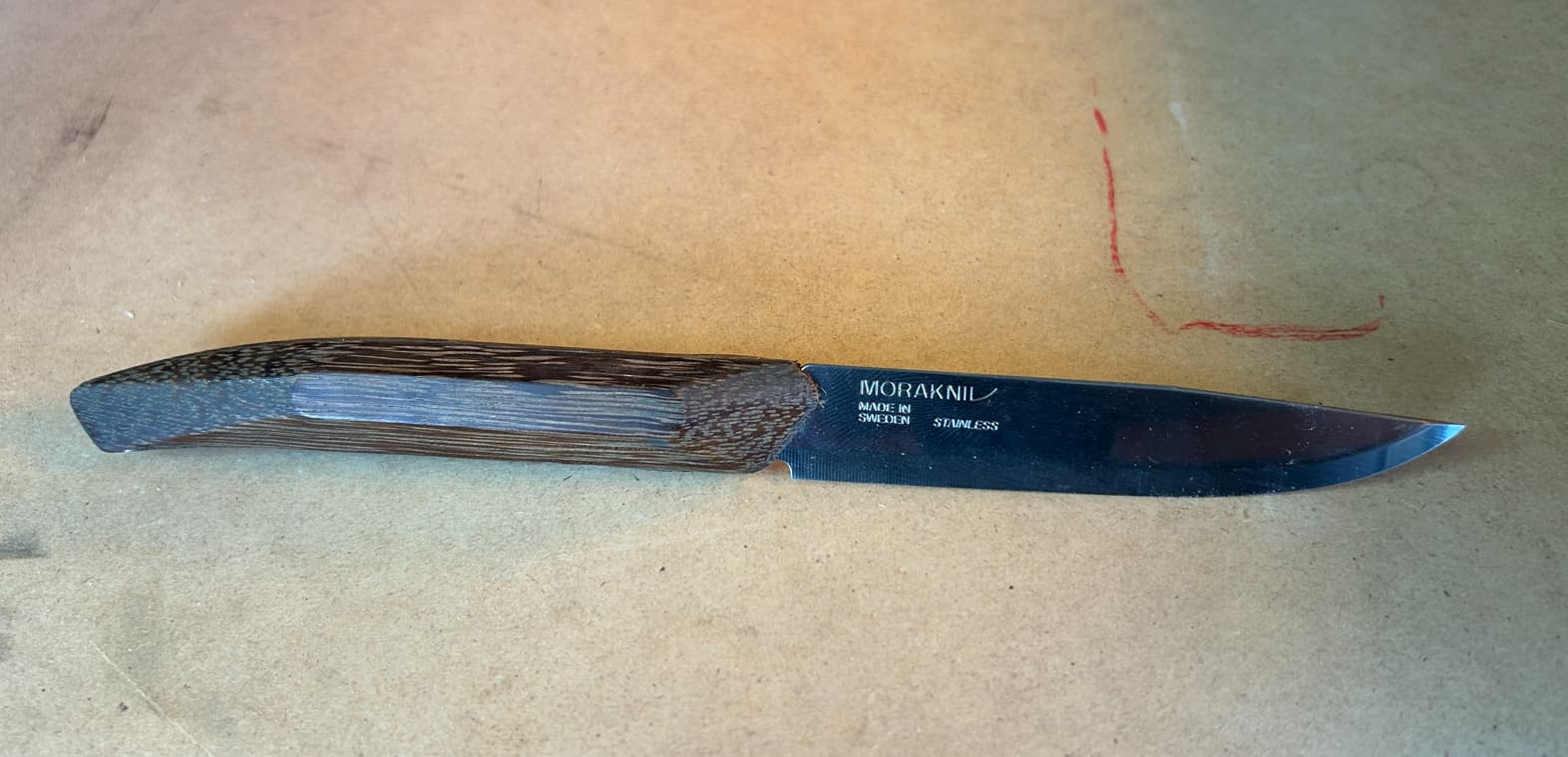

Working on some knife scales for Morakniv SS knife blanks. The wood is an offcut from UC Berkeley when they were studying wood properties, sold by a hardware store in Santa Cruz called Byrne Bros around 1910-1930. It says purpleheart/amaranth a few spots on the board. Have been saving it for the right project.

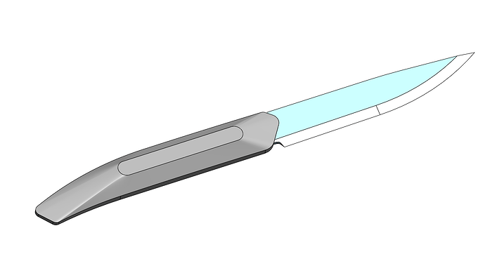

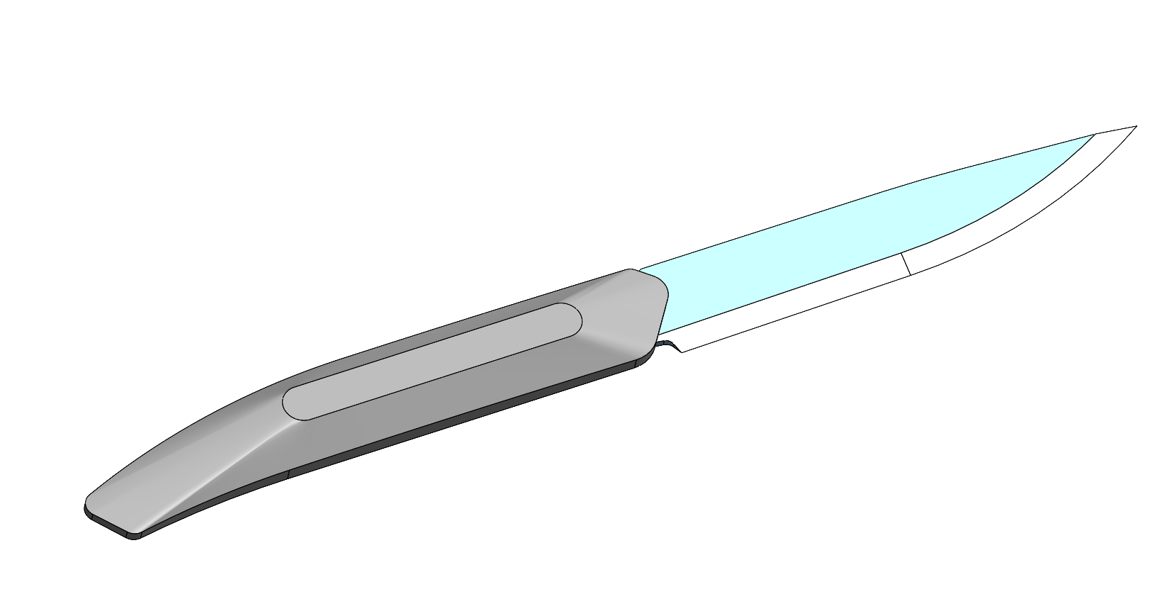

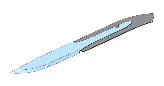

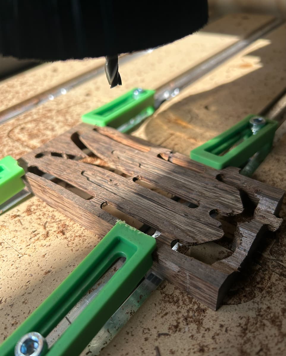

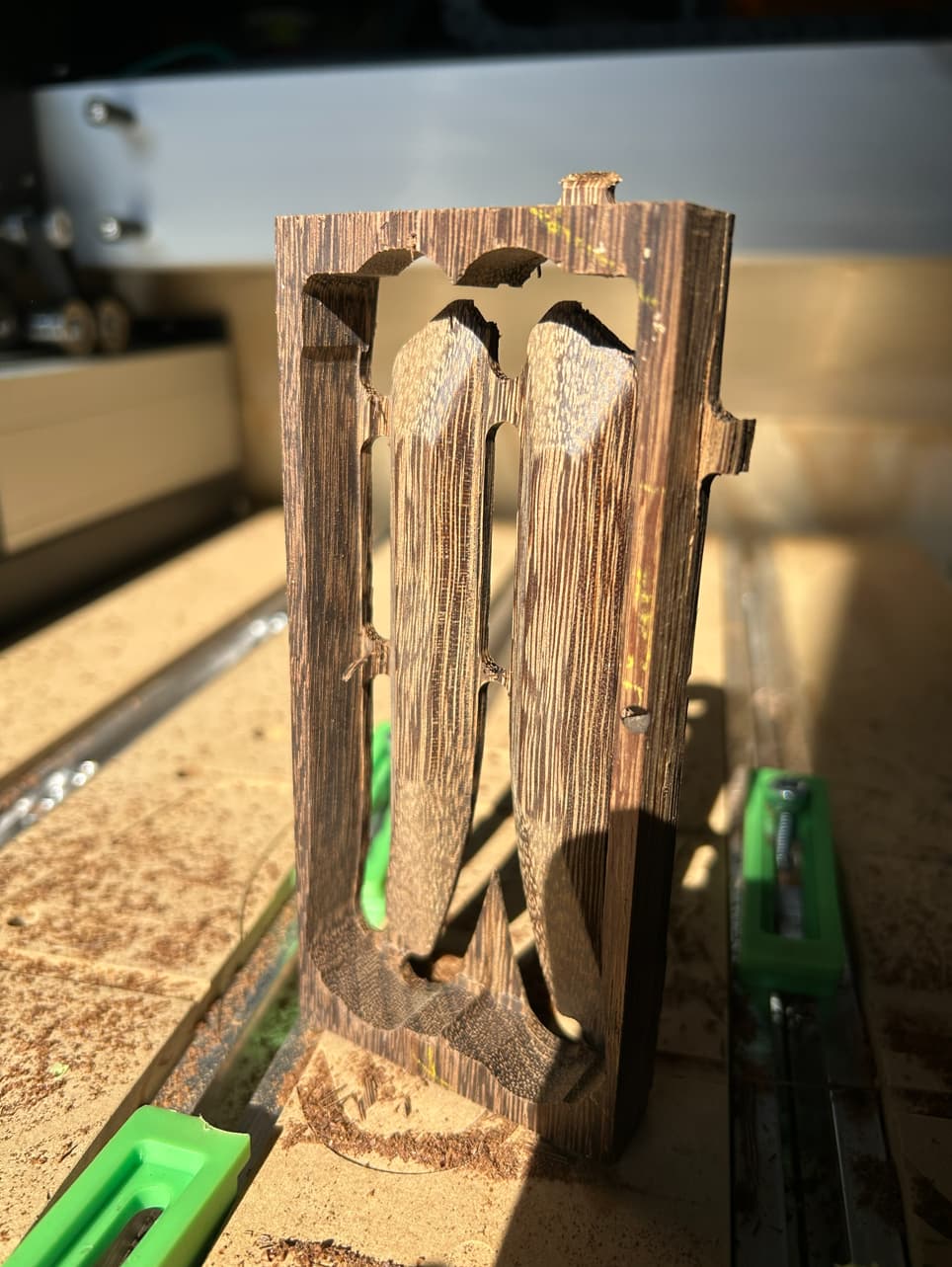

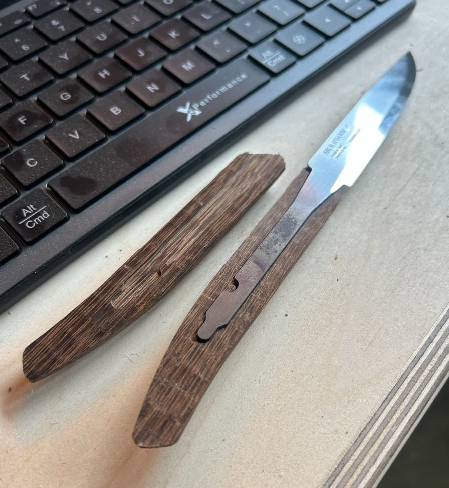

It’s a fun process and has yielded good results so far. I did. I had to add some geometry since the parts require operations on both sides, but overall it worked really well.
