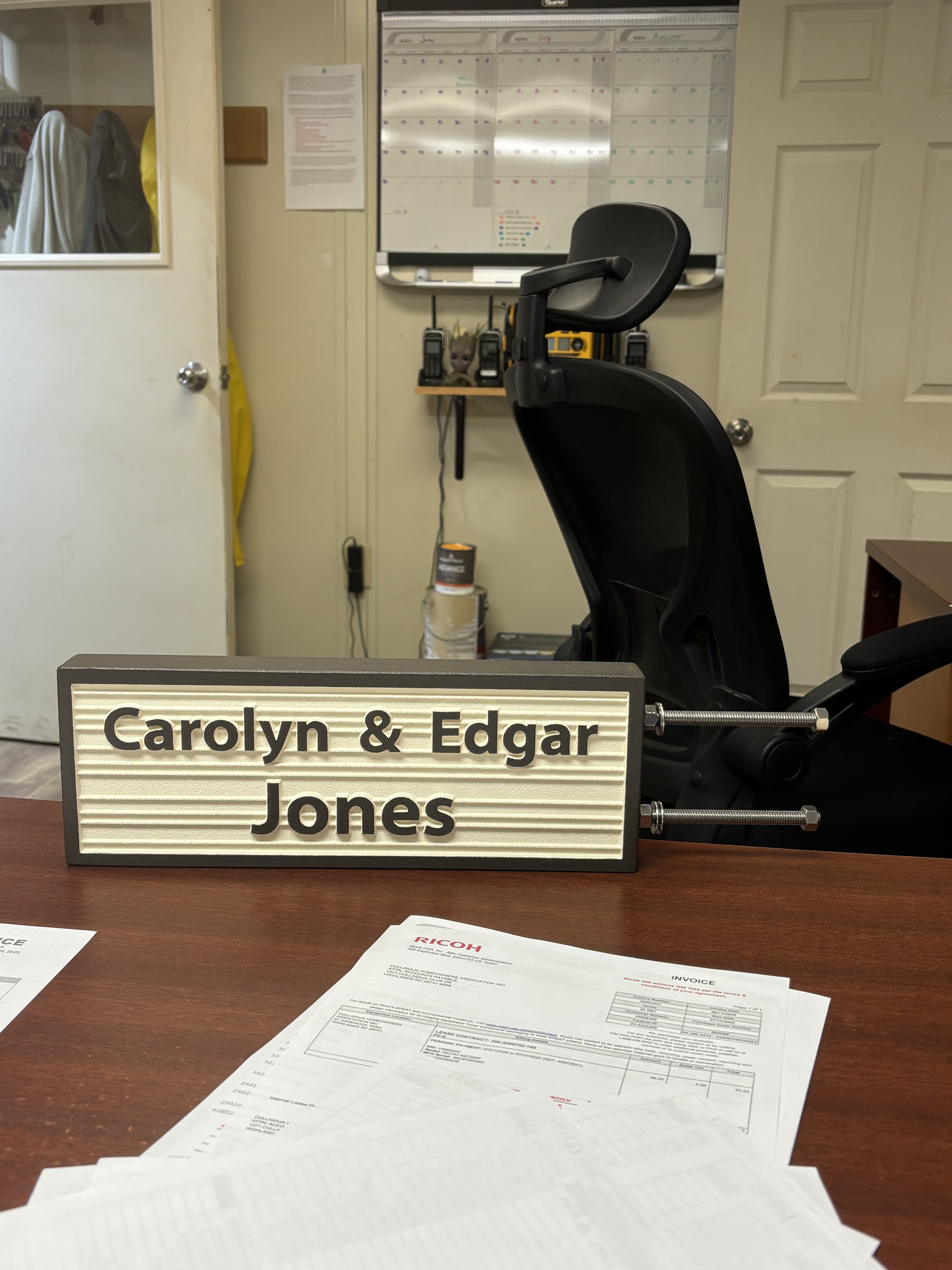

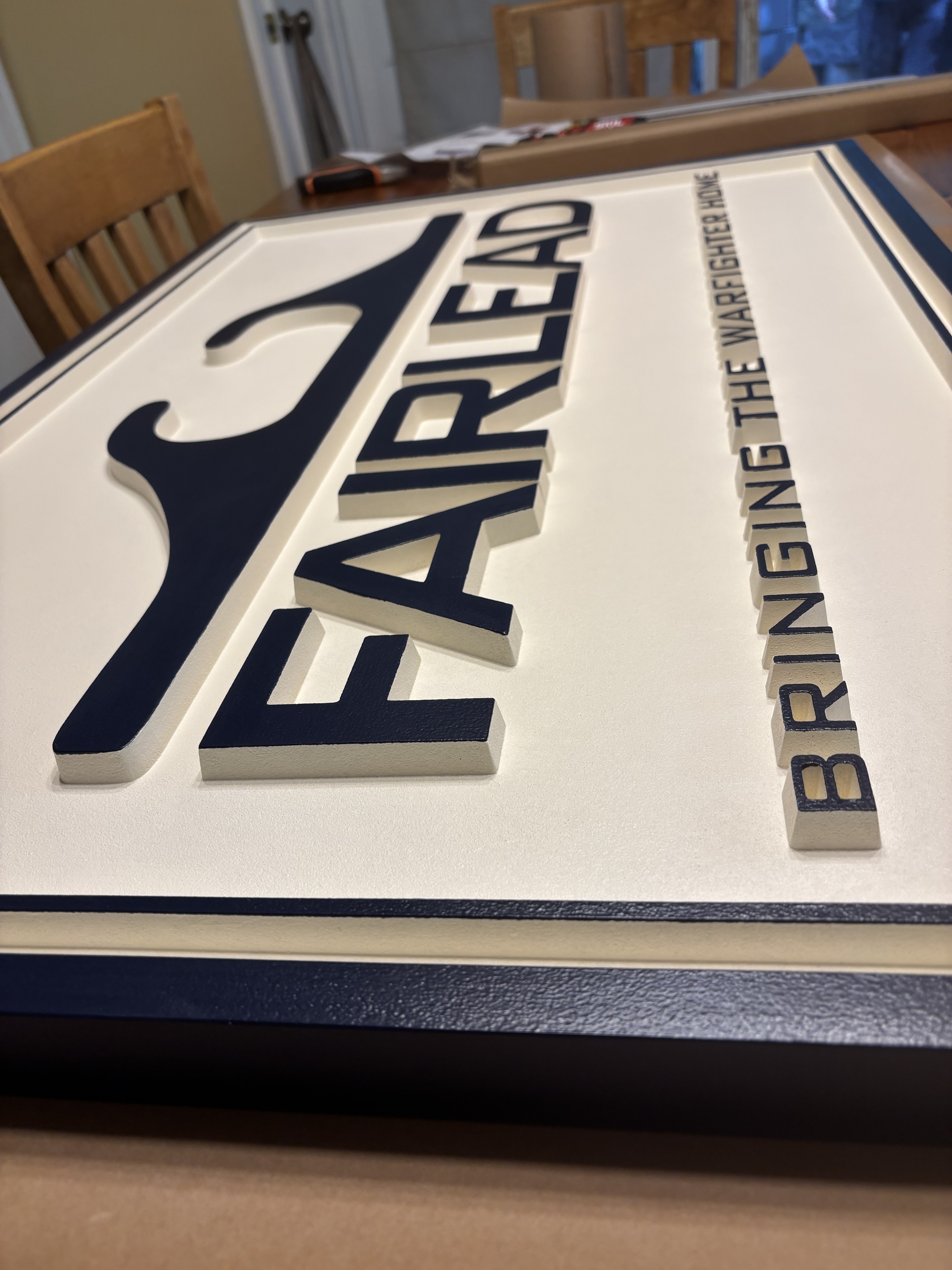

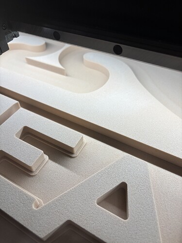

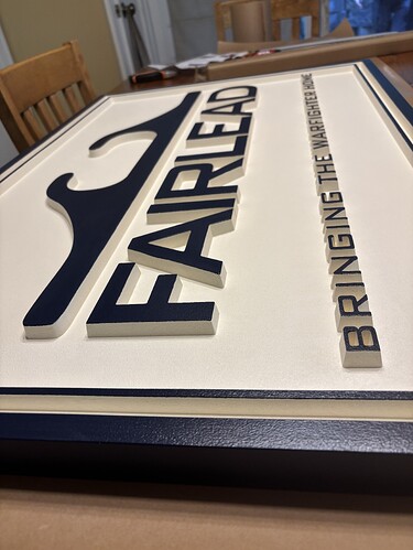

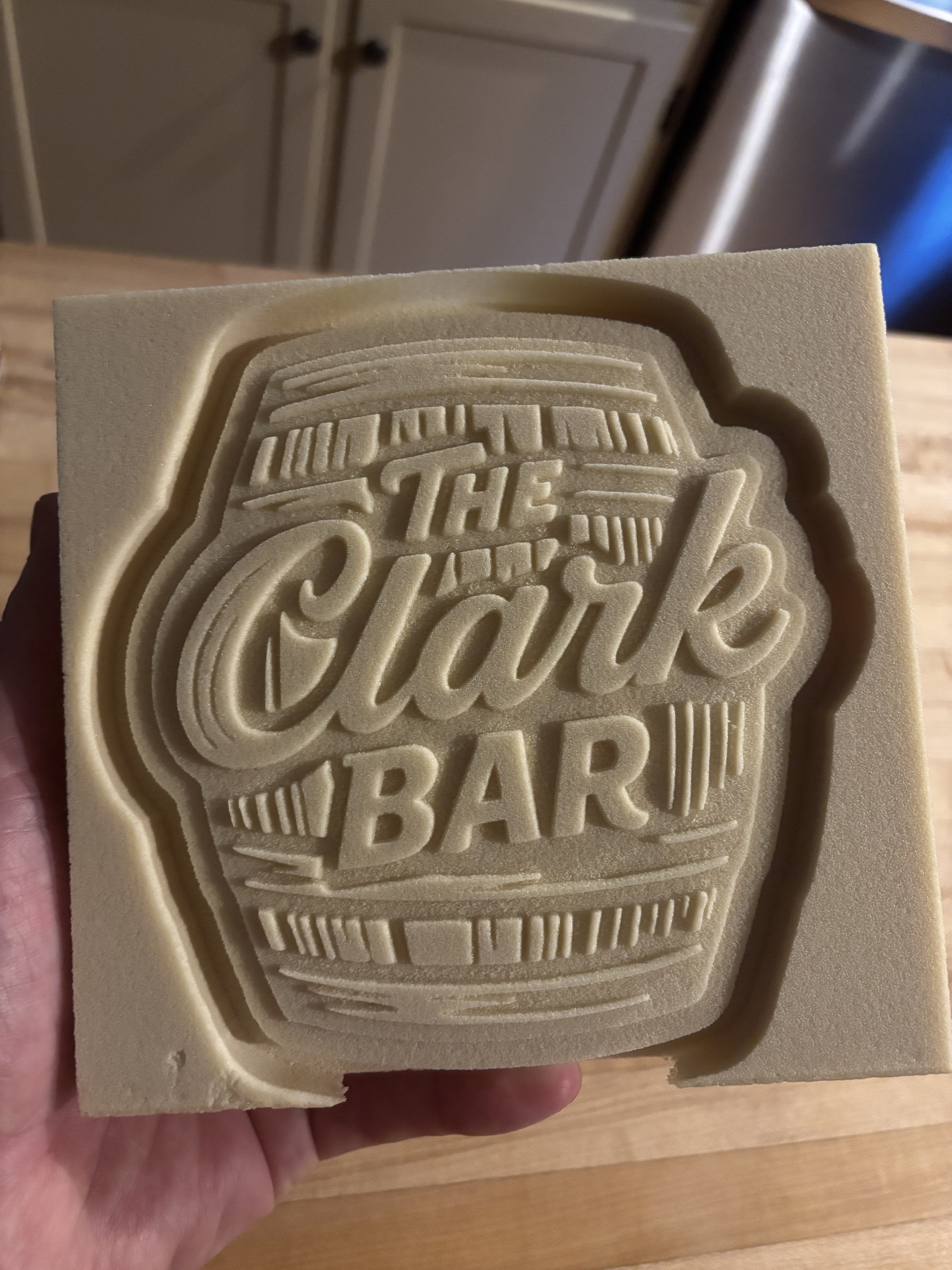

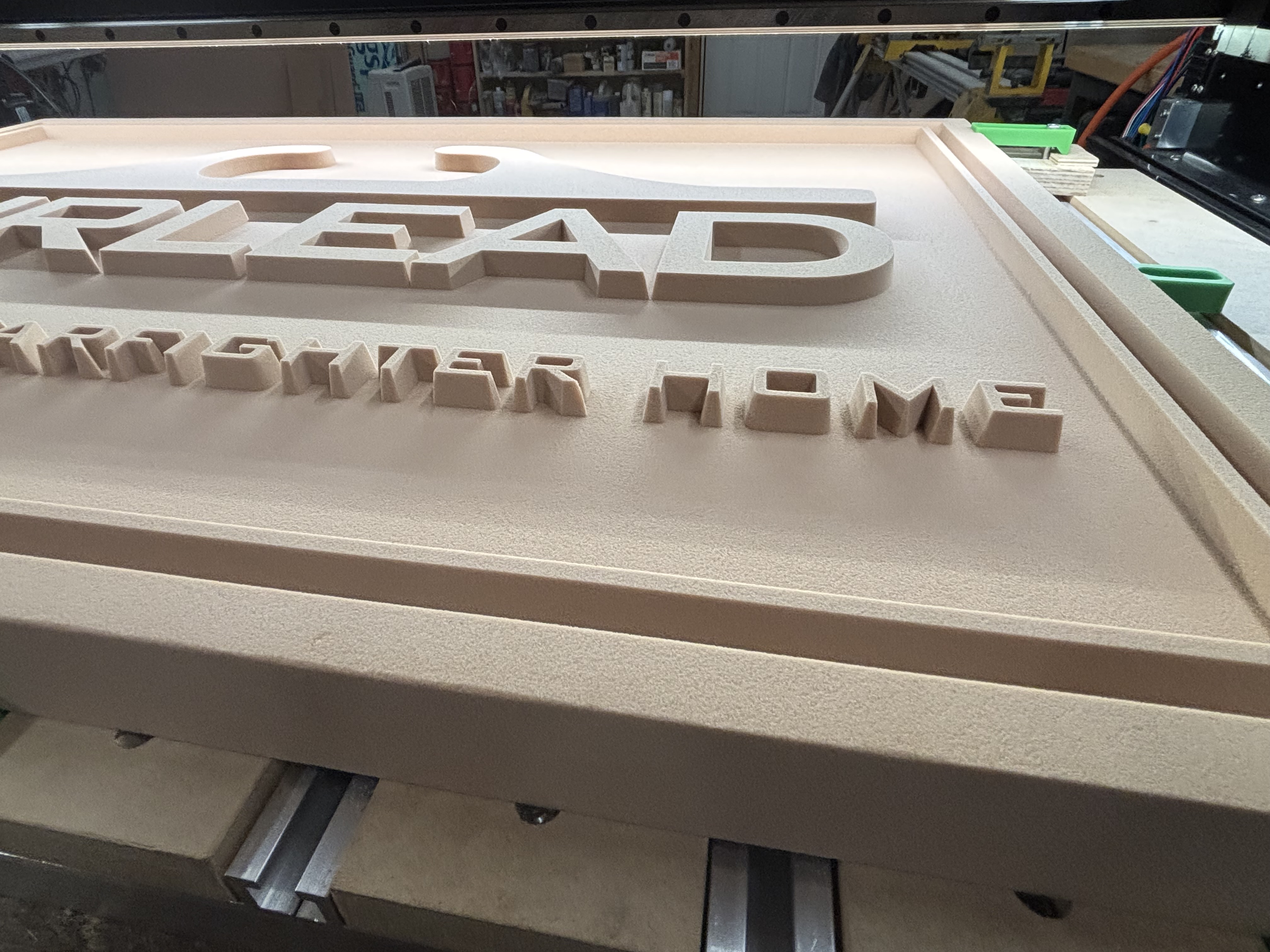

At least consider HDU. You will find that most professional carved/painted signs these are made from it these days. Extremely easy to work with, it will last a long time (we are repainting some where I work that are 12 years old and still in very good shape). It is a little more fragile but it cuts CLEAN!
Here are some examples I’ve done in the last couple months.
