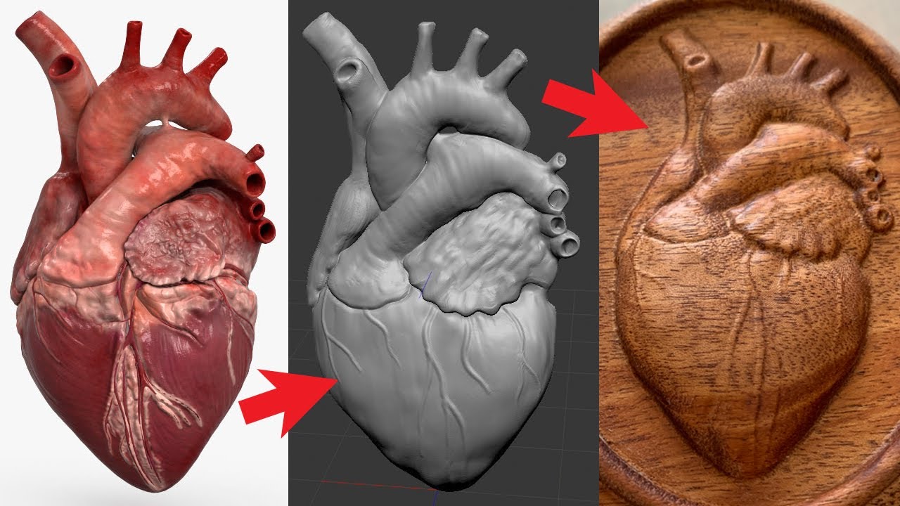

I am using Fusion 360, so I am not sure about Carbide Create or Vcarve. I found the steep learning curve in fusion 360 worth it.
To do the hornet I used the method from this tutorial.
After making the hornet, I made the models of the parts in fusion 360, and then converted them into tool paths.
For the carving, I used a tapered ballnose and parallel passes in fusion 360. Feed and speed depend on your machine.
