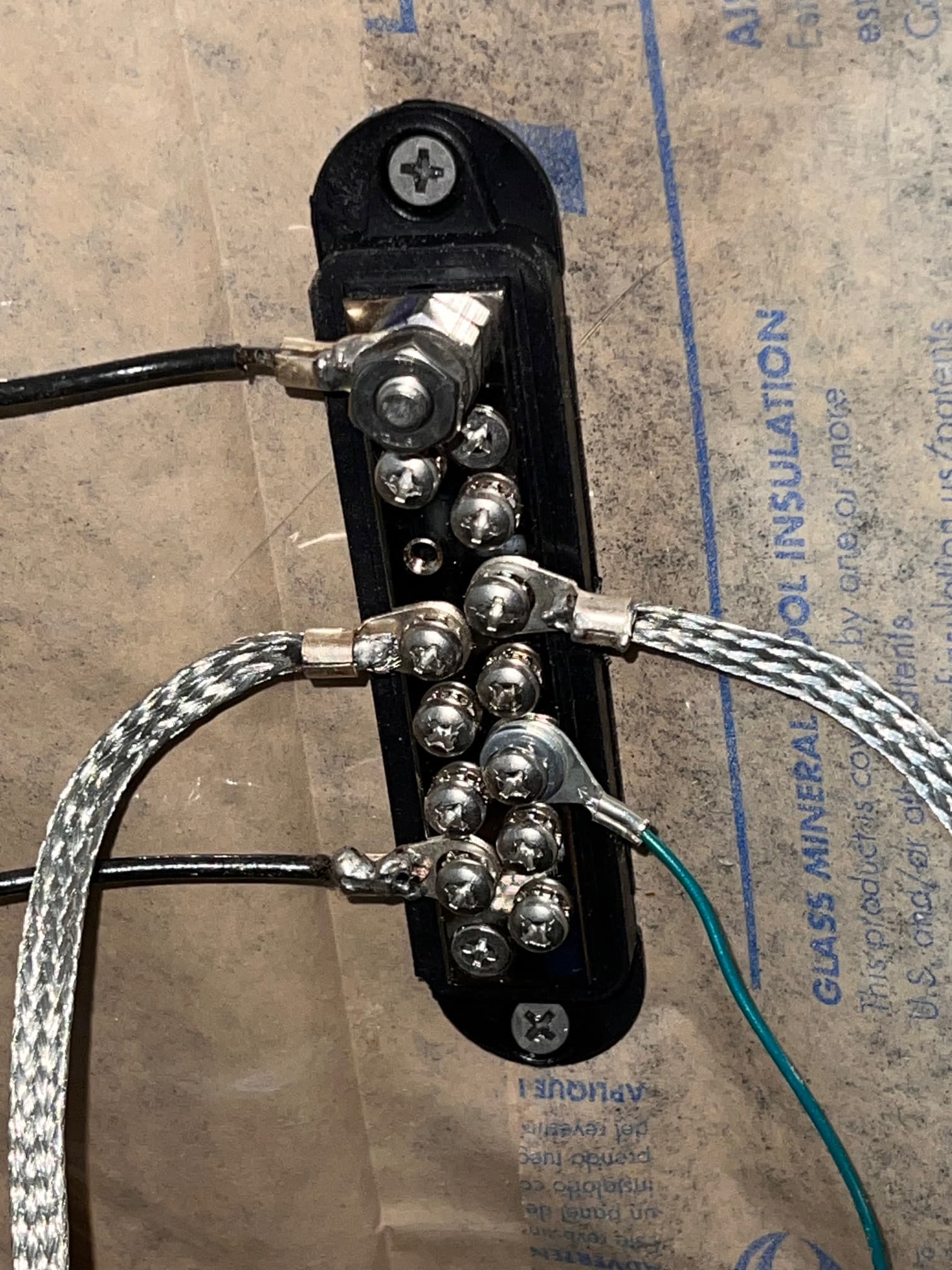

I decided to install a separate star point grounding panel on the adjacent wall with a grounding busbar (Amazon). I will attach a photo of this busbar plate. I then soldered a heavy grounding wire from my wall outlet to the main outlet on the busbar plate. Then I attached separate ground wires to each component of my CNC machine back to this plate. I used flexible tinned flat copper braid so that I could thread it through the drag chains on the machine to get direct and reliable connections to both the X and Y axis. I attached the controllers green ground wire directly to this plate instead of to the CNC frame. I attached ground wires from my dust collection hose to the plate as well. I also sanded off the black powder coating where needed to get good continuity throughout the X/Z assembly and the router mount to get good continuity throughout this assembly including to the outer surface of my router.

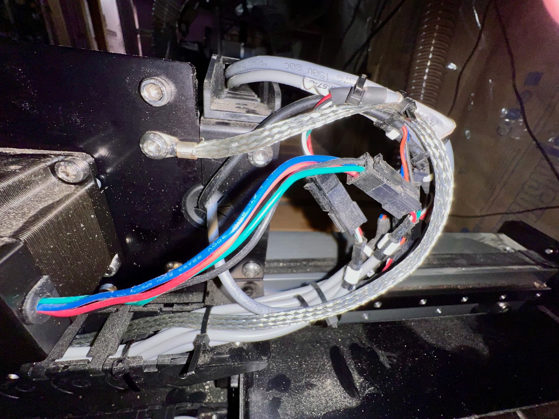

This shows how I threaded the braided cable through the drag chain and attached it to the frame (X axis gantry in this picture).

Here are the simple and inexpensive parts that I used.
This is the external busbar distribution block that I used.
This is the braid cable that I used. It comes with terminals that are easy to solder to the cable ends.
