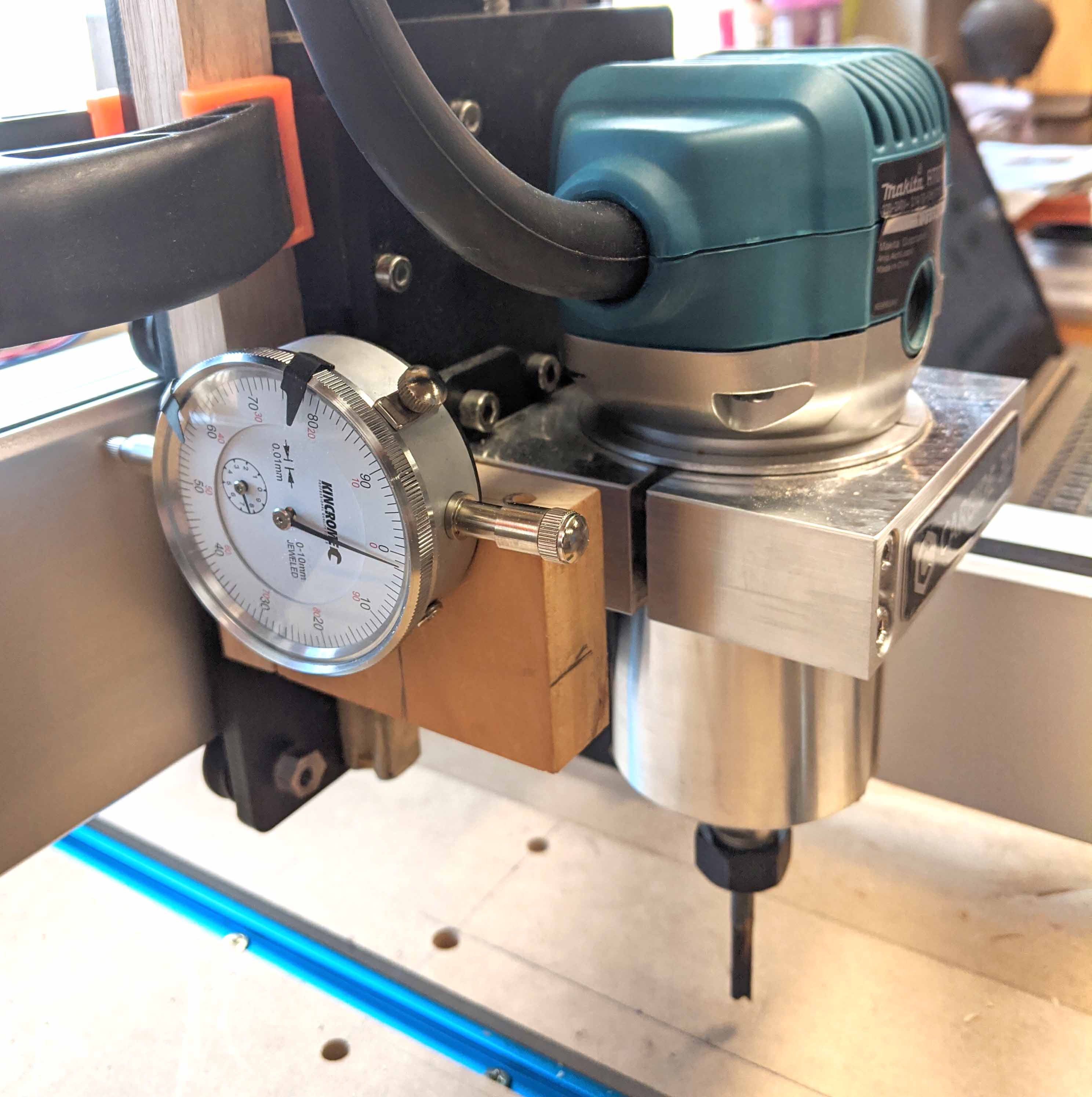

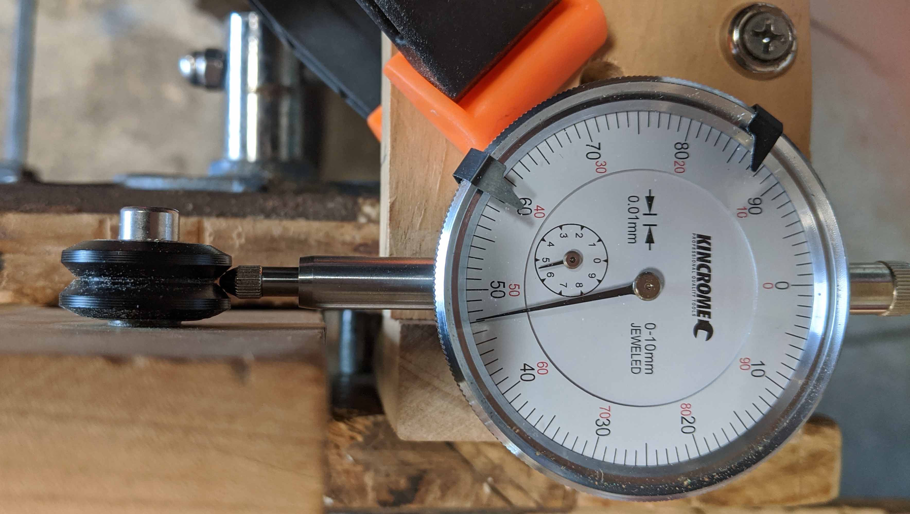

I’ve pretty well narrowed the cause of the waver down to the four V wheels that secure the router carriage to the X-beam. When removed and rotated with a dial guage (calibrated to 0.01 mm) bearing on the center of the V slot, the variation appears to be between 0.08 mm and 0.2 mm when measured over the four wheels. This doesn’t sound like much, but appears to arise from deformation of the wheel causing the plane of the slot not being exactly perpendicular to the axis around which it is rotating. Does this make sense? The mechanical arrangement could cause these irregularities to be magnified at the cutting end by a factor of about 2X, leading to the roughly 0.5 mm waver I’m obtaining in my straight line cuts (ie +/- 0.25 mm).The apparatus I constructed is pretty crude but gave fairly consistent results over multiple measurments (see below)
When I mounted the dial guage on the router carriage (see below), the gap between the top of the beam and the router carriage varied by 0.1 mm as the carriage traversed the length of the beam, reaching its maximum value five time over the 16" traverse.
Again, this would seem to be sufficient to cause the waver I’m observing.
The only explanation I can obtain from this is that the X-axis V wheels are deforned to various extents, although the 7 cm period of the wavers (also the circumference of the V wheels) suggests that one is more deformed than the others and I observed that the upper left wheel is worse than the other three.
One question remains - did I cause this or is there a manufacturing flaw. I actually undertightened the wheels at the ouset, rotating the cam screw only until the first resistance was encountered. I later noticed some slop, and tightened just enough to eliminate this.

Good measuring, it looks like you’ve eliminated everything but the cause of the fault.
The periodicity of the measurement still seems to be the strong pointer here.
The lack of shims is interesting, if your wheels look like @David.Curtis but have no internal shim then either the shim is missing or, as you say, the design of the wheel has changed. As I understand it the purpose of the shim between the inner races of the bearing is so that when the clamp bolt is tightened the inner races are locked into a fixed relative position in a solid stack from the plate to the bolt head. This then fixes the outer races on the plastic lip between the two outer races. This reduces any unwanted axial movement without creating excess axial load which the bearings aren’t meant to take and quickly causes wear.
Presumably the new wheel has either a much narrower gap between the bearing outer shells or is fitted with a differerent bearing? (although even an angular contact bearing normally needs a fixed spacing)
It would be good to confirm the lack of requirement for the shim.
It might also be worth checking your bearings for axial play and slack?
