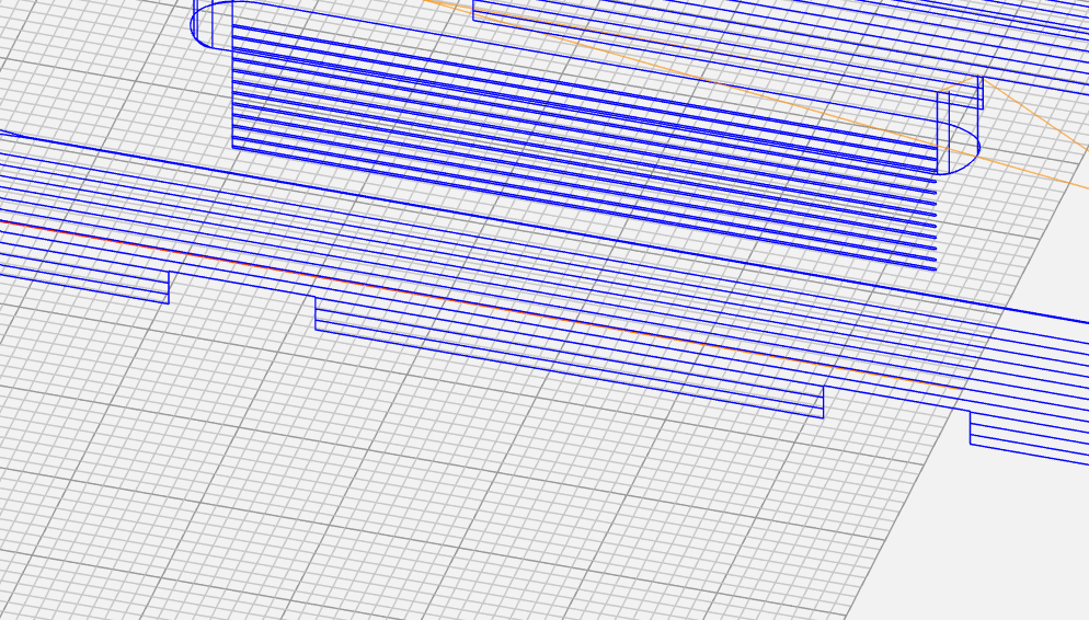

The wood is .471" thick, so I set my contour cut to .475". Was that too much?
But it should not have gone through my tabs (5mm wide x 3mm high).
I did set the retract height to .25, is that what did it?
See my code attached.
Thank you.

Weird…the moves to avoid the tabs are present in the G-code,
so the only thing I can think of would be an incorrect Z zero, resulting in a first pass being ~3mm deeper than it should be (and then it would cut down to stock bottom before reaching the cutting depth where tabs would have started).
