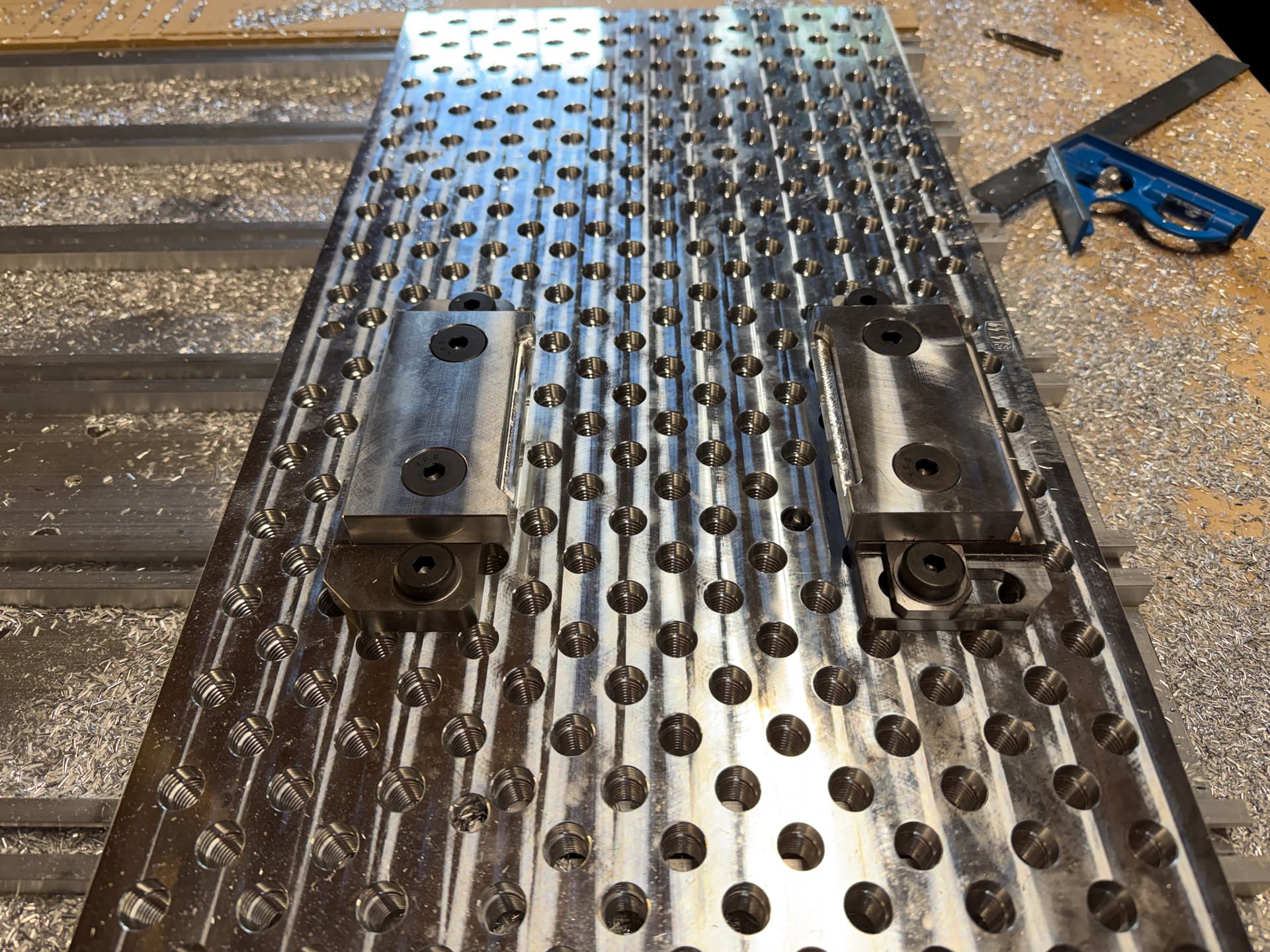

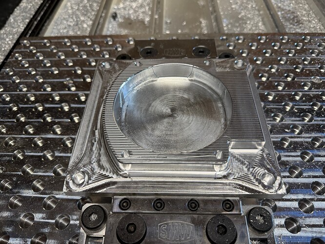

I’m putting a drive by wire throttle body on my '72 Cadillac and Holley no longer makes the one I wanted so I thought it’d be a good first aluminum project for my So5P.
I figured this one was a throw away prototype anyway to make sure I had at least the first round of attempts at doing aluminum figured out. Granted that is probably a $45 chunk of aluminum but I’ve learned/figured out so much with it that it was worth the effort. All the machine upgrade stuff (5.1 rails, 2.2 kw watercooled spindle) showed up yesterday and when I’m done with this particular part I’m going to start on that with hopefully making a video of the process then do the part again for real. I might even sneak in an attempt to thread mill the 1/4-20 holes on the first op side.

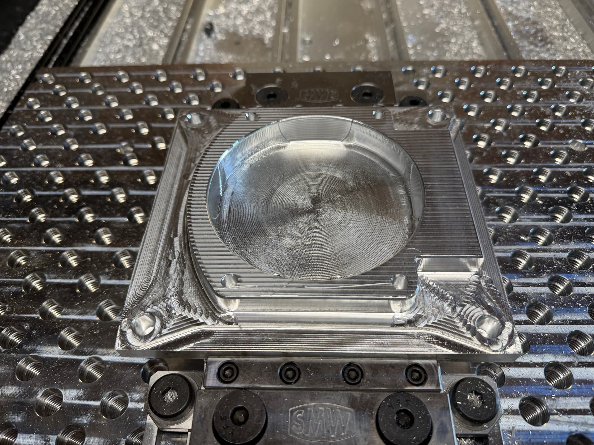

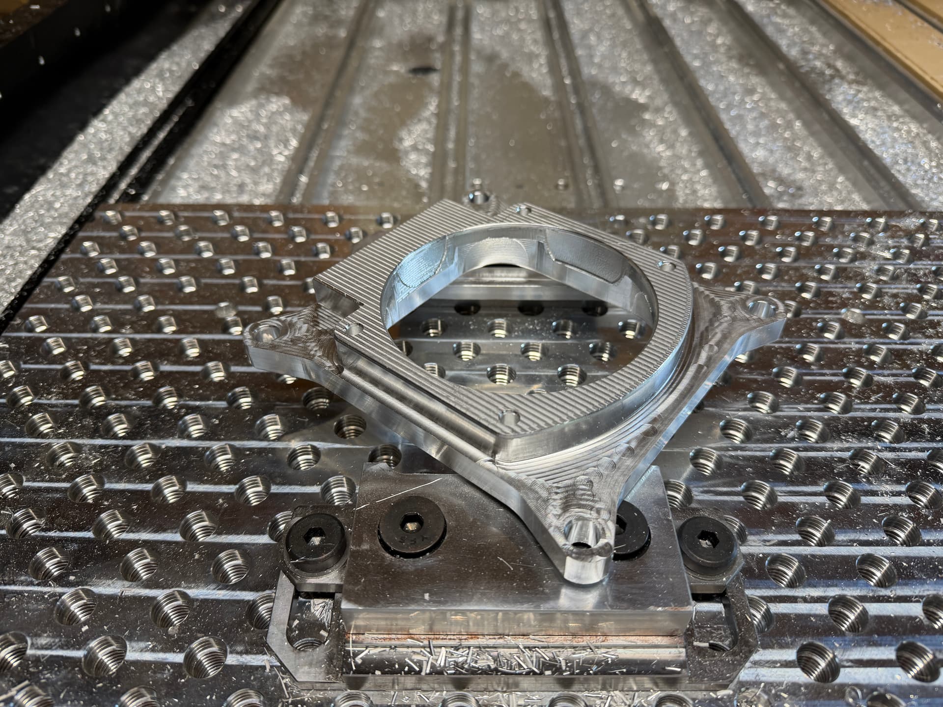

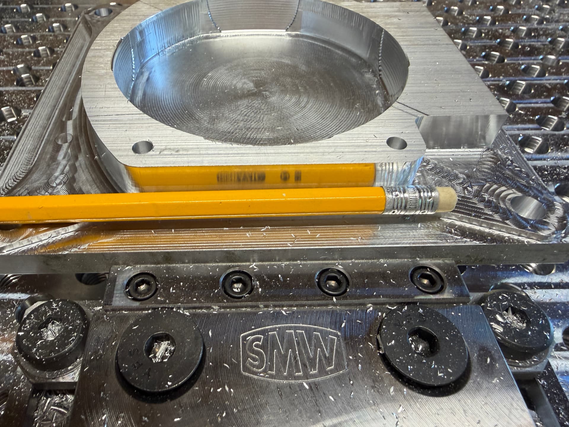

  • I think there was a bur or a chip in the soft jaws I didn’t see so it wasn’t completely flat. I need to get the micrometer out and see how far off I was on X/Y too but it was REAL close on the second op.

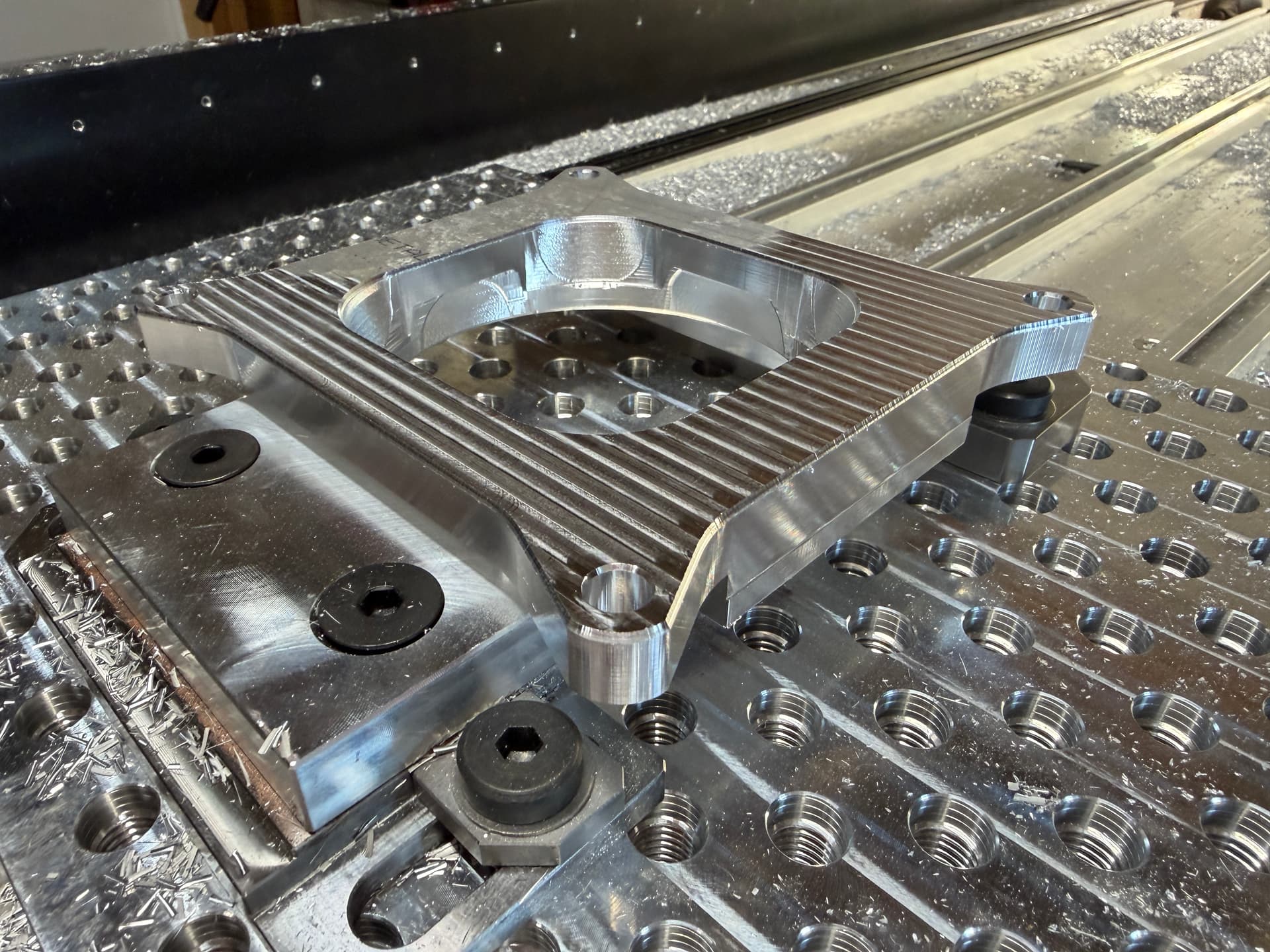

  • Flipping it for a second op was not nearly as bad as I was thinking. I was, as usual, overcomplicating it but I found some great youtube videos from Mechanical Advantage and Chip Monkeys that really helped me understand it.
  • Since the overall finished part is 1" thick I need to use longer cutting length endmills for the interior pocket and one face on the outside. Most of what I’ve been doing has been single flute with a .75" cutter length so I’ve been going .6 on most things when I should have gone .7 and not have to pick up the the rest later. That later mentioned 10mm is going to be mighty handy for this.

  • I forgot a clean up pass on the first op for the inside of the round hole so it is undersized by .02 and looks a little crap.

  • 3d Ramp is a better strategy than 3d Contour for finishing passes but I might be getting a bit over zealous with the thickness. Pretty much everything in Fusion can be seen as a parameter so I think I can take the ‘stock to leave’ dimension and use that as the max radial cut width for the clean up pass to get dimensional accuracy?
  • I did find an Amana 46286-K tapered ball nose in my box-o-bits which so far gives me a glorious finish on a .015 stepover. For the actual part I might go super fine on this so I have to do less manual blending later.
  • Single/zero flute endmills are the bees knees for doing clearing but I think a 3 flute might be the money for doing face finishing passes since they are more stiff.

  • I should figure out some creative way to set the distance between the softjaws when I mill them. I initially set them at 4.25" in the program but for some reason I had 4.5" in my head so the first one cut air. I could probably just cut a 2x4" to width for spacing them since the movable doesn’t have to be as precise and if I put it back in the machine I’ll be locating off the part anyway.
