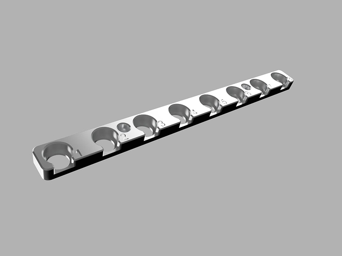

Tool Magazine design

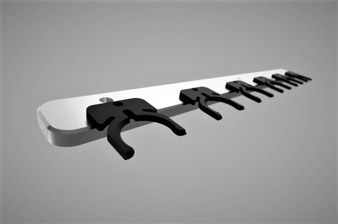

Thinking about changing the strategy here, sending the tools to the back of the machine and installed on a wine rack holder with forks…
