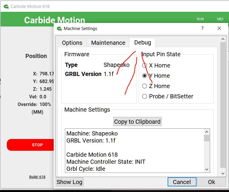

Go thru the steps to check your proximity switch by putting a piece of ferrous metal by it. If it lights up check the board to see if it has a light on it corresponding to the proximity switch. Also, open CM to see if it sees the switch (debug tab). If the proximity switch works correctly try adjusting the proximity switch closer. Check that all connectors are tight.
I did this:
Got to take another picture, took the AC wire out a long time ago
I did there is a corresponding light at the box i also notice i have two red flashing lights just below where the power cord connects. and it is still doing the same thing . I want thank you for taking the time

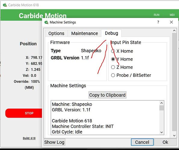

With Carbide Motion open and in the Debug tab, is the proximity switch marked when you put metal by the switch? And does it go off when removed?
I apologized where is debug tab ?

mine is different goes machine options user interface I click around to find debug i did not find it I also notice that mine is 579 version
@WillAdams I don’t remember if the screens have changed in versions.
Yes, the screens have changed.
The Debug pane is new in CM6.
Some of the information is in other panes in the older versions.
I am out of options. I don’t remember what screen it is on.
I do know it is in CM
